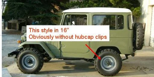

Has anyone tracked down an aftermarket steel wheel that looks like the old stock hubcap style (not the later one) but in 16" with the proper center for the hub and clearance for discs? I'm about to just order the 15x5.5s from my local Toyota dealer but wanted to make one more run at something that looks stock in 16" I'm not planning to run the caps anyway...just gonna paint them gray and call it good. This is the wheel style I'm looking for.

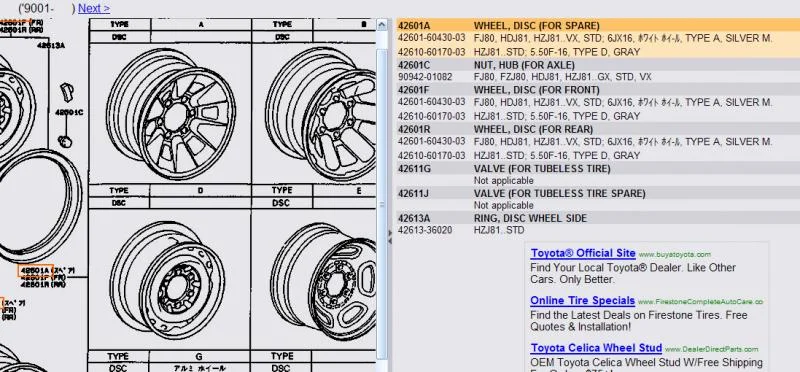

You know there is a 16" non-split option from Toyota right?
The part number is definitely in the 45 section.
Dan
Not using the part number I found there... not with my dealer here in NY (who is pretty good about odd part numbers)
42610-60021 is the number
