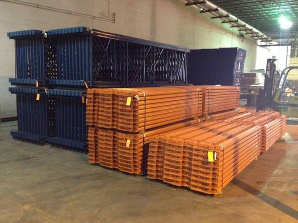

Where did you get that shelving? We need some like that.
Garrett got it from where he was working ( the were changing up the layout)
it is pallet shelving. you can check around on craigslist
or places like uline
One of the last things I did at a previous job was dismantle about 80 linear feet of that stuff. All of it was 12 and 16 feet tall, with 4-6 shelves each. Loaded it up for the buyer. A year later I went to work for the buyer...and my first job was cutting it to fit the available height, blasting it, painting it, and installing it before setting up the warehouse. It had just been sitting outdoors in the year he'd had it. Had no clue that our paths would ever cross again. Oh, did I mention the 3/4" plywood decking???
