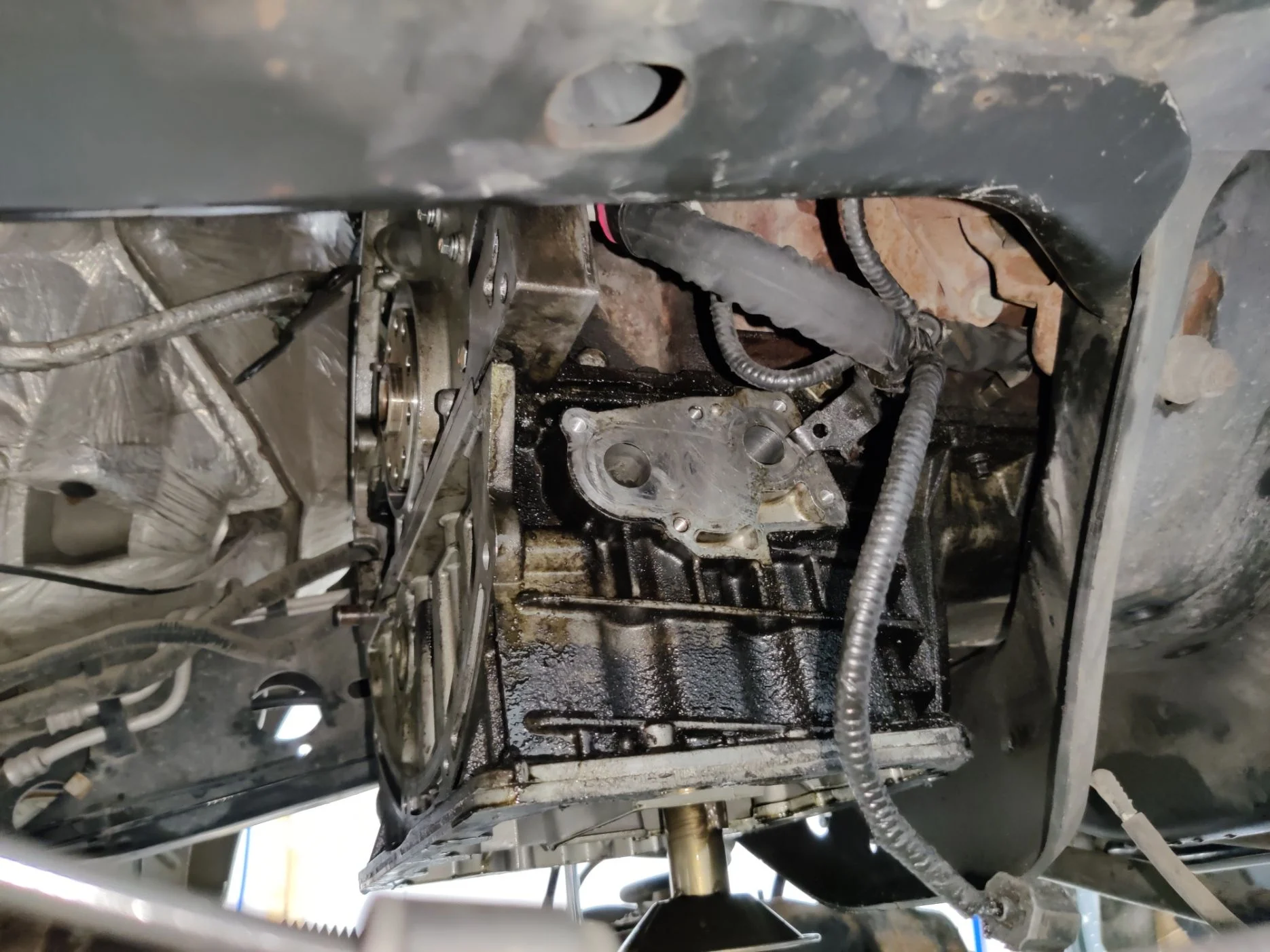

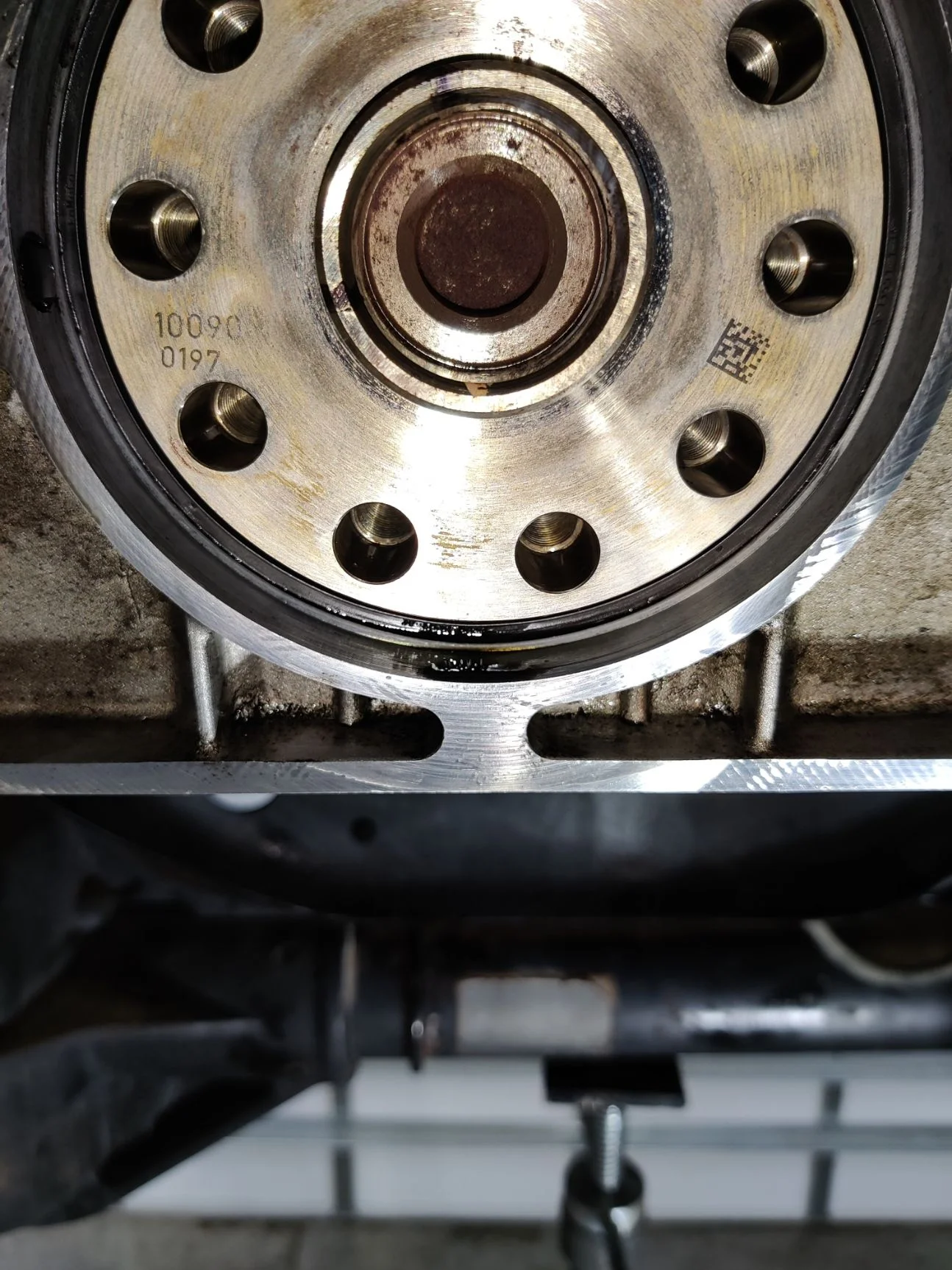

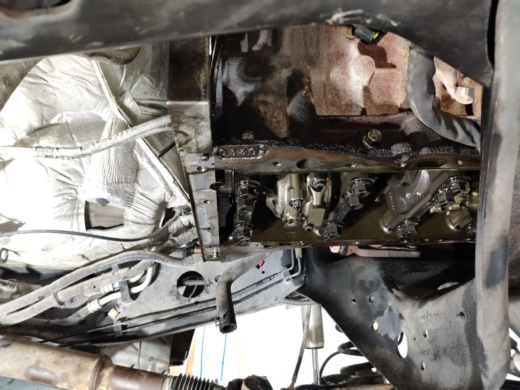

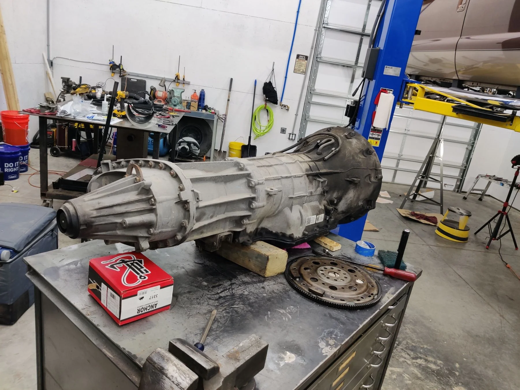

Ford had a bit of an oil leak, Upper pan gasket and rear main. also found a radiator leak and repalced the transmission pan gasket and all the coolant hoses while i was there. hope be good for another 10 years or so.

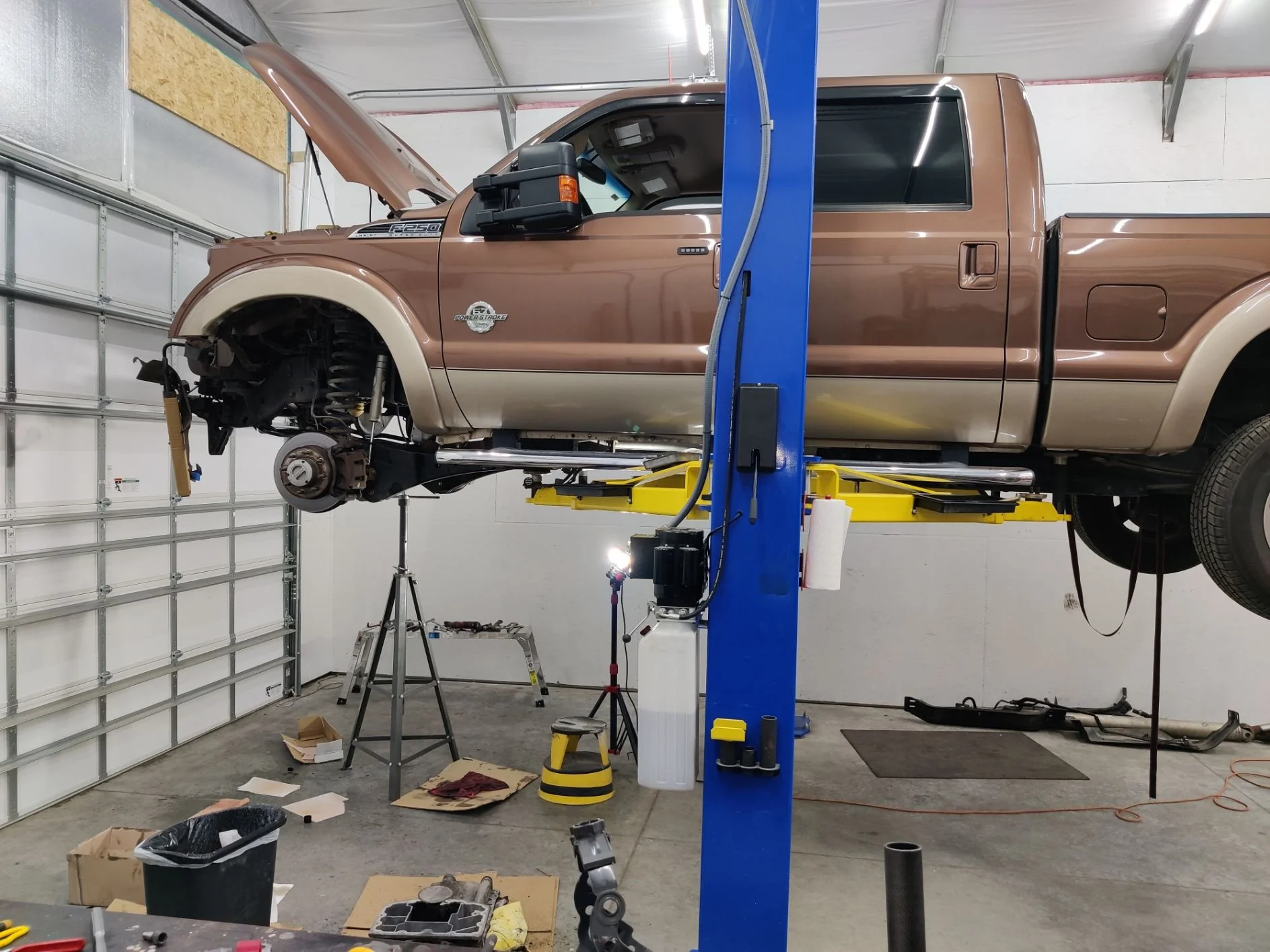

now Garrett has two vehicles in the garage he is working on, and one waiting in the yard. and i got one coming next week. Leason: should have built bigger.

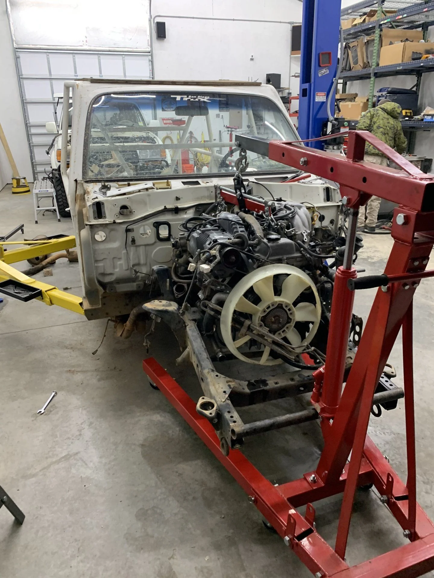

Got some more progress for the supercharger for the 80. Got it all stripped and the motor out.
Removed the core support and inner fenders. did a compression check, As my luck would have it, Cylinders all had 190pso except for 4-5 at 160. Suspecting a HG but ill get it stripped down at some point to further investigate the issue, Me and Pops went ahead and and ripped the motor out all in one since we had easy access to do so. Now she's about off to end her life at the scrap yard.
