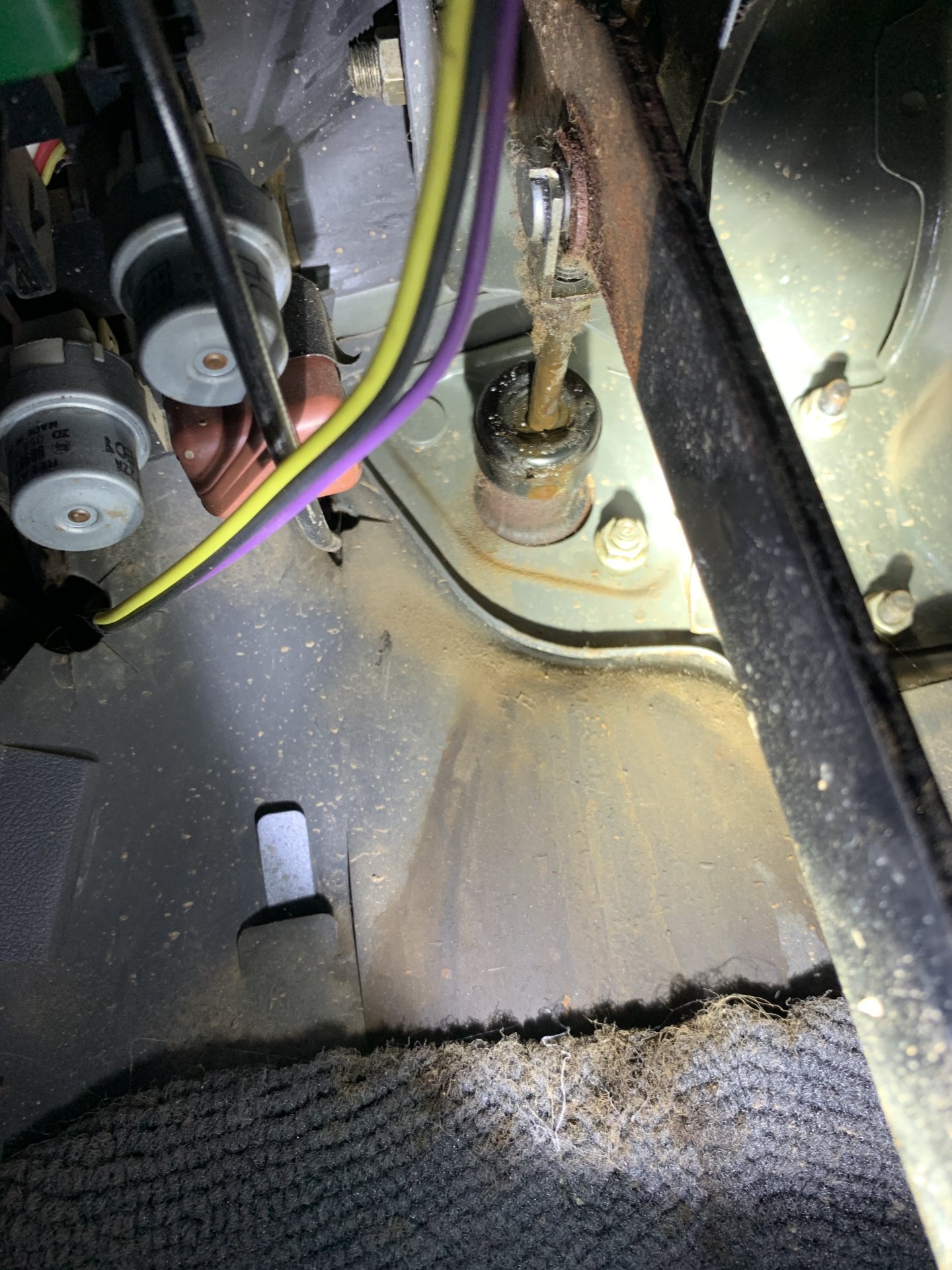

Regarding the clutch master cyl. leak - since it has been sitting I would recommend replacing the clutch slave and master. I have owned 60's for many years and the only time I have been stranded in one is when the hydraulic clutch system failed. It is relatively easy and inexpensive to replace and bleed the whole system, and well worth it for the peace of mind. There are several great vendors on this website who can hook you up with the correct OEM quality (AISIN) parts for your build date.

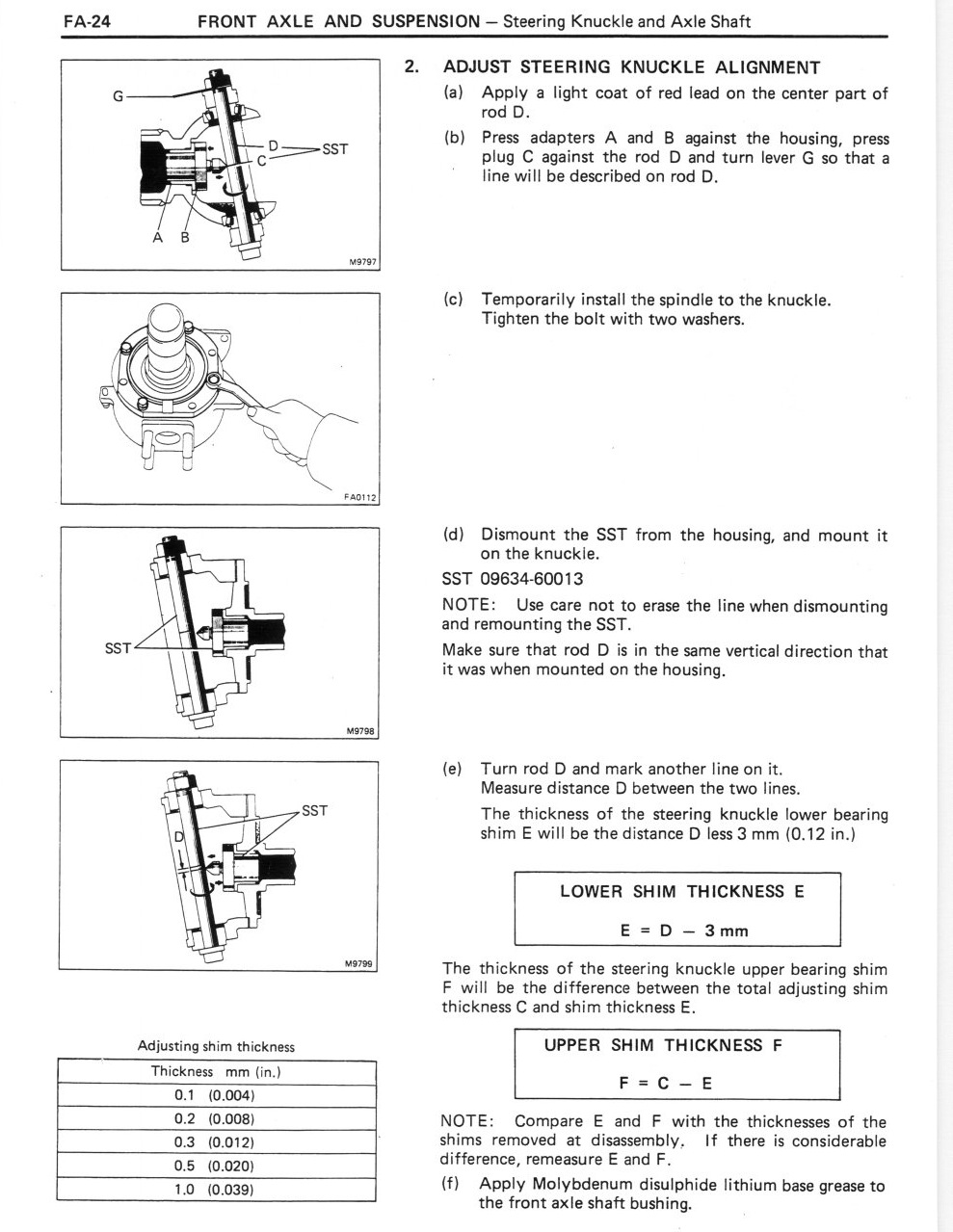

Step one: go here FSM - 1984 - 1990 Repair Manual, Chassis/Body - https://forum.ih8mud.com/resources/1984-1990-repair-manual-chassis-body.1/ and click the download button. Read the FA section.

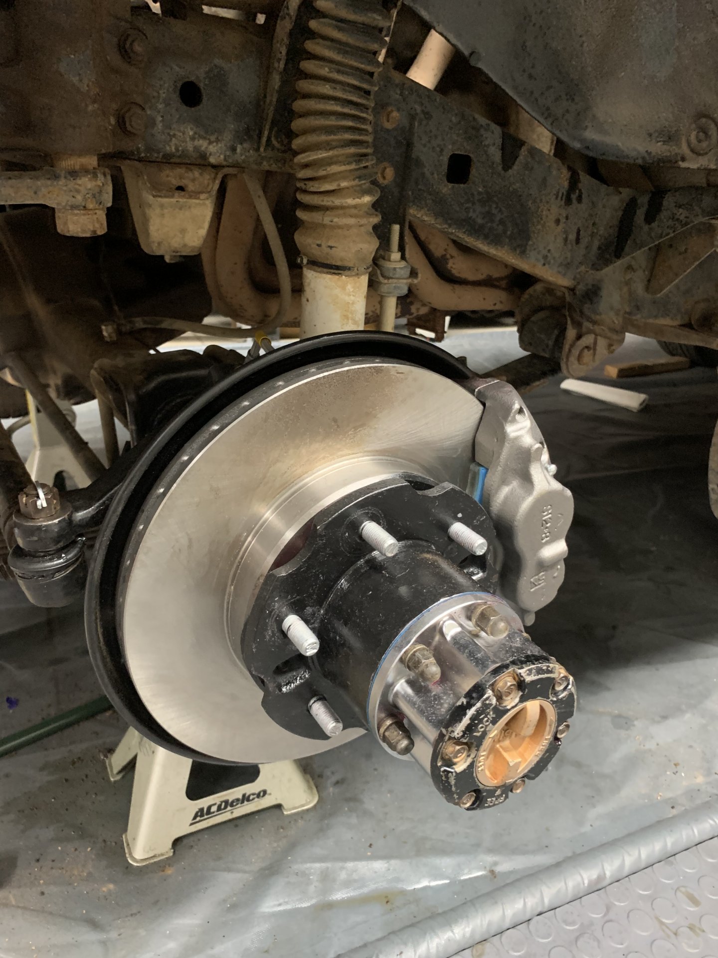

Of course it took longer than expected but the knuckle refresh went well. A few things are making me question the P.O.s mechanic, he’s a well known and respected guy but looks like I’ll be double checking more of his work…

Nice job on the knuckles. Looks like you replaced the disc, calipers and studs while you where in there. Nice. that takes some dedication to drive out the old studs and press in new ones to get all that done. Is that a new hub too?
Agreed here. Those studs are the biggest PITA of replacing the discs to me. Had some shear on me recently and had to get new ones. I don't have the proper press to make it easy so have to find someone who does. Some day I'll get one and make my life better. Good job OP.
g, the old studs came out fairly easy. When I removed them from the 60 I hit them with some PB Blaster and they sat until the end of the project. Just a few smacks with BFH and they came right out. I wasn't willing to swing the BFH hard enough to drive the new ones in. A friend let me use his 12 ton press (no dies). We had to get creative to support the assembly and give the studs clearance. Some scrap 8020 worked like a charm. As always the right tools make the job go faster, easier and safer. Although the snow didn't help.
The hubs are stock. Hit them with a wire brush, de-greaser, primer and a few coats of semigloss black. I don't expect it to last long but they look good now and it gave me something to do while waiting for parts to dry.
