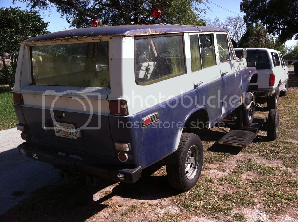

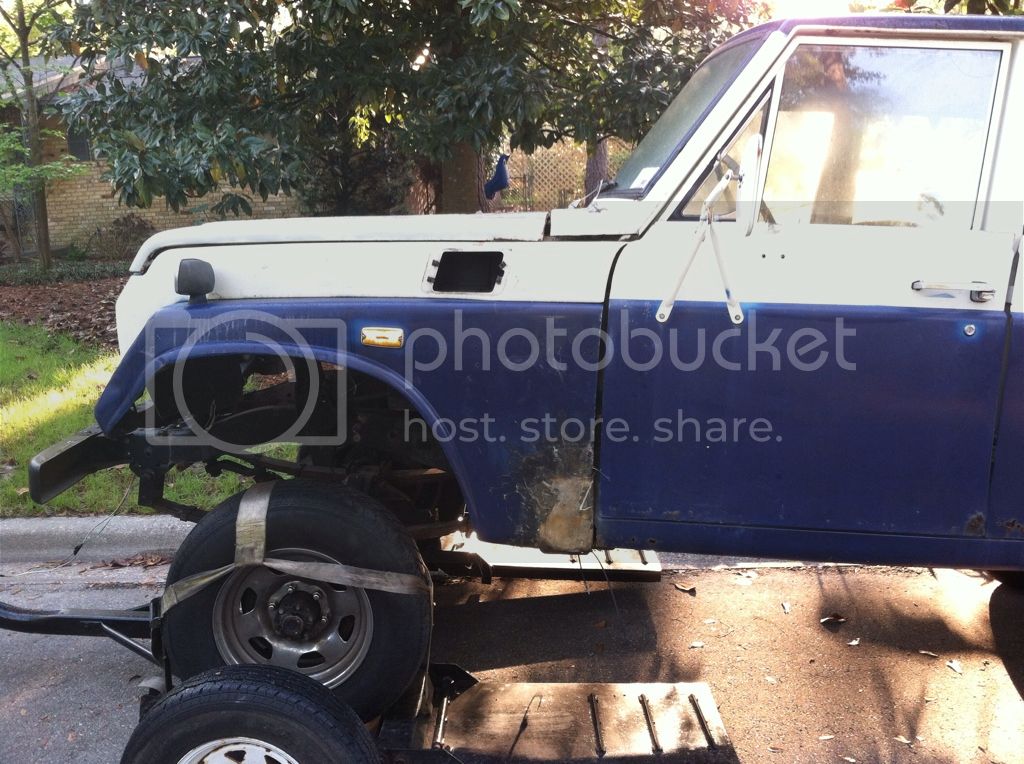

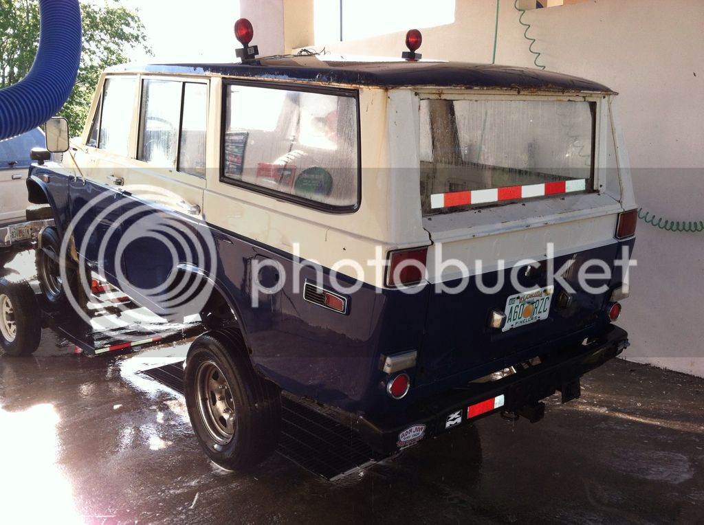

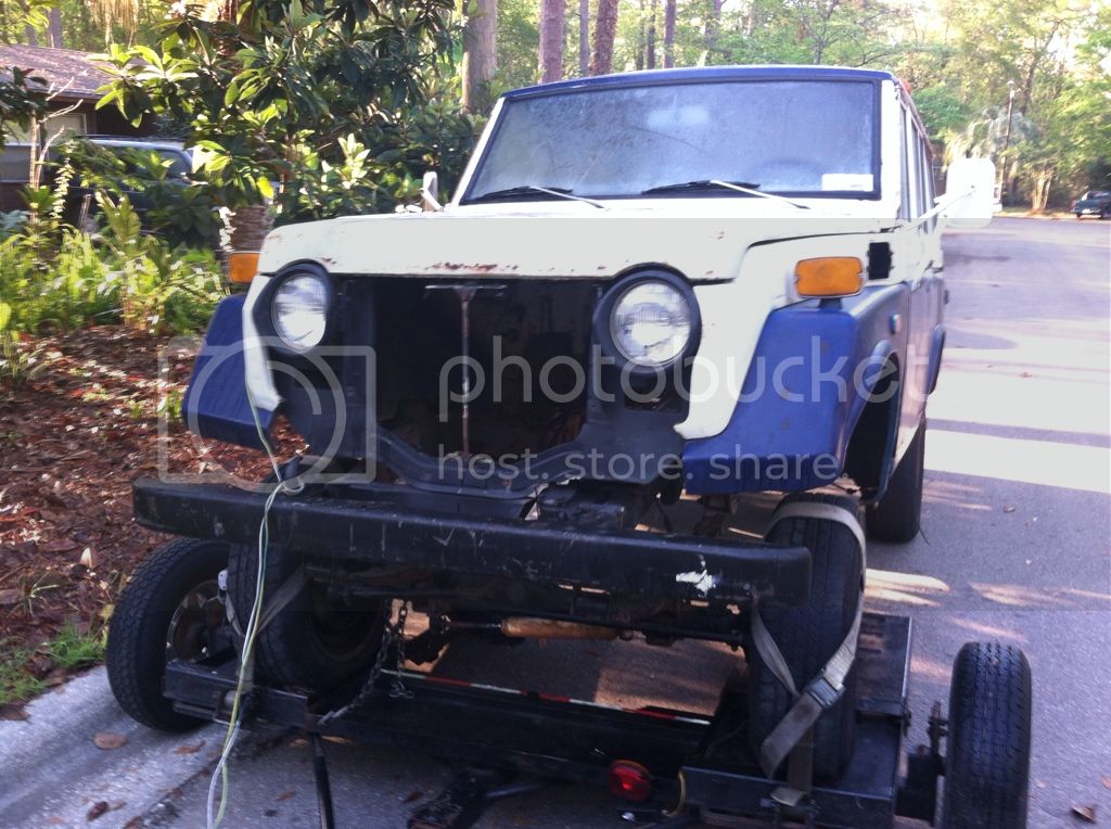

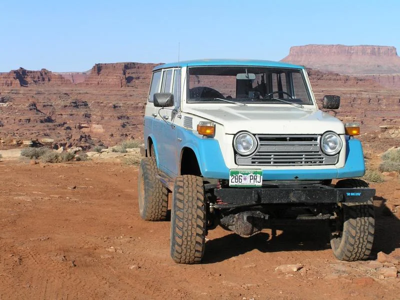

I have had all sorts of cruisers, but never a pig. As you would imagine, I'm stoked.

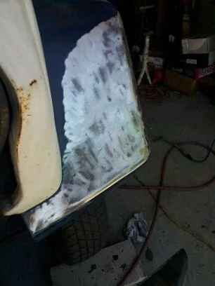

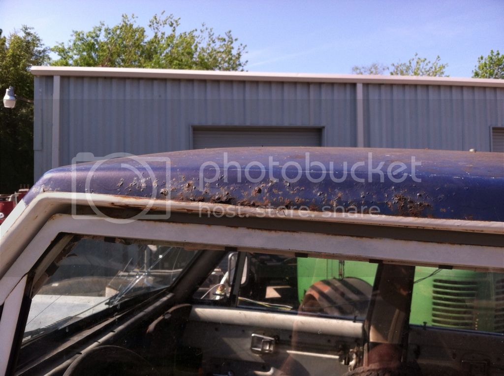

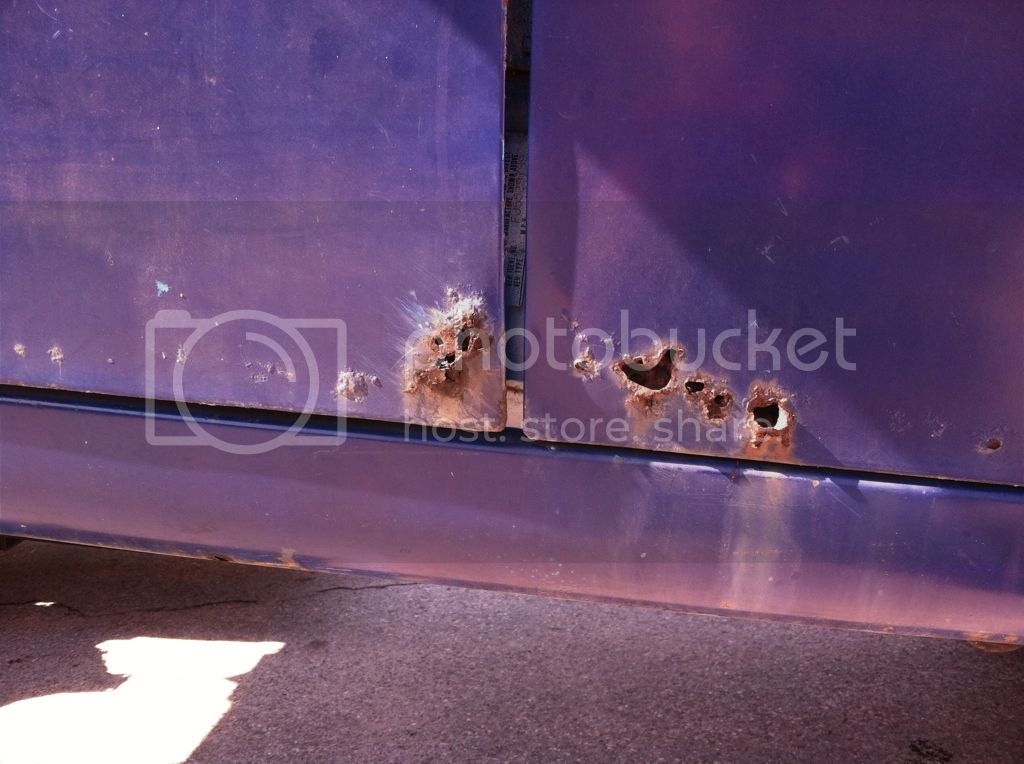

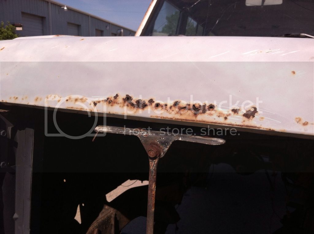

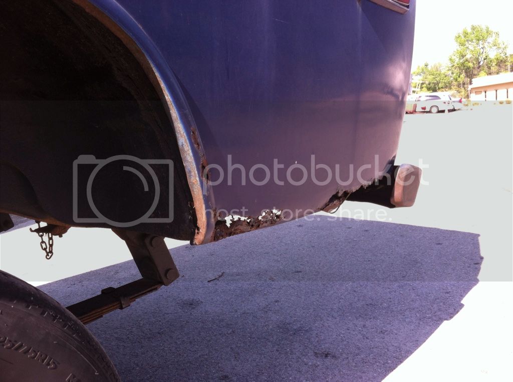

Currently it is just a roller. The frame and undersides are rust free. The plan is to have all the rot & fiberglass removed and then swap in an entire 60 drivetrain.

Looks like someone did a spring-over on it?
Yeah, it's sprung over. I was going to put sua 60 axles under it, but may leave it as is and just swap the pieces from the knuckles out. I have plenty of time to decide while the body is being repaired.

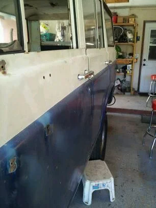

Not much of the interior was in the truck when I picked it up. All the seats and rubber flooring are MIA. The truck did come with all four door panels. The po ripped all of them, instead of taking off the window cranks, when removing them. What a bozo. On a positive note, the floors are solid and won't need any repairs.

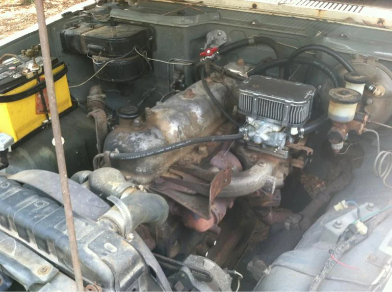

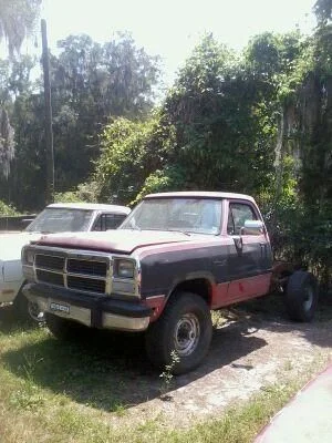

I've been driving the tan donor 60 while the 55 body is getting made over. It runs like a top, but to be quite honest, I am already bored with it and fear I won't be satisfied once it's installed in the piggy. After some serious thought, I have decided on another power train for the project. I'm picking this up tomorrow and am attempting to replicate the build below. I figure it will keep me busy the next 24 months worth of weekends.
http://www.pirate4x4.com/forum/showthread.php?t=309331&highlight=cummins
The Dodge is equipped with automatic overdrive A518 and a NP205, which will all be retained. The orginal plan was to run the d60 and 70, but since this lilly piggy won't be seeing any dirt, the Toyota axles will be beefed up instead. The np205 has a centered output, so TURNMEOVER is building a cruiser/mini hybrid rear axle. The plan for the front end was to use the 60 outters and brakes. After seeing PROJECT IRON MOOSE, I am now thinking of using mini stuff so I can run these adapters for 12.5" rotors and calipers off of a 06 4runner.

Seriously!!!!!! That is a bad azz Dodge. Keep that as a tow rig. I've got that truck and it is the real deal. I put a 4bt in the 55. Im rocken two Cummins
Believe me, you aren't the first one to tell me that. I agree, the drivetrain in the Dodge is the real deal. but just think of how much more appealing it will be wrapped in bacon. Besides, I already have the tow rig department covered.

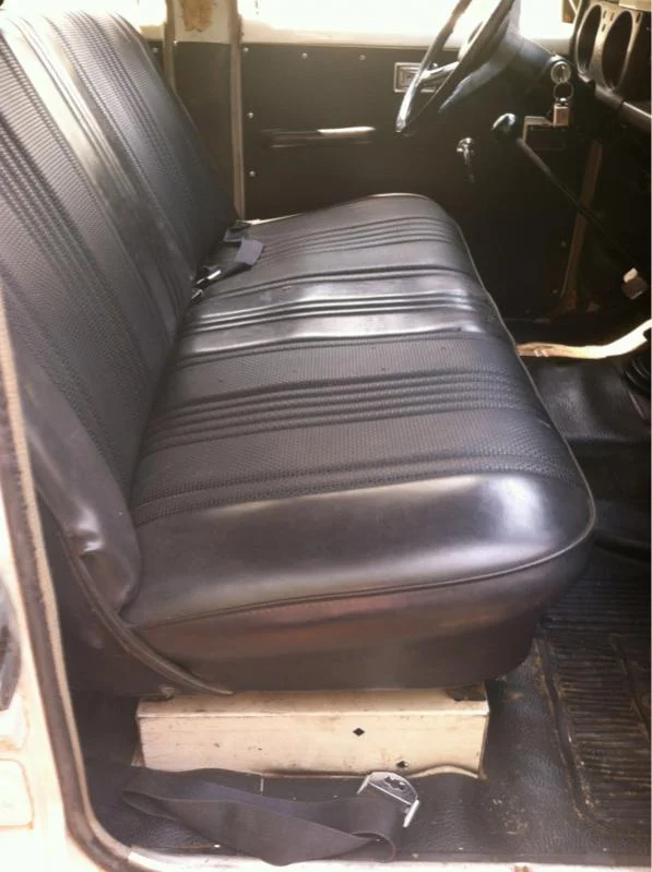

The Florida DMV will allow you to regsiter a vinatge plate to your vehicle, as long as the year lines up and the plate isn't toast, you can run it after its been inspected/approved. I picked up this beauty today for TP.
