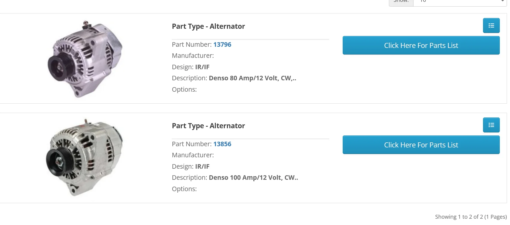

My source for alternator and starter parts. There's no reason you can't rebuild an alternator (or starter, for that matter) yourself; you're just swapping parts. The specifications are in the FSM, which is in the Resources section for free download. ASP had "kits" at one time, but now they're listing parts, so you have to buy what you need from your own list. Not a big deal, the kits were mainly an ordering timesaver. You didn't save/lose any money.

I bought a OEM unit from a bone yard and used this kit
It works well.
