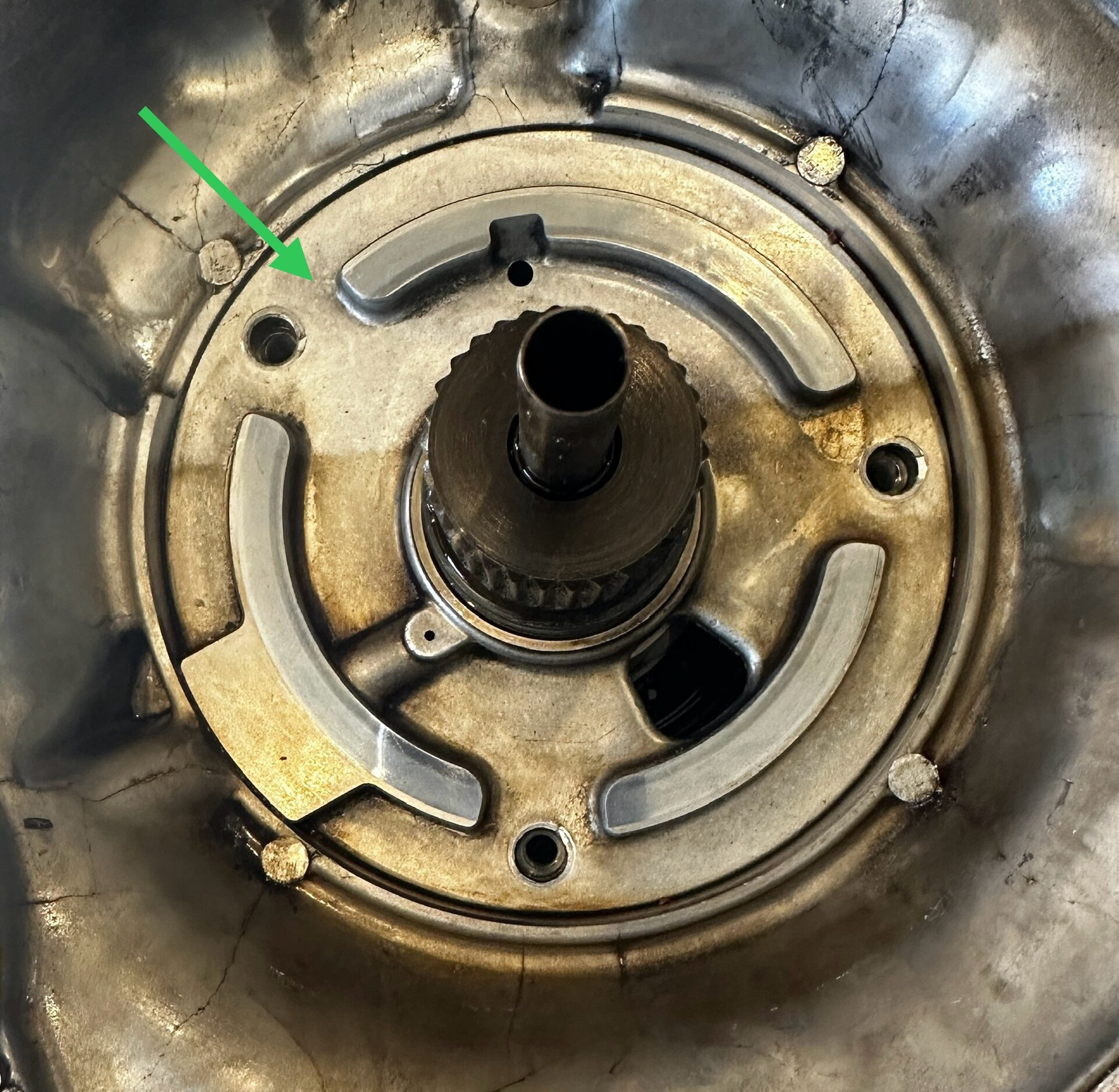

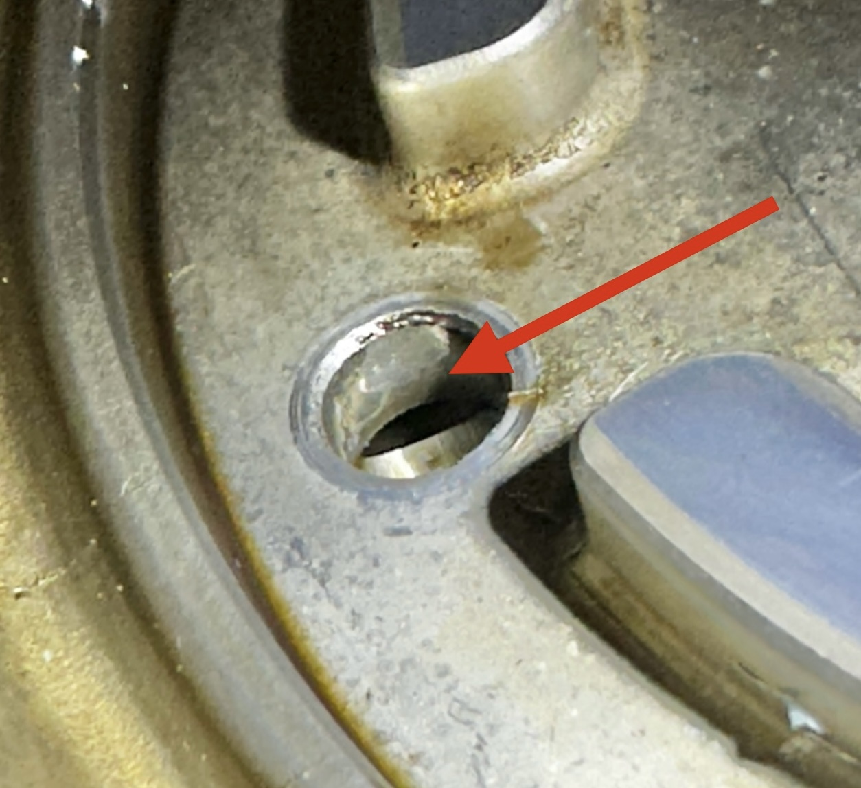

This round cover is a bit stubborn, already removed the three 10mm bolts and it this won’t come off, any other suggestion you can share?
From the part 1 video that George did, the specific plate they were working on had thread on it and he used three (3) M8x1.25 bolts which was used to raise the plate after rotating it a bit same as like popping out a drum brake if it’s stuck. However in my case, that hole is smooth and doesn’t have existing thread to use an M8x1.25 bolt.
Stumped at this point. Any recommendations is greatly appreciated.
