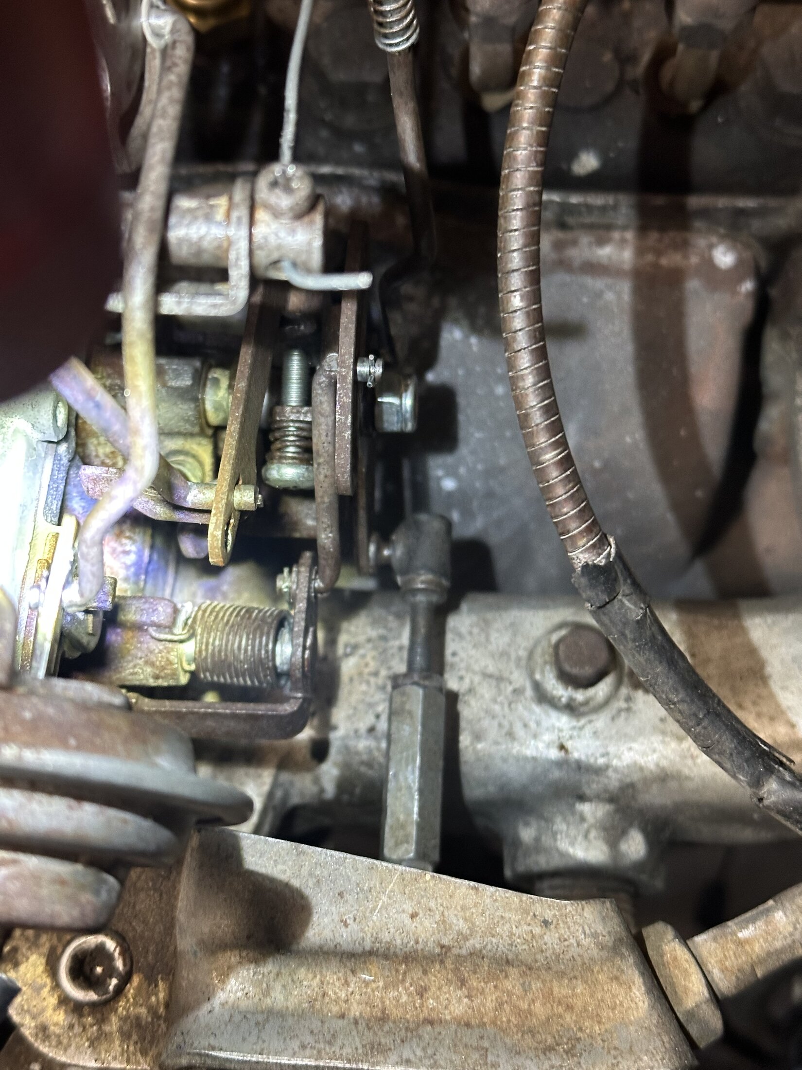

Will do this tomorrow. I was thinking about that episode, and now I wonder if I threw a kink into the accelerator cable back in the cab at the pedal. I say that because there’s no kink in the cable under the hood.
Pighead, I just looked and there is no kink or obstruction in the accelerator cable either in the cab at the pedal or at the carburetor. I’m gonna include photos of both ends. In one of the pics you can see my bright shiny new Idle Speed Screw, too. Does it look wrong?
With the engine off, there is actually a slight bit of slack in the accelerator cable (that you may be able to see). As I move the linkage to simulate the accelerator, yes I feel a positive clunk when the throttle plate closes.
Any ideas? Next steps?

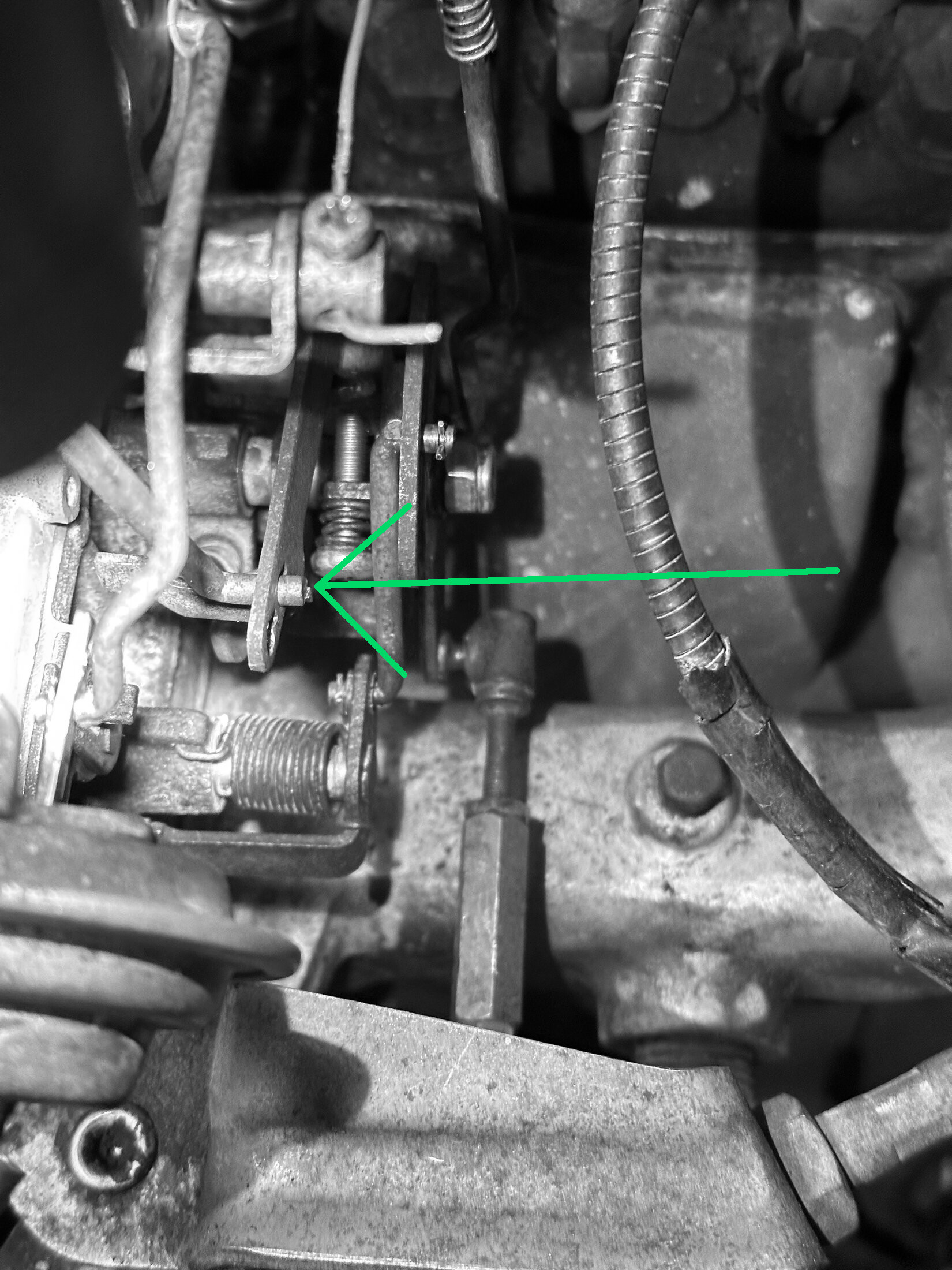

There isn't a hang-up on this linkage, is there. The SOR carb identifier shows the linkage being connected thru the other hole on the 1st idle adjusting lever. A photograph, not top-down, of this area would be helpful. Also, there is a return spring on the bellcrank?
No sir, there’s no hang up. It moves freely. You have got some sharp eyes there! I will move that piece of linkage to the first hole!!

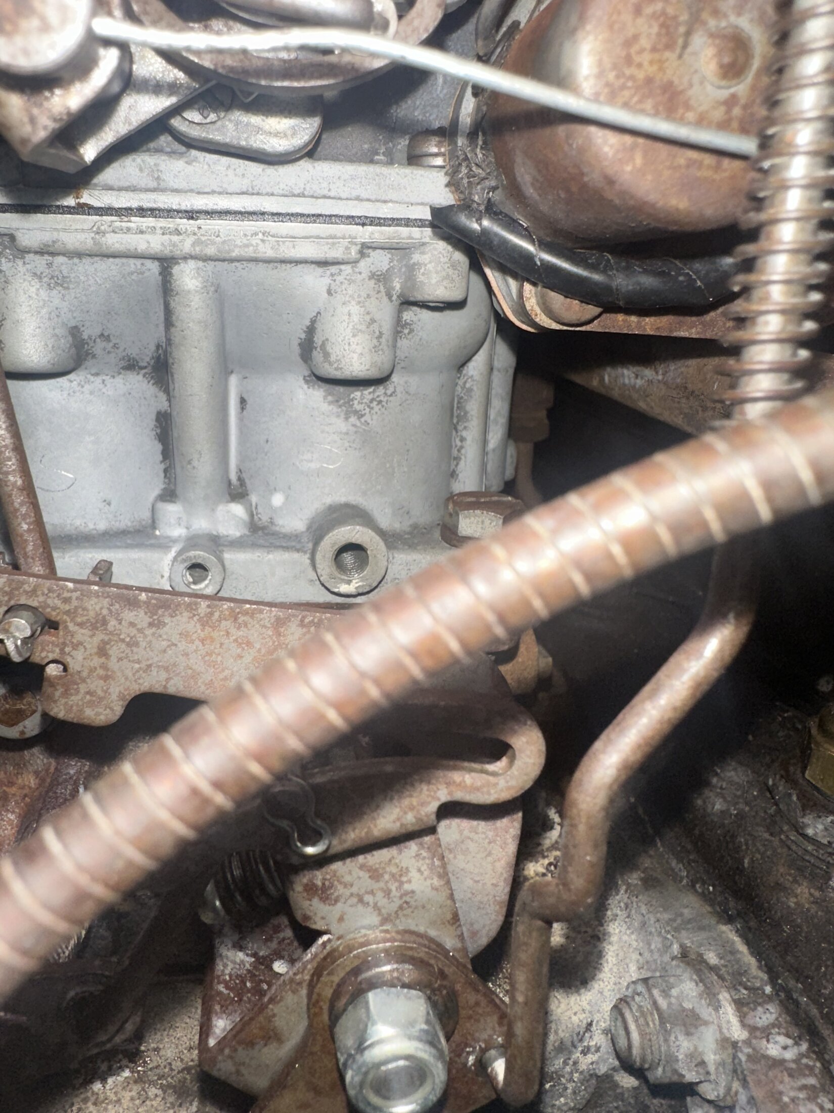

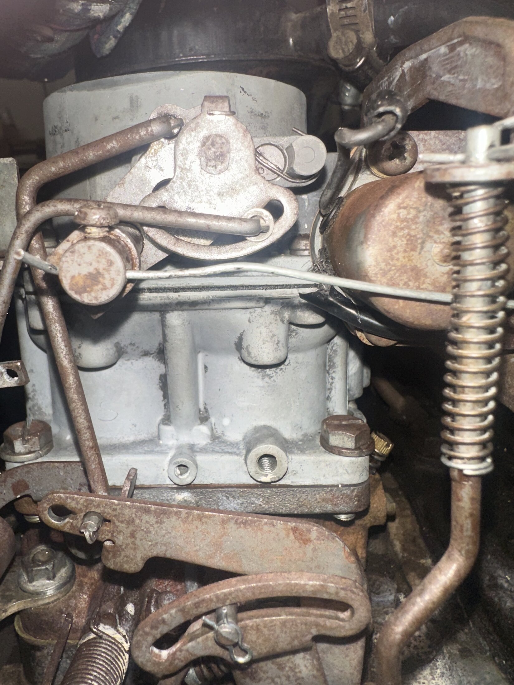

I took a couple of pics from the direction of the firewall that I will attach.
Also I’m not sure what a “bell crank” is, but I have a return spring on the forward end of the carb. I’ll get a pic of that also.
I really do thank you for your insights. I had about run out of ideas!!
Grayscale
I’m getting my hopes up. When I moved the linkage to the correct hole as you discovered, the carburetor innards shifted a bit. Unfortunately, I have my distributor pulled so I can’t fire it up right now but I’m encouraged!! Just wanted you to know.

I'm fairy certain that the linkage you adjusted is the fast-idle setting for when the choke butterfly is closed, or somewhat closed, but, it is too extended and it is affecting the choke-opened position. This linkage is probably keeping the engine racing, and unaffected by the idle speed screw setting? I see the return spring for the bell crank (the throttle cable / carburetor attachment).
