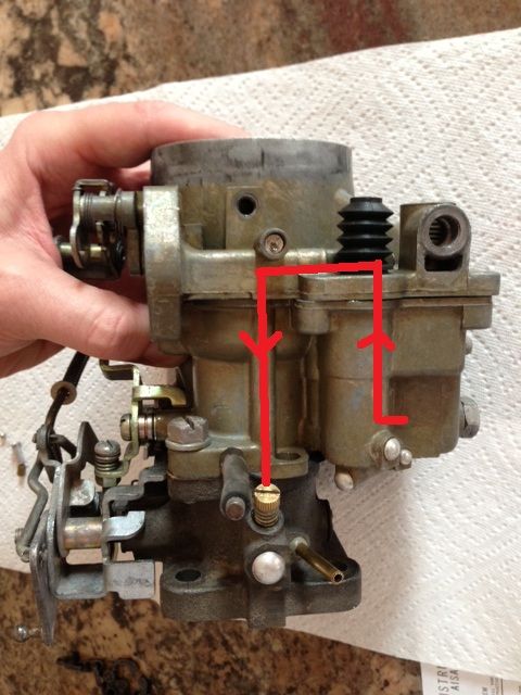

I am working to diagnose an idling issue on my trail rig and am fairly convinced that the idle circuit has a blockage somewhere. Can someone help explain to me the routing of the idle circuit from start to finish? Carb is a December 1969 production 2-barrel Aisin. Idle mixture screw will not kill the engine when fully turned in.
As far as troubleshooting goes, I have checked and removed the idle mixture screw and looks fine. I have tested the solenoid and it clicks and works fine. Vacuum is 14" hg at 7,000' elevation. I know that is a little on the low side, but I still don't think that the idle fuel should be non-existent.
See attached pics and let me know if I'm moving in the right direction.
It is hard to detect, but if someone has previously closed off the idle mix screw way to hard, it can damage the seat/casting that the needle fits into. Then it will never close off completely. I have come across this twice over the years. If you take a can of carb cleaner with an extension straw and blow it into each passage way then you can tell where they go and if they are/are not open. John
The reason you can close the idle mix screw all the way without stalling the engine is because your idle speed screw is set too high which opens the primary throttle plate far enough to pull fuel out of the transition slot, which is immediately above the idle fuel port and connected to it. The typical reason for this is that you have a manifold vacuum leak and need to increase the idle speed to compensate for the vacuum leak.
Take a peek inside with a flash light and I bet you will see fuel running out of the transition slot. This condition is also typically associated with bogging down off idle because there is no fuel left at the transition slot when you open the throttle further.
Thanks much, guys.
So I assume that the attached picture is correct in regards to the location of the transition slot? Pinhead, you are spot on about bogging down off idle. Is the purpose of the transition slot to deliver fuel during the transition from idle to throttle? Should be slot be covered by the throttle plate at idle?
If I adjust the idle speed screw so that the throttle plate covers the transition slot, wouldn't I be back to square one because the idle fuel port is not delivering fuel? It seems that it should be delivering idle fuel through this port even with a vacuum leak?
Also, where does the transition slot receive its fuel? Separate from the idle circuit?
1. Yes.
2. Yes.
3. Yes
4,5. The idle port does deliver fuel all the time. It just isn't enough fuel to let it run with the air leaking in because of the vacuum leak has no fuel. When you open the throttle plate the manifold vacuum drops, slowing the rate of air leak and now more air is going through the carb and picking up fuel from the transition slot.
6. The idle port and transition slot are connected together as part of the same hole so they are both part of the idle circuit and get fuel from the same place. The idle port is the end of the line and the slot is upstream. That is why you can shut off the idle port and it makes no difference because all the fuel is coming out of the slot.
7. Fix your manifold leak and you will notice the difference in performance.
