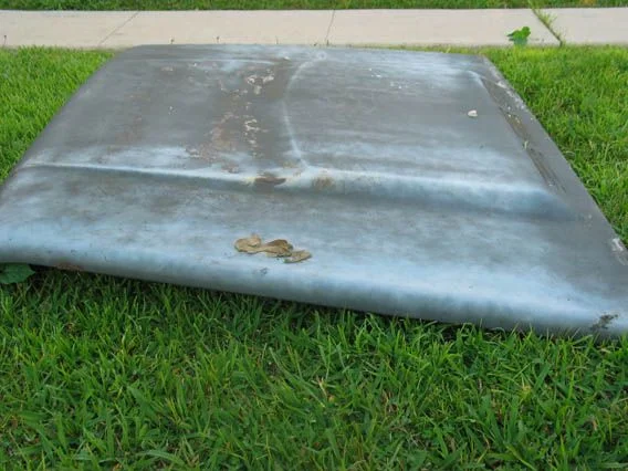

Why does the later hood have more clearance?
see the bump?
Yes I see the bump.
No on answered the other question. How much room do you need for the snorkel set?
