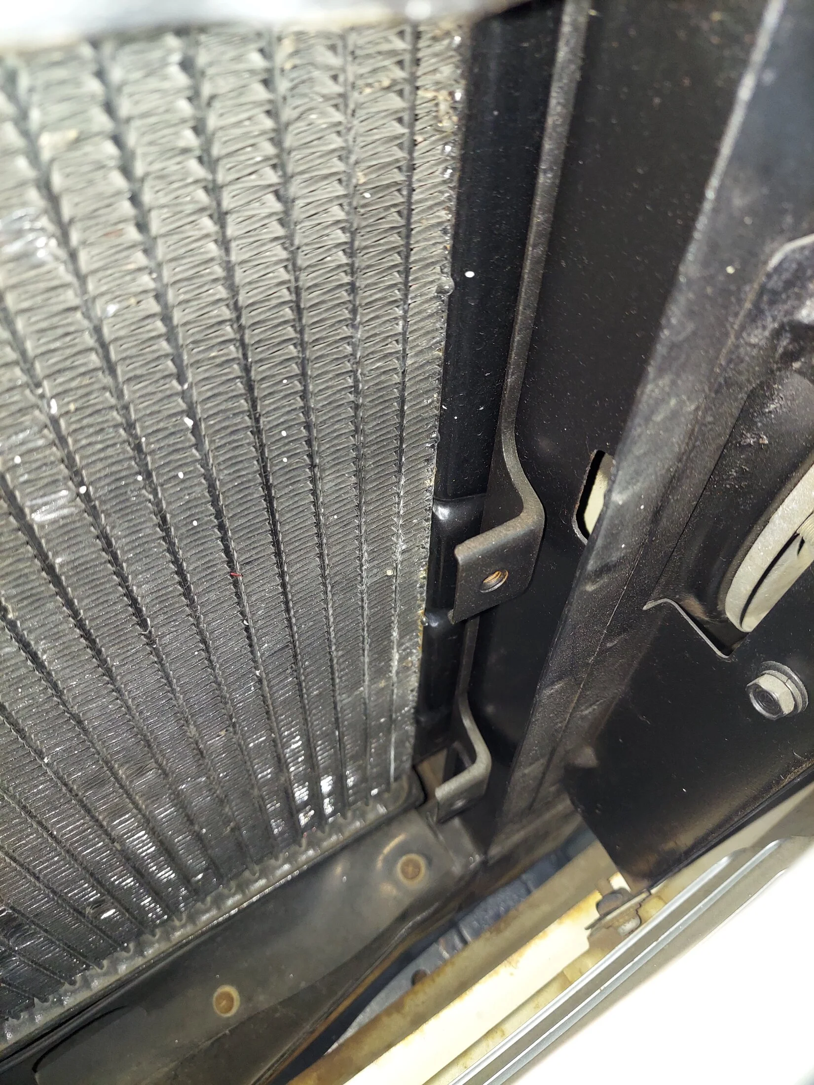

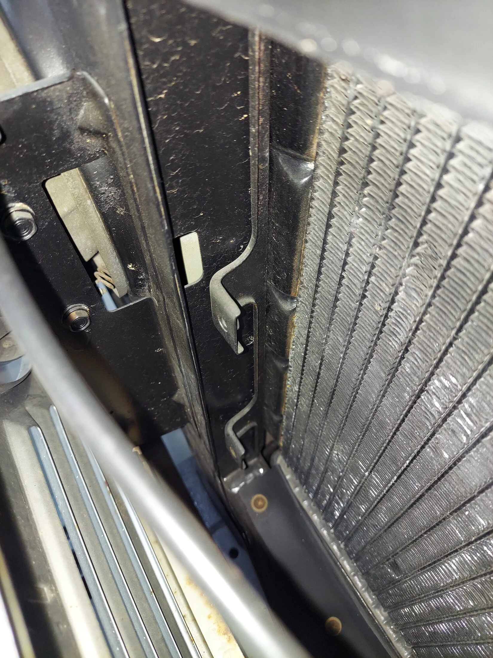

Figured it wouldn't hurt to post up the question. Looking for this pair of brackets. They would have been found on FJ55s with factory (dealer installed) A/C units. The backside are sandwiched between the radiator and the core support and the Condenser mounts on the 4 tabs. Here are two photos of the brackets with the Condenser missing.

Based on Dan's post in my build thread, those brackets were apparently specific to Australia. To be honest, I don't think they would be very useful. Just buy a condenser with mounting brackets that fit the radiator vertical core supports and make sure the body of the condenser fits in between the core supports. Drill holes for the mounting brackets and use a washer and nut on the backside or install nutserts and just use the bolts - which is what I plan on doing.

Yes I thought the same thing about mounting the condenser, I’ve never seen that bracket it sure looks OEM nice, Thanks for the your information
