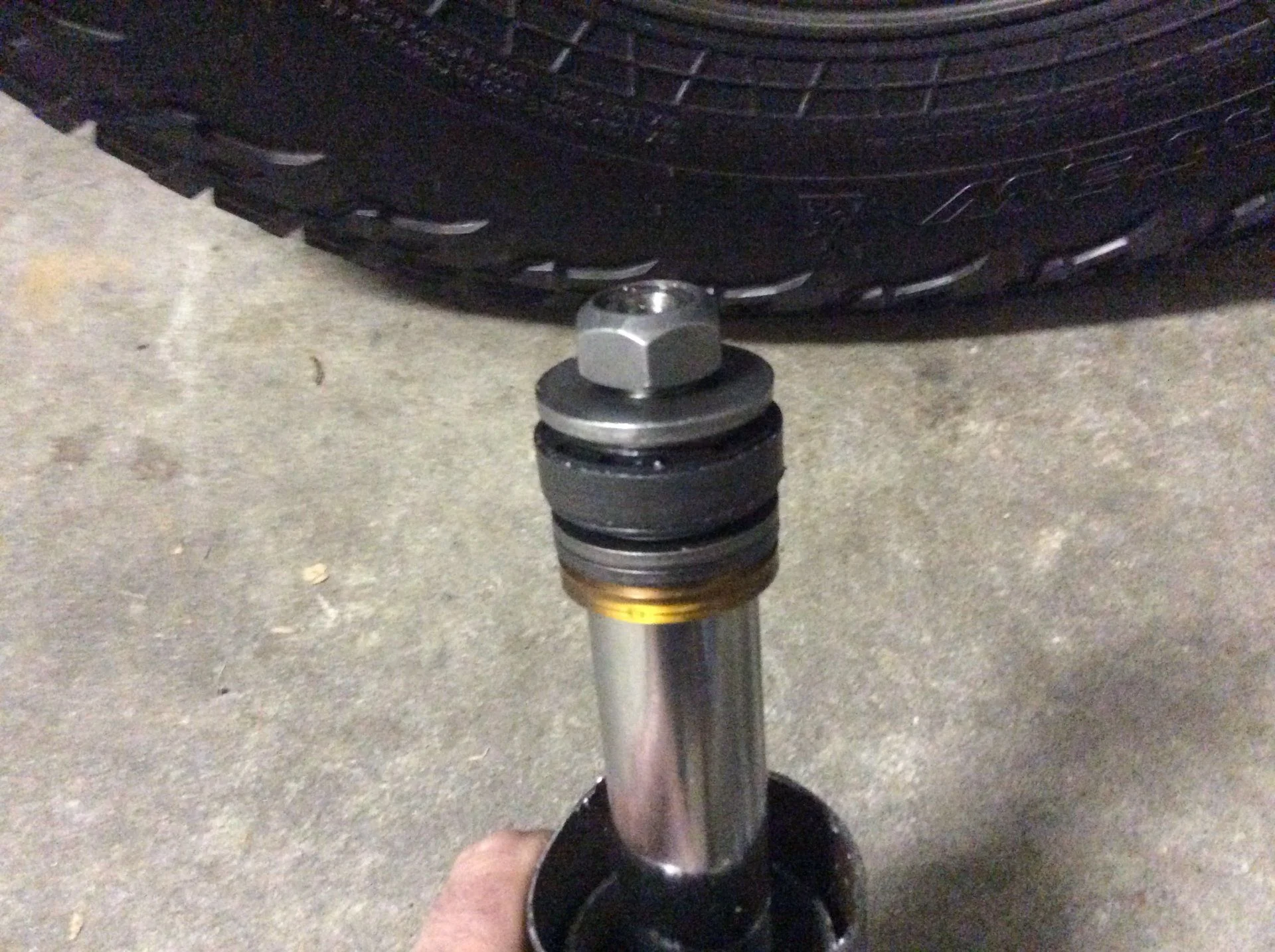

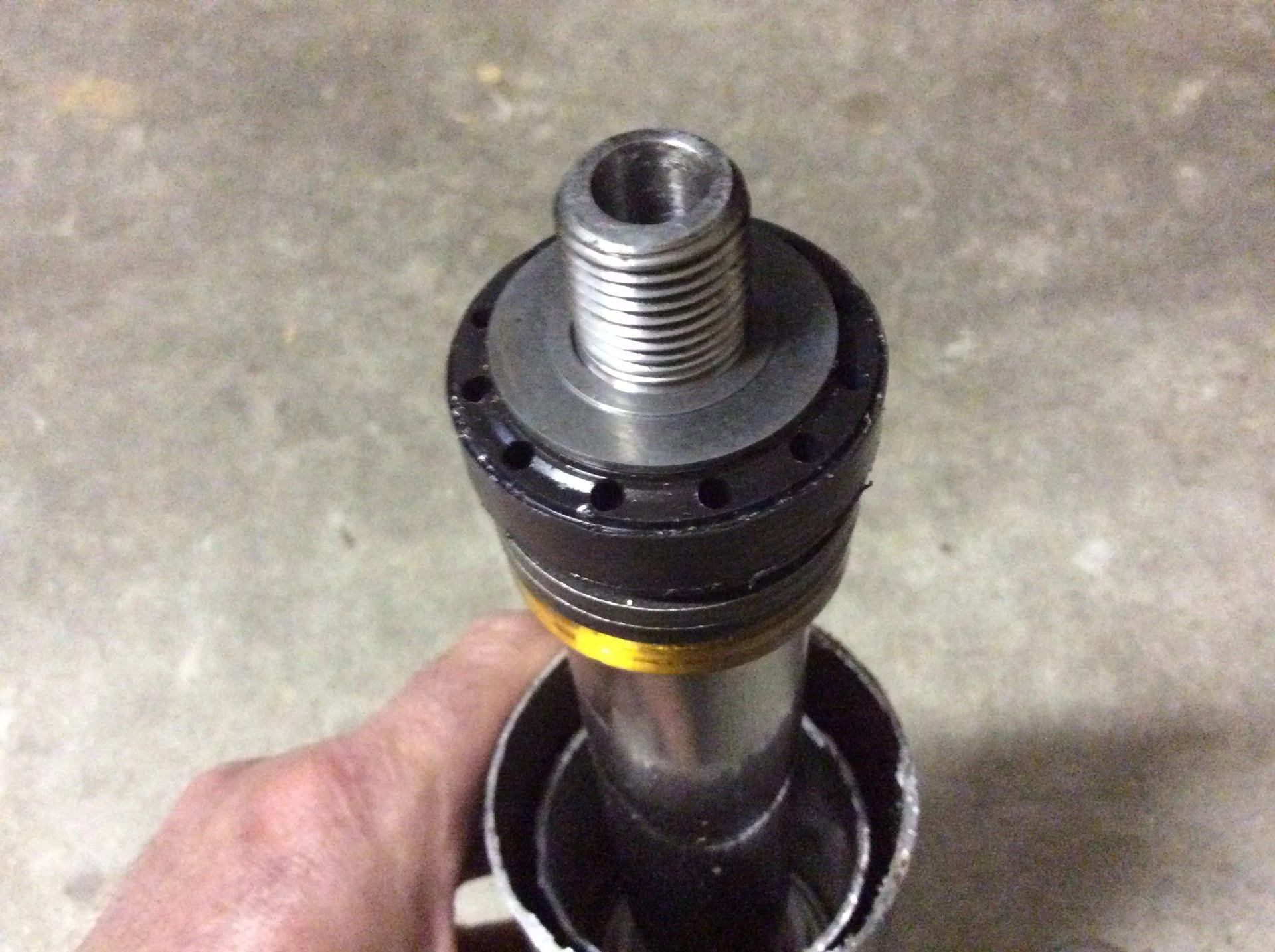

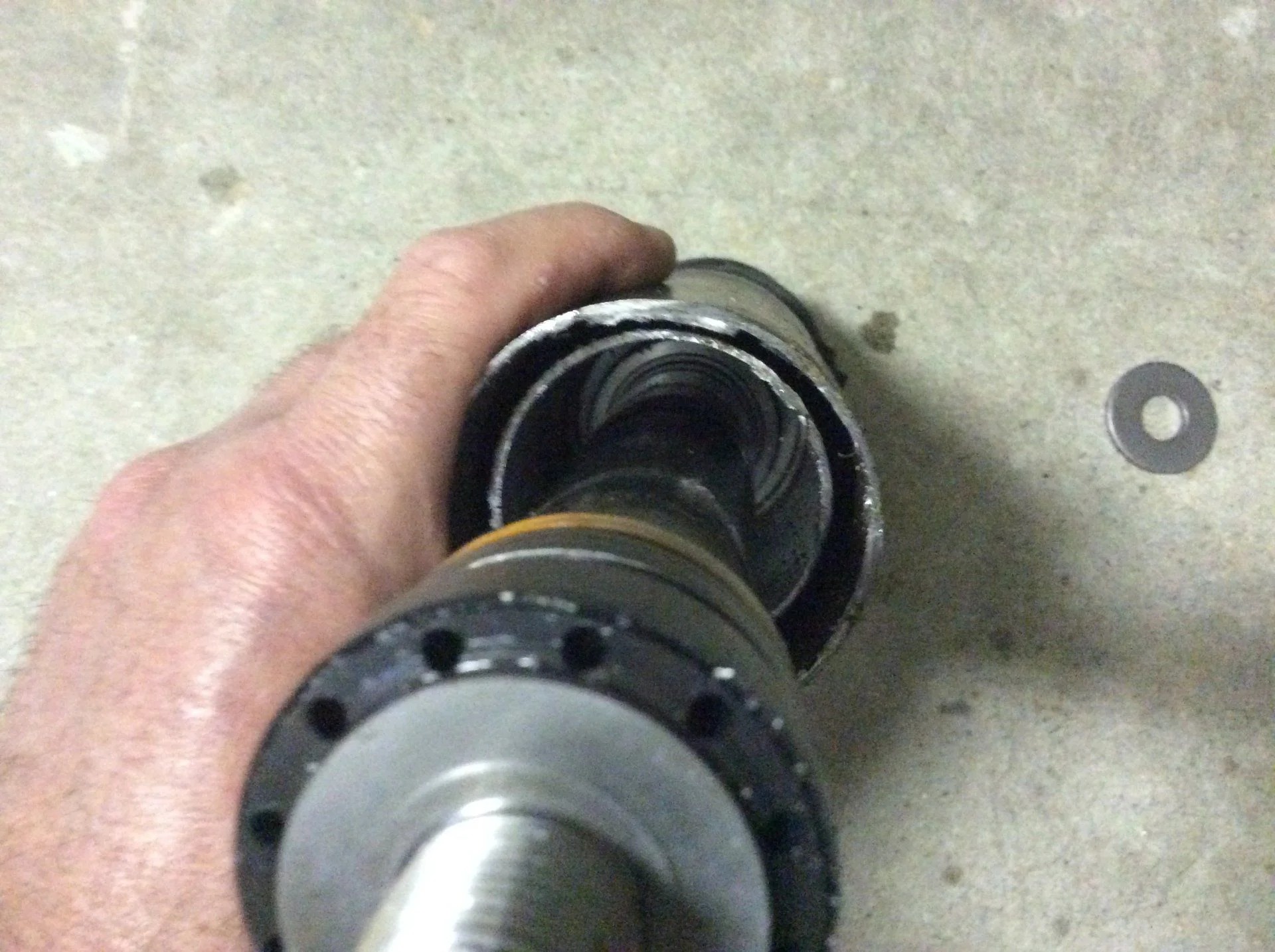

I’ve some photos of a shock actuators internals if you’re interested. They are just a free bleeding multi drilled piston with what looks like a progressive style stacked disc arrangement working in a inner liner cylinder tube that’s separate to the outer structural shock body tube.
It’s in Lexus’ hands again for now but I’ll let you know what happens. I would be very interested in the pics of the shock internals.

Here’s what the piston and valve stack look like. Front actuator, upside down and the inner tube cylinder (that the piston strokes in) is completely removed. The retaining nut isn’t lockwired or loctited so it’s not impossible for it to loosen I suppose. Regardless, changing shock actuators didn’t correct your suspension related noise so it wasn’t that.
^^^^^ Wow, that is a really robust design. Did not expect to see such substantial internals.
Thanks for posting.
I can now easily understand why they are fairly expensive.
Thanks for posting.
Agreed, the hydraulic elements of this system are of very high quality and robustly engineered. Toyota didn’t skimp on this platform and it’s active suspension at all. Having spent close to three decades in military servo control/hydraulics and related fields I’d comfortably compare the overall quality of engineering design and build to mil spec equipments. It just needs a little basic routine maintenance, like any system.
