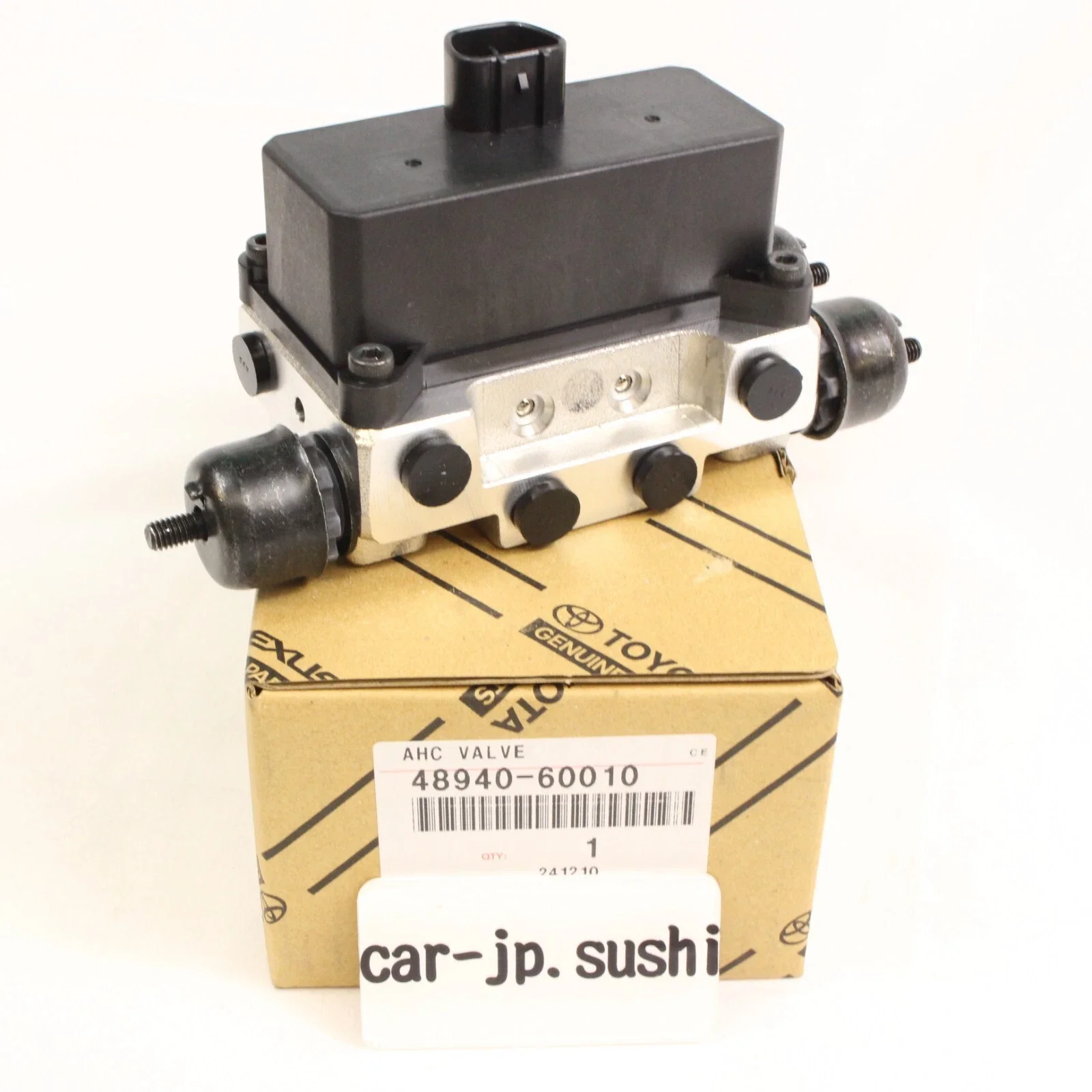

I would bet the valve assembly is allowing fluid to pass. When it pressures up to raise the suspension, these valves should close to keep the pressure/fluid in place. I’ve been eyeing this repair and part to avoid being caught with the part no longer available. I don’t have an issue just yet, but I’m certain this will eventually be a problem. We can’t expect those valves to seat and seal 100% after 20 years of use. Note that this is just a suspicion, not definitive. Here’s the part:
TOYOTA LEXUS Genuine Valve ASSY Height Control No.1 48940-60010
