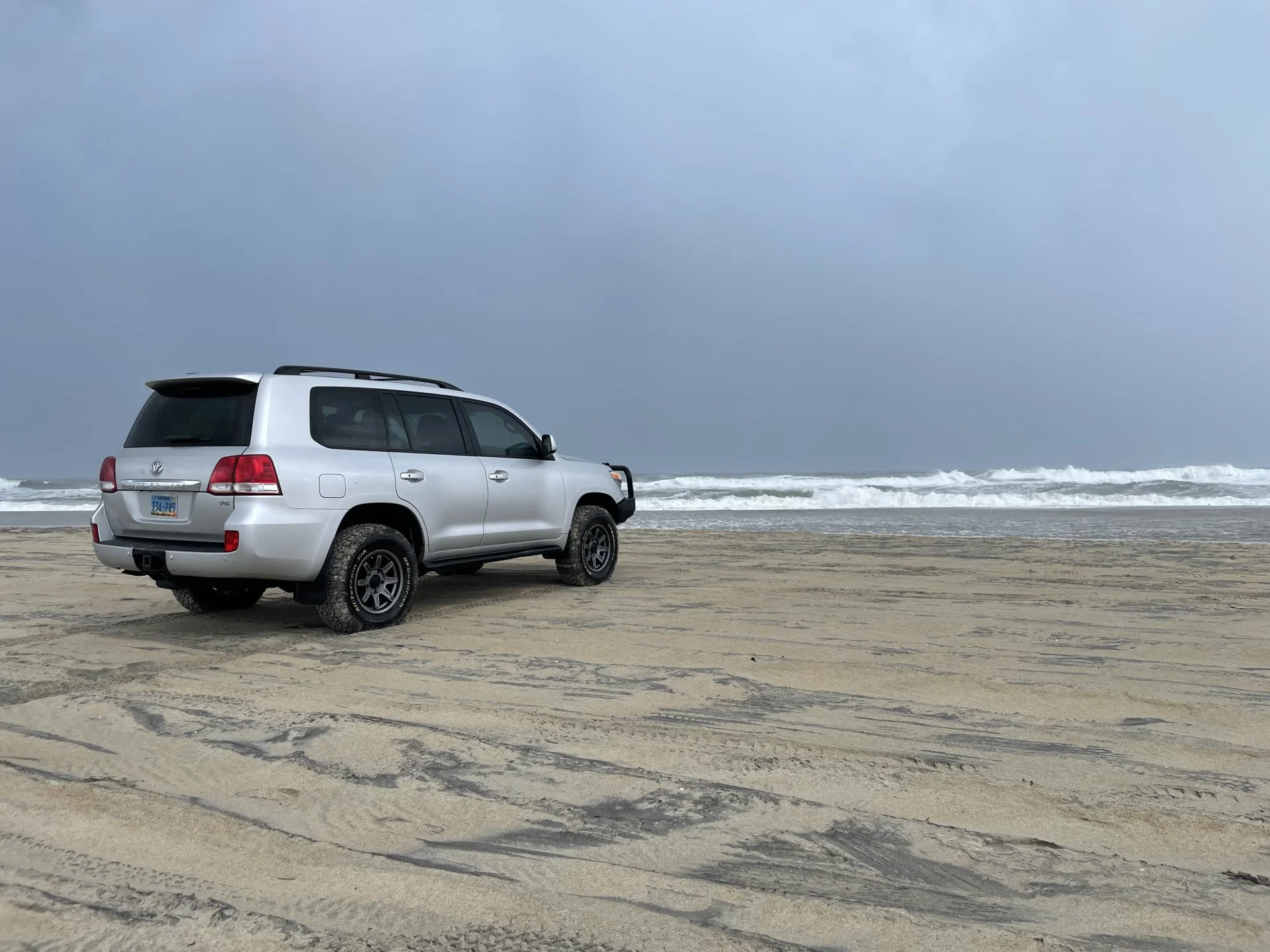

I put FN FxPro wheels on my truck in 18x9 with +25 offset. Running 305/65R18 KO2s with a lift and super happy with them. I went with matte black, but they are available in a couple other nice looking colors, and I think there is also a 18x8.5 +20 option.

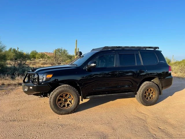

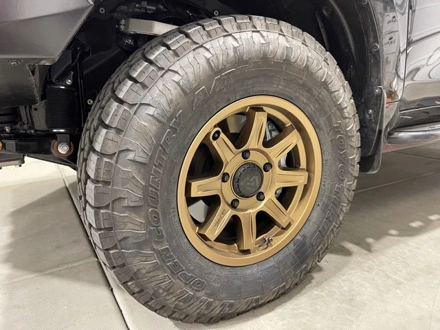

Icon Vector 5
  • 17in diameter, 8.5in width, 25mm offest
  • 30pounds
Toyo open country AT3 285/75/17
Only had this set up for a few weeks but loving it so far! More details on making it all fit on my build thread: 2016 LX570 Air Down Gear Up build - https://forum.ih8mud.com/threads/2016-lx570-air-down-gear-up-build.1263324/

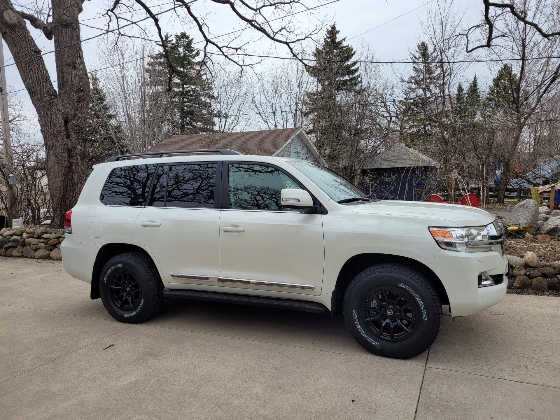

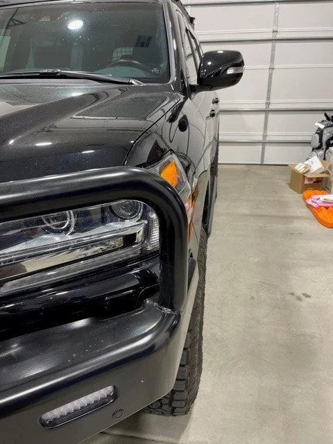

Alpha Equipt offers great fitment for the LC200. I am running the Command in 17x8.5 +35mm.
Did not know about that one thanks! This is just about as good as it gets for offroad focused builds.
I would LOVE if you could get us a pic dead on front tire profile. We do not see enough +35s.

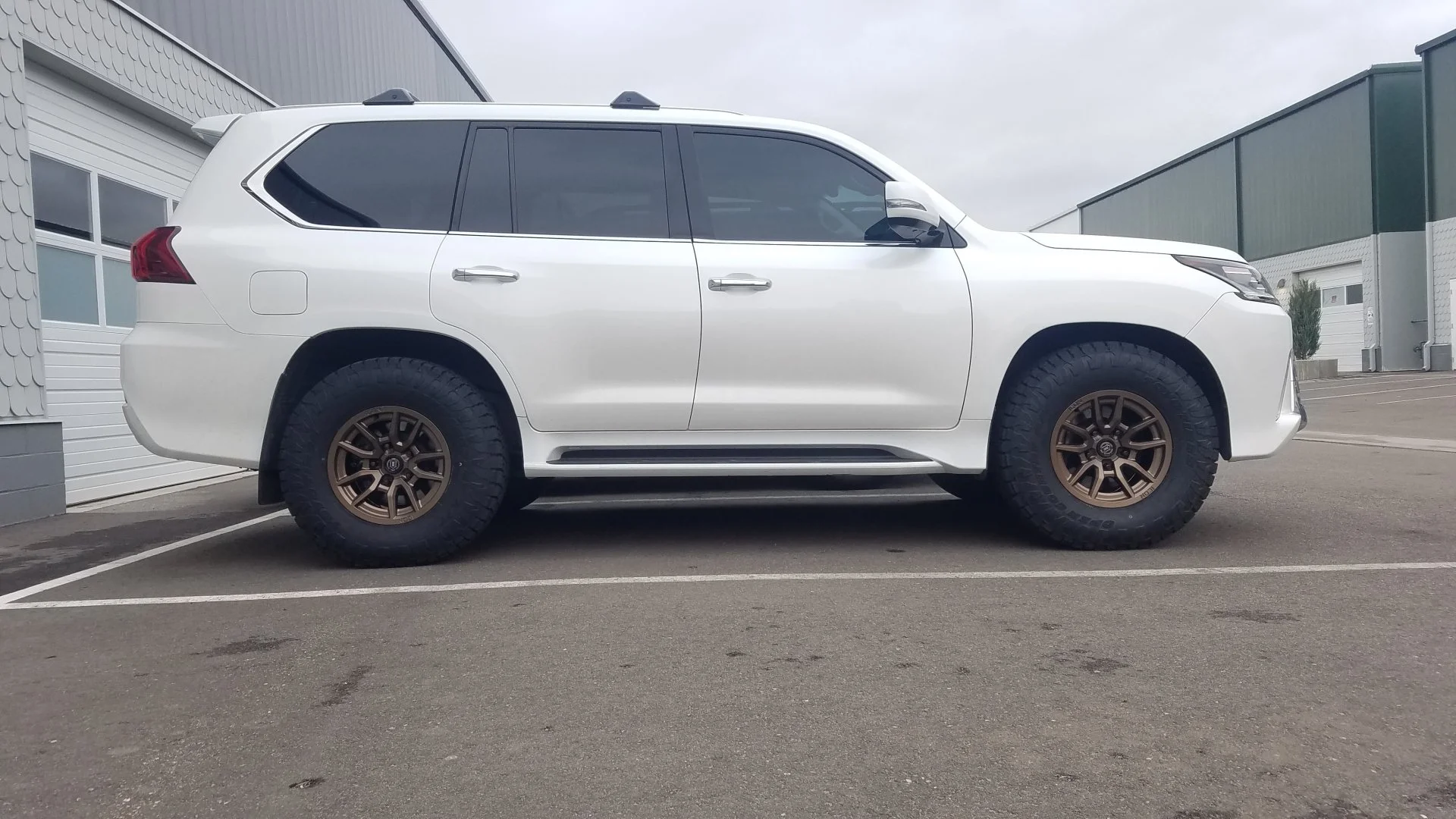

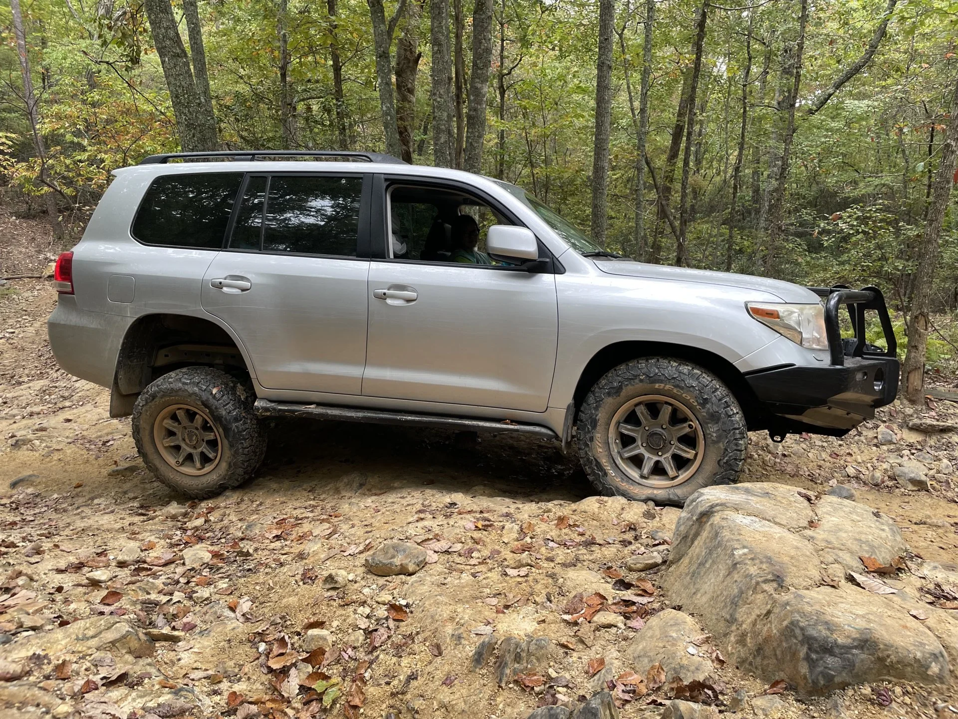

Here are the alphaequipt command 17x8.5 in the +15 offset. They’re just proud of the fender. The grey is on close out on tire rack for $158 right now. I went lower offset to get the tire out of the swaybar on the RF corner, but did have to massage the front mud flap with a heat gun running 285/70/17 KO2s. A +25 offset would probably be a happy medium, if it were available. Other than the front mudflap I’ve had no rubbing at full stuff front or rear.
Looks great. I just ordered 3 of the +15mm wheels a few minutes ago to put on trailer.
I don't have any rubbing at all with the +35mm version and 285/75-17 AT3s.

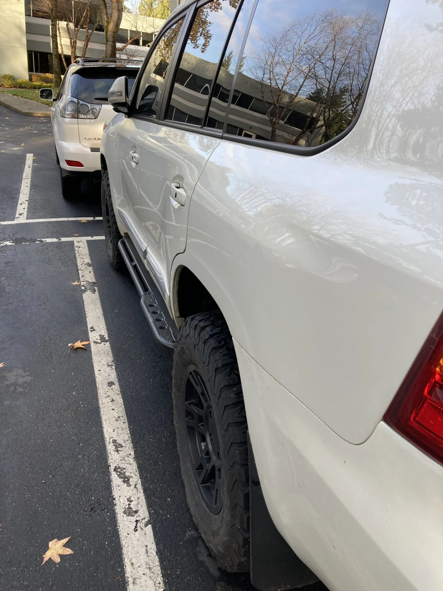

I bought 5 of these about a month or so ago on Tire Rack. I paid $177 each. I just had them mounted with new tires. So far so good!
