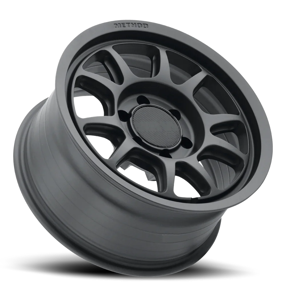

Running Method Vex 17x8.5 0 offset on KO2's installed by PO with King 2.5's SPC Uppers & adjustable rear panhard. Love the look of the set up, nice poke but mud flaps removed and some trimming. As much as I love the look I am going to do to a better offset for better function. The new Method 703 trail series wheel 17x8.5 BS35 looks really nice & clean but out of stock. Will likely wait for it. Seen lots of Icon Rebounds but anyone running their Compression wheel? 703 | Matte Black - https://www.methodracewheels.com/products/703-matte-black?variant=33034699243581
I'm torn between getting more Rock Warriors for my trailer or to wait for the 703's and swap everything over. Method said August for the 703's. We will see if i have the patience.
August, Dang! Think I'll still wait. They do have them available in gold in correct offset now but...yeah gold wheels :( Saw a set in person today on a black truck & they seemed pretty nice. Would prefer Method over Icons.

Anybody running the Method 703's yet? Any pics? Curios to see offset pics. Will be coming from zero offset and want to pick a set up. They are still on back order.
Also plan on getting them once off back order. Last I heard was august.
I just tried to order bronze 703's in 17" ET35 and was told 8 weeks. Bummer. I'm reconsidering Icon Rebounds at the moment.
Same delima here but considering Icon Compression. Really want to see pics of the 703's poke before waiting another 8 weeks. Would prefer 25 vs the 703's 35 offset however I prefer Method wheels over Icon, no fake bead lock & the gimicky "internal beadlock" sounds interesting. I did speak with the guys at Icon & they said they sell or you can paint the fake bead lock gold screws on their wheels. I replaced the ones on my Method Vex wheels with black studs & they look way better.

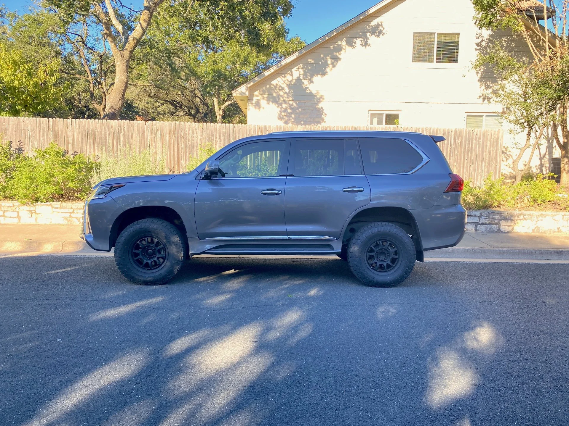

@ 23.5 lbs MR313 is the lightest 17" here with adequate load capacity. Now discontinued. I have a full set of 5.
With my LT 285/70r17 C Toyo AT IIIs on im just about at OEM fitment weight (80 lbs) and that keeps AHC happy.
Handling is solid but if these were at +35 ET it would be the GOAT wheel IMO for this use case.
Heres a better pic:

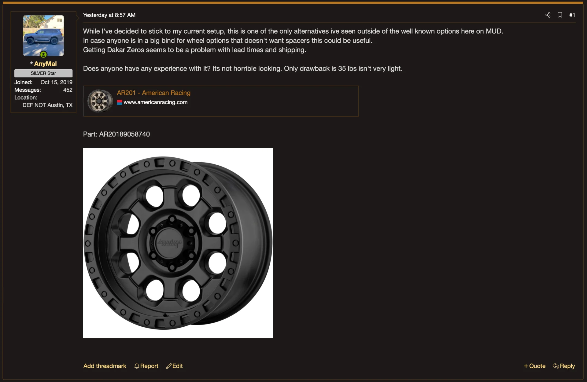

By the way i had made a post and didnt realize i should have put it here for those in search of wheels.
For the offset susp geometry purists, this is the only other suitable +40 wheel i was able to find anywhere.
If your upsized and lifted, this is about as good as it gets in aftermarket offsets.
(Just disregard that thread)
