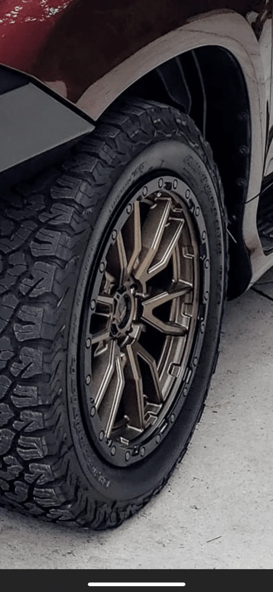

my rims were 20x9.5 et 0 btw... with the tundra front I had to use spacers in the rear to match the stance.
ET55 if the markings on the rims are any indication ;)
There's a bit of rub at full lock on the front UCA and KDSS bracket with the tundra swap and these wheels. I added a 1" spacer up front after getting the truck from Erich to eliminate the rub. The fronts don't quite stuff, but on the few times I've rubbed the fenders I've been going way too fast for the road conditions. I'm considering taking the spacers off, because the way too fast bit is only going to get worse:

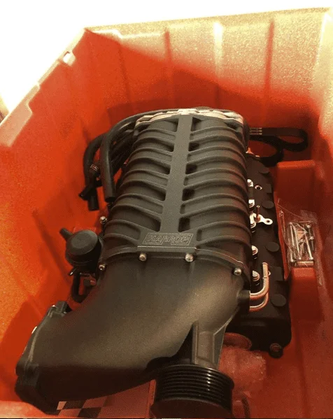

I had a cts-v wagon with a roots blower on it.......MAN did it get crap for mileage. If I dogged it got 9 MPG, if I babied it it got 13. How much do you think this will affect your MPG?
On the positive side, at 60 mph on the highway in 4th gear, I could stomp on it, and all hell would break lose (MAJOR wheel spin, even with super sticky tires). That thing looks like fun!
🤷🏻‍♂️ There’s a reason I got the aux tank first though...
I’ll post more details after the shop finishes getting it on, for sure.
oops - confused the specs with the current ones I've got on the wife's car !.thanks Edward.... can't wait to hear how it all comes together once the blower and tune are done...... !! Are you going to do a snow's kit or anything else while in there ?

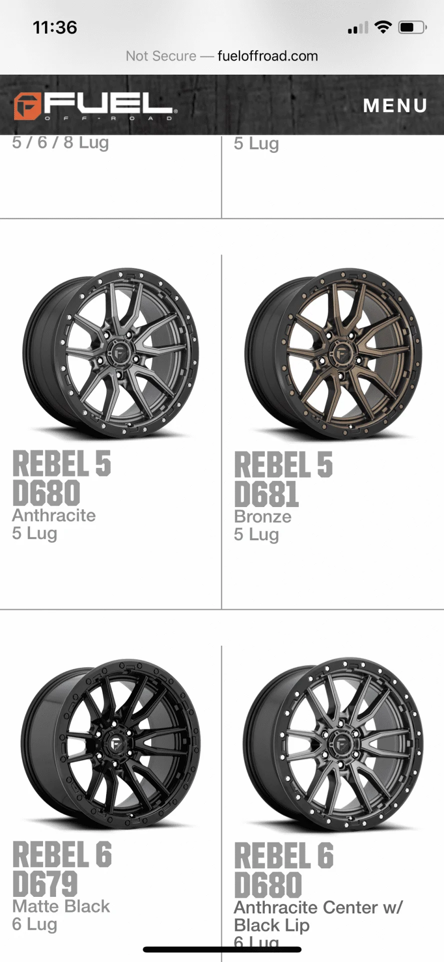

Has anyone run these Fuel Rebel 5 Wheels on a 200? they are 18x9 with a 1 or 20 offset. I'm highly interested in getting a set for the white 200 I'm pickup up saturday morning. I have had 4 LC/LX’s, but this is my first 200. Super excited!! I don’t plan in doing an suspension work anytime soon as it will be my wife’s Daily driver for a few years. I am thinking a 285/65/18 ko2 or 275/70/18 KM3 or ko2
On the 18" option, the weight rating is only 2300lbs
The Load Rating of the 18 x 9 5x150 wheels is only 2300 pounds - too low for use on a LC200 IMHO. I would recommend a wheel with a Load Rating of at least 2500 pounds which is about what the Load Limit is for stock P285/60R18 tires.
gotcha. bummer. Thanks guys!
