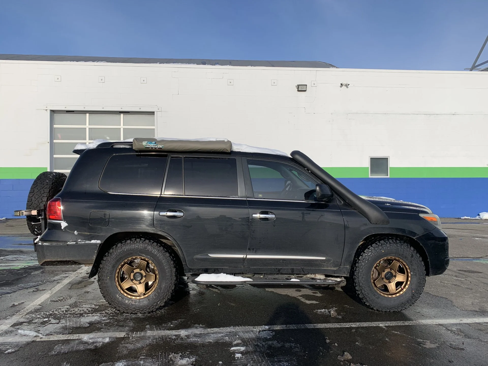

Alphaequipt Echo in bronze

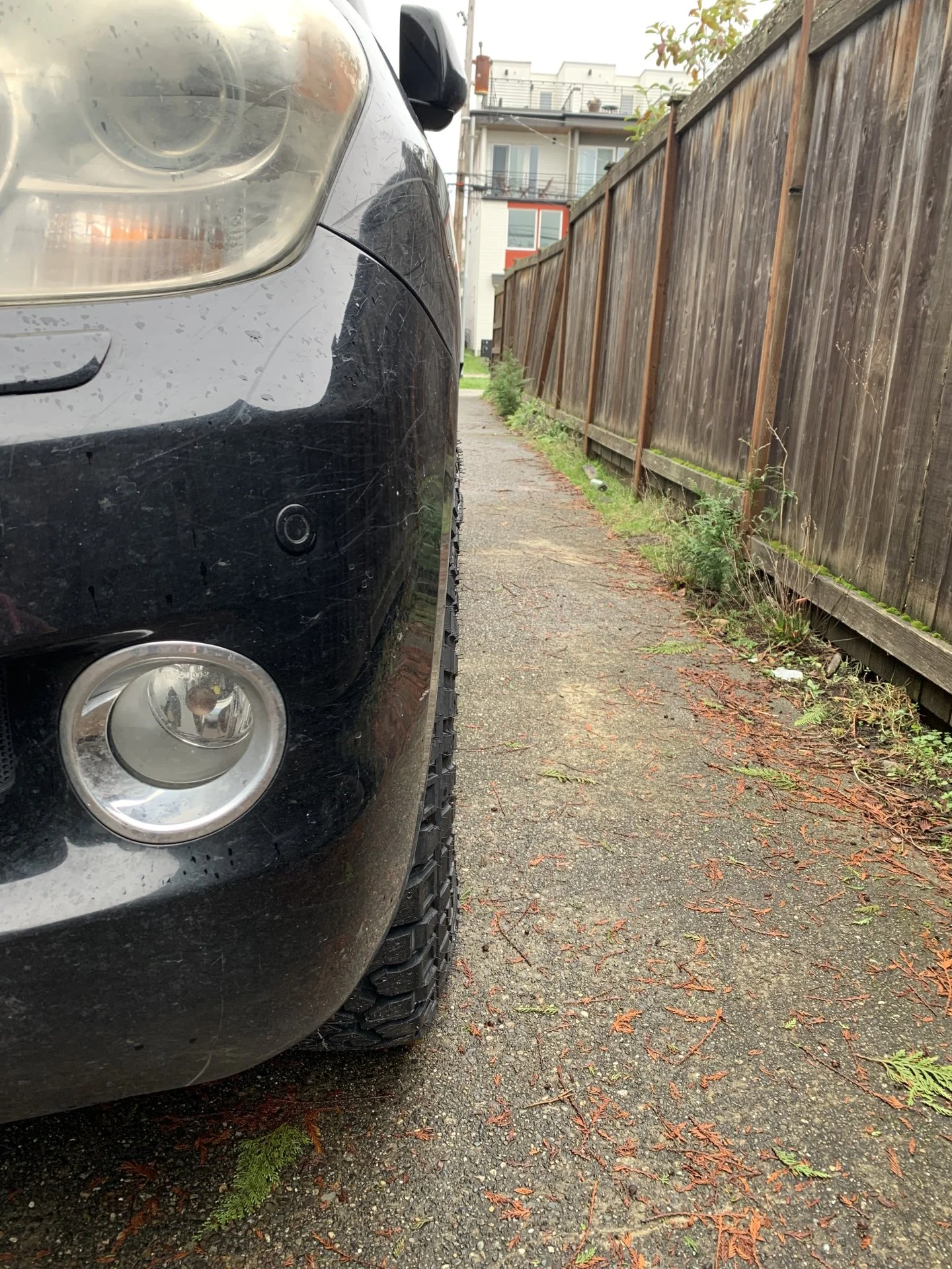

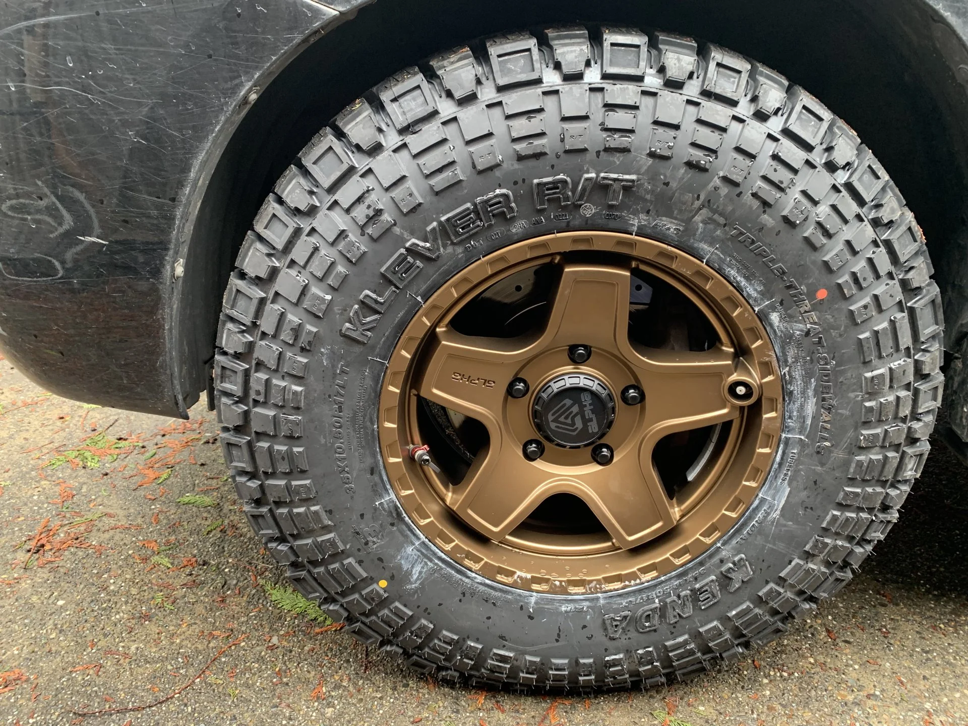

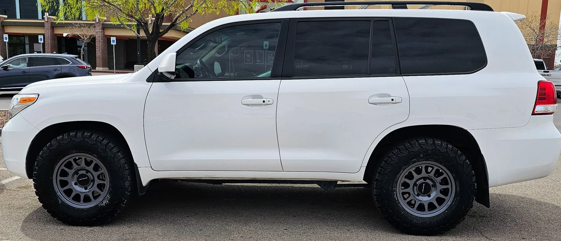

17” 8.5 wide +35mm
Kenda Klever 35x10.5r17
Flush with fender.
Super late getting this post up- had em for 4 months already.
The McGuard lugs won’t work. Need extended thread conical lugs.

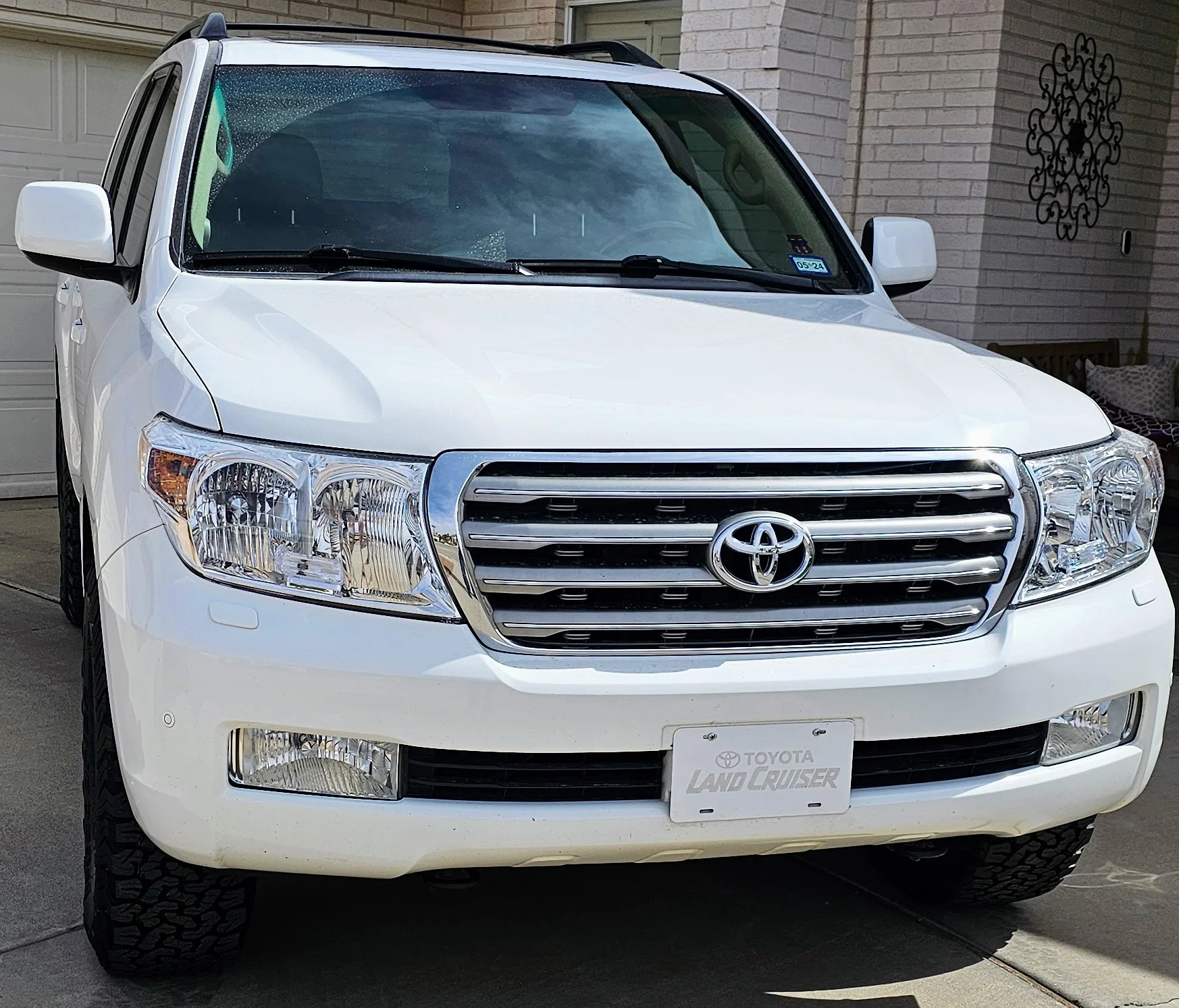

Here are the alphaequipt command 17x8.5 in the +15 offset. They’re just proud of the fender. The grey is on close out on tire rack for $158 right now. I went lower offset to get the tire out of the swaybar on the RF corner, but did have to massage the front mud flap with a heat gun running 285/70/17 KO2s. A +25 offset would probably be a happy medium, if it were available. Other than the front mudflap I’ve had no rubbing at full stuff front or rear.

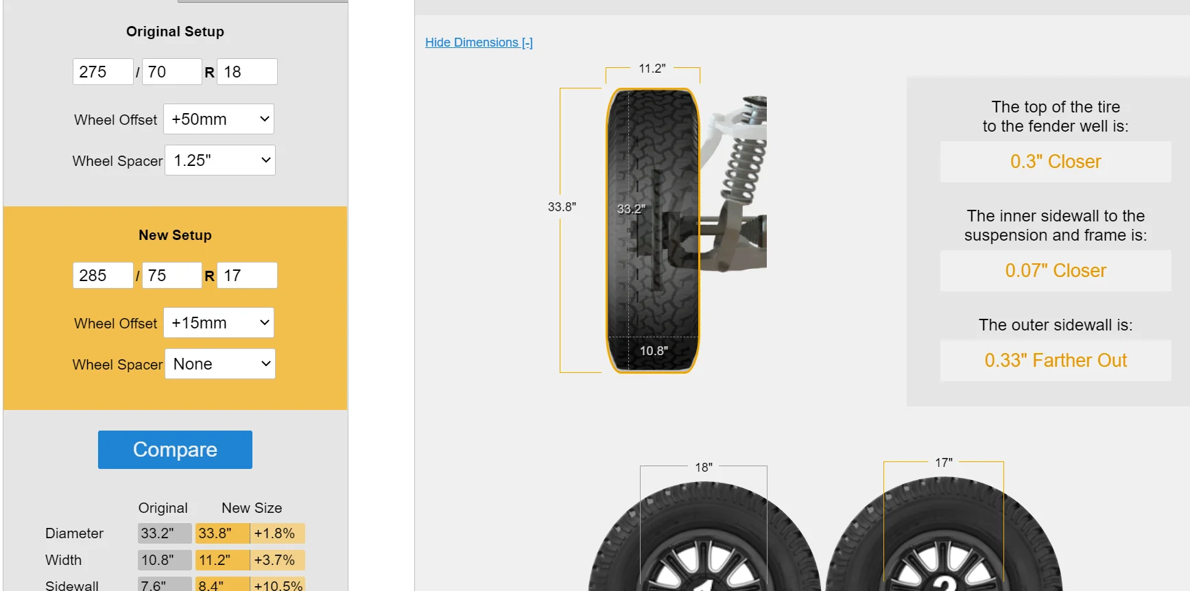

Ok, you sold me. was looking to move to a 17 and saw the tire rack deals happening right now. Was nervous about the +15 offset, but seeing you and doing some calculations using the offset calculator, it seems like I am going to be about the same as I am now (or where most are with a RW with a 1.25 spacer).
