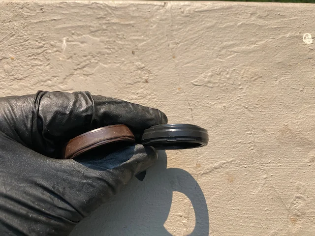

I replaced the leaking valve cover gaskets (and installed new tube seals while I was at it)

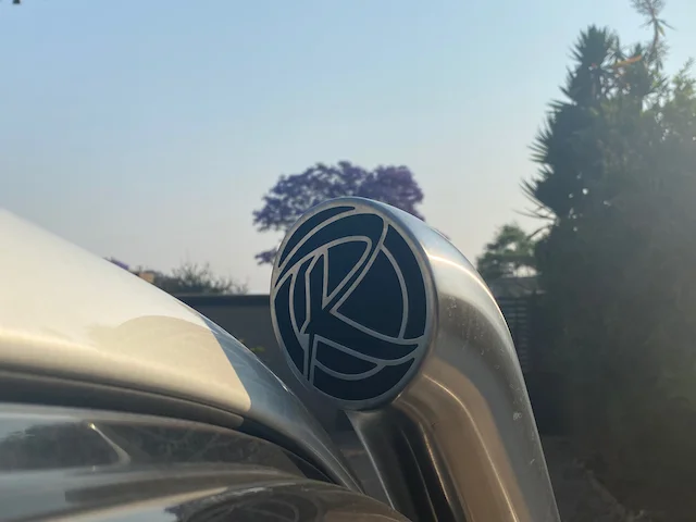

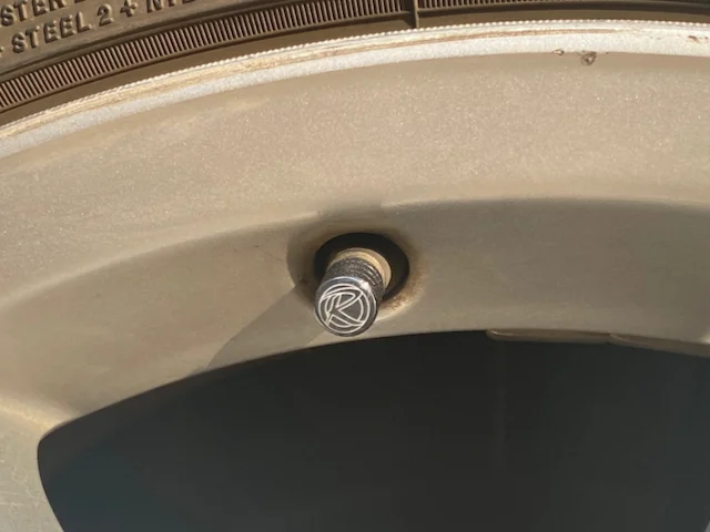

And I (finally!) installed my Fabulous Fabrications snorkel
The snorkel grill has a custom-made logo in the shape of an "R" (this LC is named "Renegade")
The logo appears in a couple of other places too...

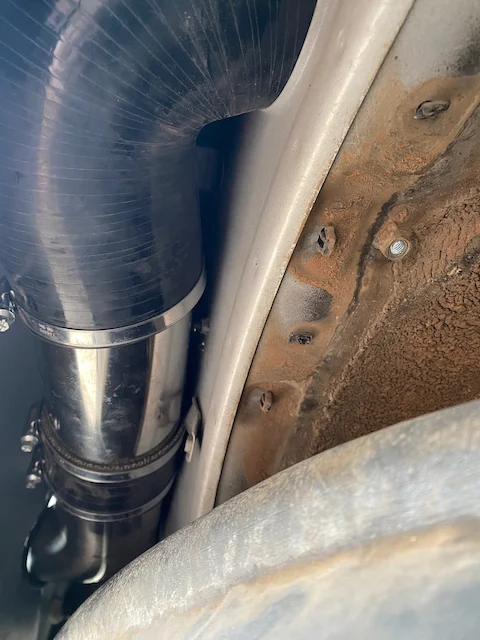

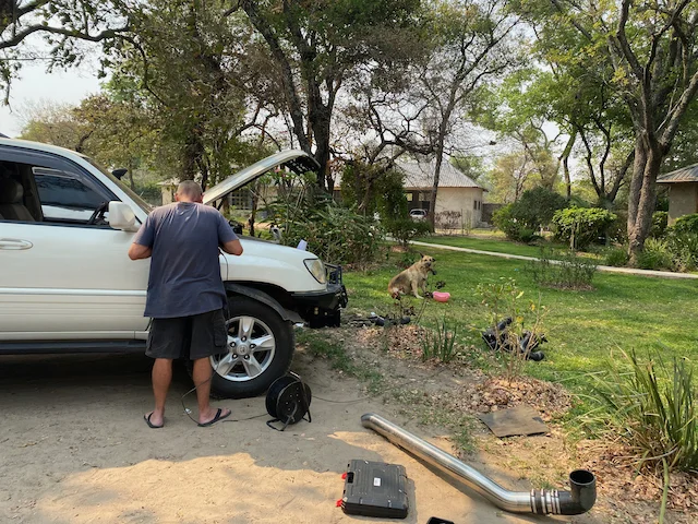

Zimbabwe has a lot of toll booths. As I was pulling away from one of the booths I noticed a bit more of a growl than normal from the exhaust. "Huh. Something to check out later." I thought.
But at each toll booth, the sound became louder and louder. Eventually I knew it was an exhaust leak, so I reluctantly pulled over to investigate.
Hmmmm, that's not good.
I salvaged an M10 bolt and nut from elsewhere on the truck and tightened up this joint (and the other, which was in the same situation).

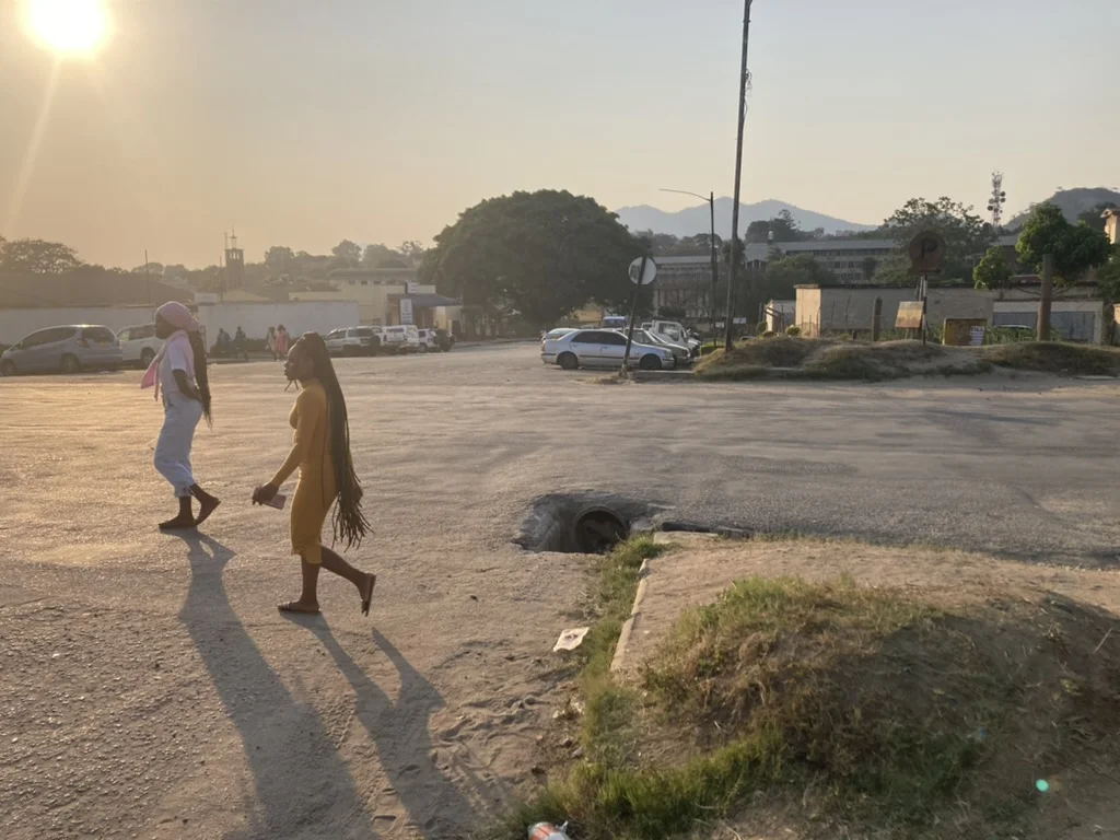

Late in the afternoon we pulled into the city of Mutare. I had never been there before, but I found a hardware store in the GPS and decided we would stop to see if they had proper nuts and bolts.
We came to this intersection on the main road and turned left on the side road where the hardware store was. We were parking, so I was lining myself up to be close to the curb. And then BANG! We were jerked to a stop. Our left trailer wheel had fallen into this open sewer and stopped us dead in our tracks.
The trailer's weight landed squarely on the propane tank cubby, pushing the bottom upwards. Propane tank itself was unfazed, luckily.
I got the bolts I needed and we were on our way again. The sun set as we were climbing the mountains of the eastern highlands. We passed wild fires that hugged both sides of the road, traversed tight switchbacks while passing extremely slow-moving trucks and things were going as well as could be expected...until the A/T OiIL TEMP came on as we were about to crest a particularly steep pass.

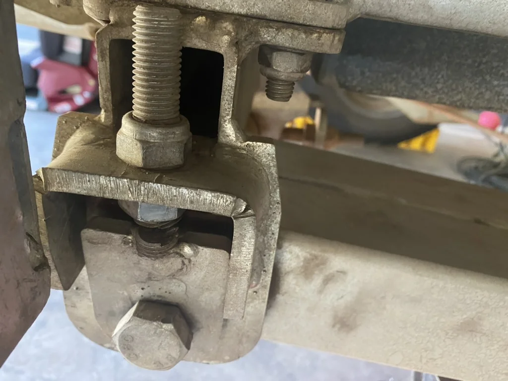

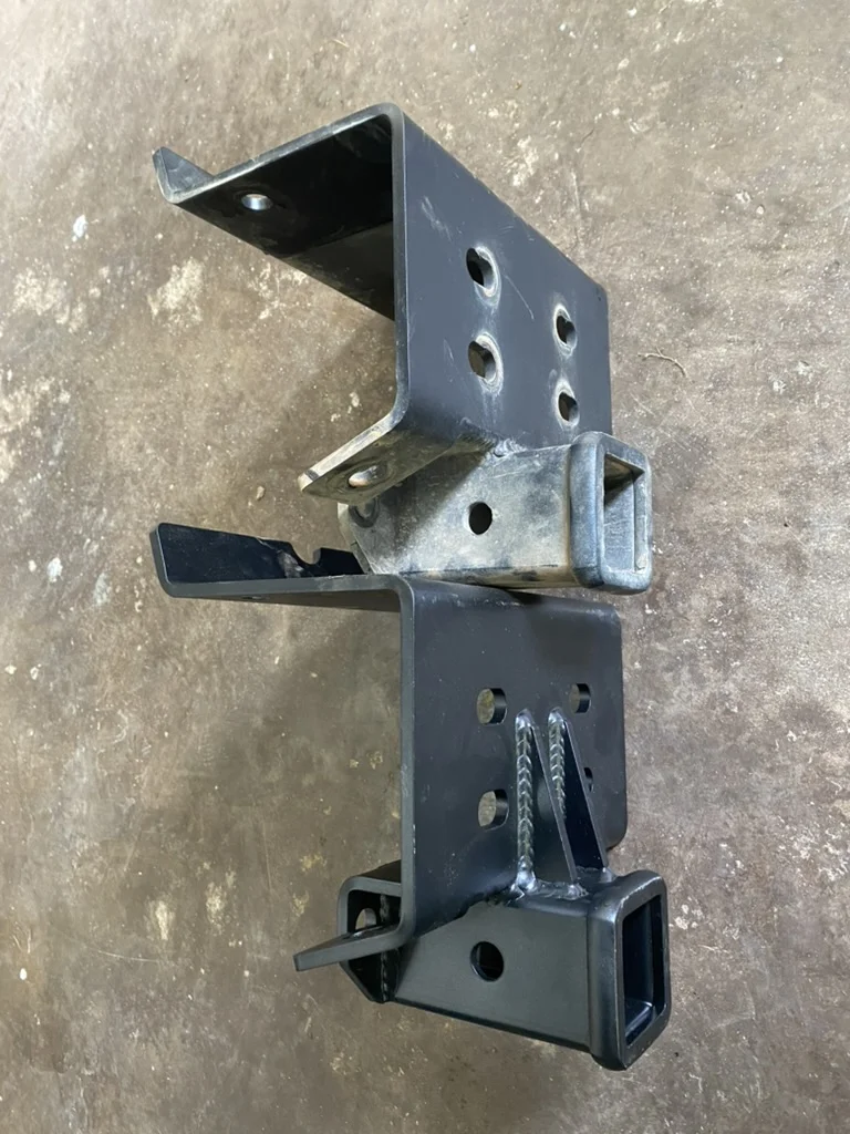

That doesn't look right...
Welp, the hitch and backing plate are bent...but not much I can do about it right now.

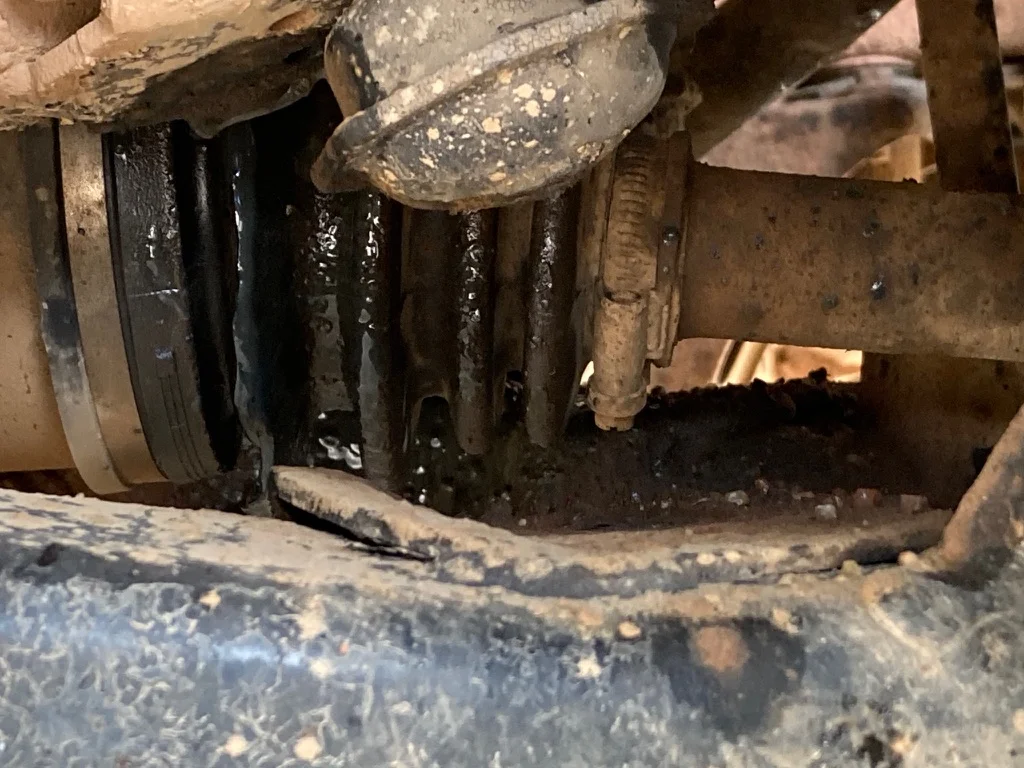

Jeeze, and one of the CV boots is torn wide open

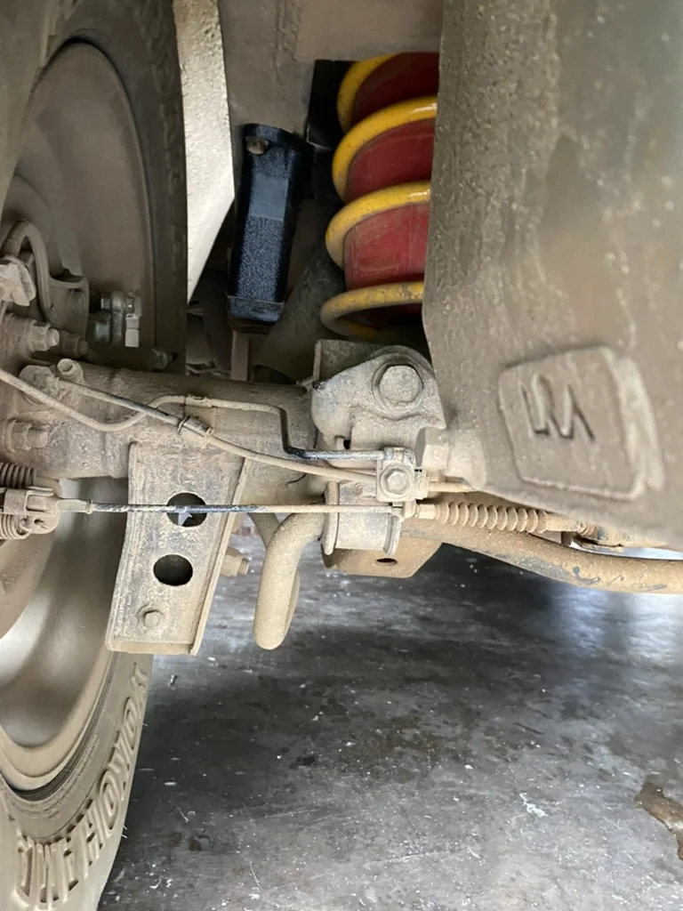

Soon, something felt off, the truck was acting like it had no rear shocks; extremely soft. It was clearly bottoming out on whoops.
I had another member's kid in my truck (and this group doesn't use radio comms), so I felt like I had to keep up and kept pushing. The truck was slamming onto the rear bumpstops and the nose was pointing toward the sky...but I pushed on, knowing that the paved road was just a "few more minutes" away.
We arrived at the paved road and pulled over. I crawled under the truck to see what was going on.

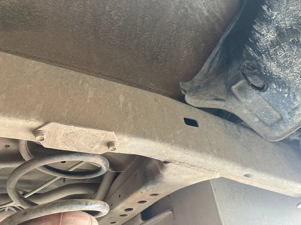

Anyone remember that "great deal" from post #27 where a local 4X4 shop welded a bracket to my Trail Tailor adjustable rear upper control arms so that I could continue to use the AHC rear height sensor? Well, it turns out that wasn't such a great deal. The weld broke and the rear height sensor was just swinging in the wind, telling the truck that the rear was sky-high when it was really dragging bottom. 4 zip ties and we were back in business.
Not much I could do about a completely missing rear bump stop, though (you can also see where the tire was wearing through the rear liner, rubbing directly onto the auxiliary fuel pump...

I contacted Dissent about the hitch failure and without hesitation Ben dispatched a reinforced hitch and back plate - no charge.

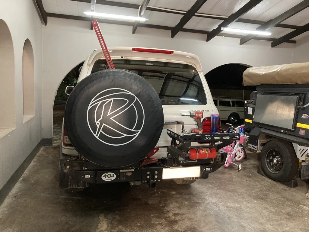

I also figured out that I had mounted the tire and rack to the wrong sides. "Driver side" is not "Driver side" on RHD vehicles - D'oh! All fixed now...
I tossed the Trail Tailor rear upper control arms for some factory units, with a factory-welded bracket (which I bolted a flat bracket to for the sensor lift). I also swapped out the 80's series rear springs for King Coils. The 80's series springs were perfect for when the truck and trailer were fully loaded. Anything less than fully loaded and the ride became slightly bouncy. The King Springs don't have that issue.
I also installed some Perry Parts bumpstops. They are NOT designed specifically for the 100 series (holes in the bumpstop base are offset, while the 100 series bracket holes are centered) but they seem to work OK.

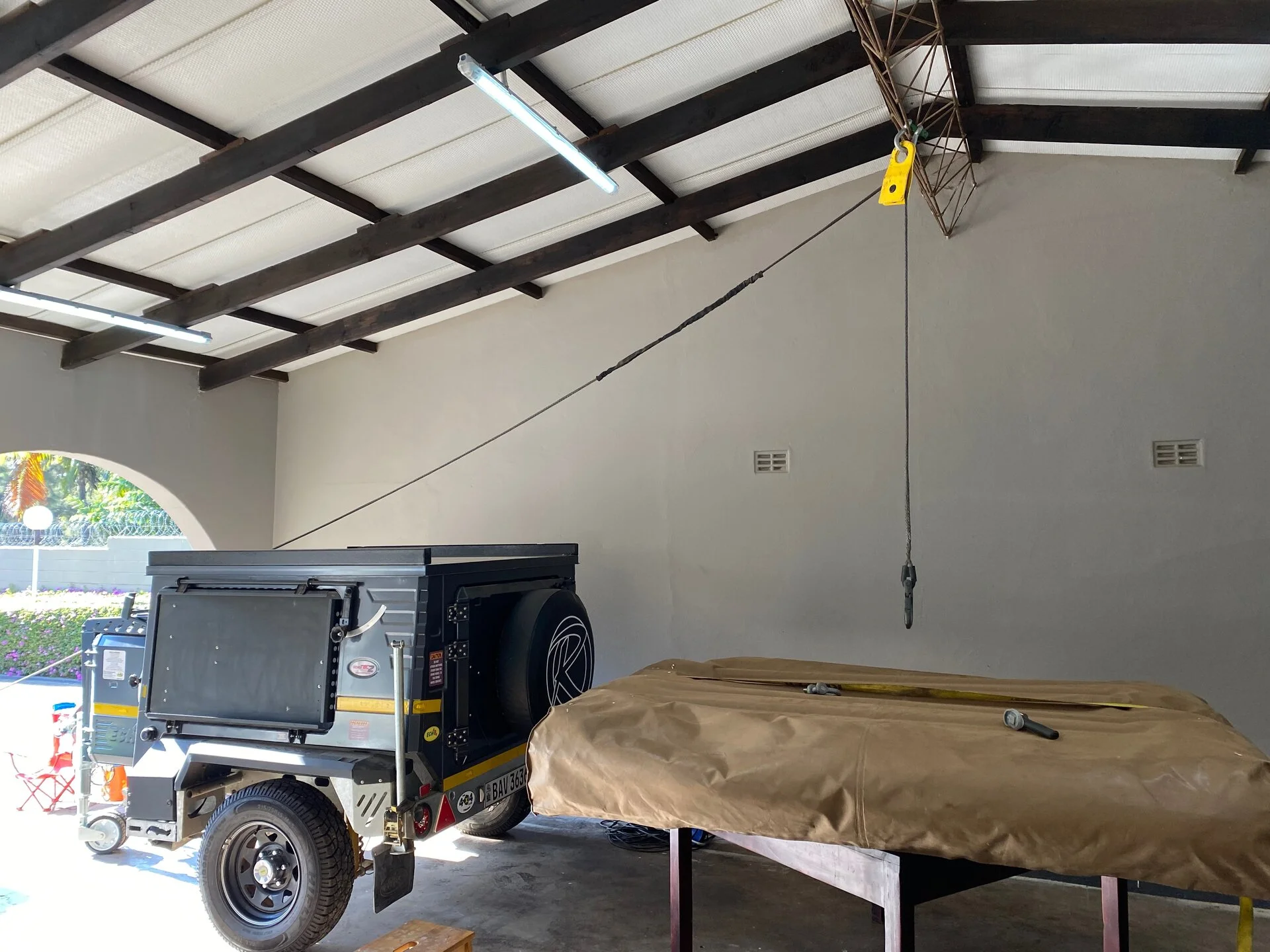

Based on the advanced age of the guests we will have on our next multi-week trip, I decided to utilize the trailer for luggage and food hauling duties, but ditch the rooftop tent, saving an estimated 350 lbs and some wind resistance. This way, 7 people can ride comfortably in the Land Cruiser during the day and we can sleep comfortably at night in self-catering lodges / airbnbs during the trip.
DISCLAIMER: The safer way to do this would have been 4 guys lifting the tent off the trailer and placing it on the table. I do not endorse this sort of arrangement (offroad winches and their accessories are made for pulling not lifting), but I took the maximum safety precautions I could given the equipment available and my lack of willing friends. I made sure I NEVER even got close to being underneath the load. With that said, for your viewing pleasure, my one-man tent removal procedure:

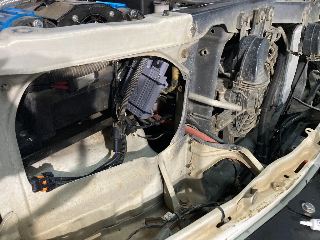

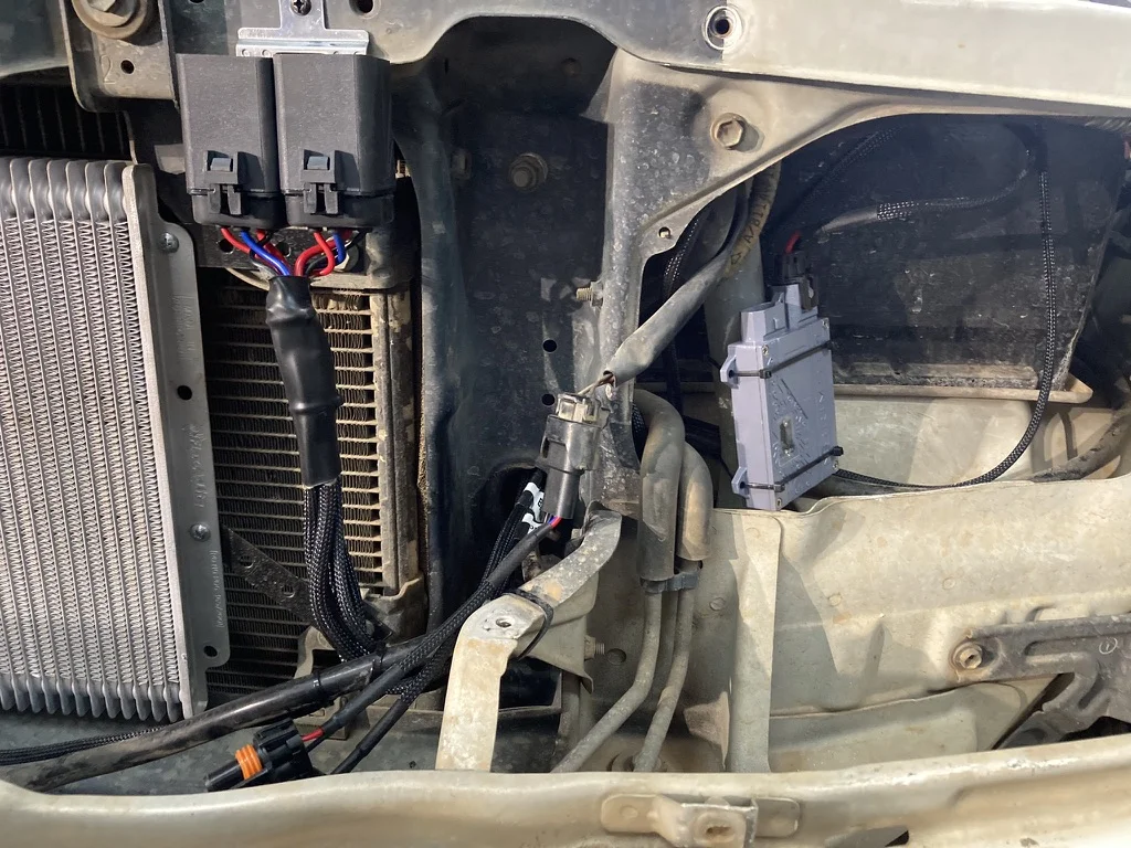

To continue the theme of delayed gratification / million dollar build, I finally received the LB Builtworks lights I ordered back in December 2021. I opted to have LB build them instead of just using his bracket and doing the work myself, since I needed new housings in any case and didn't have the time to do all the research and build everything myself. I wanted a simple bolt-in solution and was willing to pay for it. It took him 17 months, but he delivered exactly what I ordered.
Installation was quick and straightforward. I zip tied the ballasts to nearby looms and bolted the relays to the radiator support.
We had talked about how when he sets up his builds he sets them up for left-hand drive countries (like the US). Since I will be bringing this truck back to the U.S. when I finish this tour, we figured better to just annoy fellow drivers for a couple years in Africa instead of in America for decades to come.
Well, as it turns out, having them set up for LHD really annoys Zambians. To the point where every single car flashes their brights at me (thinking my high beams are on) and some say "that will get you shot eventually if you keep running your lights like that." The lights do, in fact, light up oncoming drivers interiors like a paparazzi blitz. I can see how that would be annoying / blinding considering the impressive output of these lights.

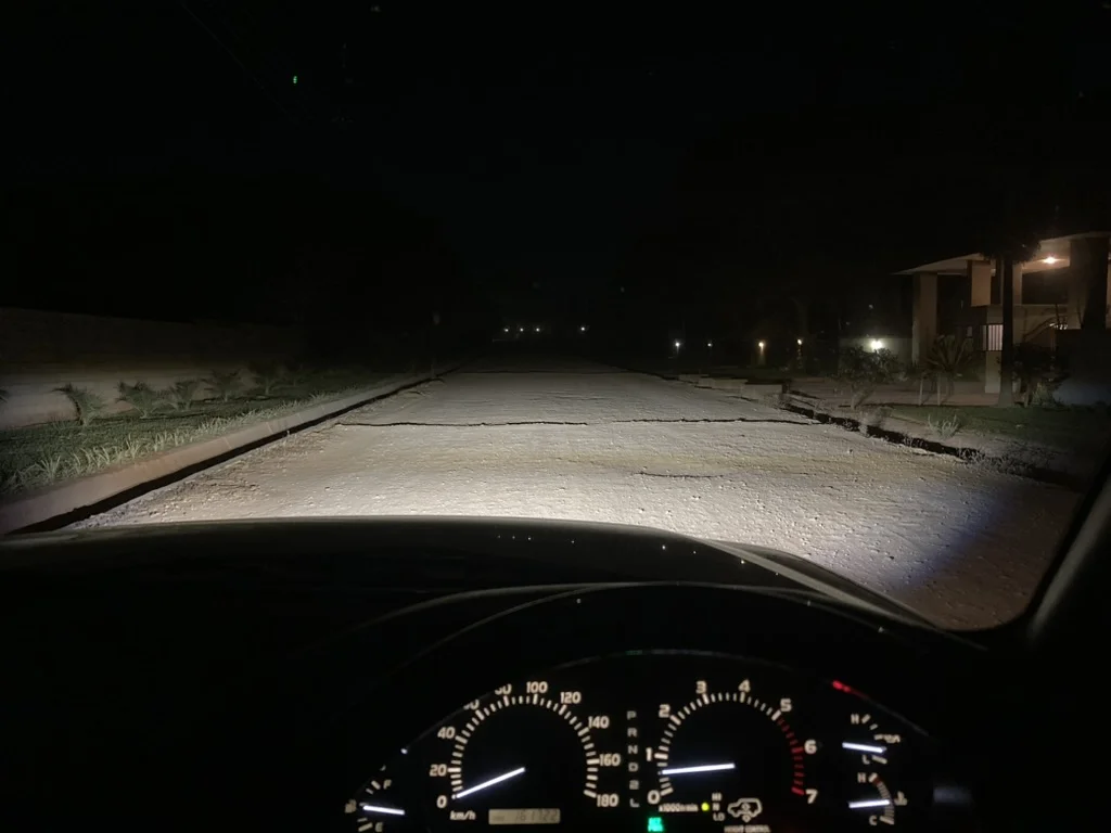

Add on top of that the fact that the D2S low beams are only slightly better than my RIGID 4" round SAE-compliant (AKA non-blinding to other drivers) spot lights, and my solution for now is to just run the parking lights and spot lights for "low beam" driving and only employing my $$$ LB Builtworks lights for high beam duties.
Parking lights & RIGID 4" round SAE-compliant spot lights only:
RIGID 4" round SAE-compliant spot lights and D2S lowbeams:
RIGID 4" round SAE-compliant spot lights, D2S lowbeams, and RIGID 3x3 flush mount "ditch lights" that came with Dissent bumper:
RIGID 4" round SAE-compliant spot lights, D2S high beams, factory high beams, and RIGID 3x3 flush mount "ditch lights" that came with Dissent bumper:

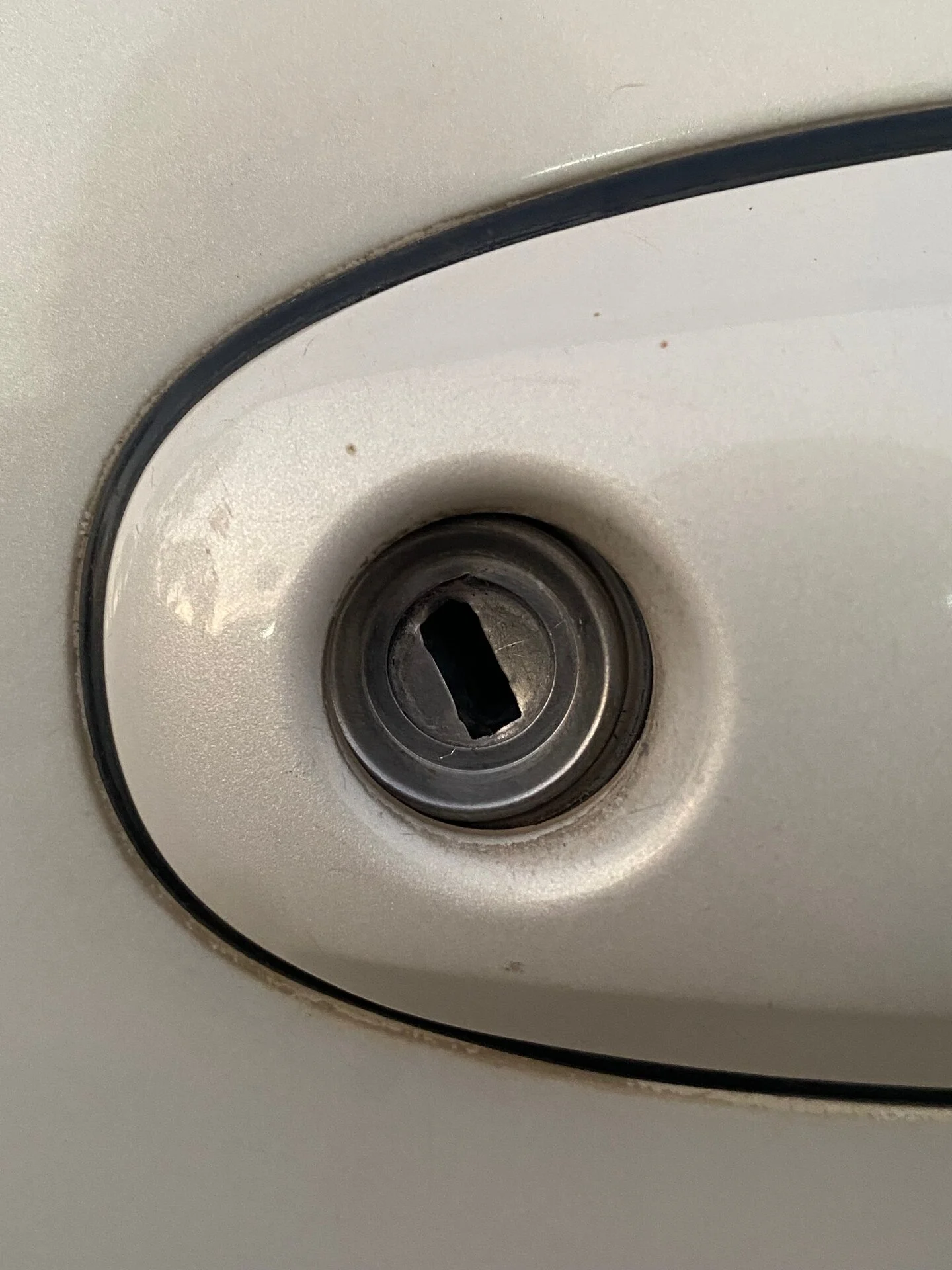

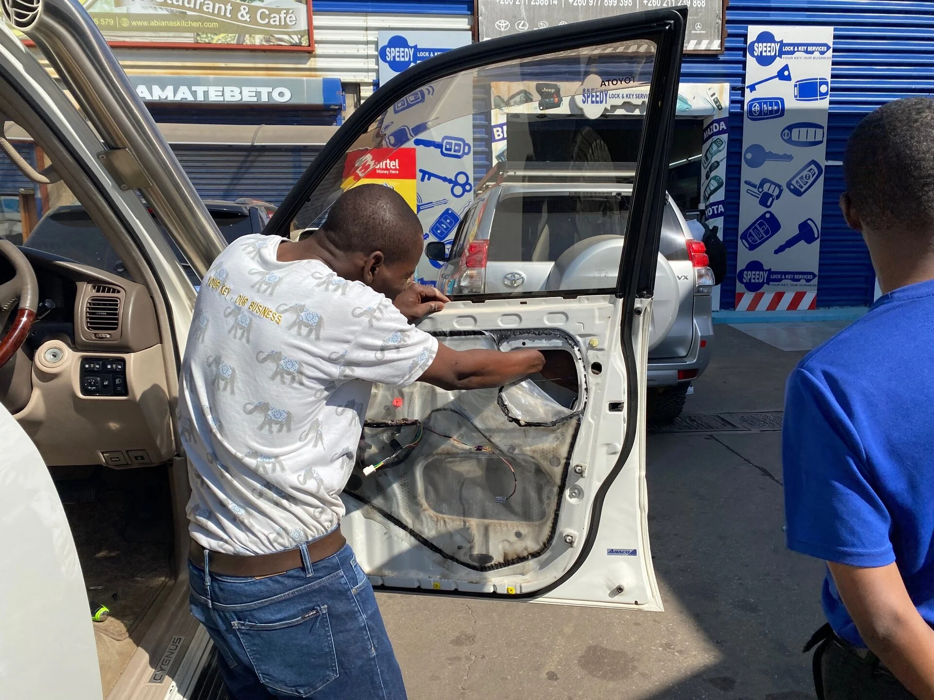

This "gentleman" gave himself a self-guided tour of our landcruiser while my wife was at the hardware store this week. He pulled up in the white camry, came out, busted my drivers side door lock and went in through the back door. He crawled all over inside the truck two times looking for anything to take. Luckily we only had our first aid kit strapped to the center console Victory 4X4 MOLLE mount. He opened it up and took some bandages. Thankful that he just busted the lock cylinder. My friend had this lock cylinder destroyed, but their tool broke off inside it, so they broke his window too.
Thankfully (?) the local locksmith is highly experienced in repairing this exact issue. He says he does multiple every day. 45 minutes and $12 later, the lock cylinder was repaired and I was on my way.

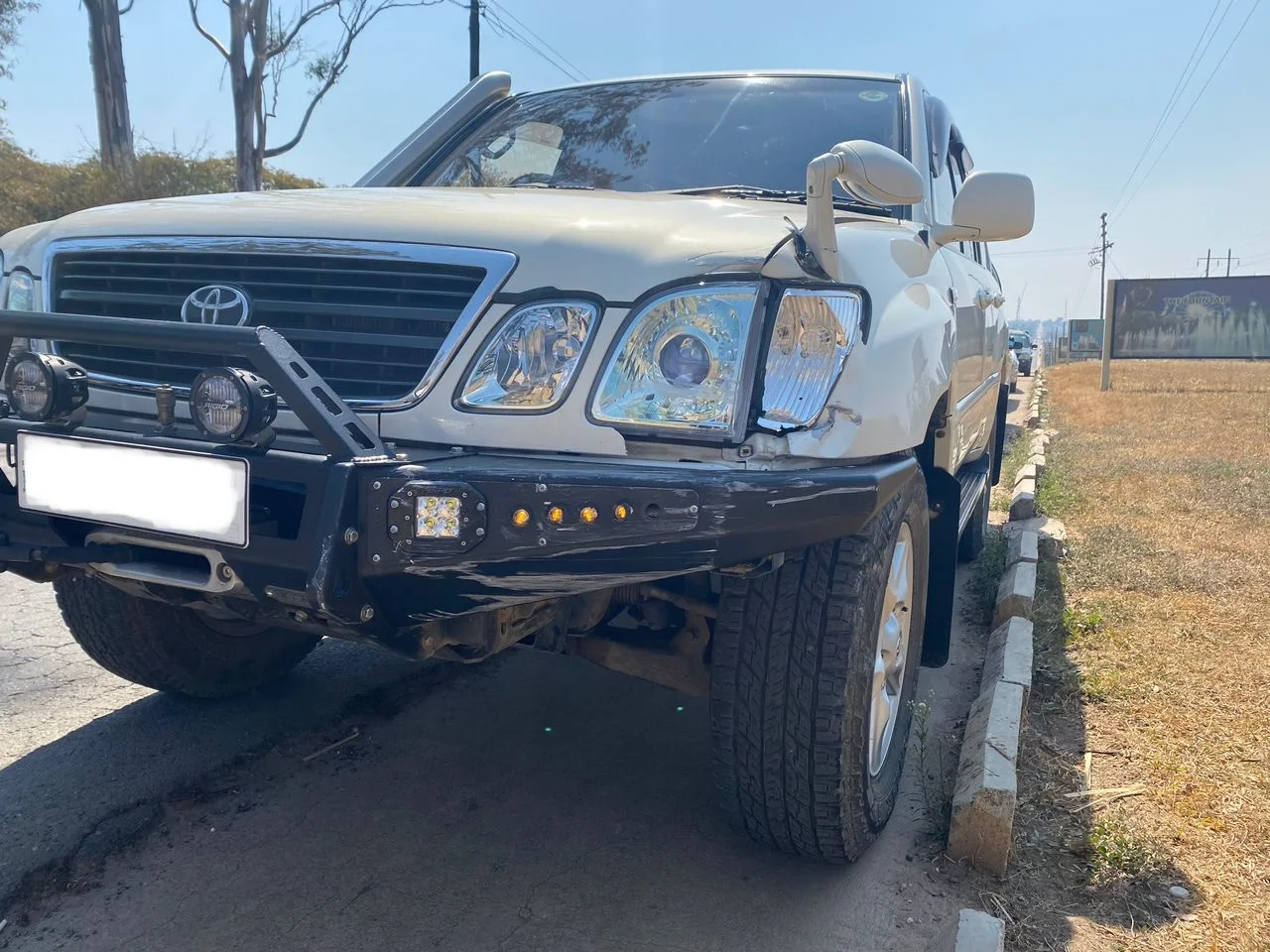

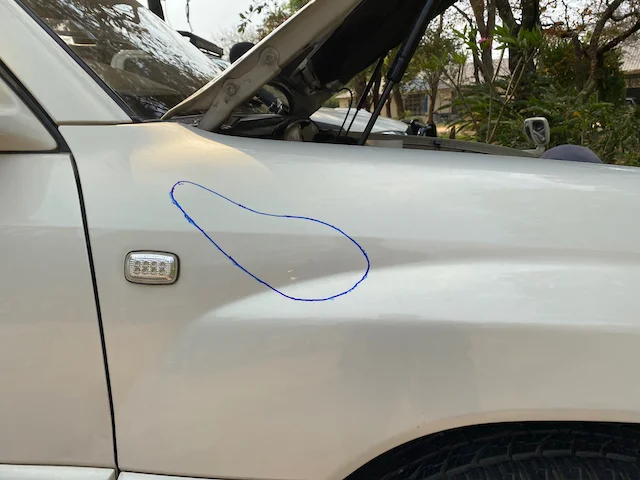

My wife is lucky I love her so much. Just like our last cruiser, she managed to crash this one. Rear-ended someone in broad daylight and clear weather because the person stopped completely in the middle of the road (as Zambian drivers are want to do whenever a pothole or speed bump appears in front of them). Uggh. Luckily the local insurance came through and it seems we will only be out of pocket a few hundred dollars after it is all said and done.
I sent the busted headlight housing back to LBBuiltwerks and Lou put the guts into yet another brand new housing and got it back to me quickly. Dissent aluminum bumper was completely unfazed; A quick blast of semi gloss black, some new LED turn signal bulbs, and it looks like new. Ordered a brand new hood and related trim pieces from Partsouq, a new side marker lamp from Amayama, and waiting on a used fender to arrive from Japan courtesy of BeForward before it goes off to "the best" body shop here...but even they admit the lower-quality paint they use will only last 2-3 years :-(
Still plan to keep it forever even though it's not as pristine as it once was.

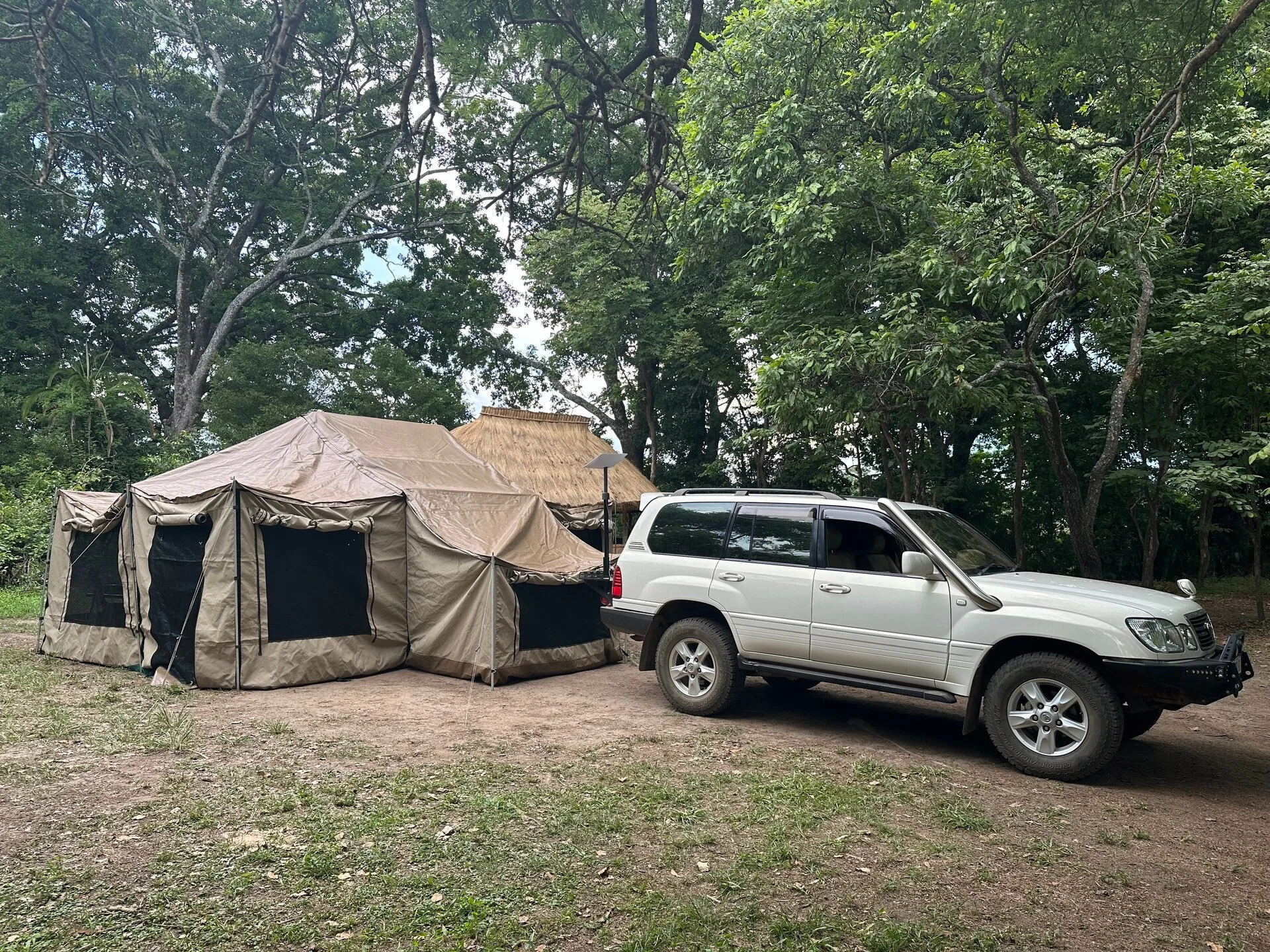

Yes, known to other campers as the "Taj-ma-Tent" or "Royal Palace" it truly does sleep 7 in total comfort. The tent is custom made for the trailer, which is an Echo4x4 Tec2.
