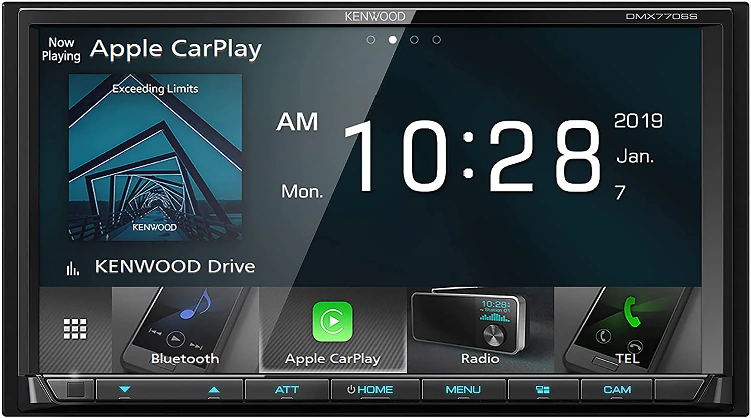

As mentioned above, the radio that came with the truck might have been great for Tokyo, but since I don’t read Japanese and don’t need GPS navigation specific to Japan, it had to go.
In searching for a new head unit, I quickly came to find that the worldwide supply chain problems were also affecting aftermarket car stereos. I eventually decided to purchase a model that was a couple years old but hit all the right…buttons.
I was really enamored with the dual camera function and easy access to the “Cam” button on the right hand (my driver’s) side of the Kenwood DMX7706S.
Parking in tight spaces can be stressful enough, but once a big steel bumper with winch goes on, parallel parking in the city becomes a nerve-wracking game of chicken with other people’s trunk lids / bumpers / back windows. I liked the idea of a front camera taking the guesswork out of the equation. At the same time, accessing it through a series of menus was not going to work in a parking situation, it had to be an easily accessible physical button. The DMX7706S fit the bill perfectly.
I found one on Amazon for $600. It was the last one in stock (seemingly anywhere on the planet), so I purchased it. Unfortunately, around this time, our mail was incredibly messed up and I after months of waiting, it was clear I was never going to receive the package.
With Amazon now out of stock, I went searching elsewhere. I had never heard of buya.com before, but decided to take a chance. The website is an online marketplace for pawn shops to sell their goods. At less than half the cost of new, I went for a pawn-shop special. And you know what? It works just fine.

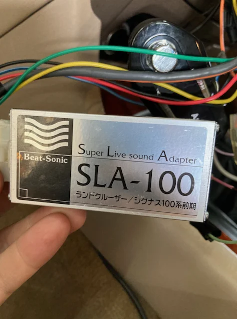

I feel incredibly lucky that the prior owner had already installed an aftermarket stereo. I found this gem (Beat Sonic SLA-100), which allows the signal from the aftermarket stereo to pass through the factory amp and subwoofer. A major win.
I still had to wire the connector on the receiver side of the SLA-100 manually, since the old stereo was a pioneer and the new a Kenwood, but the job was made much easier by the prior installer leaving the identifying tags on each wire. Even the aftermarket rear camera from the old stereo wired right up and worked beautifully.

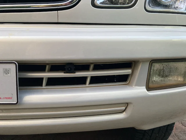

I wired up the front camera and mounted it within the front bumper cover – it is everything I hoped for. Once the Dissent bumper is mounted I will need to figure something else out.

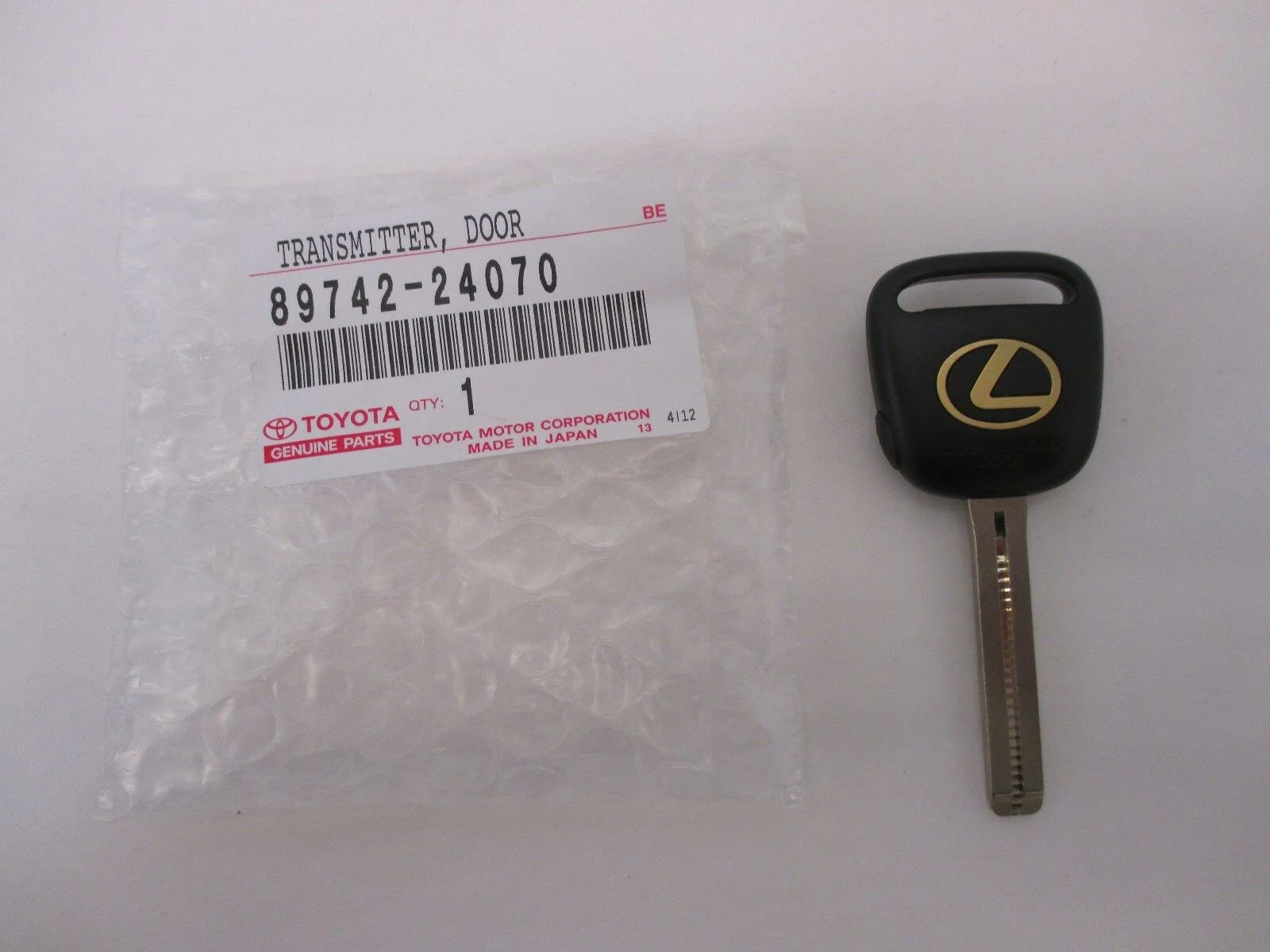

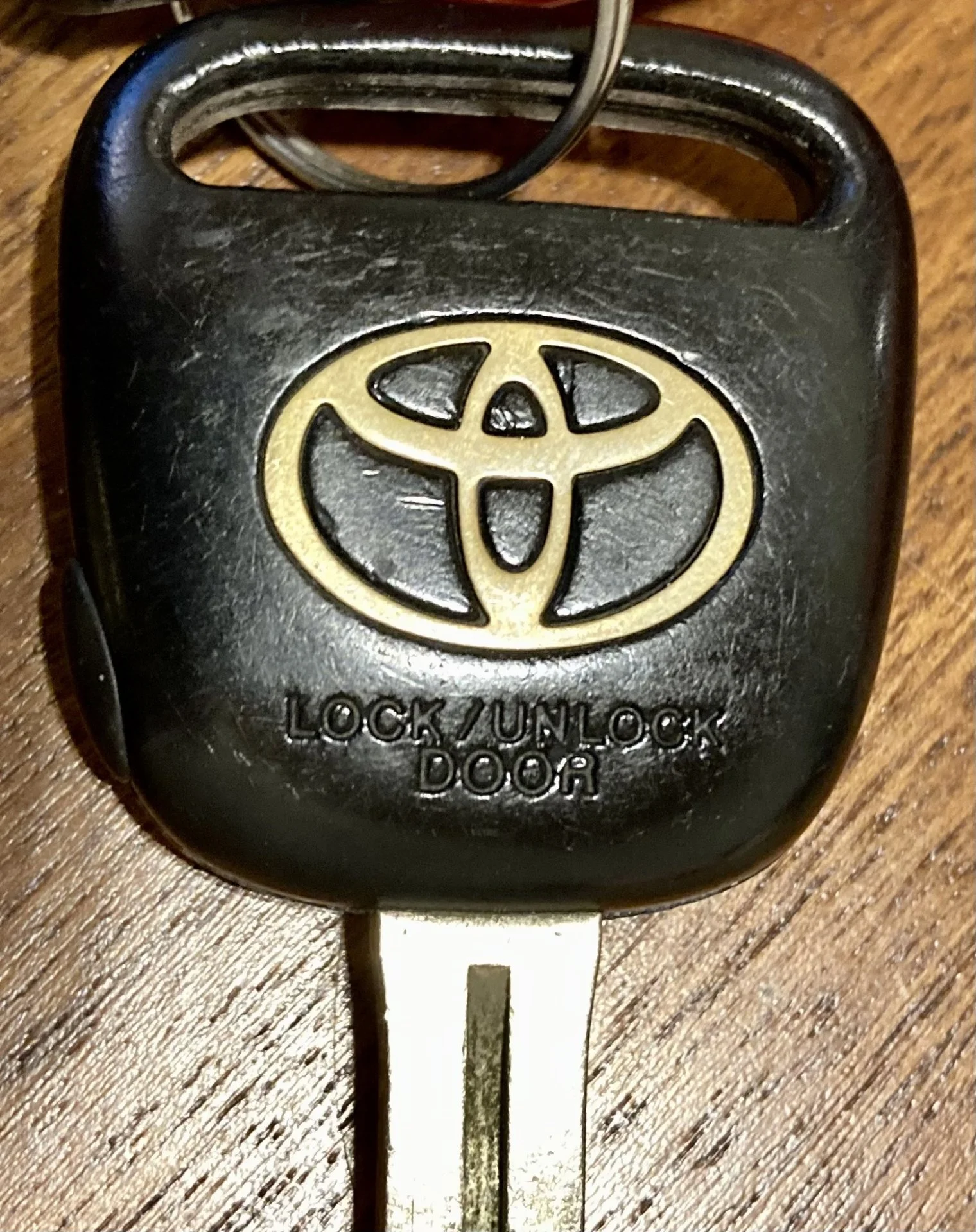

On a related note,I love the factory key, it has a single button lock/unlock integrated into a much smaller profile than our U.S. market two or three button keys.
I wanted to get another transponder key like this. It looked like mid-90’s Lexus cars in the U.S. used this same style key / fob, so I ordered a blank from ebay and had it cut locally.
It starts the truck up just fine, but I’m not sure if the FOB can communicate with the truck or not. My factory key has no FCC Id (why would it, I suppose, it was a JDM key, so no FCC id required).
Additionally, all of the directions I can find online about programming fobs describe how to program a fob with two or more buttons (e.g. “hold down both the lock and unlock button…”). I can get the truck itself into programming mode, but I have not had any luck with it recognizing this FOB. I don’t know if it’s on a different frequency, or if I’m not doing the programming steps correctly, or what.

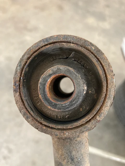

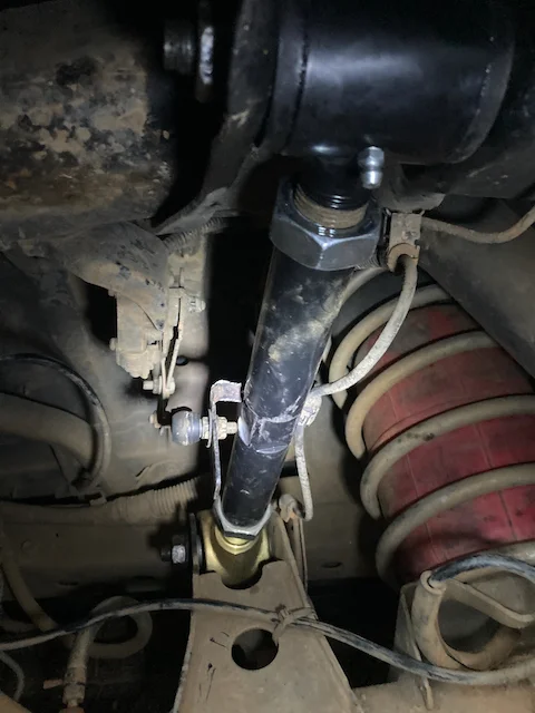

Today's accomplishment was the installation of Trail Tailor adjustable rear upper control arms.
The bushings on the factory arms were ready to hang up the towel.
Back in December when I received both the lower and upper control arms from Trail Tailor, I installed the lowers right away (along with some Firestone airbags, in preparation for my eventual 40 gallon auxiliary fuel tank). The complicating factor when installing adjustable upper control arms on a truck with AHC is that they don't come with a bracket for the rear sensor.

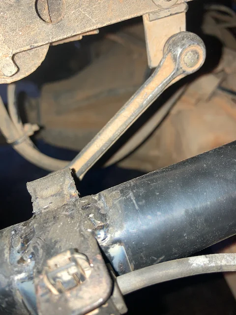

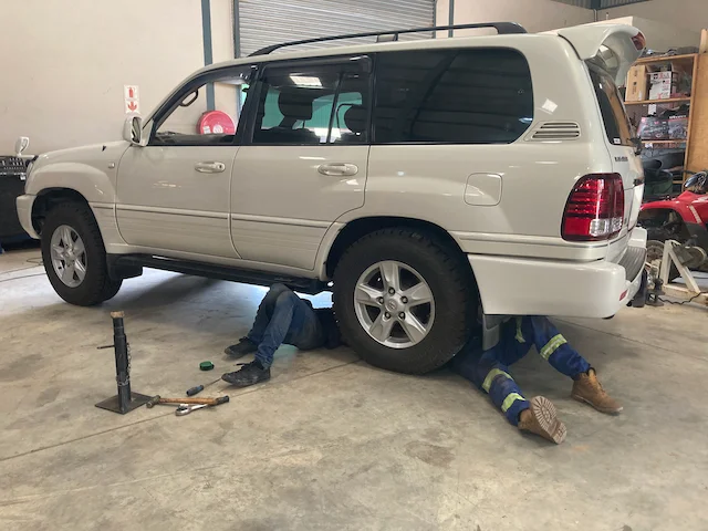

Today I finally had the opportunity to go into the local off-road shop and have them weld the AHC bracket to one of the Trail Tailor arms. While we were at it, we welded the ABS wire bracket to the other, for good measure.
Even though I was with the mechanics for the entire time...it only takes a second.
Before installing the arms, I set them to the correct length. The mechanic then installed them...but as he was doing that he started lengthening one of the arms to have it reach the axle, which had shifted. I told him as long as he got them back to the same length, we should be OK.
Then, when were were setting the bracket location, we noticed the driver's side was an inch lower than the passenger. I had to take a 2 min call so stepped away and when I turned around I saw one of the mechanics cranking on the driver's torsion bar. "Stop!"
"But boss, this is how you adjust the height on one side."
"No, it's not. Not for this truck."
It turns out that cross leveling an AHC vehicle can also be impacted by rear upper control arms that are different lengths. It took four full rotations of the driver's side arm to get it equal to the passenger side and to level the truck out. Can I complain? All together, including 6 hours of labor and some light welding the bill was $100 total.

I have no idea. But I guess this is as good a time as any to add the final chapter to the story of that amazing, fantastic, best-ever key.
My wife and I went to a park with the kids. As we were leaving, my wife gave her key (THE key) to our six year old, to unlock the doors because she was running ahead and would get to the truck first. The six year old unlocked the doors, climbed in and - our best guess - left that key in the gravel parking lot next to the truck. At the time that was happening, I was getting the two year old buckled on the other side, my wife was getting the four year old situated and by the time we were all in the truck we were distracted by a monkey troop walking through the parking lot...and by the time she realized her keys were missing it was already two days later. No luck returning to the parking lot and doing a thorough sweep. That key lives on only in our memories...a legend among keys.

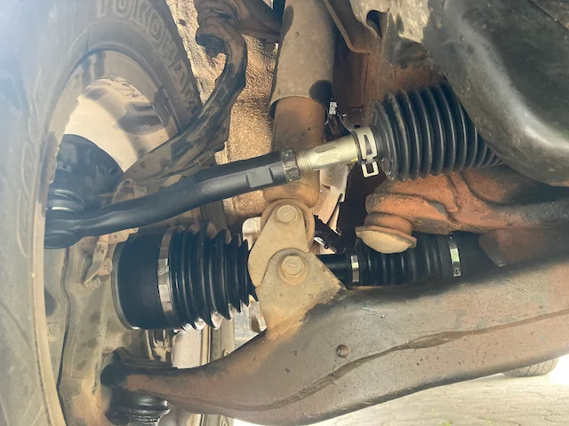

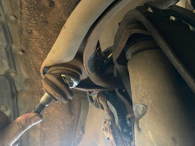

I intended to replace the steering rack, driver's side CV, and front upper control arms yesterday.
With increased down travel generated by the AHC lift brackets, you can have contact with the stock upper control arm and the dust shield of the front actuator. And in a country riddled with potholes and speed bumps, you might have a lot of contact.
The trouble with any aftermarket control arms is that they aren't made with AHC trucks in mind, since the AHC lift brackets aren't readily available in the U.S. and conventional wisdom goes against keeping an AHC system when lifting a truck. Even the Dobinson arms I purchased, which include a stud to mount the ABS line, will need the AHC sensor bracket welded on before mounting them.
Unfortunately the welder was out sick yesterday, so the upper arms will have to wait for another day, despite the split boots.
So off with the CV...

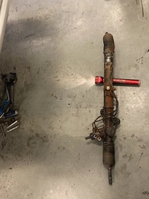

And using the the tricks in this thread, we worked on getting the steering rack out. We used the below setup to get the bolts off the D-bracket from above.
And thanks to the trick of lifting the engine a couple inches, out it came! (landing on top of a 25 yer old maglite...which wasn't phased at all).
Who doesn't love some fresh new parts?!

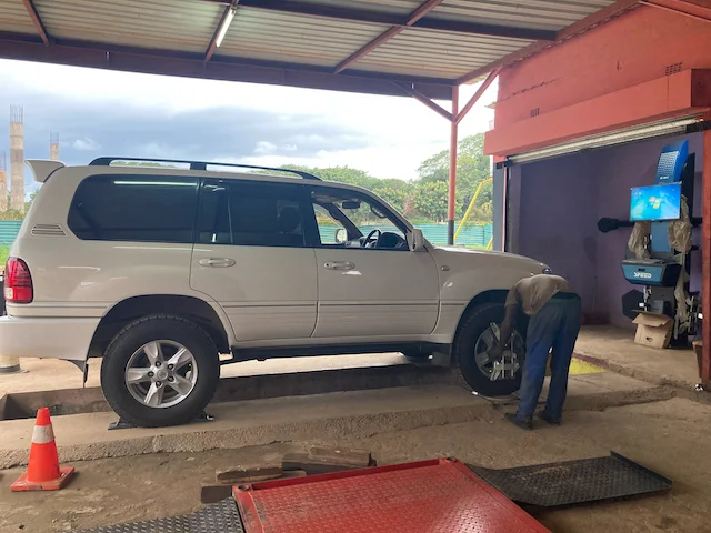

A $10 alignment should get me through until the welder is feeling better and we take a bite of the front UCA project (after which I will go to a more advanced alignment shop).
