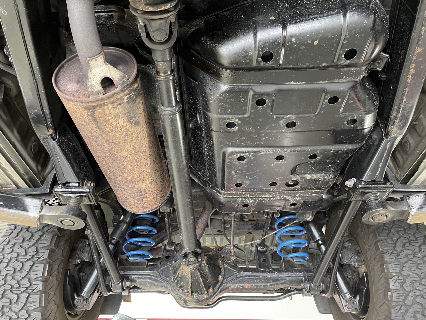

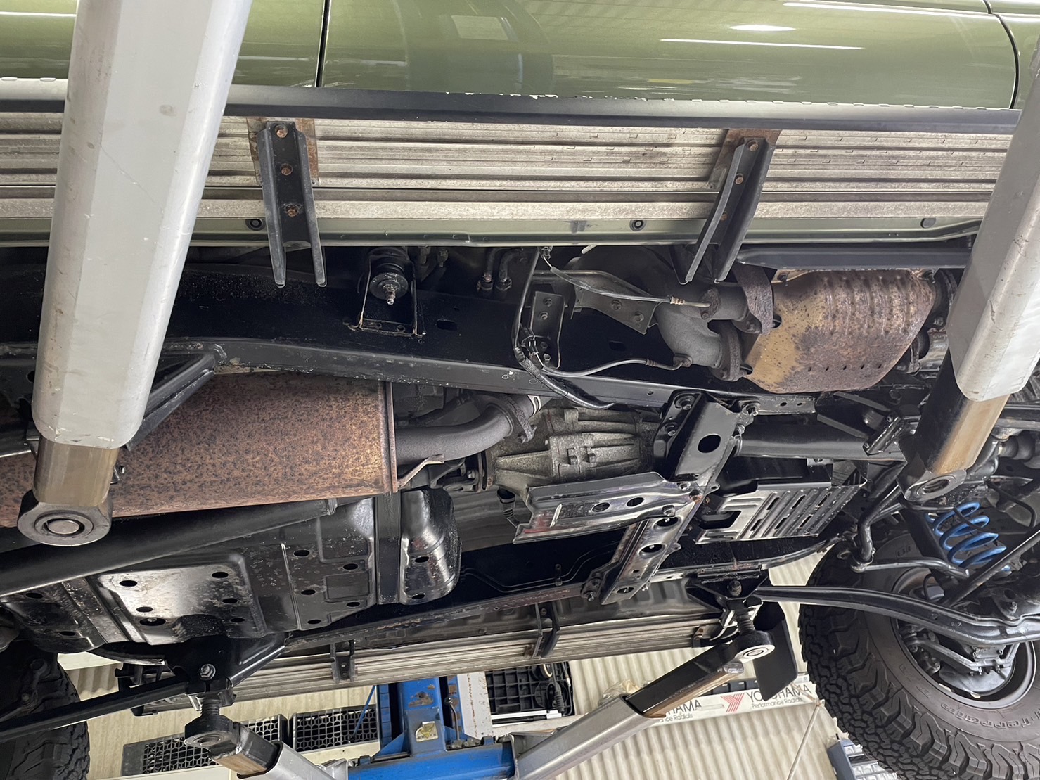

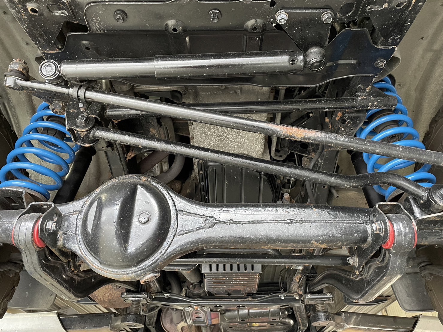

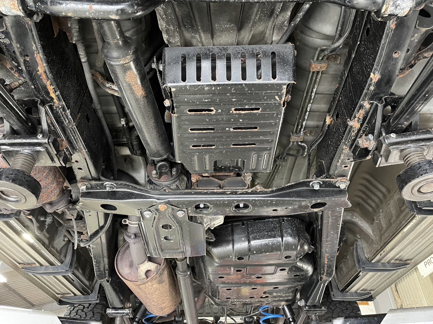

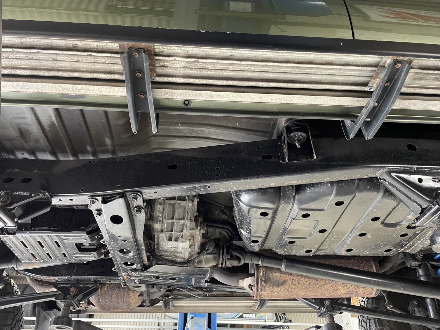

Looking into a 94 JDM model, and had the seller take a few more pictures since it was lacking some of the underbody. Something had to be a point of concern, and this is it.
Looks pretty extensive in a good couple spots to my untrained eye, and like it wasn't in good condition when it had the undercoat of paint put on.
Want to know what anybody who's dealt with underbody rust thinks about how it looks. Ever seen a $23k rig look like this underneath?
For a $23,000 cruiser, I think it looks really great! For selling purposes, most people would say that is almost rust free.
Keep in mind, rust happens. Any little parts of rust that you can see, I would recommend trying to remove it as best as possible without doing damage to surrounding areas. Treat it with a corrosive prevention chemical, then I would use macropoxy 646 to seal it.
I’m an old crusty military retired dude. My salty perspective is this:
It isn’t bad, but it will look worse in real life. If you’re unsure about it now, no one on the internet is going to give you warm fuzzy’s. If you’re looking for rust-free and you’re compromising for this one then you’ll probably regret it. You’re going to pay, take delivery, take a look underneath, and then buyer’s remorse will hit you like a Mac truck.
What’s the rest of the cruiser look like? Interior, engine, specs, exterior, KMs etc. $23k might be well worth it.
Rusted muffler, rusted cat shield. Wirewheel and paint, move on with your life.
What rust? One of the cleanest I've seen. Muffler and shields always rust. Frame, etc, is amazing.
Gotta agree with everyone here. I'd kill to have mine had looked like that when I got it. Granted it wasn't anywhere near $23k but still. The rust I do see is MINOR at best. Exhaust pieces are going to rust but they are easily replaceable. I would not be concerned based off the pictures. Will you find a little more once you see it in person? One thing I notice is some of the pieces are so smooth they look to be new. Possibly they've already replaced anything that was really bad before the respray.

Want to know what anybody who's dealt with underbody rust thinks about how it looks. Ever seen a $23k rig look like this underneath?View attachment 3188131View attachment 3188133View attachment 3188132View attachment 3188130View attachment 3188129
Looks beautiful to me. You should see mine! We removed flaking rust using an air needle scaler. Since then we've been coating it annually with NHOU Home - https://nhoilundercoating.com/. Some say it is better than fluid film. Seems to have arrested the corrosion on our rig. Started this three years ago and just bought my 2nd 5 gallon container from them. Do all our cars now. We're in Wisconsin so it's essential.

I assume that the LC is still in Japan and if it is that rust is nothing especially for being on a island with a ton of salt air to kill it.
That engine bay looks great. It's pretty common to see all the fasteners rusted and the aluminum covered in splotchy white corrosion.
The undercarriage has more rust than I like, but it's definitely in the "very salvageable" category. Just make sure to either remove it and repaint or seal it with Fluid Film, Waxoyl, bar & chain oil + wax, or whatever. And get the inside of the frame rails, too.
Make sure to check the rearmost bottom of the body, behind the rear bumper. That and the rocker panels right behind the wheels tend to be the first body parts to rust.
