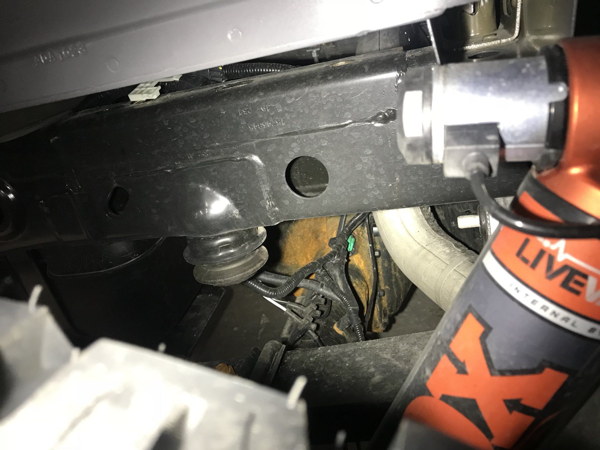

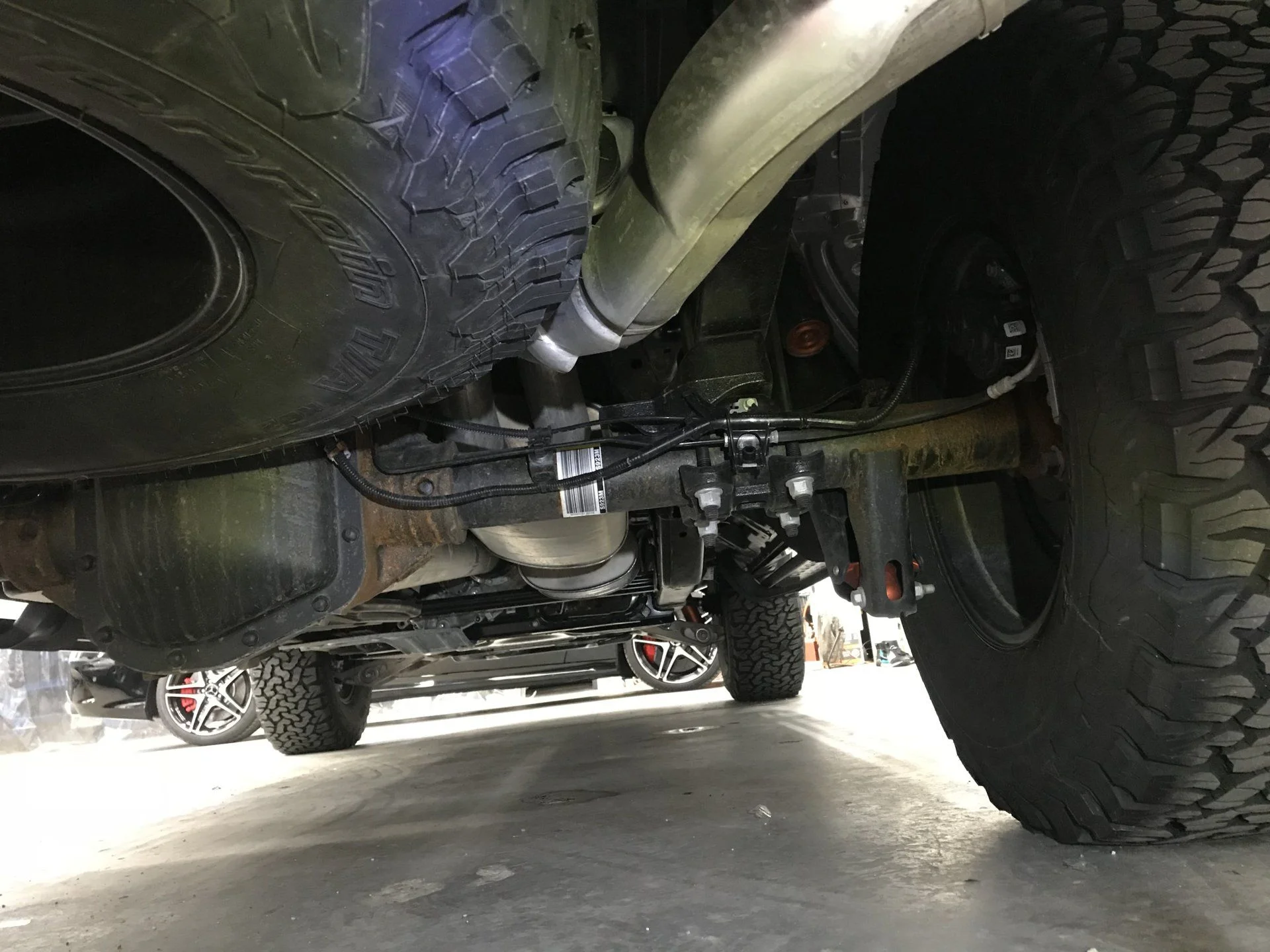

It doesn't look terrible but tough to really tell. I don't think you should be terribly concerned. I'd go over it with anything you can to loosen up the flaky rust....needle scaler, wire brush, hammer....then go over it with wool wax or fluid film and do that yearly. Even if you don't get all the loose rust off, a good coat of either product will stop the rust from getting worse. The products are also pretty reasonable and there are plenty of places that will do the coating for you if you aren't up for it. Seeing as it appears you have access to a lift, perhaps you can handle it yourself.
Interestingly enough, I looked at a 100 series a few months ago at a dealer that wasn't terribly far from you. When I pulled in, they had two cars on lifts with the doors open and a handful of guys with spray bombs that looked like a hornets nest. They were "touching up" every vehicle that came in. This was particularly annoying because up until I had arrived, I only saw pictures of the vehicle and I was amazed at the frame condition. Closer inspection proved why it looked so good as they had covered everything with their paint. That makes it very difficult to get a grasp on underside condition although.
Don't feel bad. There is a good chance you still have a solid vehicle. Give it a thorough check and then put your preventative maintenance into place and drive it. It sounds like you have enough on your plate so knock this one off your list.

You didn't get a good deal on that rig, but it is far from a rust bucket. Enjoy the Cruiser.

If you're stuck with the car, you should certainly remove that paint because it will continue to rust from the inside out. You really need to act aggressively with this snake dealership.
Suggest your next mod be to arrest extent of rust. Appears to be surface rust so shouldn’t require extensive work...may also alleviate your longevity concern.

Otherwise, I've seen that the tank shield is always the first to go, then the tank. I see that the shield has some holes, but not too bad. If you don't mind a bit of work, you could take the tank down, give it a good clean, rust converter and paint, and treat and line the inside with a tank treatment kit. Also the filler pipe will rust to pieces before most other parts.
Hard to tell from the video, but looks good to me. If it really was a horribly rusty frame, the por15 would only hide so much. There's no sign that the rust is extensive enough to worry about that.
If you can flake off some surface coating and uncover large amounts of hidden rust, do so. Then show that to the dealer and go from there.

Yeah take a slower video but the spots that I paused at to see if I could really tell if there was major rust I really couldn't. Shocks are definitely in need of replacement but I saw nothing with the quick walk around that would have me concerned. Hell there is a local one at a small car lot here that has low mileage but according to the VIN came from MA. I went to take a look at it and you can SEE all the spots that were rusted and then painted over. So much so that I saw a section on the skid plate protecting the rad and pushed on it and my finger instantly went through. THAT is rusted.
Diff casing completely rusted.

Keeping in mind that many iron components are designed for intentional oxidation. The oxidized layer provides corrosion resistance for the material beneath it. Same theory as used on power/transfer/telecom poles/etc. I've never seen a diff or axle tube compromised by corrosion. Brackets yes. I'm curious if this intentional oxidation is part of the design.
