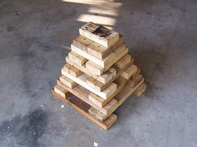

Grab some 2x4s and make a set of these. I’ve had mine for 15 years and they’ll probably hold up an ocean liner.And I’m s*** scared of getting under a jacked up car.
