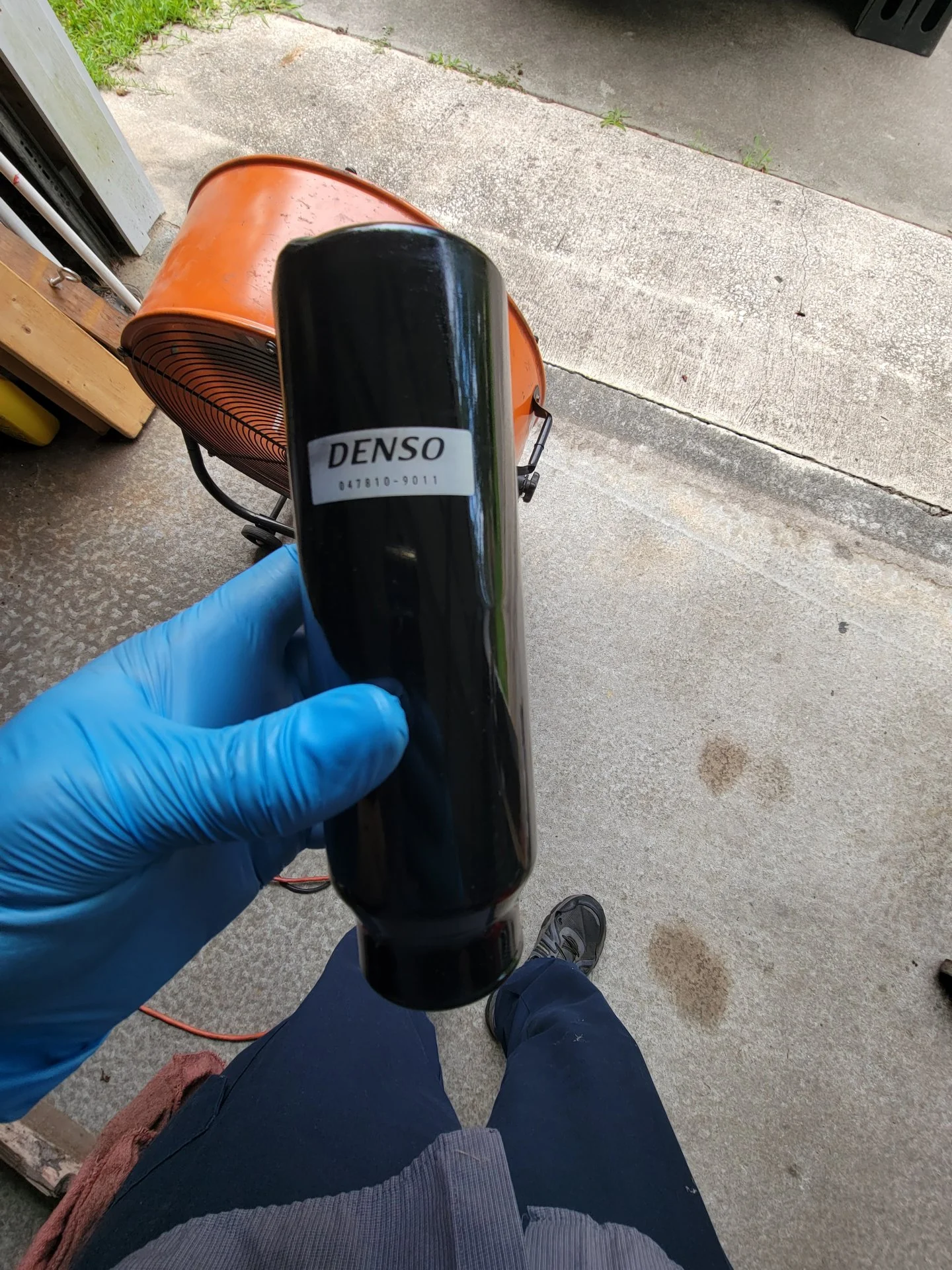

I recently replaced most of the AC system in my '97 and used this dryer which for now is still available at $26:
It looked the same as the one I removed and has worked well the few months since I installed it. I'm still getting used to how cold the AC is now and learning to point the vents away from passengers so they don't get too cold.

Thanks. I ordered one from Ebay that said it was Denso. It was a knock-off of an off-brand. Returned it. I was hoping for something local so I could get it going quickly. I'll pick up a Four Seasons and then keep a Denso on hand for the inevitable future system opening.

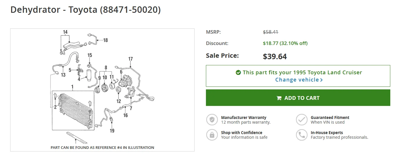

doesn't appear to be discontinued...maybe I'm missing something
They may be available from Toyota but the Denso link is showing discontinued. I was looking for a recommendation on something I could find locally, since the heat index is 115 the past three days.
Also, pre-5/93 is a different part.

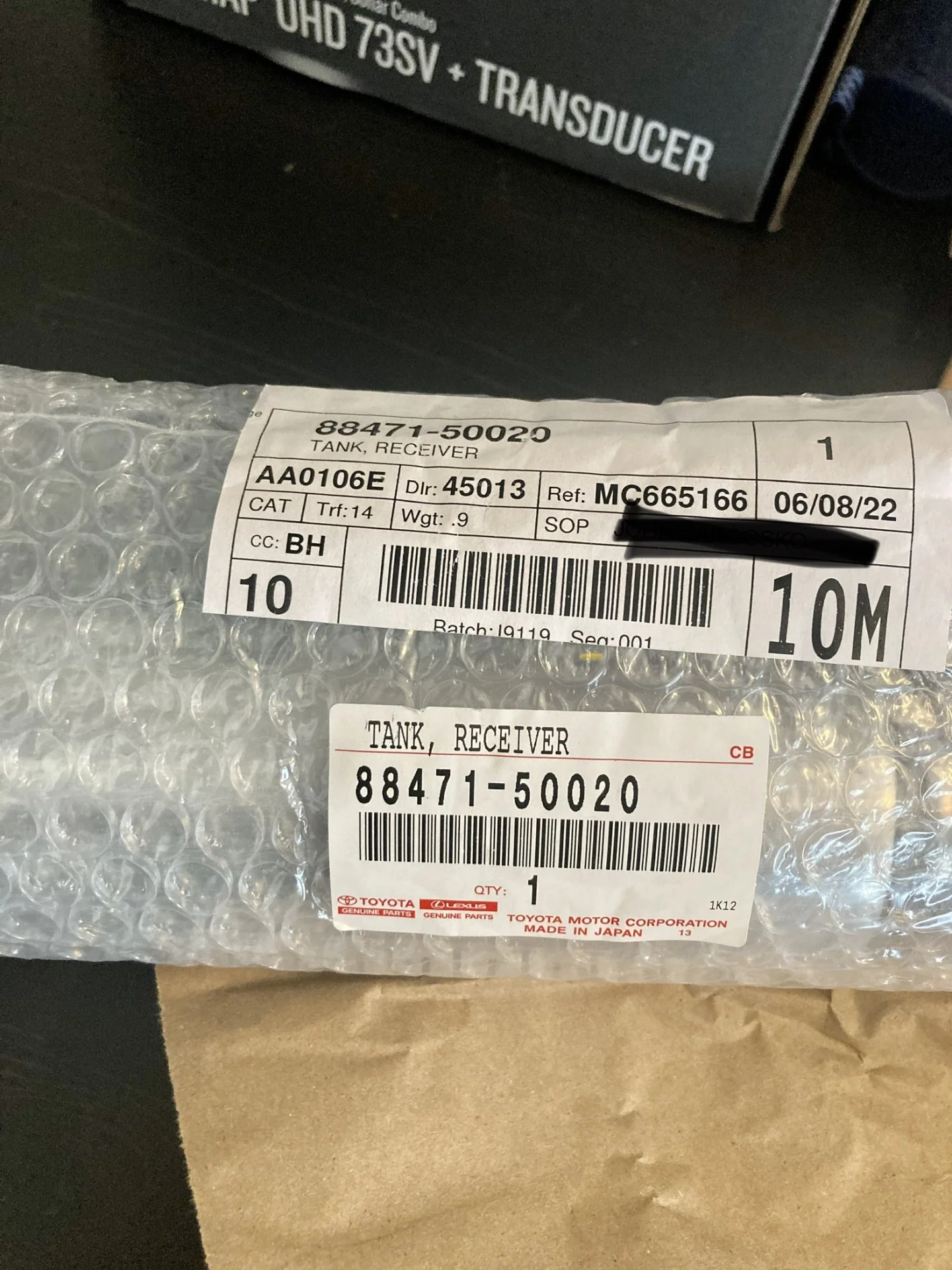

88471-50020 is the correct number for you application. Had you ordered one from your local dealer on Friday you would have had it by now.
Yes, at over $70. While I typically do OE parts, I declined to pay the mark-up on this one from my local dealer. I also did the A/C work over the weekend, so having one on Monday would have been little help. I put on a Four Seasons and ordered a Denso unit for the next time this rolls around.
