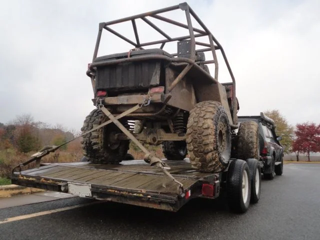

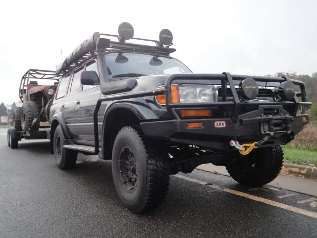

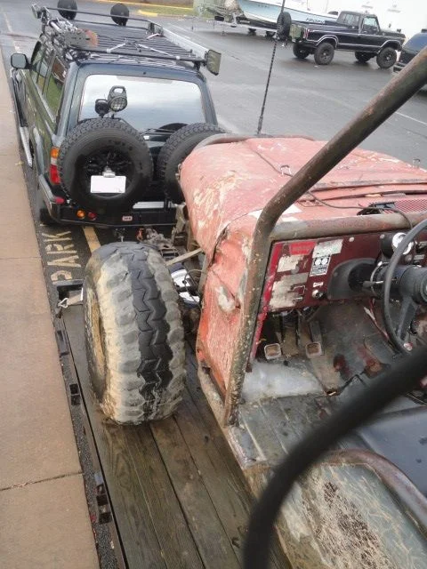

We did a tow test with it just the other day.
It was around 6,500 lbs with the trailer and buggy. The brakes were the limiting factor for sure, but it has some sticky pads and slotted rotors, and the trailer brakes work well. It pulls REALLY well. Accelerating up hills was not a problem.
"Accelerating up hills was not a problem." - SWEET! This is a huge reason why I am looking at a 200 series. Would love it if my 100 had as much power as this 80! Loved my 80, but now it is serving my son in the Army.
I can understand the brakes being the limiting factor now! With that power plant, torque should not be an issue! Great job on he conversion!
