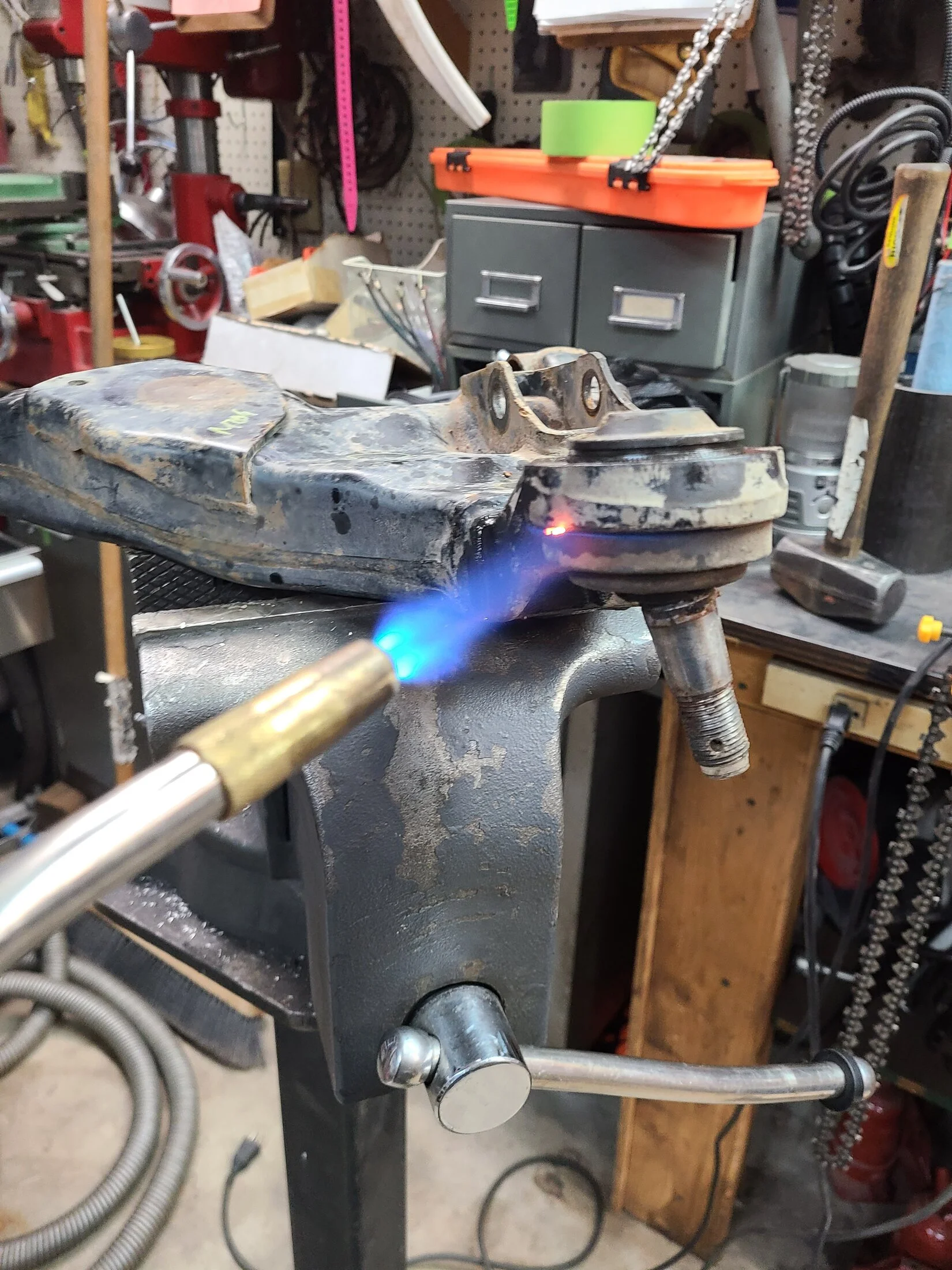

Likely. In addition the process to split them apart is pretty violent and I'm not too fond of it. Pounding things apart can't be ideal.
So beat and heat not your favorite? 🤪
Just messing.
