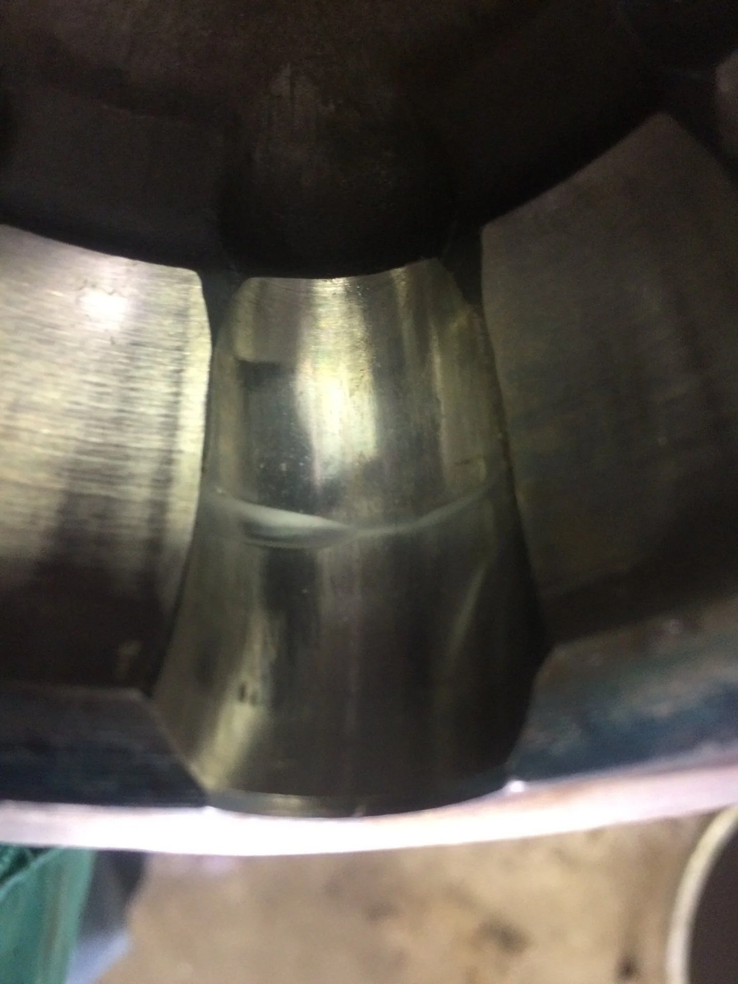

I have a little different slant, but I'm retired and my '94 is not my DD. I would definitely tear 'em down all the way. Mine weren't clicking & I have 275K+ miles so I wanted to see what kind of wear I had. Just as I suspected, mine had marks on the forward drive side on both (see pic), so I swapped 'em. I like PM (preventative maintenance) - not waiting until I have a problem. If I cause a problem by taking something apart - that's on me - my bad. I've learned something, but I now know what it is and don't shy away from it. It's a well built, actually over built rig, but it still needs care periodically. Maybe I'll need new birfs & axles at 500K - we'll see. But to break or seize a birf at say 350K because I took a short cut when I was 98% there already, doesn't set well with me.
