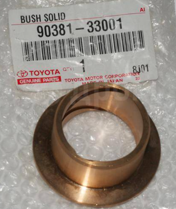

i use one of these for the spindle bearing and find it better than using the square plug on the knuckle housing. gets grease into the bearing which can also get noisy if left to get a bit dry. The grease also finds its way up over the Bifrield - be sure to use Moly grease too as Kernal said
replace with gun drilled birfs and use the spindle greaser tool.

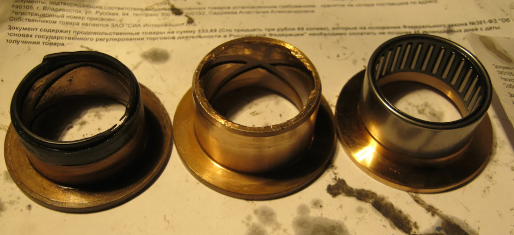

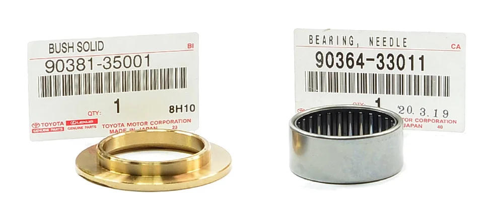

depending on what version you have some have a needle bearing inside vs a large copper spindle washer
VERSION 1
VERSION 2
comparison

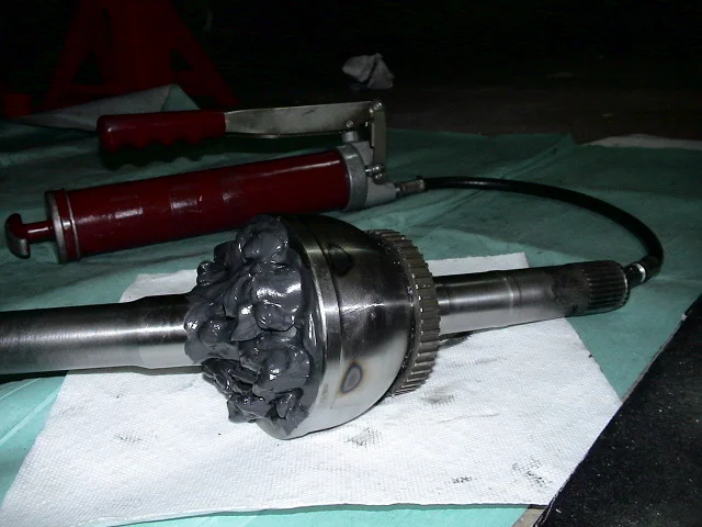

I thought the clicking Birfs in my 96 model were toast but swapped them side-to-side to get more miles out of them, that was 13 years and 95,000 miles ago.
They're now at 386,000 miles total on the original birfs and no clicking since swapping them side-to-side in 2010.
I did however have those Birfs drilled to make them greasable and pumped in a mixture of 60% Moly grease (Honda grease for motorcycle driveshaft splines) along with Valvoline Palladium 3% Moly, around half and half (they were compatible). I ended up with a ~30% Moly (grease) inside the birfs originally. I've added a small amount of Moly grease as needed over the years via the zerks. FWIW
