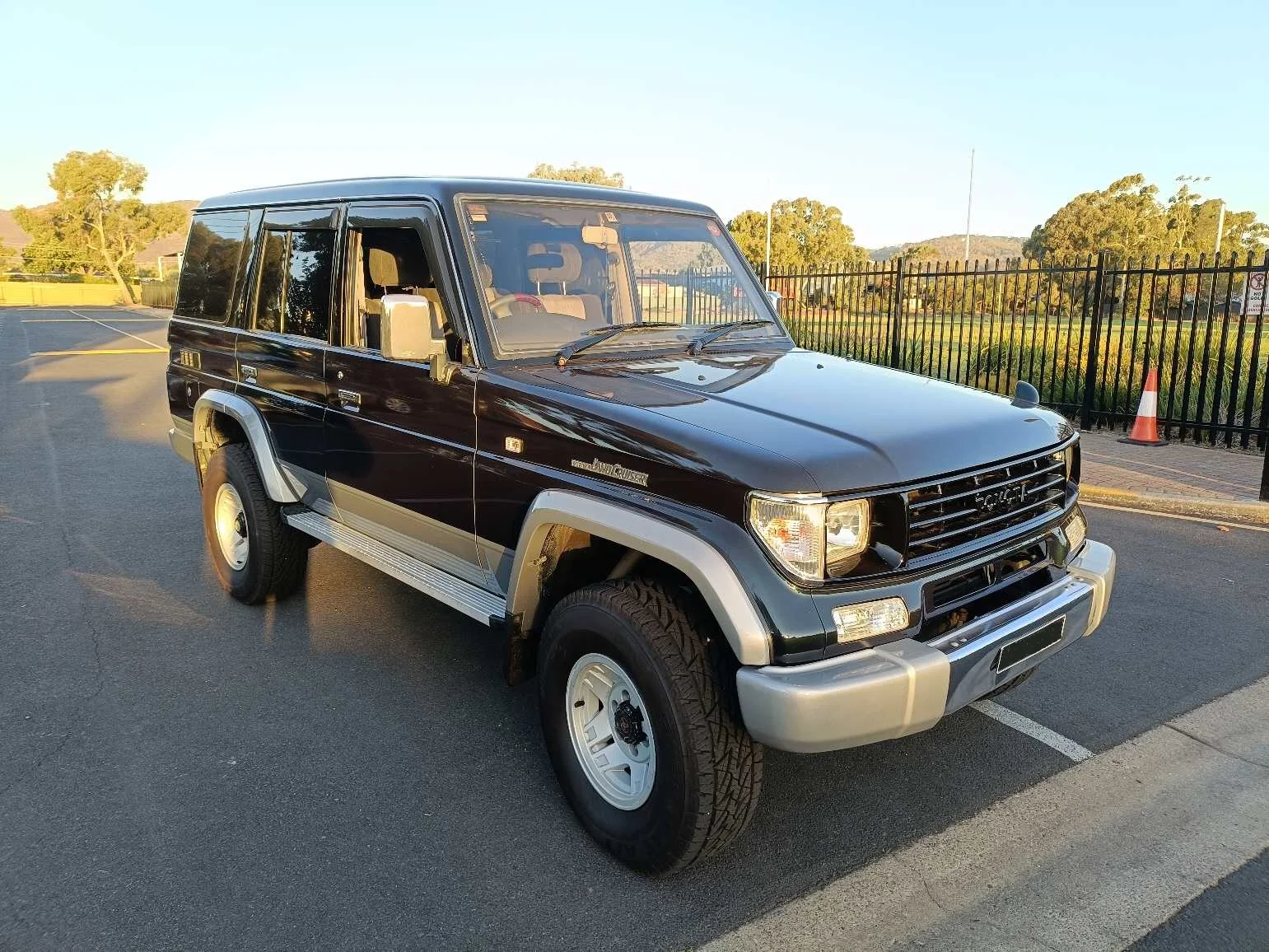

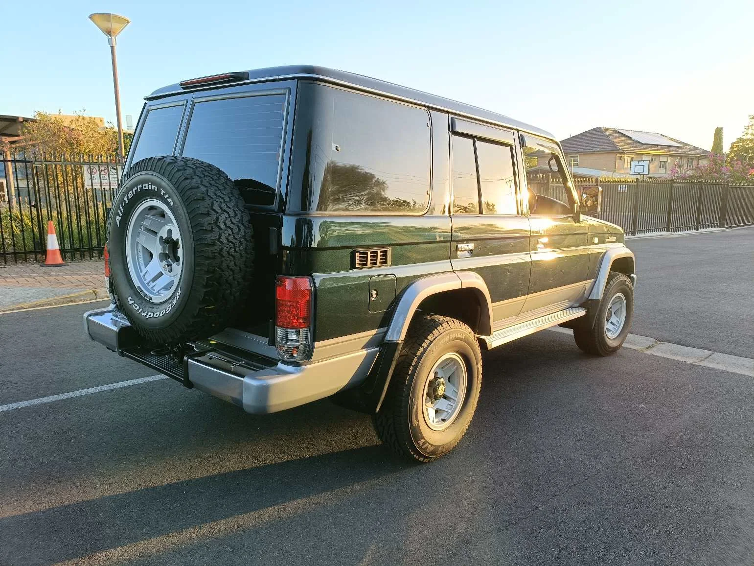

Hi All,
Finally decided to make the purchase of a KZJ78. This one is currently making its way over and should hopefully be here in a few weeks. This will be my new daily, and I have a bunch of mods planned for it so thought I'd just start a build thread for anyone that's interested and to seek advice along the way!

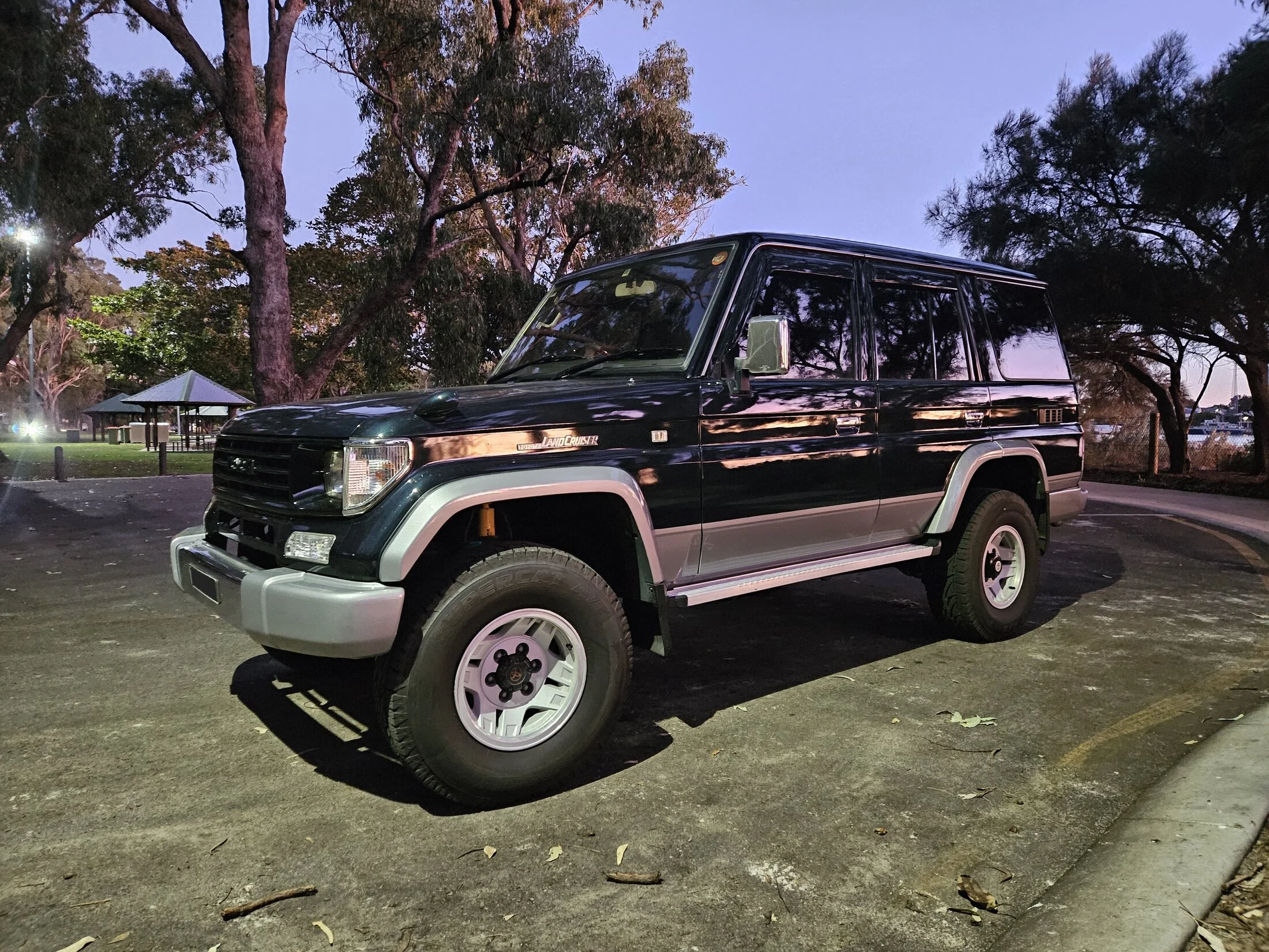

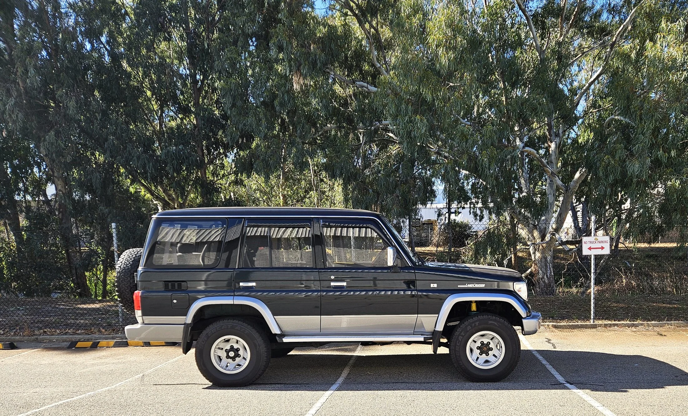

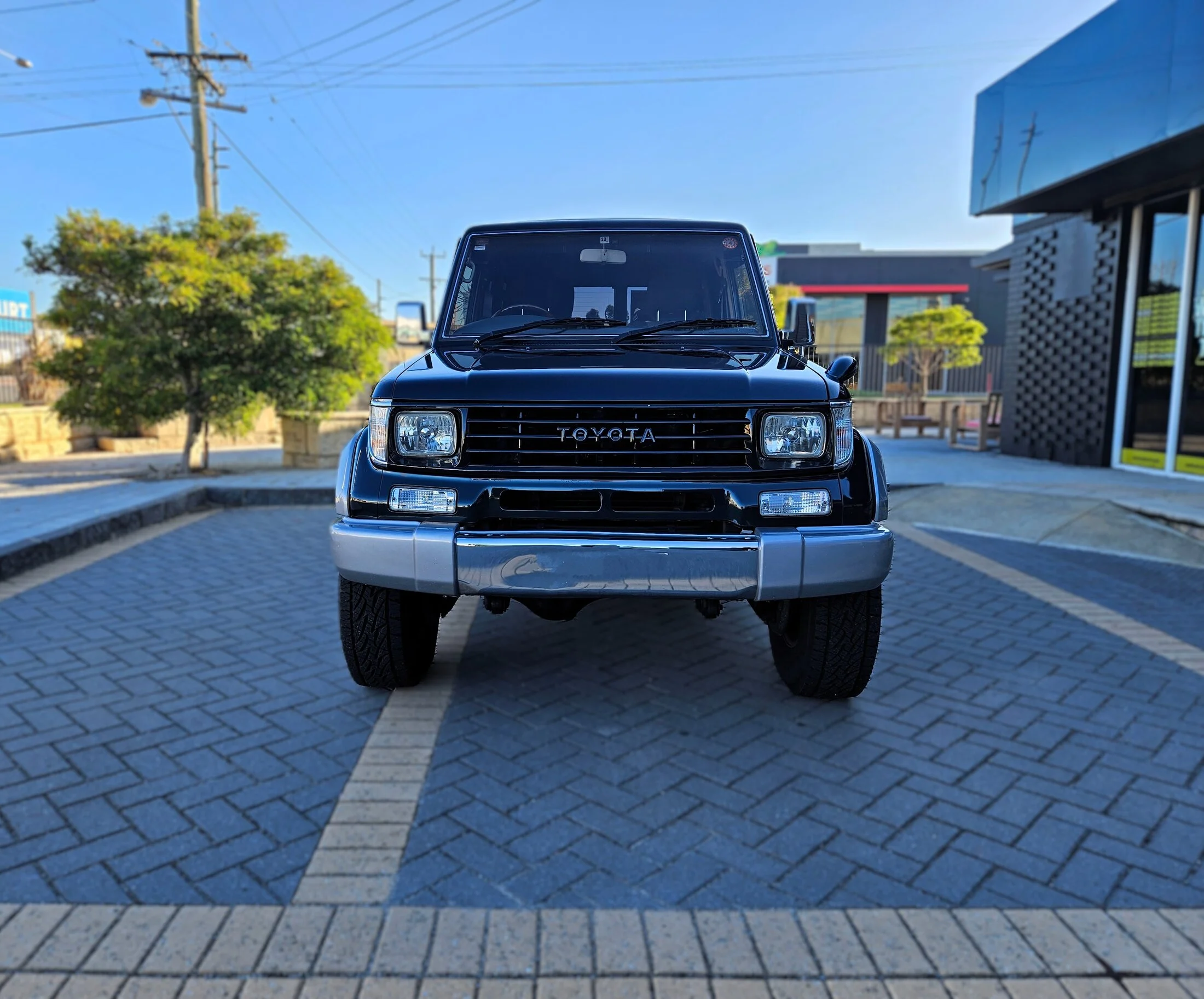

Car arrived yesterday - very please with the overall condition and great to finally see it in the flesh. A few signs showing its age here and there, but overall very happy!
First impressions: very unique car, a little slow haha however not complaining - still a fun car to drive around. The exterior conditon is great for its age, previous owner had given it a repsray in its original colour so paint job is almost brand new. Interior is also looking good considering, the previous owner had the seats reupholstered essentially in the original trim colours so they look and feel new.
I'll need to get the car over the pits soon to get it roadworthy and licensed to drive here. Also booking the car in for a full sevice next week hopefully to set a baseline given I don't know the service history of it, so just playing it safe for peace of mind.
Current mods:
  • 2" Dobinsons lift kit
  • Custom exhaust (I think 2.5" without measuring it) There seems to a some sort of a high flow cat & a resonator, then a muffler delete
  • Pioneer 9" touch screen (wireless Android auto is a life saver :P)
  • Upgraded speakers however unsure of brand - will try to remove the front dash cover to see over the weekend (may upgrade if I don't like them)
  • Pioneer underseat sub + remote (currently between middle and third row seats)
  • Limo tint - too dark for my liking and is illegal here so it definitely won't pass inspection. Will remove prior to inspection & replace with a 20% tint after
  • Rear LED tail light & all clear indicators
I ran out of time today and was losing sunlight quick, so only took a couple of shots...wil try to get more over the weekend:

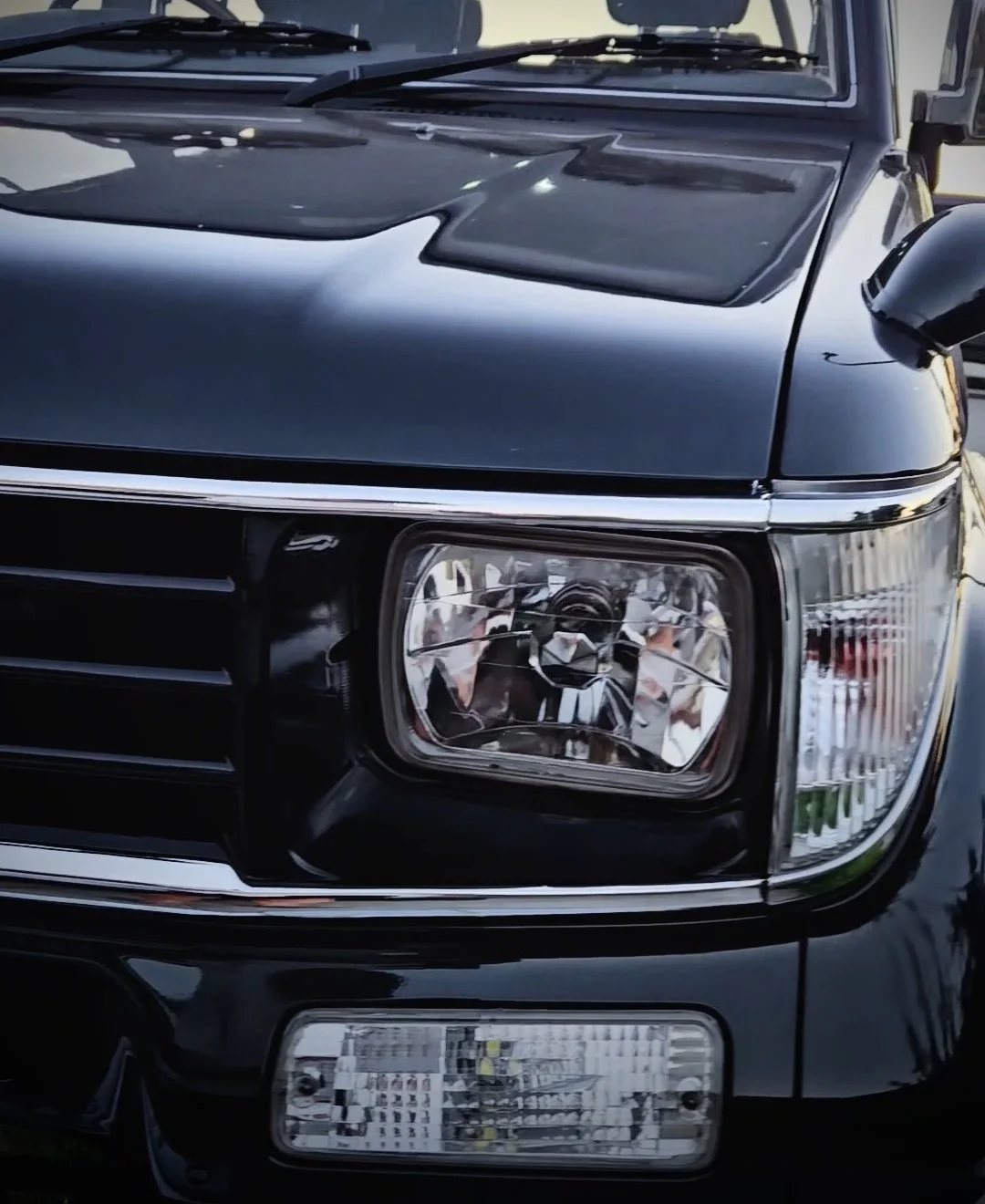

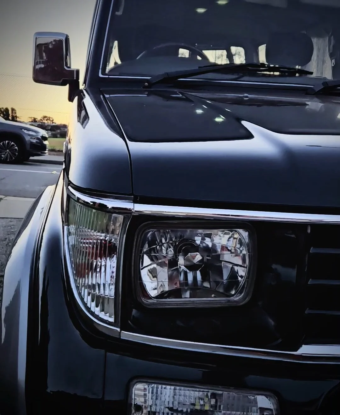

Gave it a wash today - the front grille is painted all black which kinda makes the 2x side indicators look disjointed. I plan to have the upper and lower lip of the grille chrome wrapped to match the indicators so it all ties in, and will also chrome the 'TOYOTA' text at the same time. I tried sourcing a replacement grille which has the chrome/black already but hard to find over here, so thought wrapping will achieve the same result I'm looking for.

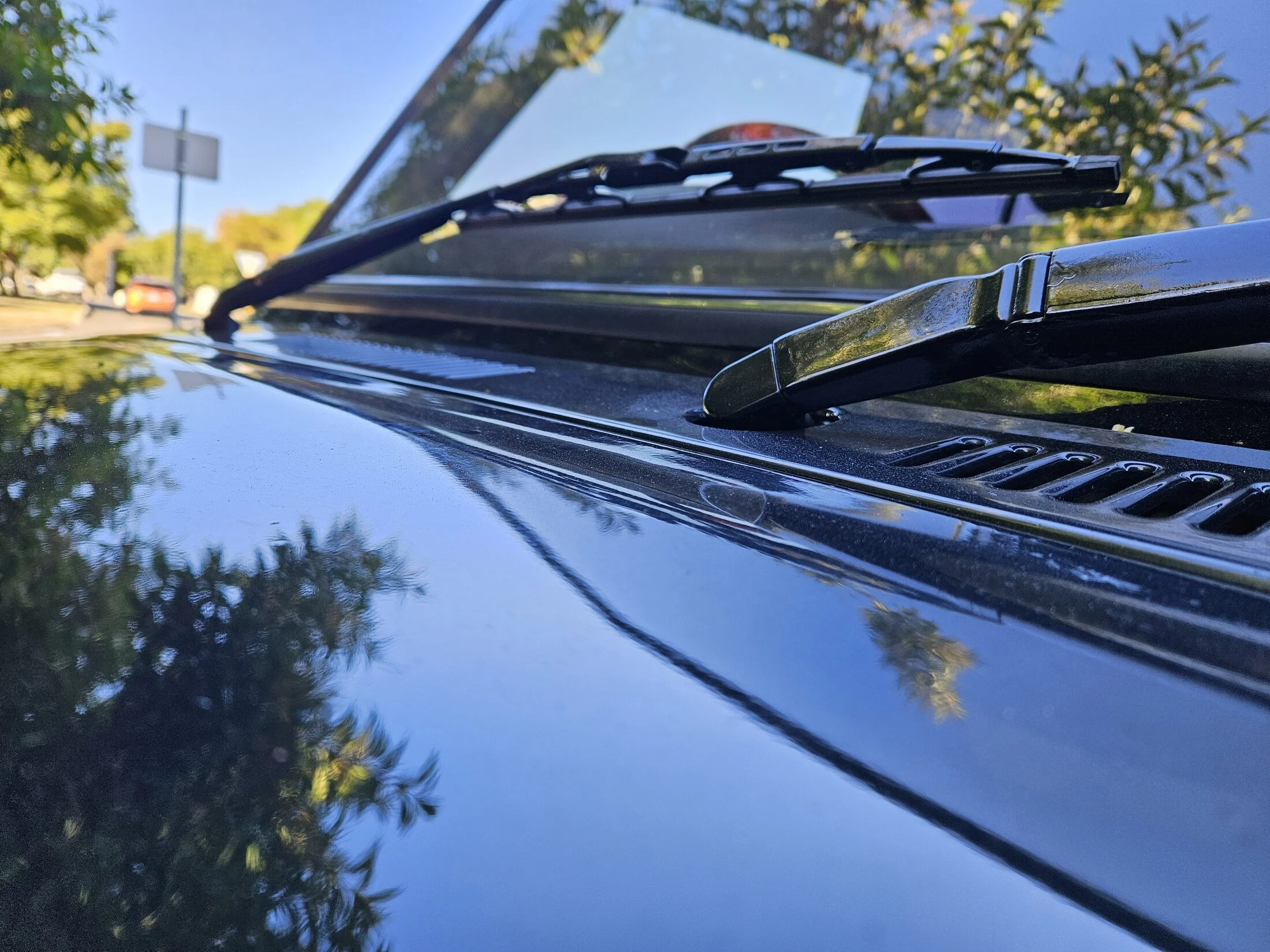

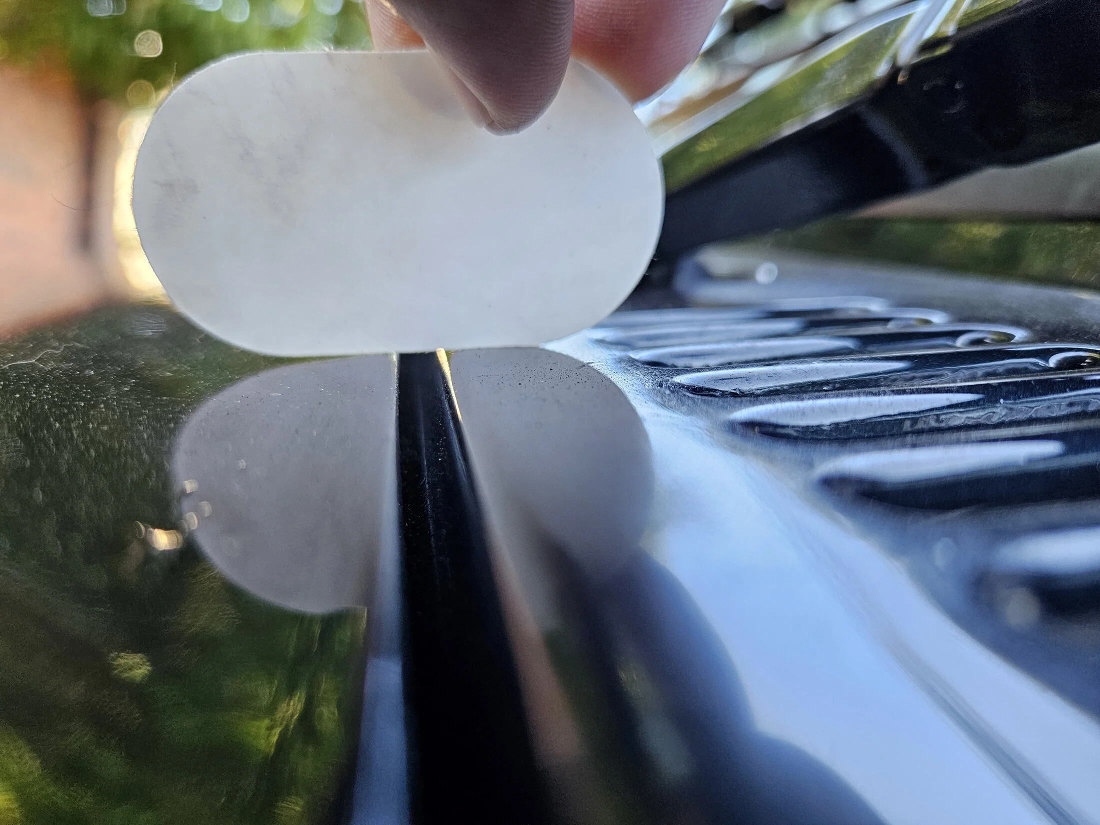

Also noticed a bit of rubbing in the middile of the bonnet with the body. The middle of the bonnet sits lower by approx 5mm which I think is causing the rub. Will get it looked at by a panel beater this week to hopefully straightened it back. Will post update photos when completed...
If you like the look of the current grill, you could also paint the chrome trim around the corner lights. I've seen that done a number of times. You could go an extra step and also paint the side mirror either body color or the same black as what was used on the grill. That would be a fairly consistent look and not particularly time consuming or costly.
Yep nothing wrong with the black grille, but I do prefer the chrome trim - I think it adds to the somewhat classic look I'm going for!

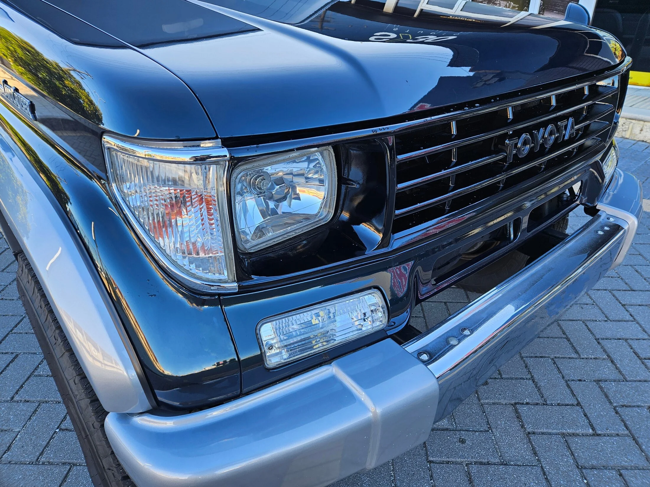

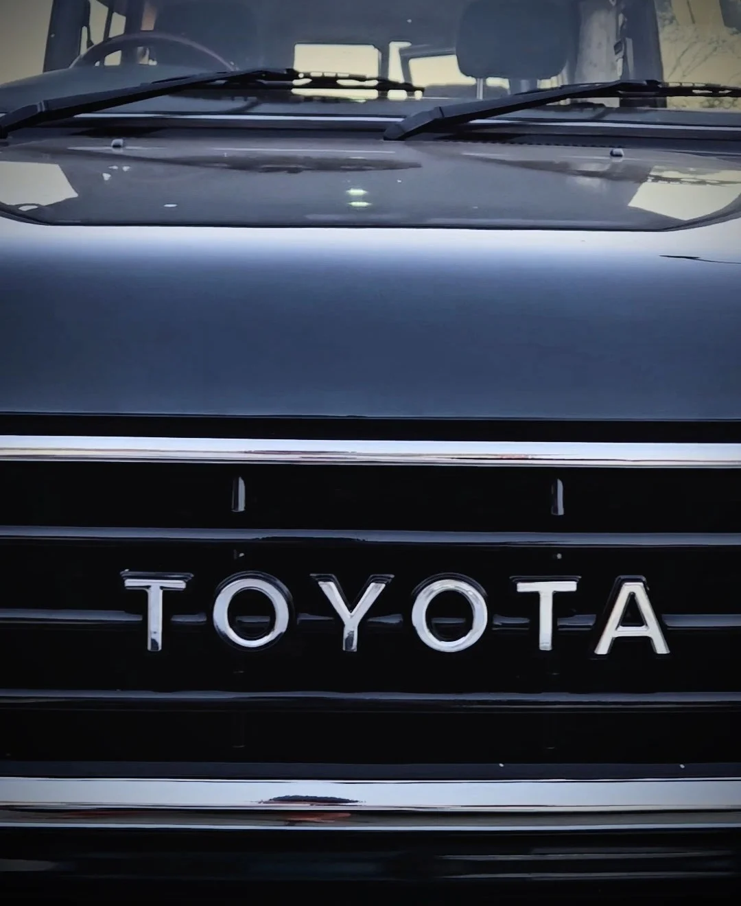

Update: had the bonnet sag fixed and the grille chrome wrapped last week. No more rubbing as it now sits flush. I think the grille now ties in well with the indicators.
Forgot to take a photo of the complete grille so I just extracted frames from a reel I made 🙃:

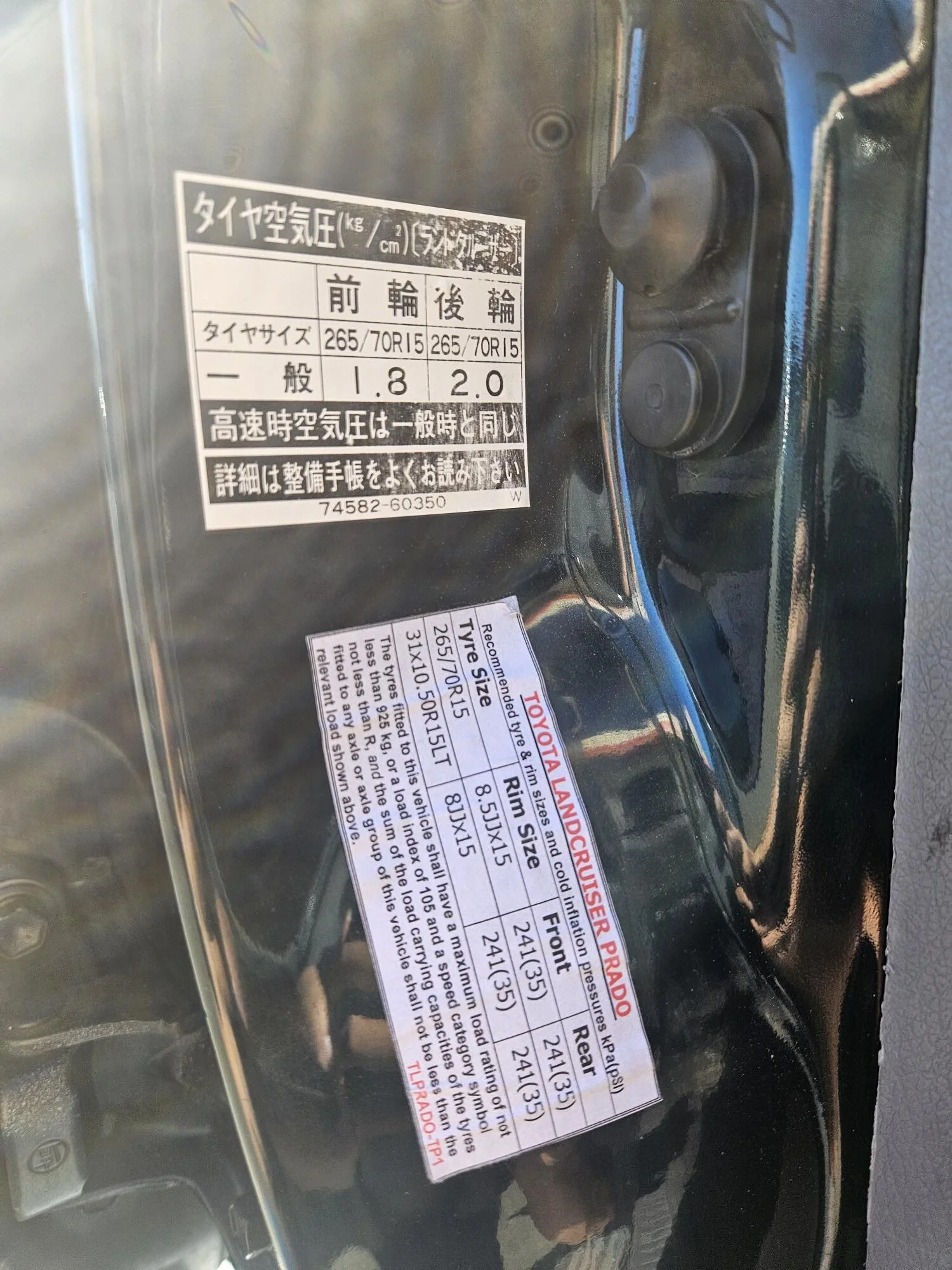

I found this on the driver side chassis, so I'm thinking the original size is 265/70/15 (or 30s) based on the Jap sticker. The english one doesn't seem OEM. A quick search online don't seem to have much tyre options for 32's that will suit the 15x7inch wheel.
Do you think it is necessary to change the gear ratio for 32s? This process is completely new to me so keen to learn. I do have plans to install a FMIC and upping boost/unichip if that makes any difference.

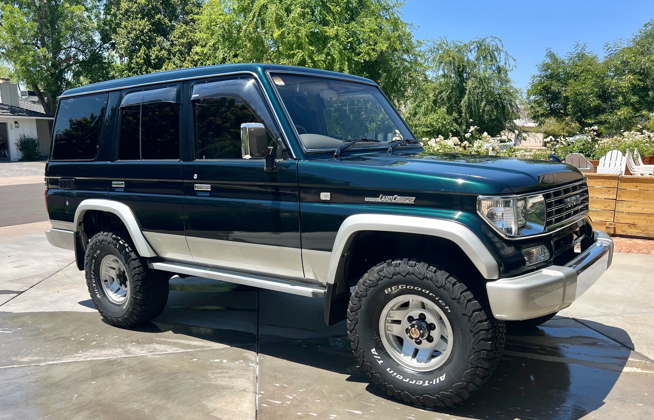

Here is the Prado I sold a couple weeks ago (not the one I'm driving today with the EGT gauge). I included it because it's the same paint scheme, similar lift, same OEM wheels. The wheels don't have spacers like yours, but the 12.5s without spacers probably extend outboard to about the same place as 10.5 with spacers. Looks are entirely subjective so it doesn't matter which I like, but this should give you a pretty accurate idea what yours would look like with 33x10.5 plus spacers.
Ah I will explore the tube route. I rather not permanently cut into anything if I don't have to. I'll still need to have hole for the EGT probe somewhere though...
That looks very tidy :clap: The 33s definitely fills up the well nicely. My only concern is the performance (or lack of) going up to 33s, and given the stock is wheel is only 15x7, many tyre options for 32s or 33s do not recommend fitting below 8 or 8.5. I take it you have no issues fitting on OEM? What about when airing down?
