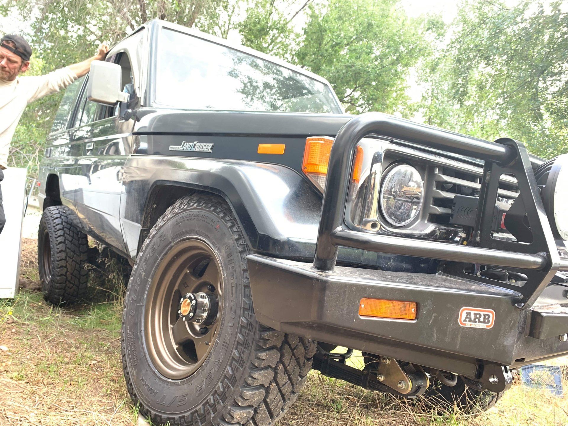

A 77 prepared by me,
View attachment 2355380View attachment 2355381View attachment 2355382

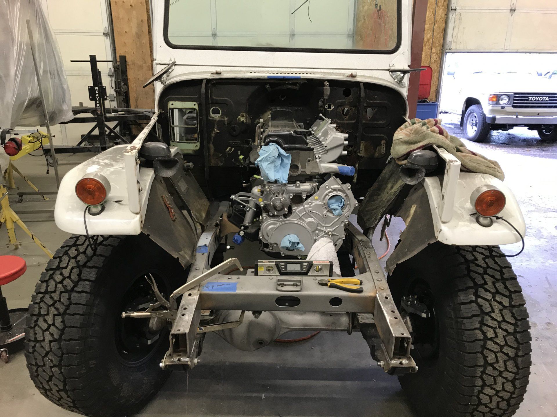

I am most of the way through installing an FT right now in a 1967 45-series pickup. We are running a GTurbo with 27psi, 250rwhp. 😍
