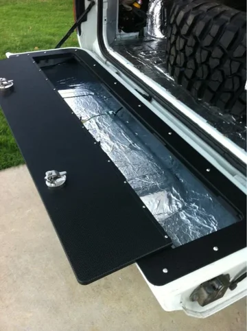

Have to celebrate the small victories, occasionally.

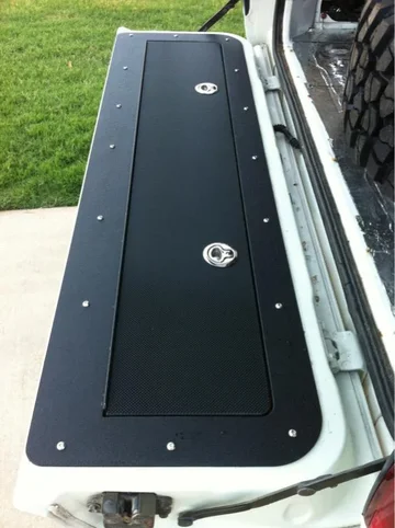

Tailgate weighs a bunch more, with the added WagonGear lid and deadener. Hinge reinforcement may be in the future.
Not sure how to carry the spare in the cargo bay, or if I could stand the smell of smeltering rubber. If it lays flat, takes all the room to the lower lip of the rear window, and standing up takes 35% of the width.
Was trying for a minimalist approach and avoiding a swing out, but drawing blanks on a permanent solution.
After scrubbing carpet for two hours, would like to enjoy the new car smell for, at least, a couple days.
Hats off to Kevin at WagonGear. Great product. Probably store in bags and pack full, since there's no much room for metal mesh and Quick Fist.

Like tailgate lid. Going to figure out side panels and storage means for, eventually.
