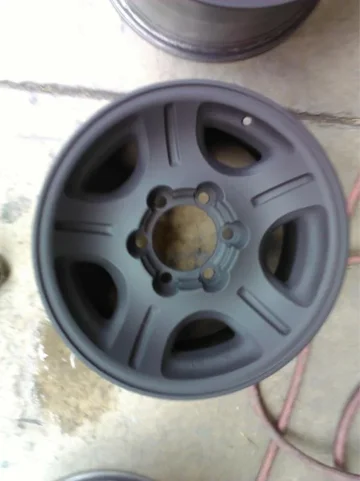

Wheels turned out good. Black, which I could've done at home, but oh well.

Painted. Long story, but wanted to rehabilitate to OEMish look, but after blasting, determined the pitting wouldn't allow for a decent finish. Guy suggested a flat black. They look pretty good, and not faulting him because I saw his other work, but I might have explored a used set in good shape, had I known.

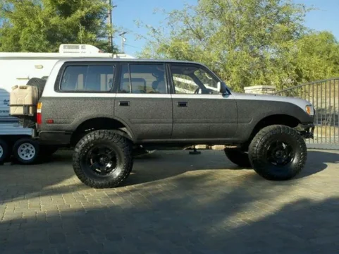

Pics shortly. Stopped to rip the front bumper off. I wouldn't advise running 345/75/16s without a lift, but it's, surprisingly, not as bad as I thought....until a turn.

Don't see how I'll get by without cutting fenders.
My bumpstops are set to stop the tire rubber on the roof of the wheel well. With that size tire you won't get anymore tuck. The 4" coil will have more compression left in it though. That's why I recommended a coil spacer to allow as much downward coil force to the dropping wheel. Which is where you need it and not to waste the coils energy. But you will only need to trim the back bit in my pic.
The other thing is your already using up the shocks full stroke anyway. Unless you modify shock position. There is no more usable travel to gain.
Kind of my concern was usable shock travel. Not opposed to modifying the front upper mount, IF there's a remarkable gain.

If you're out and about later or tomorrow, give me a shout, if interested in seeing what rolling ridiculousness looks like. The pics don't do it justice, then I'll have a witness that it only rubs a little bit. Hahaha.
The rear will easily use it all up. A stock front end- no way. Superflex arms - yes it will but... The new bushes have to losen up a bit. So travel gets better and better. Flipped and modified - yet to max the front out even with no shocks. 16" would be close but I settled for 14" as they where in stock.
