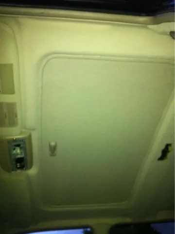

installing headliner
Monkey snack's...great job..
One more warning.... when you re-install your headliner...I used an awl to line up the holes and ended up dislodging a nutsert that rattles around ....driving me nuts.. I'm thinking about shooting expandable foam to keep it in place... Just letting you know;)
Lou
Thanks for the warning. Had forgotten to pull the tan covers by the front seat belts, so dropped earlier. Waiting on the call to pick up all.
I'd thought of expansion foam in rear hatch, because I can't find the friggin nutsert that's rolling around, or anywhere it could be, unless between the skins, inaccessible.

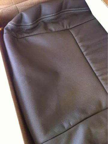

About the time I start to angry about, UPS drops off a package like this
And all's good in the world again.
Awesome looking. Wish I had done the headliner in leather, to match. Hahaha.
Picking up headliner now, and this is in for interior work.
Locked, 200k. Getting details from lot, and will post up in the FS by others.
I dropped off the seats and armrests today at the upholstery shop. Guy called me this afternoon to tell me all was going great and that Shanes kit fits awesome. I'm excited for the new, not stinky seats.
On the carpet, what did you use to clean them? I have a little Bissell and I was using that, combined with hose water to clean it but I was considering renting an industrial one to really get it fresh.
Good news, but I expected them to from thread perusals and talking to Shane.
Was rushing to get headliner before 5 and didn't open Shane's box until I arrived there. Interior guy said they looked nice. He's swapping front and second, console and both armrest for $200, with me delivering seats to him, uninstalled.
Can't wait to actually dig into box.

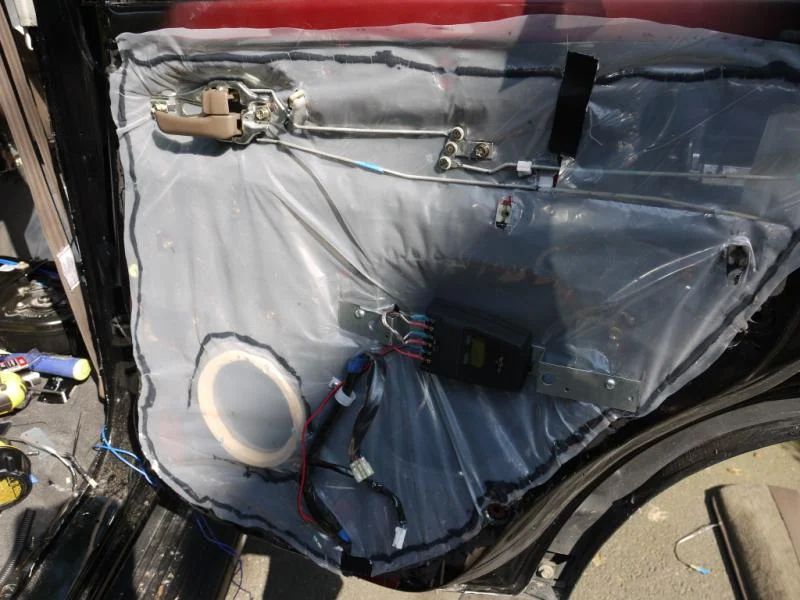

Also, when deadening, the inner door vapor barriers were accidentally discarded, and by the time I realized and went dumpster diving, it was too late to recover. (part number, for others).
Bought the last two fronts in the US, no known rears, nor ETAs on. Have thousands of square feet of thick mil visqueen, but not sure where the pockets on the rear are, so searching for pic.
Anyone know if Vulkem would suffice to adhere to door?
I know it'll inevitably cure, bill stink for the entire duration, which will be prolonged in the heat. Other suggestions?
I didn't know you could order the barrier..so I just cut my own and used 3m Strip-Calk... recommend by my a body shop guy and works great... It's really hard to work with in hot weather ...it gets really sticky ....so I had small cooler that I kept tossing it back in during the install
Lou
Sent from my iPad using IH8MUD
Thanks for the pic and product advice, Lou. Makes good sense on the strip caulking, now that I think of it.
