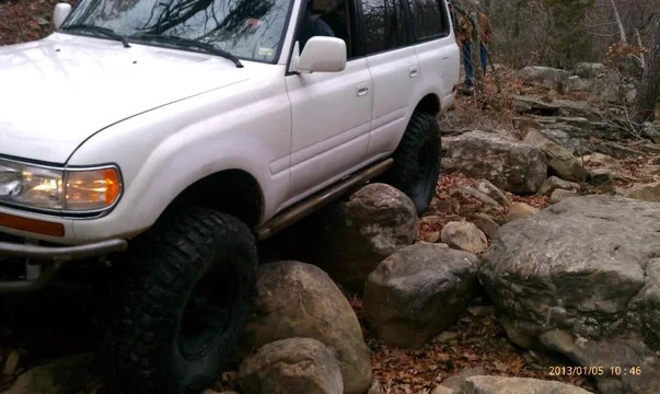

Here are a few shots from this weekend. In all fairness to Mark and the guys, you did come down hard as hell on the front bumper, and the Sliders, and the links, and the rear faux bumper, and the.... But we had a damn fine time. First time I've taken such a nice 80 series through Green Mamba, and backwards at that!

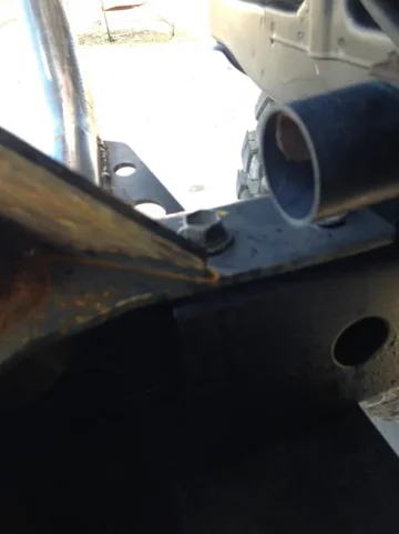

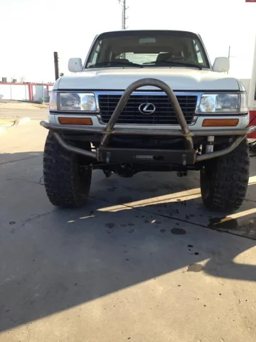

Looks like you bent the passenger wing. What exactly happened? And what did you bend?
Whole corner came down on outer edge of wing.
Best I can tell it bent wing up, but also the channel across the front frame rails.
Have no clue how to straighten, but it's shim-able, if I can get the bolts un-embedded.

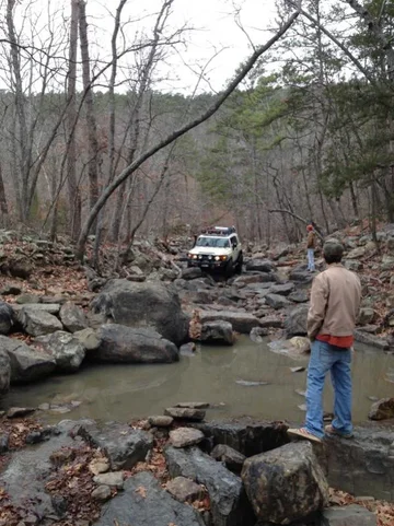

Hey Chris, did you get any pics of Bailey and I? I got to spotting and didn't think of giving Bailey the phone! Who was the guy in the FJCruiser?
Man, I saw the tail end of your and Garrett's at the onset, then never saw again until I was stuck.
Every pic I took.
That one taken so I could post this
On FJCF, considering the recovery done, involving an FJC and lack of payment for said recovery, that initiated the invite with y'all.
Hornsfan (Ryan) was in the FJC. Have a video that will post after this, that I couldn't figure out how to rotate before he posted to YouTube, highlighting the carnage.

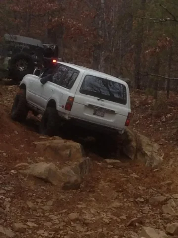

Ryan sent this pic, which doesn't do it justice. Haha.
Posted on FJCF
Good times. I was definately under gunned out there with my little tires and clearance.
[ame=http://www.youtube.com/watch?v=Iwlp0SHQp5o]Boulder dash - YouTube[/ame]
[ame=http://www.youtube.com/watch?v=n8pc1YqYIIQ]Boulderdash2 - YouTube[/ame]
The shelf that's in the video and the 40 and Jeep are depicted on is what kissed the rear frame rail......hard.
Maybe where I got into rear shaft, but hard to say.

Don't worry about the diffs, just make sure the ring gear has a proper guard and the rest can take it. Just keep make sure the studs are torqued before every wheeling trip as they will loosen themselves each time you land on your thirds.
And by the way, in no uncertain terms, it ain't the bumpers fault. Surprised it maintained as well as it did.
Was a hard hit. Chit happens.
Everything has a bending point, just trying to see room for improvement. Looks like we could add an internal gusset inside the frame rail to help reduce twisting.
For you I suggest pulling the wing down using a truck or forklift with a strap. Once it is in place I would weld a side gusset inside the frame rail while the bumper is still bolted to your truck.
I'm surprised at the trail rash to the diff faces, honestly. I don't have a lot of faith in the TG guard, since it's only on the face, but may build up welds along the drain ring, and look into one of the stouter versions. Heard it's more critical with 5.29 s to protect, and I need all I can get.
Had thought I could run a strap around bumper, then drive forward on strap to force submission, but will be cautious however.
What I was thinking was pulling straight, as described, then welding plate along the bottom and top of bumper returns, on the inside of the frame rail. End result, a channel that the frame rail slides into.
Is that what you're describing?

Yes that's exactly what I'm talking about welding a plate inside there the frame rails.
Would it be wise to box all the way to where the tubes penetrate?

I would box all the way forward seeing that you've bent it once already it has been weakened. Need as much additional strength as you can get.
