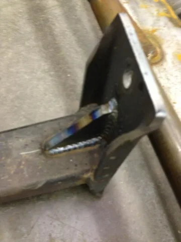

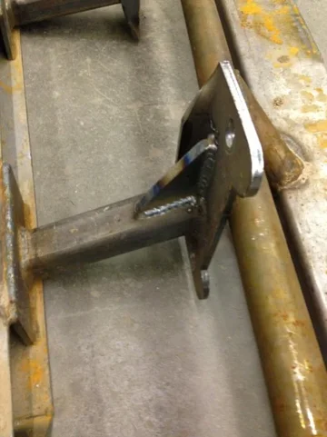

Sliders done and ready for paint.
Can't put too much larger a gusset due the lip on rocker, but a little added strength.
Hoping to have diff armor done today, bumper straightened and gusseted tomorrow.
