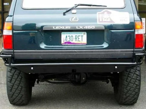

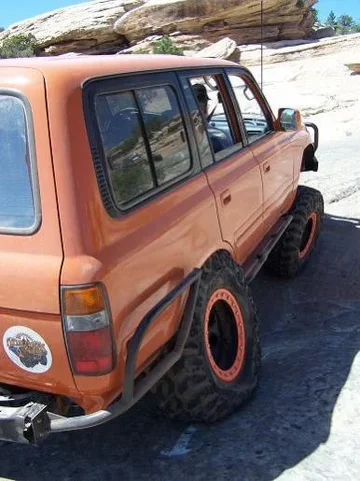

Not sure whom to credit, but considering a rear along these lines.
I have no reservations about moving the rear crossmember forward, nor welding supports back to frame. Hope to follow the body lines and gain clearance.

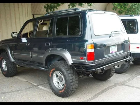

Didn't you have a rear bumper on there at some point? The tube rears listed above really look good to me however I find it difficult to love the look of the fronts on a beast this size. After owning the ARB I've realized that the shortcoming is the giant amount of metal hanging out front. Keep it small but also provide some protection for the headlights and grill.

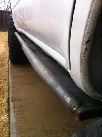

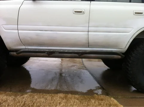

I've not had sliders until Friday, so have avoided rocker panel running runs. Think I'm going all in with these, though, and welding to the frame. Haven't had a chance to bolt them up, but once they're finally positioning is determined, getting it on.

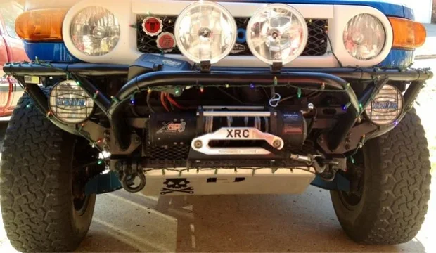

In case you hadn't seen Connor's FJC, still sporting your old tube front, how ya like these apples?
Wasn't thinking I could live with the tube look, but it's grown on me.
Thinking once the inner wells are coated black, it'd be less intrusive, but have come to grips with not entering her in the fair, proverbially speaking.
Drivers side slider fitted

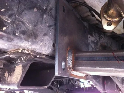

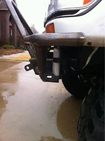

Passenger side needs to be modified. I assumed incorrectly on where the support would tie into frame, and it's directly under the exhaust clamp.
After discussion, think it'd be more secure to chop the support off, bolt slider up, bolt "foot" to frame, then bend around, but open to suggestions.
