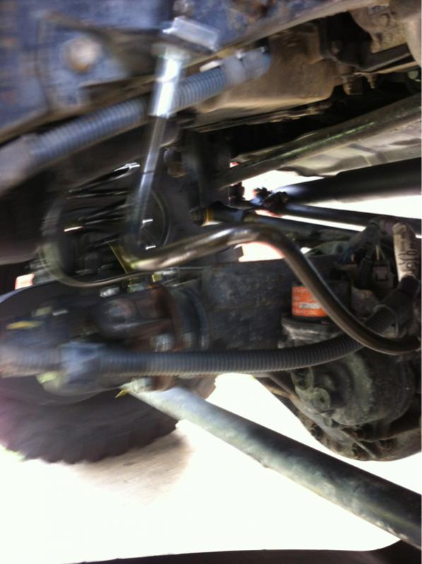

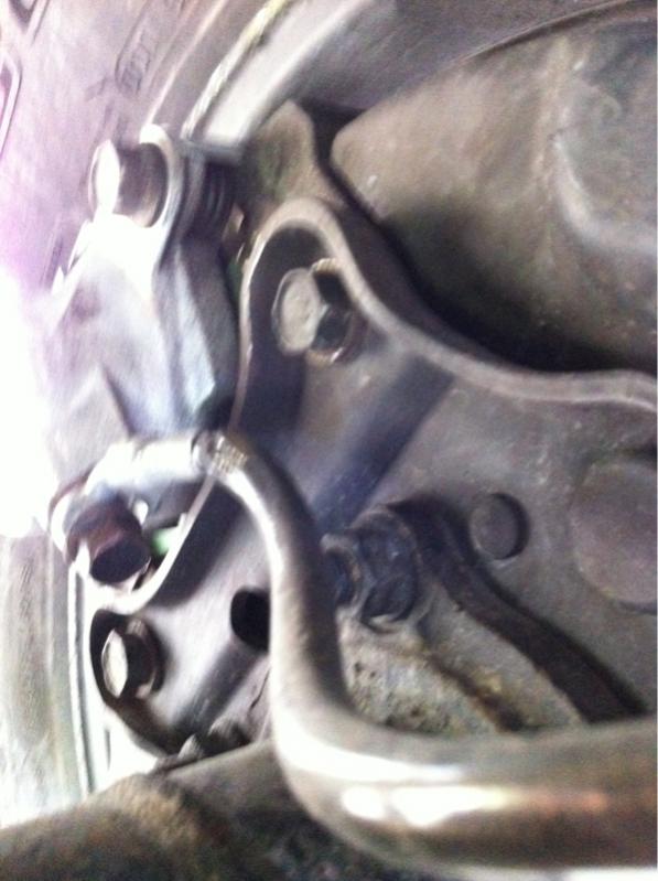

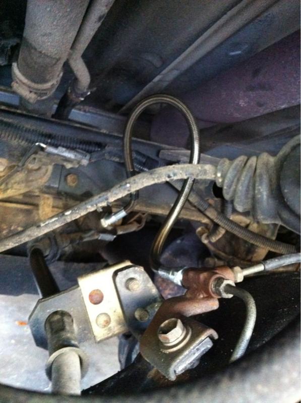

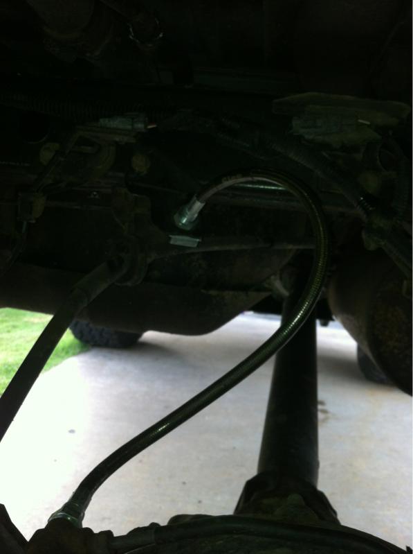

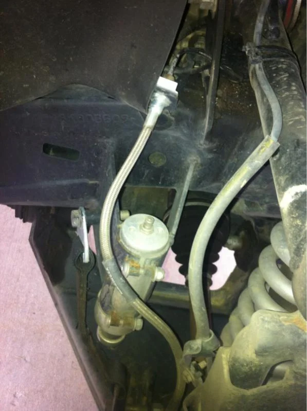

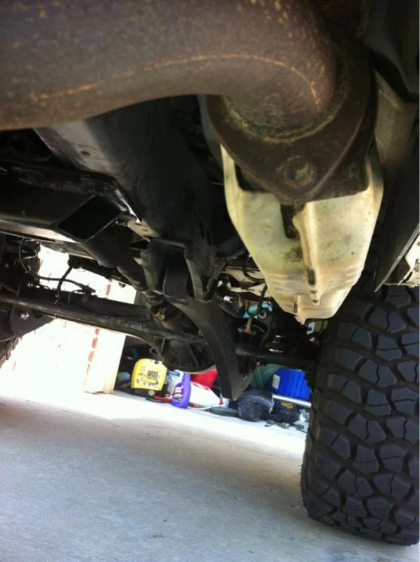

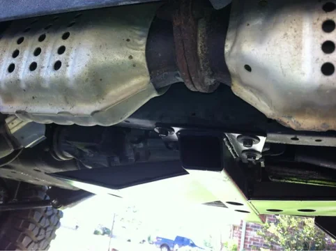

Looks great Chris! Once lifted, did the issue with the rear brake line and exhaust get worked out, or still a concern?
Thanks, Rob.
Before
After
Not a concern, anymore.
Reminds me I need to do something about an emergency brake extension.
What is a concern is the cracking plastic on the stainless lines, primarily because they've only seen about 500 miles.
Both rear caliper lines rubbed in the OE position, so I modified the method temporarily. Started to fray the stainless braiding.
The front frame to axle line I can't really explain.
It's cracked and no good reason I can see, unless the exhaust radiates that much.

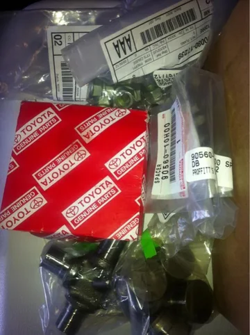

Dropped drive shafts off for lengthening, ujoints, and rebalancing.
Front needs 1.8", rear 1.25".

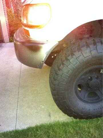

In an effort to temporarily put lipstick on the pig, attempting to make the front bumper work, and trying to mold the corners into submission is a PITA.
Have tried to buy the DS corner to replace the one the 345s ripped off in traffic that was run over, to no avail, so cut, filled, and molded with a butane torch.
Looks better in the pic, which isn't saying much, but looking for a plastic filler before rattle canning flat black. Any ideas? Bondo?
Tube fills the wounds pretty easily.

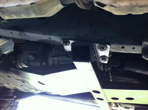

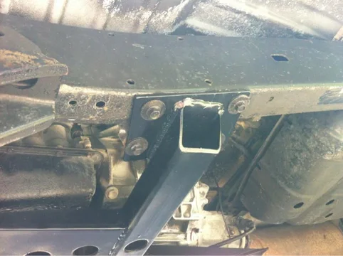

Chris, will you post up a few more pics of your t case skid? I would appreciate that as I am trying to see if it will interfere with my sliders. I don't think it will but I want to make sure.
Jon
