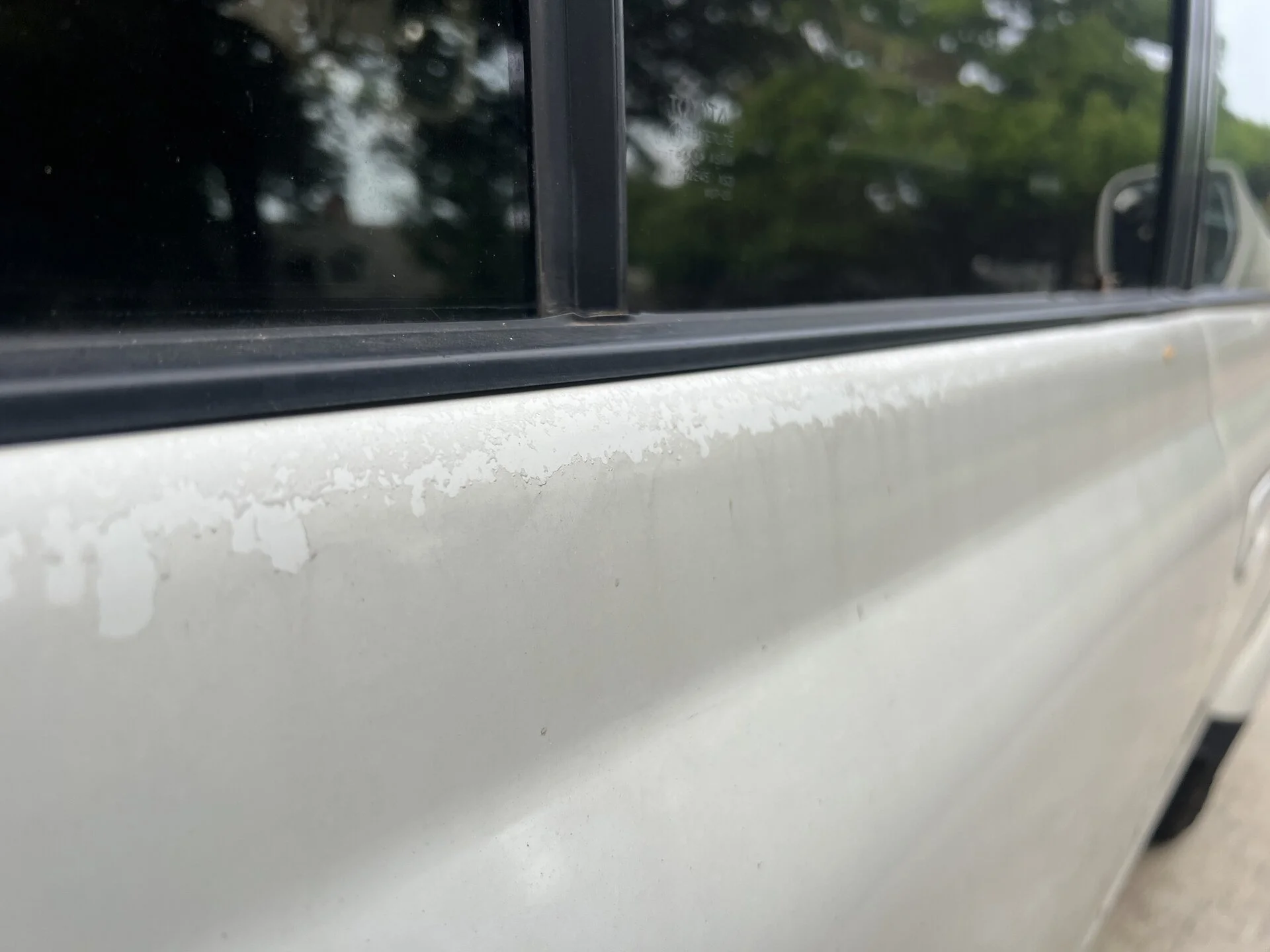

If you have peeling clear coat then the vehicle, or what's peeling, has been repainted and the body shop did a two stage paint job, color coat then clear coat. The 045 White 80 series vehicles all left the factory with single stage paint, no clear coat (and no factory options for a different type of white paint job).
Been discussed before but most shops today don't know these came with single stage paint and/or they don't know how to paint a vehicle using that method. IME they (the bodyshops) won't believe it if you tell them the (045 white) vehicles came originally with single stage paint.
Or they can't use single stage paint anymore due to local regulations. Most everything today is water-based with clear because of that.
Absolutely a re-paint. At least that panel.
Is that peeling paint or clear coat?? Whatever it is, it's seen better days, likely a cheap material whatever they sprayed on it. Can you post up more photos?
Definitely clear.

Since it has already been re-shot on that panel, I’d block the affected area down with 1500, cut it with a pad and compound and re-shoot a 2k clear over the top. Use some more compound and cut down the orange peel and blend it into the rest of the panel.

There is definitely clear coat on it because it is just starting to peel on the flares and on one door.
Have these parts possibly been repainted (opposite side of known PO damage)?
I have a 96 (8/95) in black. Was there another code for black? I also have the "chrome edition" if that makes a difference.
Definitely a re-paint.
