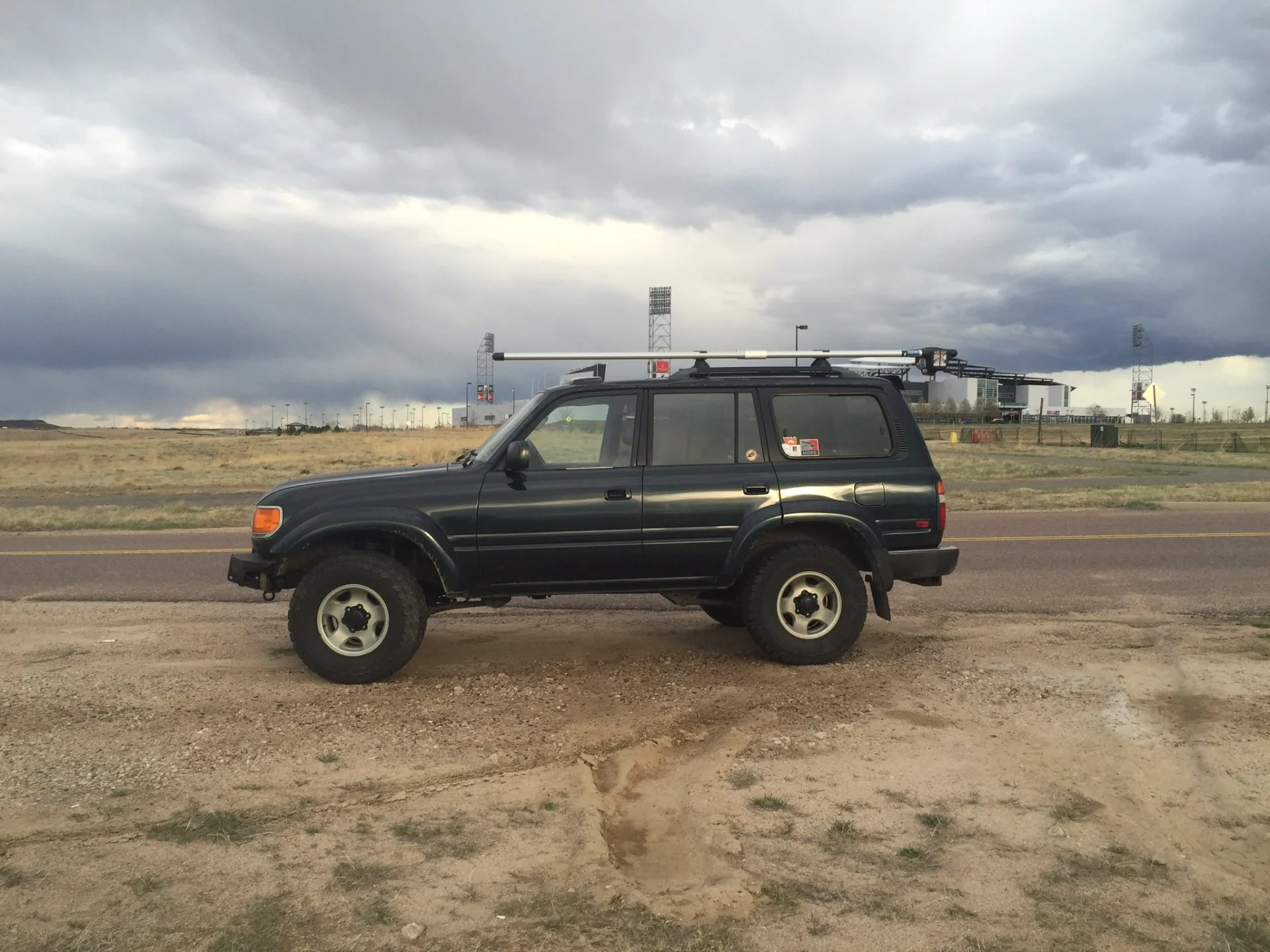

I actually don’t like driving my 80 on hwy drives (vintage auto NVH) yet I’ve completed the most long distance road trips in my 80 out of any other car I’ve owned* simply because I love driving it the most if that makes any sense.
*200, GX, 4th gen V8, 510hp RRS, etc
