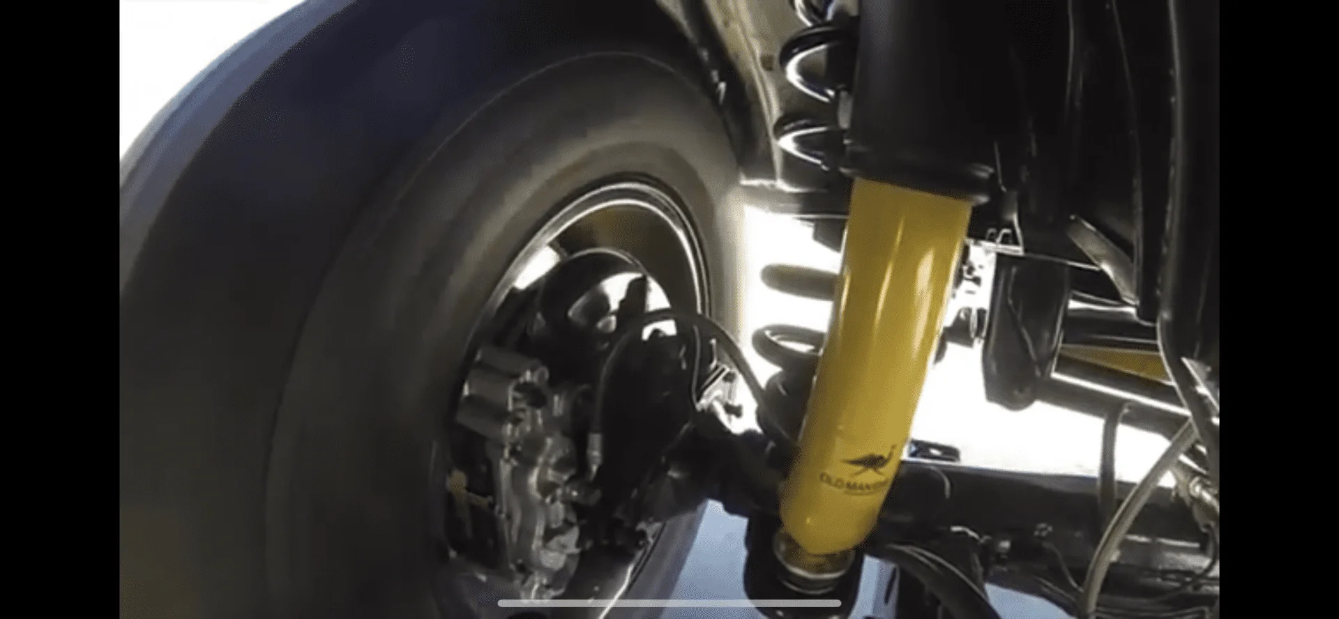

Took a screen shot of this John ward video of a 80 built by tlc.
I don’t know the make but it looks like the own backing plate is there.
I've heard Jonathon Ward sells kits. Check with them.
I don’t know. It looks like the brake shield is missing.
If they went oem why wouldn’t they keep the shield?
First thing I did when I rebuilt my knuckles was cut off the shield.
