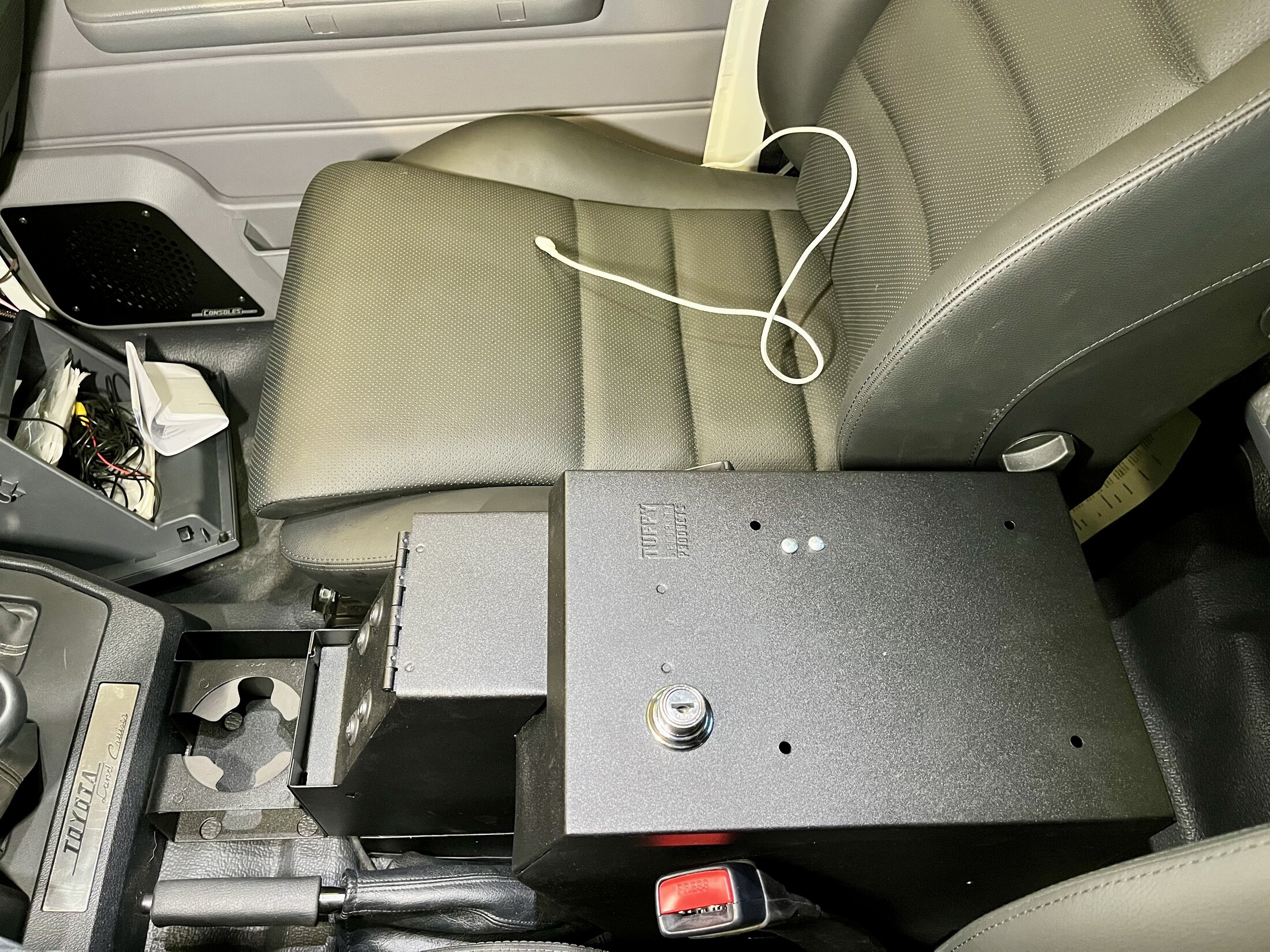

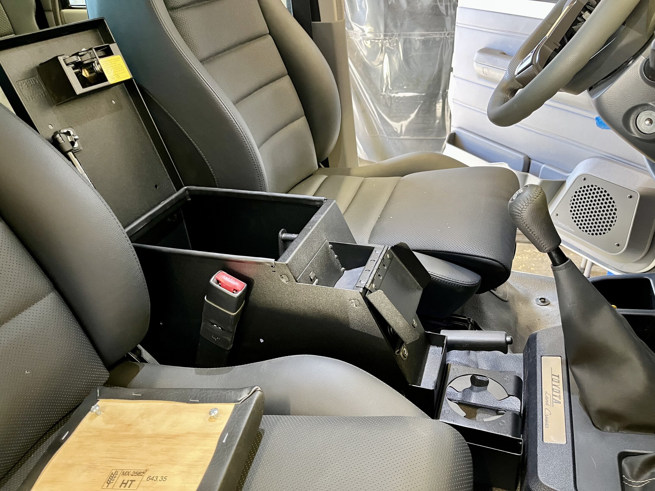

Finished custom fit Tuffy console.
Still need to attach the top pad I guess.
Seat cooler/heater switches.
Cubby
Cheers
With the pad.
We did some things to help it not rattle like most Tuffy consoles.
Cheers

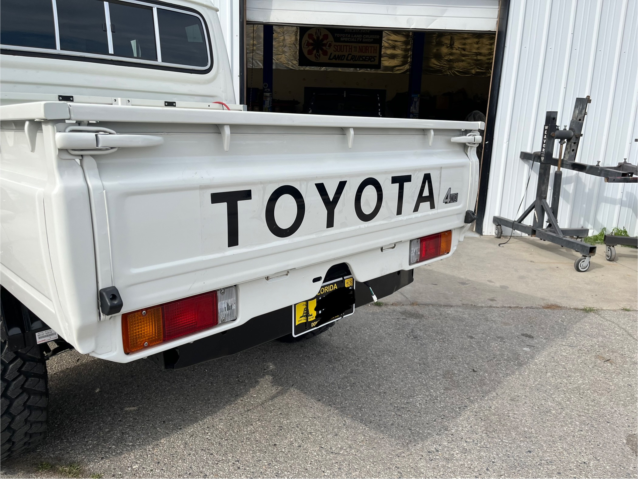

Toyota only makes this in red and white. Doesn’t matter what color you buy, those are the only two colors available for the tailgate sticker.
So sticking with the theme on the Cruiser we had these made in black.
Cheers

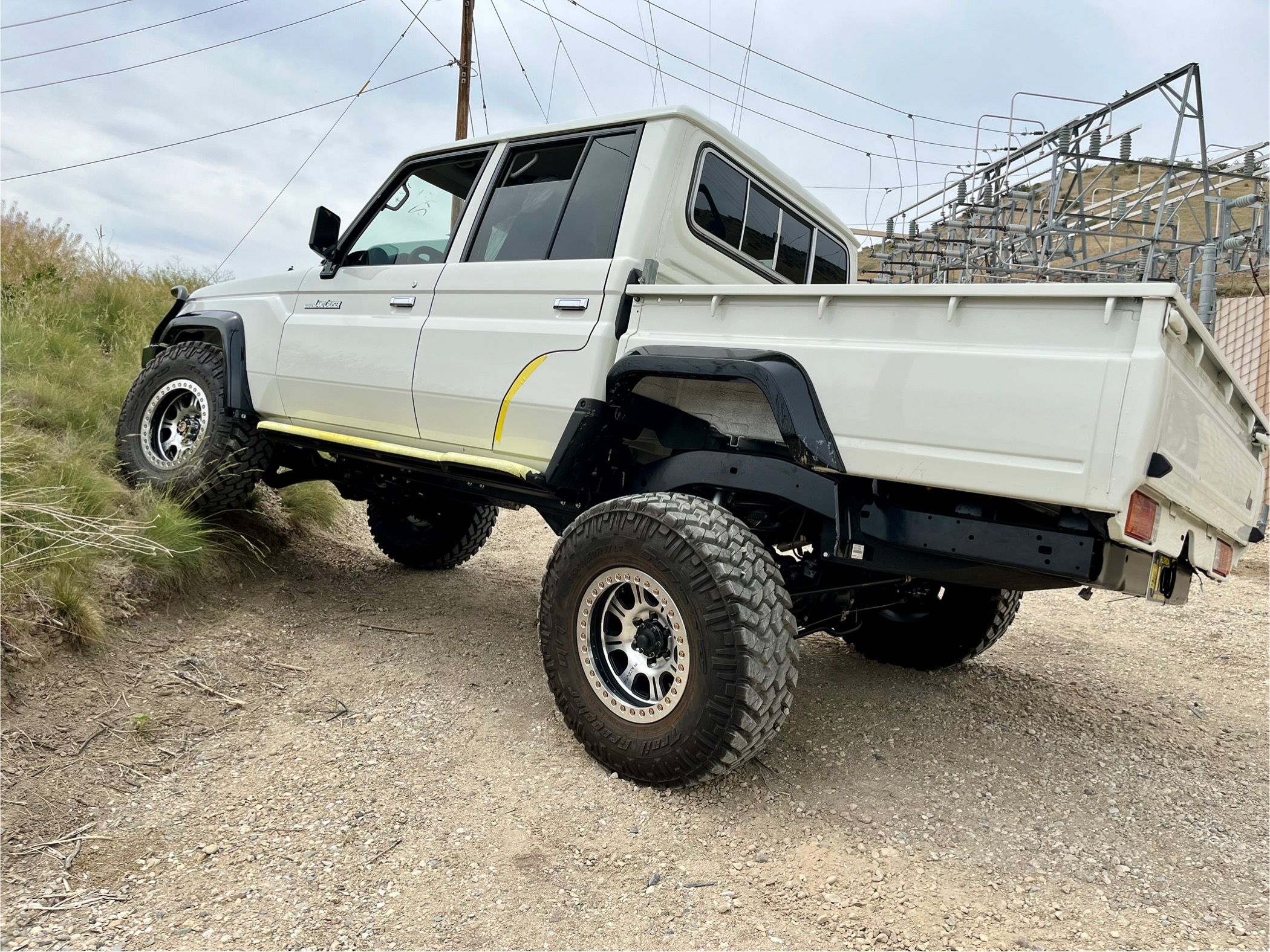

Alrighty, did about a 175 mile drive today through the mountains. It’s just the kind of driving the Cruiser needs for break in. Up and down the mountains with 5,000ft of elevation gain, multiple passes and climbs with a good load on the engine, 40-60mph Cruising.
At the top of one of the passes is this little dirt road up to a fire lookout, I drove up it a couple miles just to get off the highway and take a break, take some good pics too!
