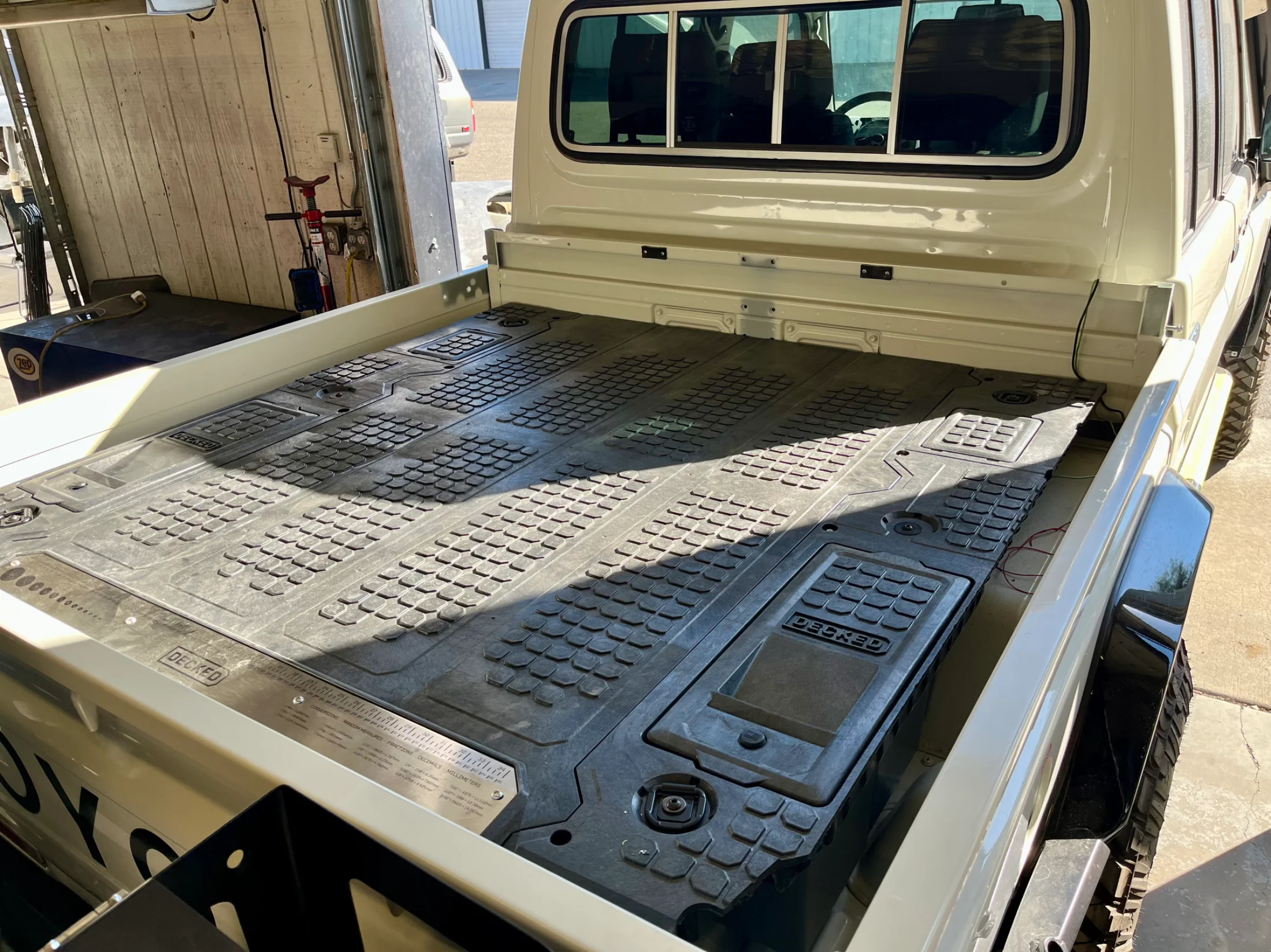

So the Decked is for a 05-23’ Tacoma with the 5ft bed. It’s the closest we could find to a plug and play system. It did require some plastic carving between the wheel wells at the front of the bed to fit it.
Here is how we have setup the mounting, no holes drilled in the bed to do this.
The fridge is getting mounted to a drop down slide. The fridge is a National Luna 70L fridge/freezer combo. It was decided to not do anything with the side trim on the top of the Decked too. Such as get it to go all the way to the sides of the Cruiser bed. So we will be leaving the gaps on both sides of the Decked which in my opinion works well for stuffing gear along the sides such as muddy boots.

You can order full-width "wings" from Decked and trim to fit your full bed width.
