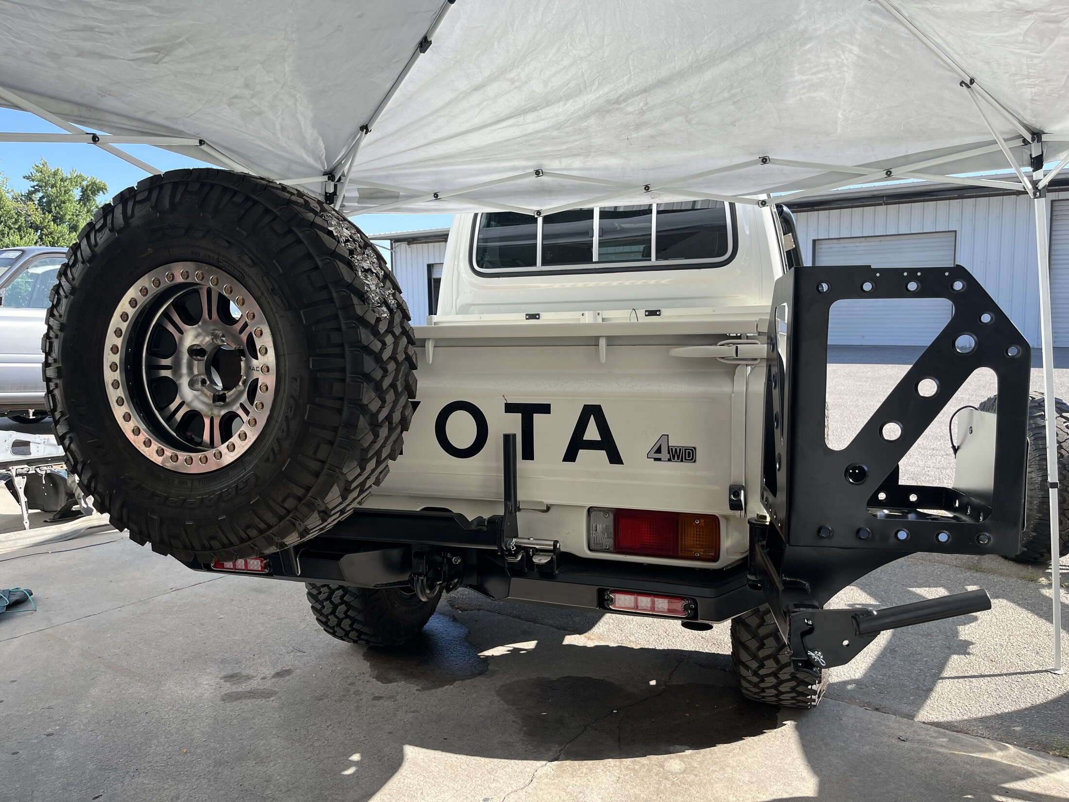

80 series tow hitch.

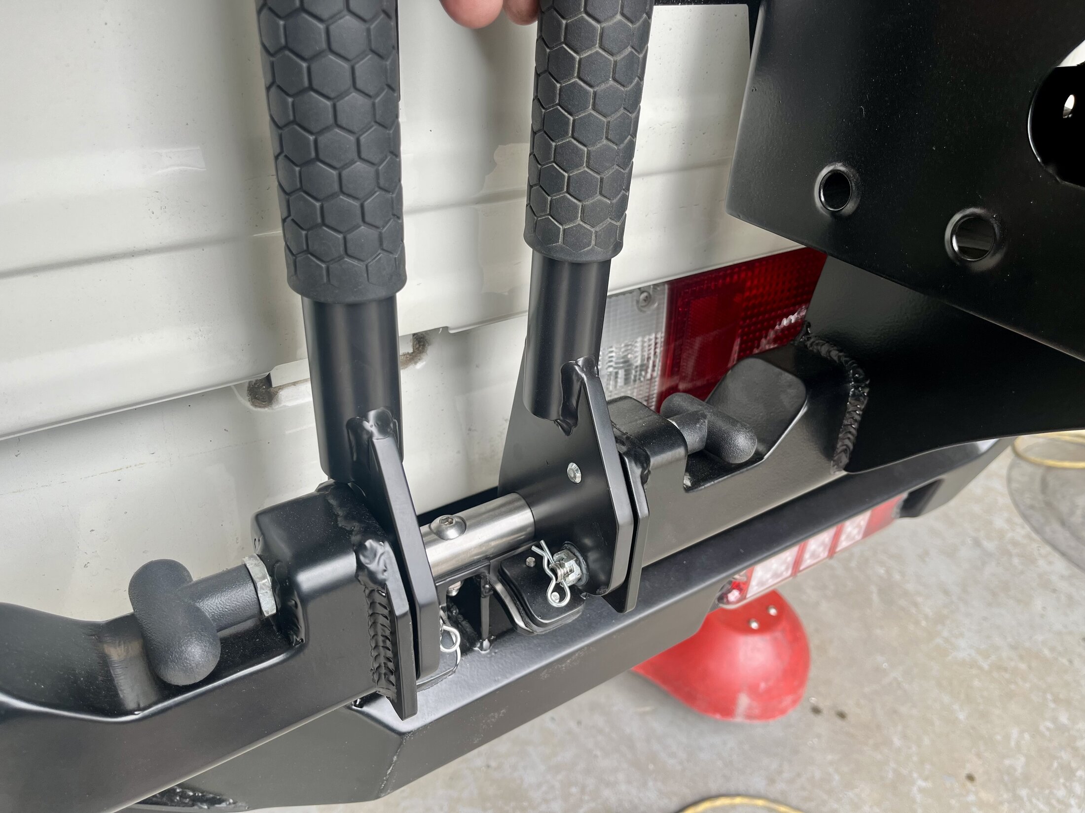

We had the handles for the carriers cerakoted with a certain cerakote that is very slippery. Seems to be working well. I think we will just change the castle nut pins to cotter pins and call it done.

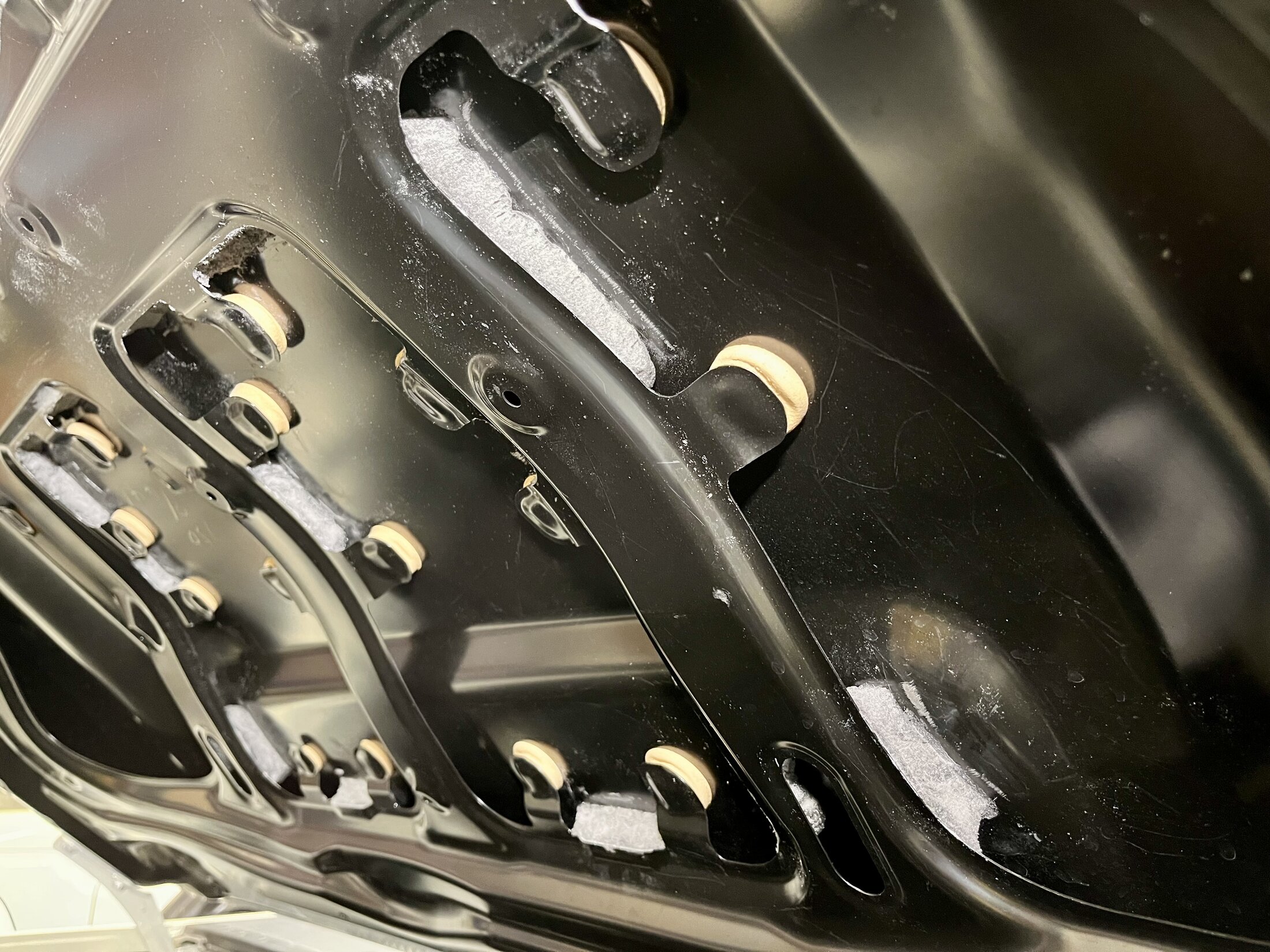

Hood is getting painted next week so we went ahead and sprayed some hood anti-rattle foam. It’s a 3M automotive product, the grey stuff. The tan is OEM.
Yes we trimmed it back after spraying and curing.
