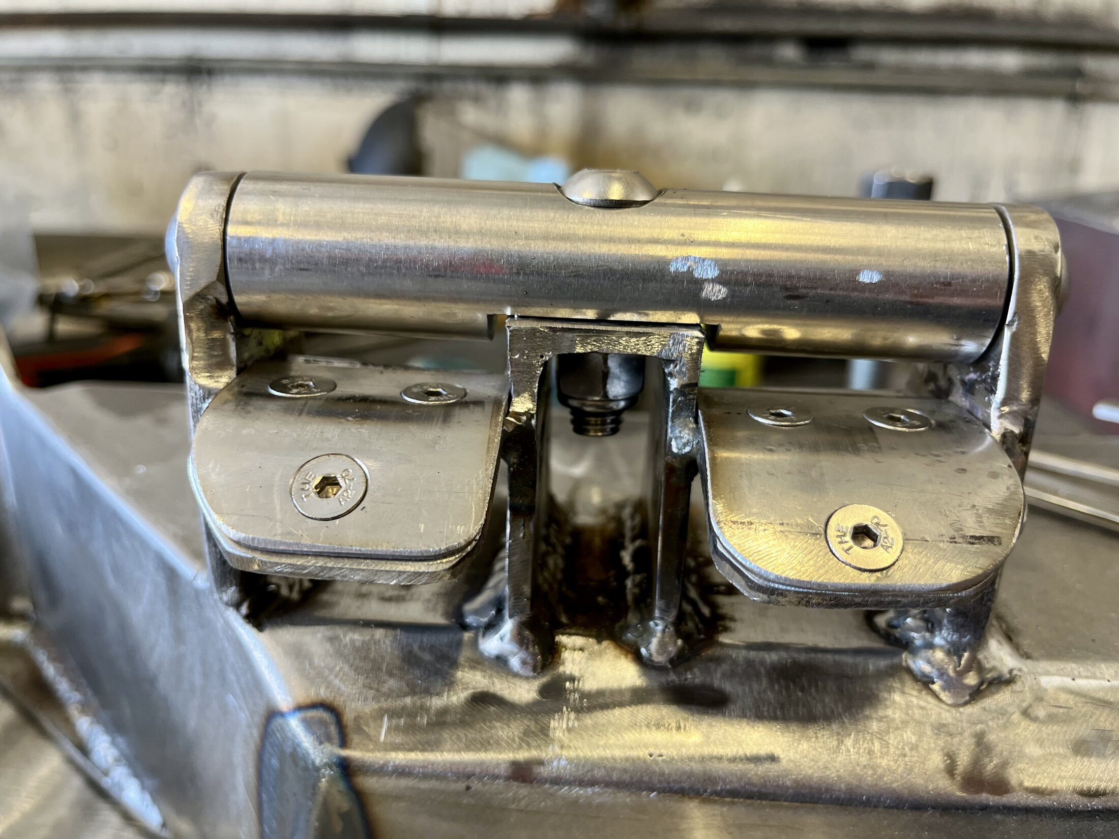

Hammock pole construction.
Cheers
This is done other than some quick clean up and probably polish the stainless.

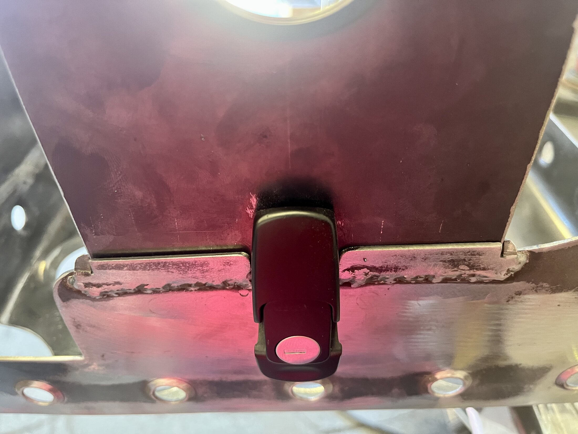

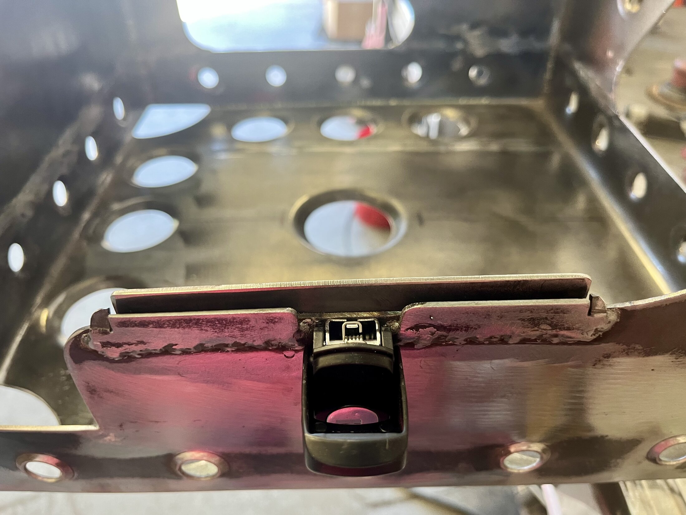

“Catch” detail for the locking Jerry can carrier.
Had to notch the carrier here for the tailgate. It’s not an issue when fully opened but the carriers have two opened selections and on the narrower of the two it was a clearance issue.
Cheers

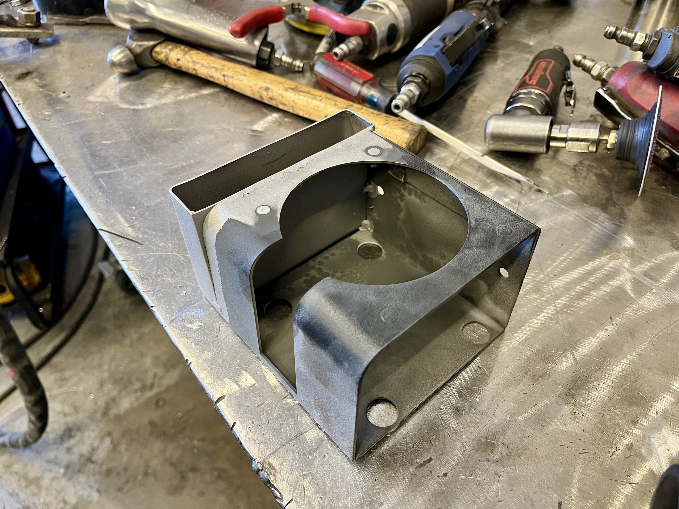

Center console work. We built this skirt and base to do two things. Bolt in to the factory console mounts and keep gear from sliding under the console.
Since the front of the Tuffy console is now narrowed to work with the 70-series style ebrake, we went with a single cup holder. I made the pocket on the side for holding a cellphone, wallet or whatever.
