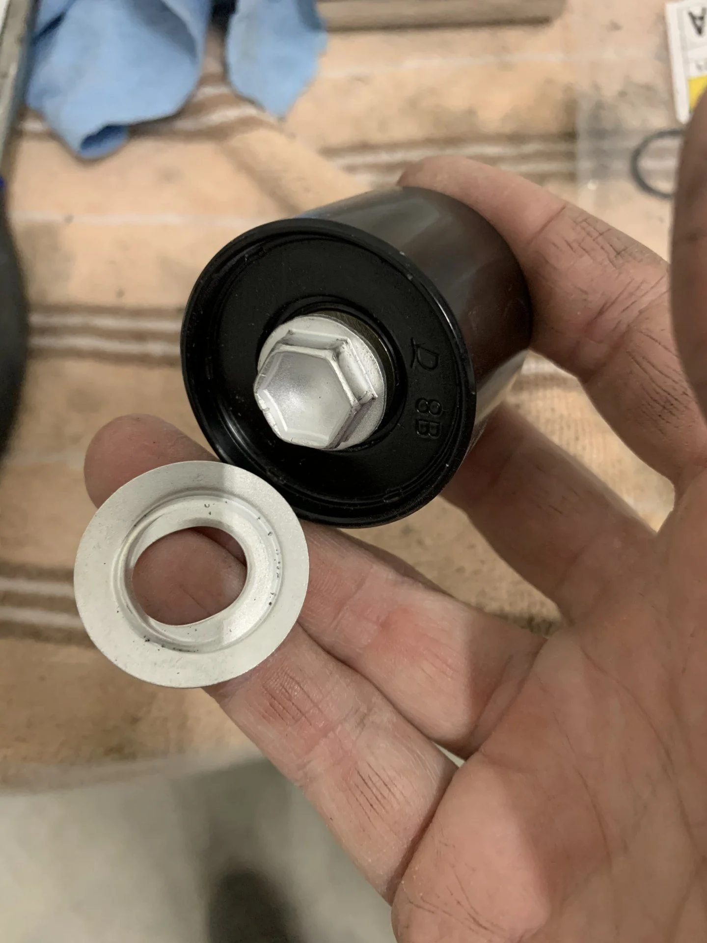

The AC belt has an idler pulley. It has a bolt through it and a “dust cover” that is NLA. My dust cover is messed up and if I install it, the pulley will not rotate. If I mount the pulley without the dust cover, it is fine. So that is what I did but if anyone reading this thinks bad idea, let me know :)

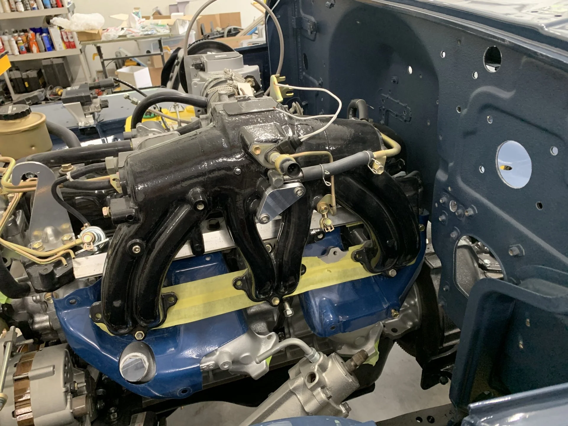

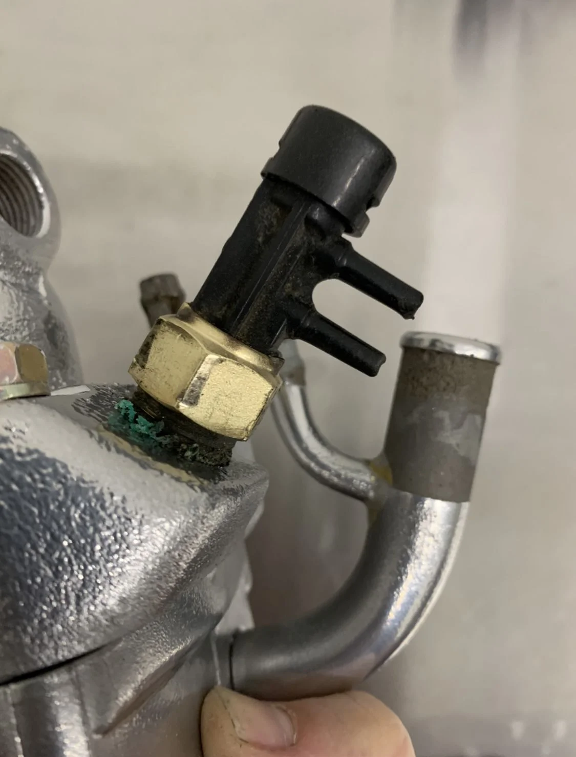

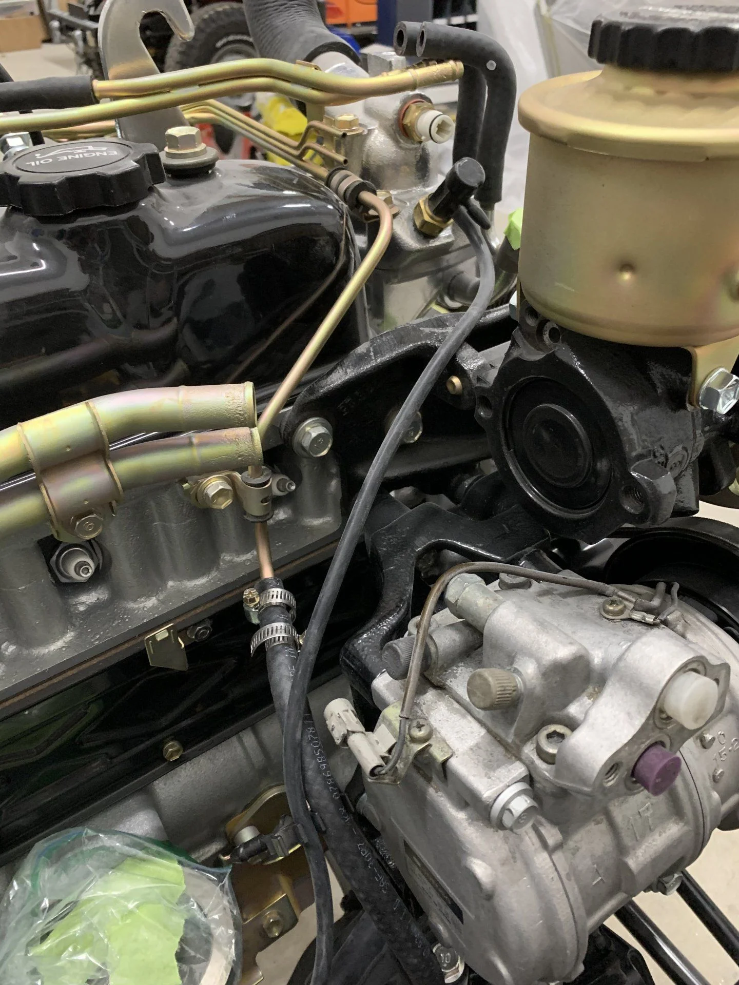

I’m still working through some desmog details and what is needed and what isn’t. Have had some questions on the BVSV valve that mounts in the T-housing.
From what I gather, the two vacuum lines are for controlling the check valve for the charcoal canister and the other is EGR related. Since I won’t have EGR, I capped the top fitting and am running a vacuum line from the bottom fitting - this will go to that check valve since I do plan to run a charcoal canister still. The vacuum hose runs by the distributor and I will run it alongside the fuel return line with a hose separator. You can see it here:

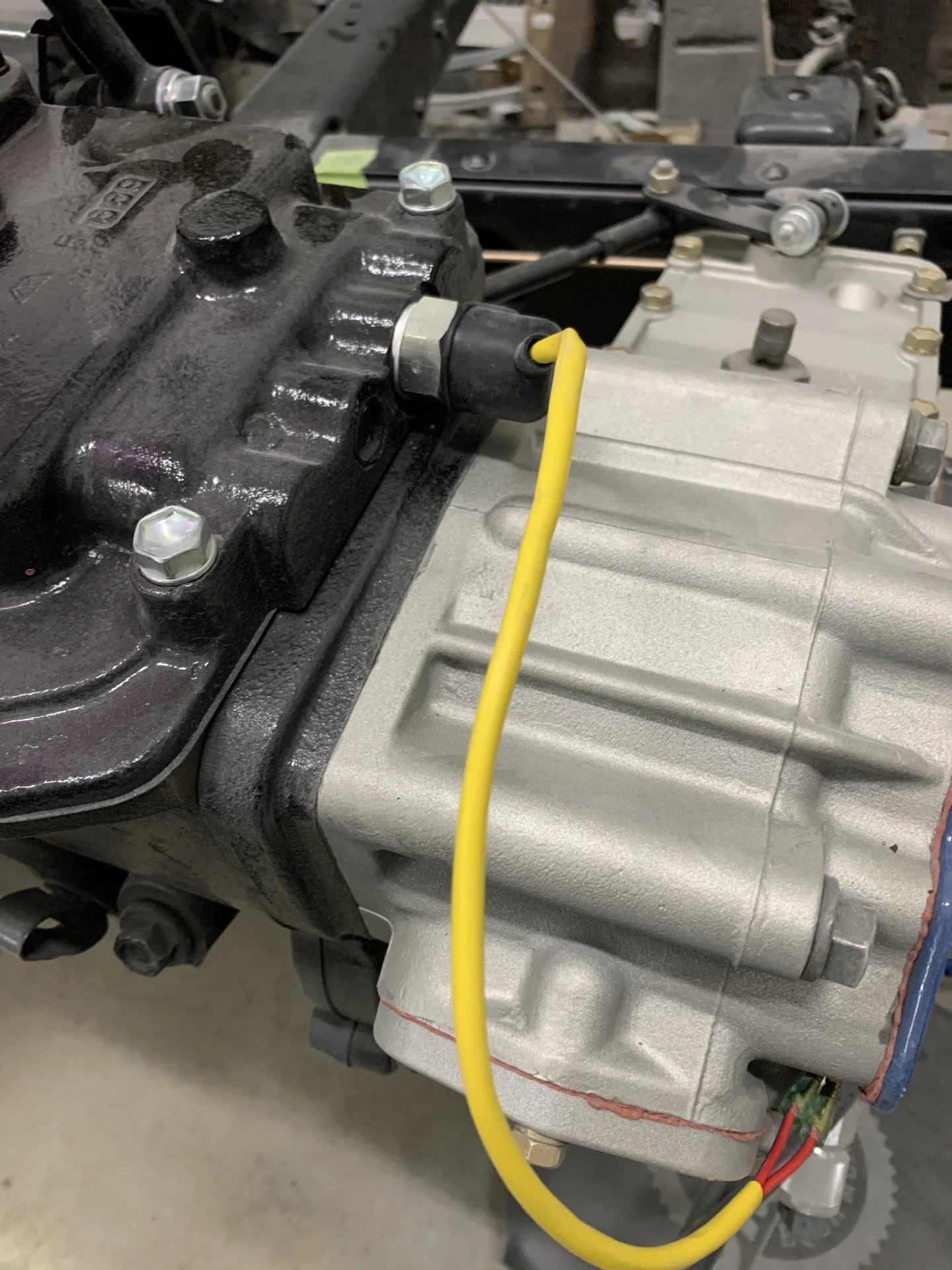

Also installed a new reverse light switch in the transmission:

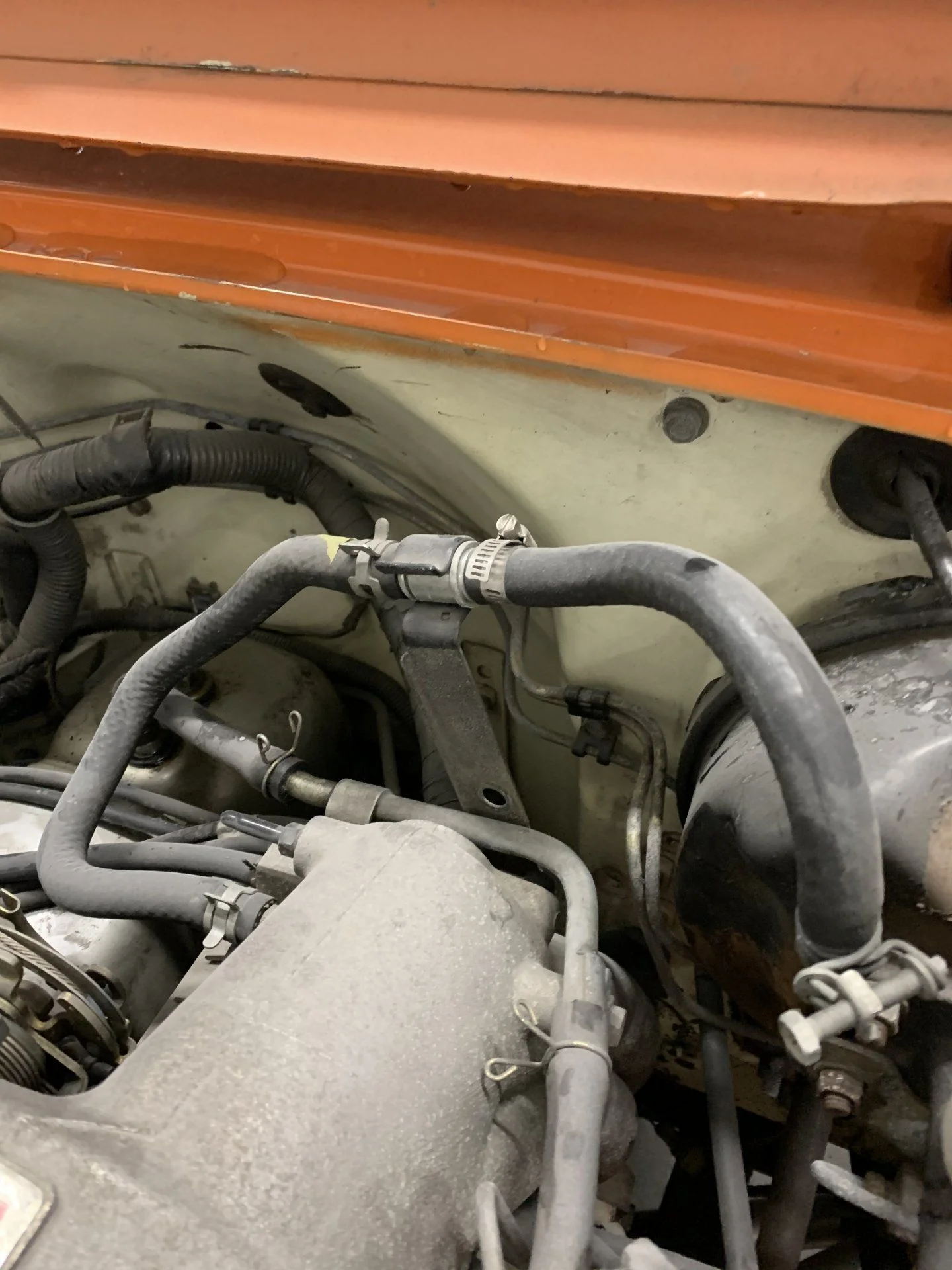

Last item is a question. I’m trying to figure out the brake booster vacuum hose. This picture is from my other 3FE. It is two hoses with some sort of fitting connecting them. I don’t know what I need for my new engine. Can I just run a hose from the booster to the intake? Or do I need whatever that middle fitting thing is?
Hey, not sure if you figured out your question on the brake booster line, but that is a check valve and is necessary for correct function of your brake booster.

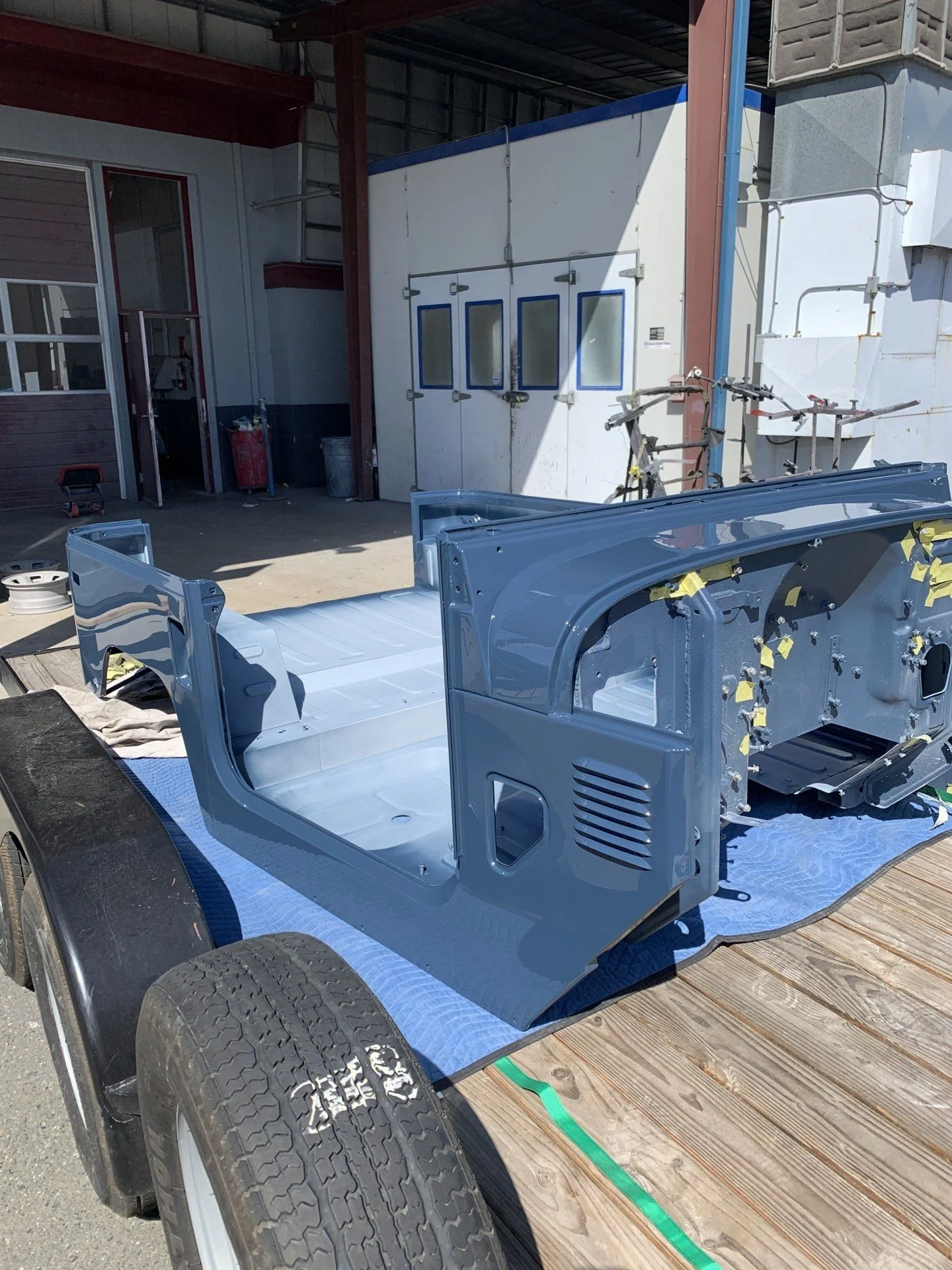

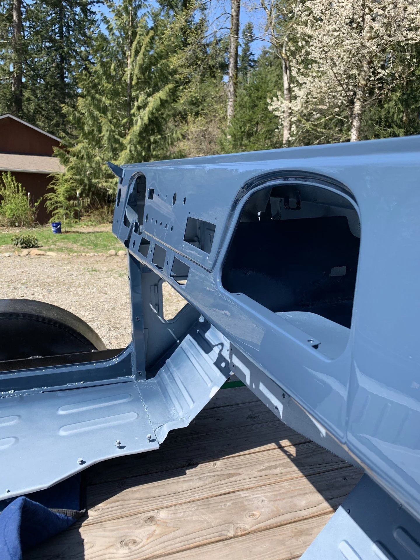

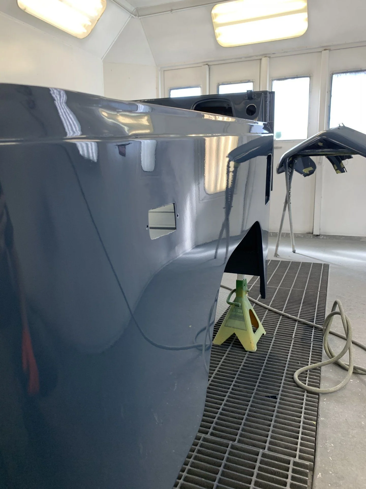

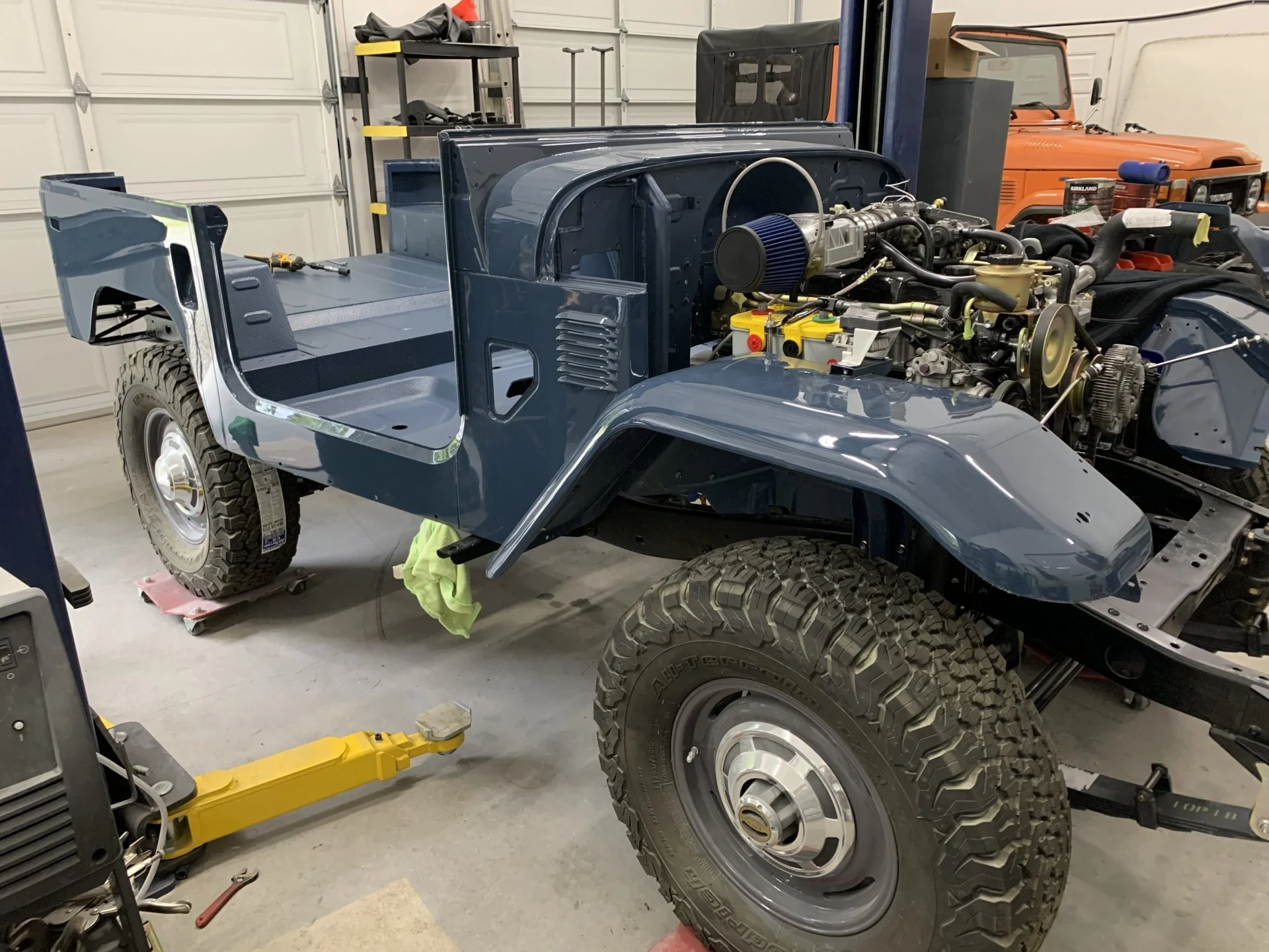

Finally got the tub painted. Fenders too. This was huge and a nice reward for the almost a year of body work, fitment problems, rebuild, welding (learning), sanding, sanding, sanding...etc. it looks really good. I’m super pleased.
What color is that?
Arles Blue. There is one or two other cruisers on the forum with it and I really liked it. I wanted to go cadet blue like several other folks, but wanted something a bit bluer and this was just exactly what I envisioned.

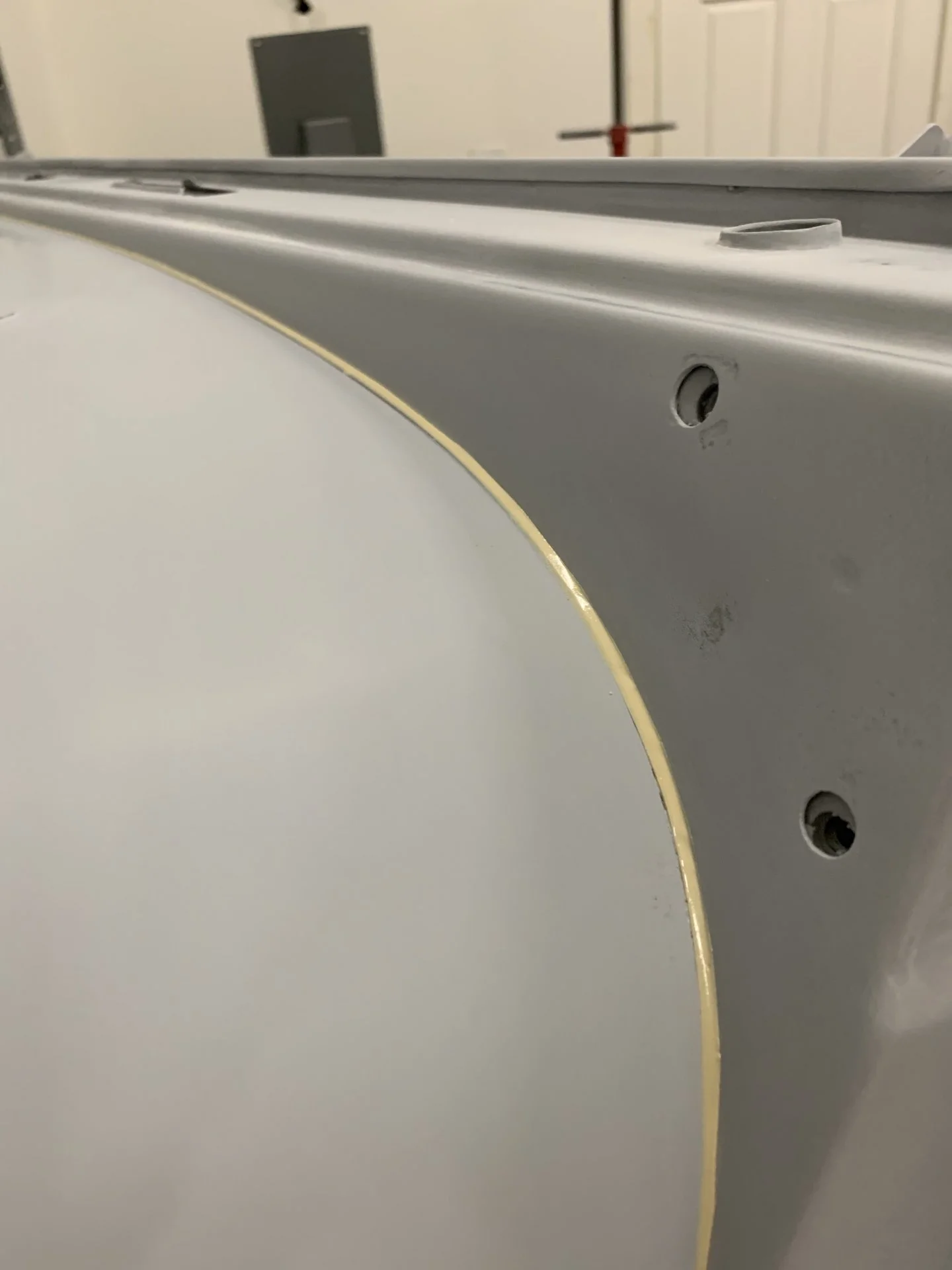

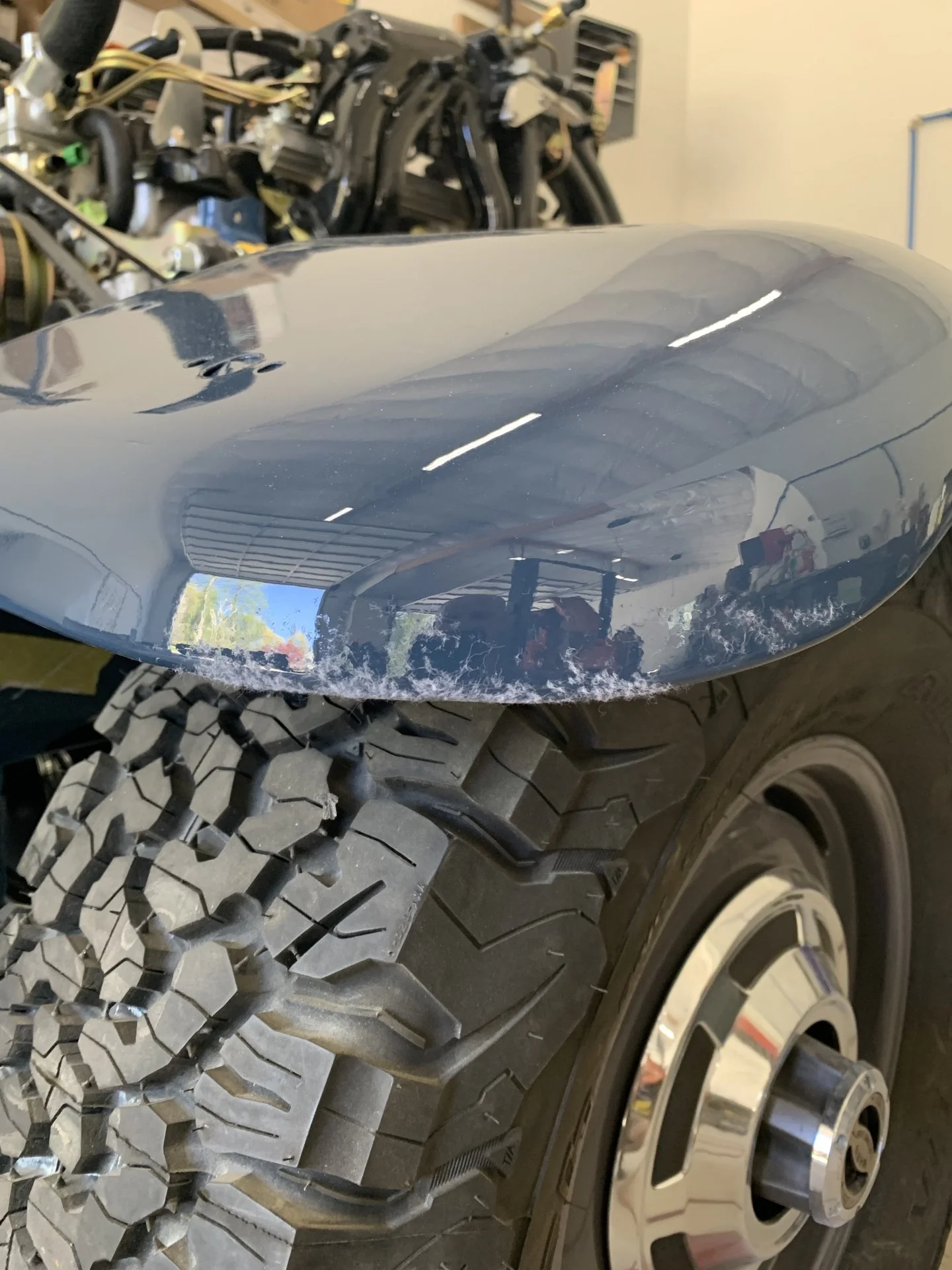

So my curse and continued fight with painting continues. We baked it in the booth after we were done painting. Then loaded it on the trailer to take it home. I was trying to protect the fenders from scratches, so laid the edges on a small towel for cushion. Well - the paint was still a bit tacky I guess and I ended up with this:
:bang: A similar problem on the tub on the bottom of the rocker panels where it was sitting on a blanket, tho not as big a deal there since it will be under the running board. Luckily, my buddy said shouldn't be too hard to cut and buff. I hope its ok...I guess worst case scenario is sand it down and repaint the panel, which wouldn't be too bad.

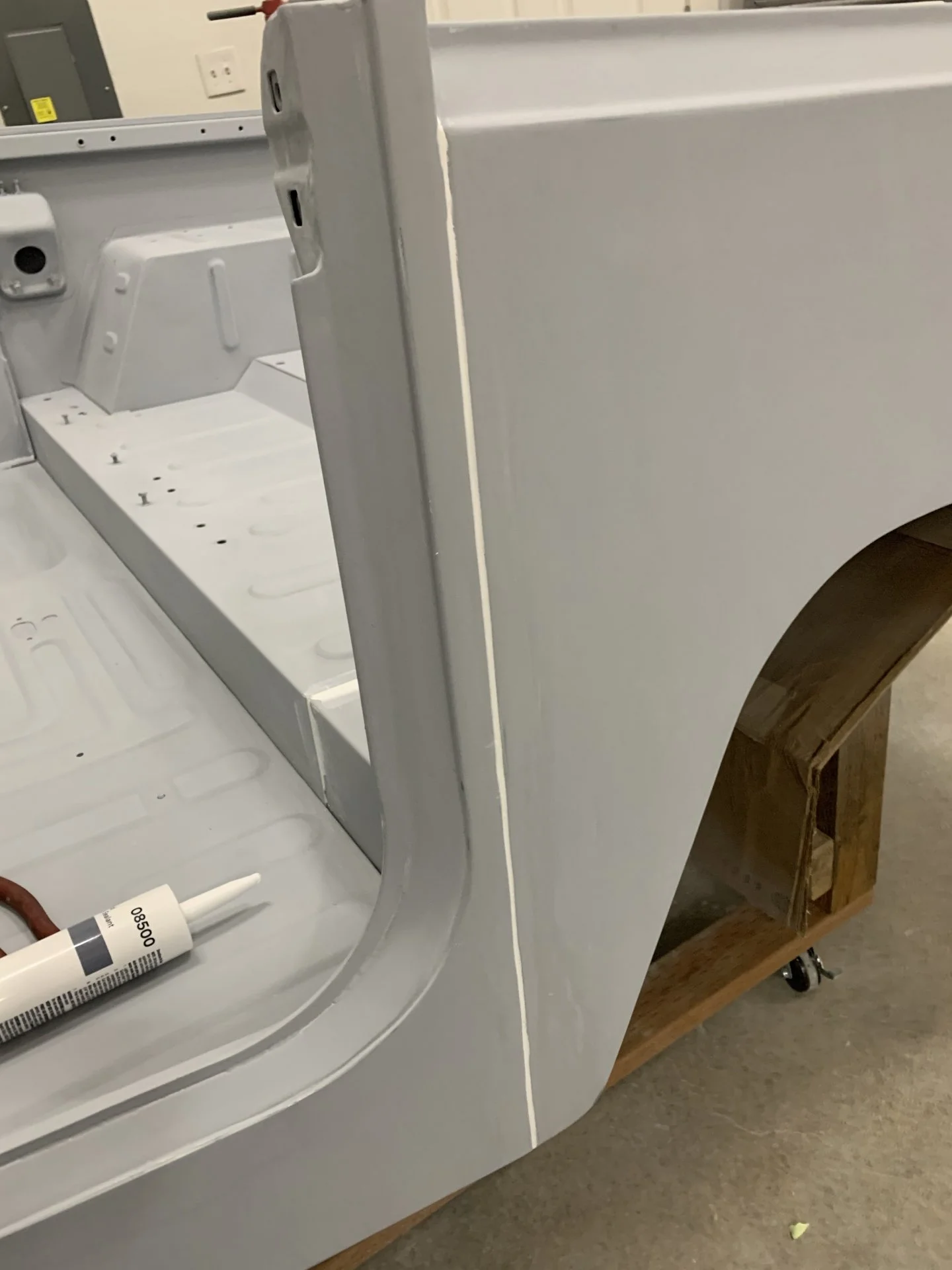

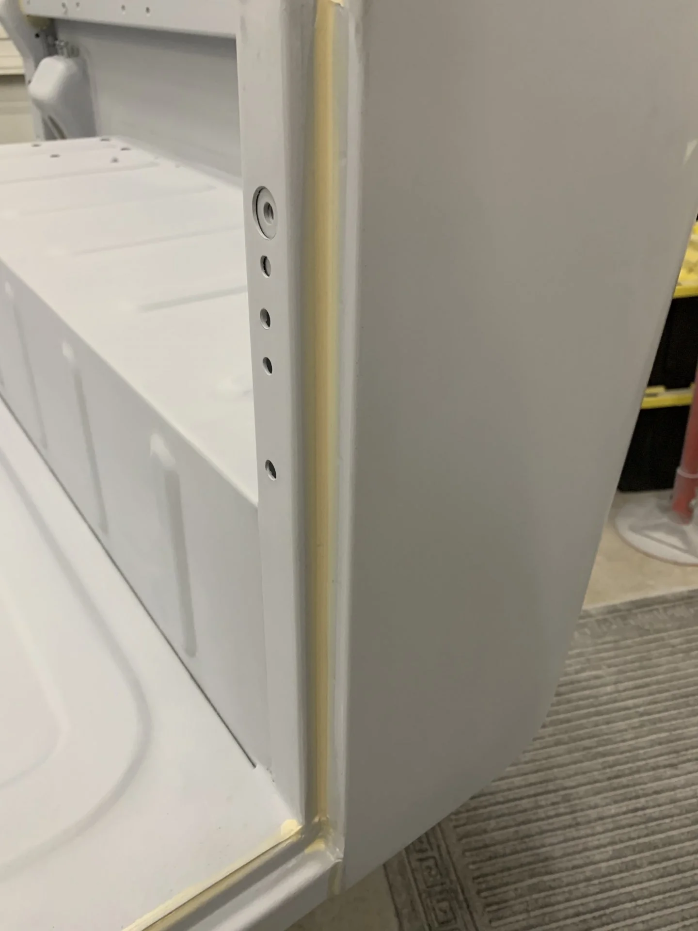

Also, realized I didn't post pics of the seam seal, which I did the night before paint.
Thanks. I was thinking the opposite and maybe it would be easier or better to try to get off before it fully cures. I’m not too worried, but was irritated.

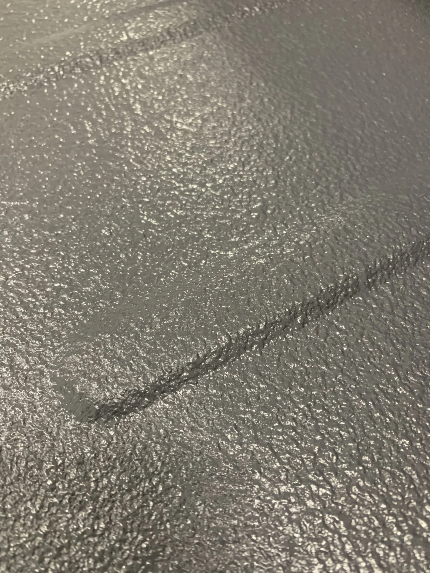

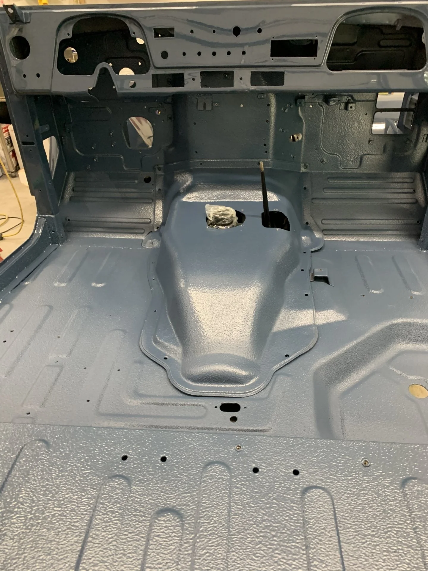

Lizard Skin sound deadener today. It goes on pretty easy, but dry time for me was about 6 hours (not the suggested 30-60 minutes...to let it dry between coats). It’s kind of humid here today and this is a water based product. At least that’s what I figure as why.
trans hump:
Also did the gas tank in case the in tank pump is noisy, hopefully this will help.
Close up of the texture if anyone wondered. It does seem to flatten out more than this as it dries.

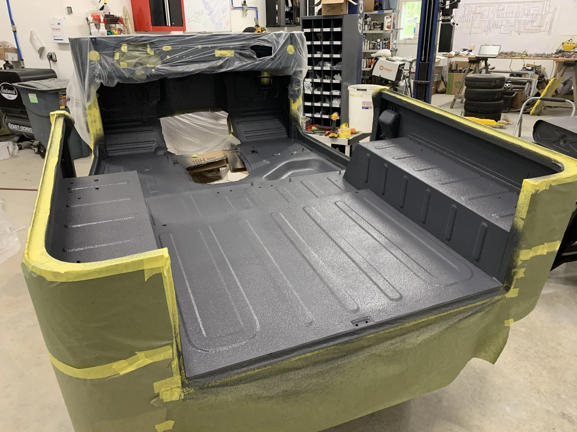

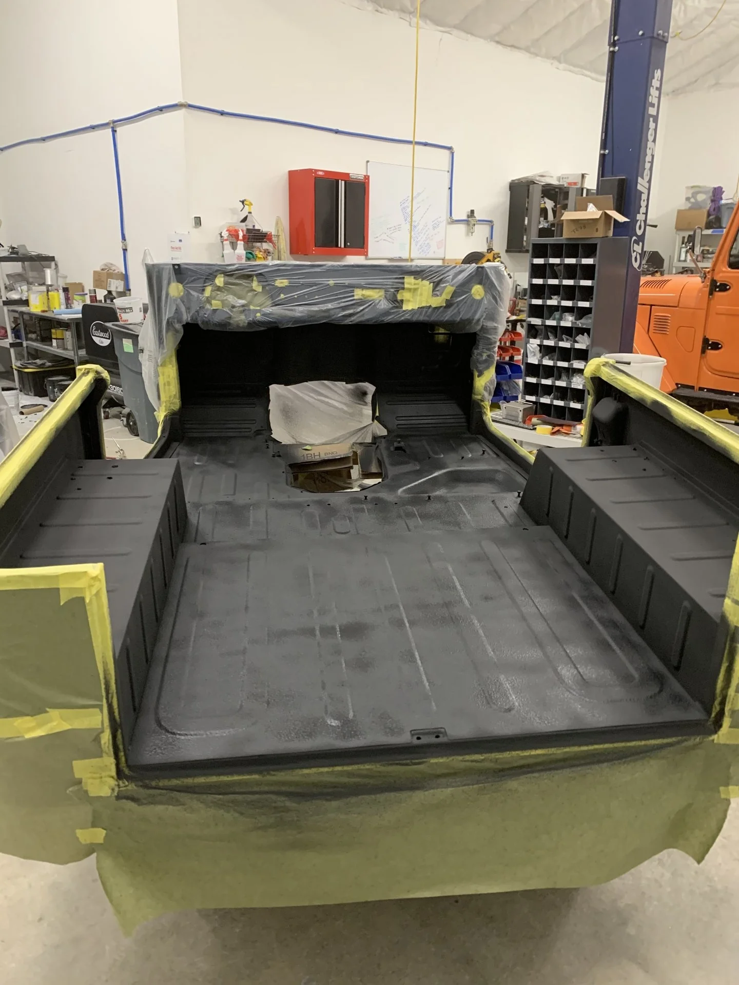

Ceramic insulation yesterday and raptor lined today.
The most tedious part was untaping and retaping between each product. Don’t know if I needed to do that but got worried about peeling dry stuff off. Anyway, finally all done with the tub work.
