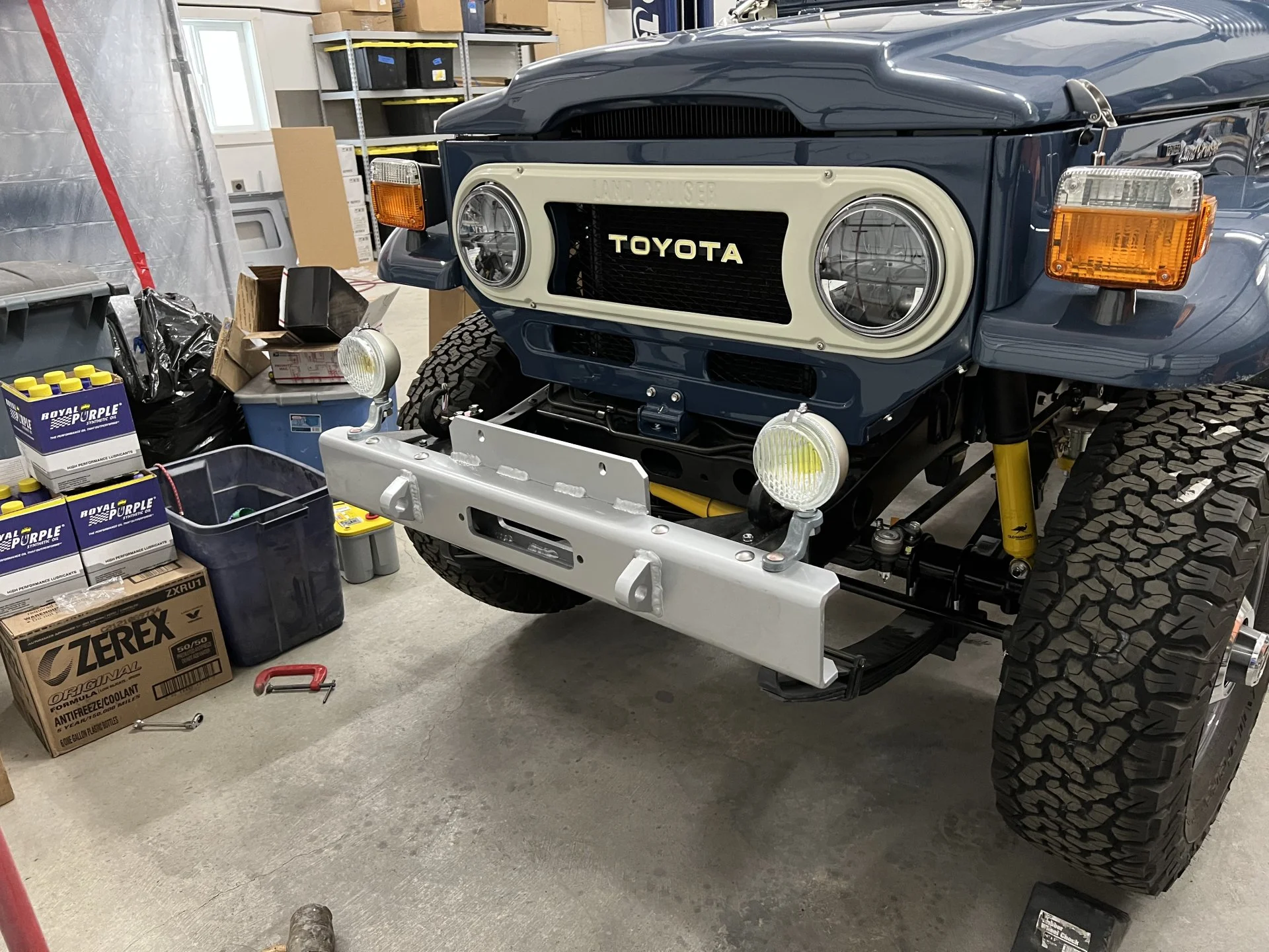

Front bumper (HFS) and fog lights installed:

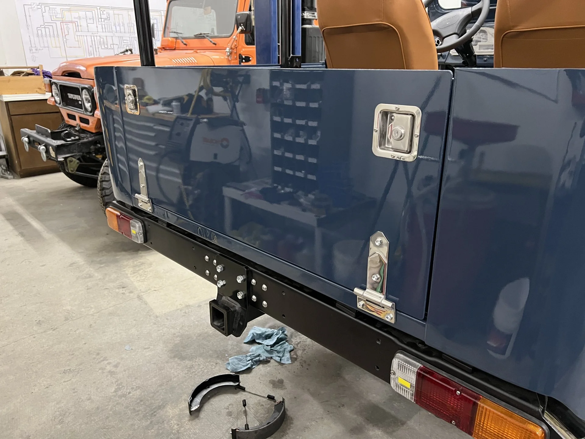

Aqualu tailgate. Need to figure out the weatherstripping for this still.

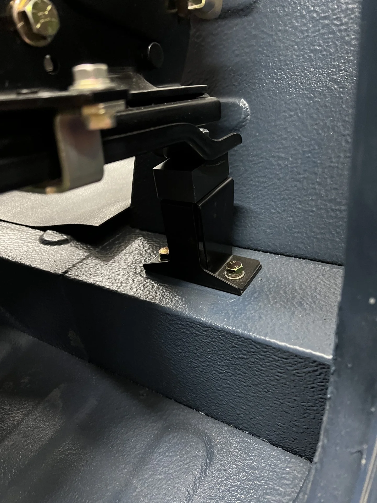

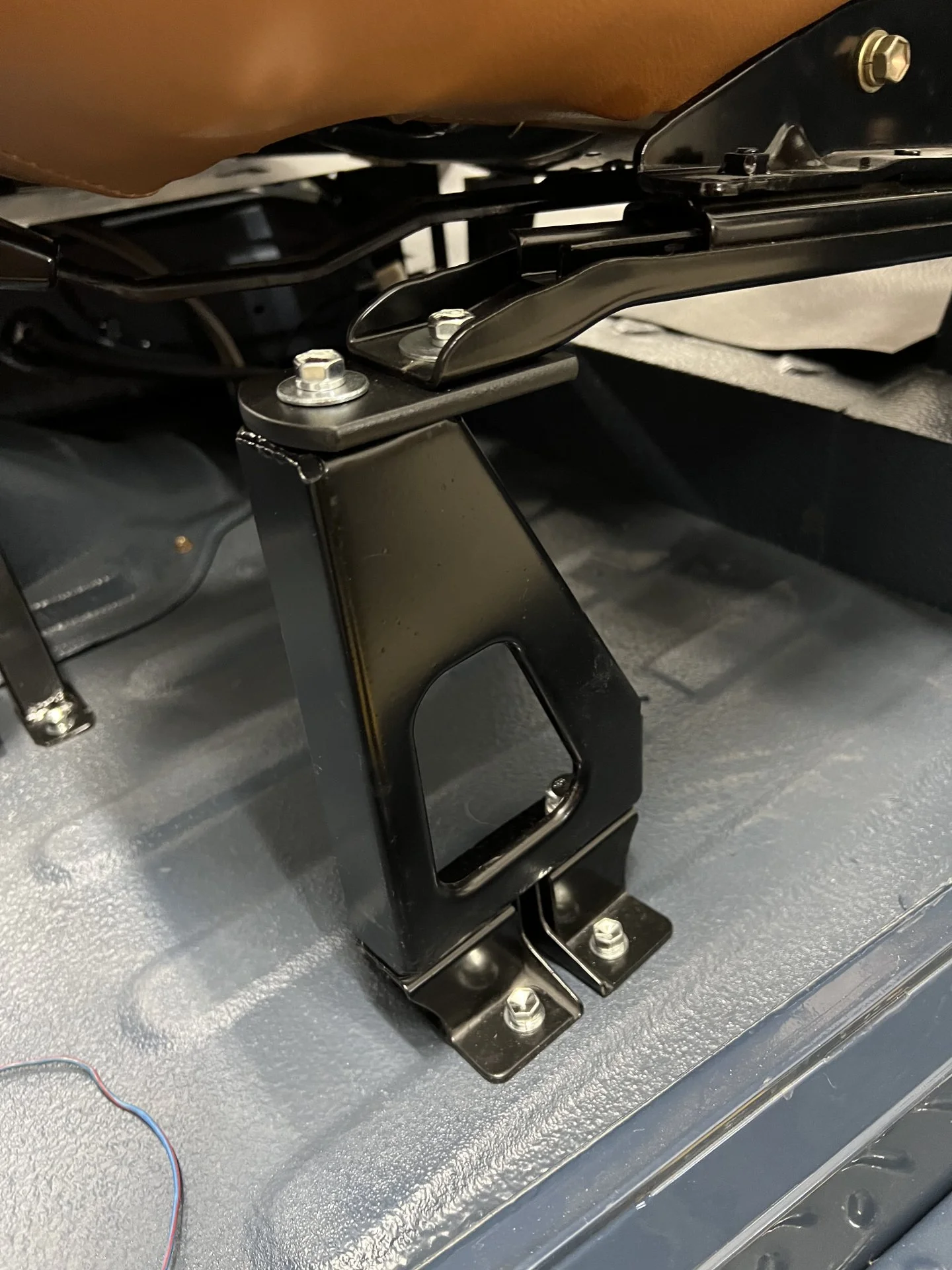

As documented earlier in the thread, I wanted my seats up higher. It turned out well, but with the higher seat, I was too close to the steering wheel, so needed to move the seat back. So I purchased the tall guy kit from classic cruisers and installed it. Reverse the rear tub mount brackets and add the kit pieces to the front bolts. It is perfect now…super comfortable and the position is just right.

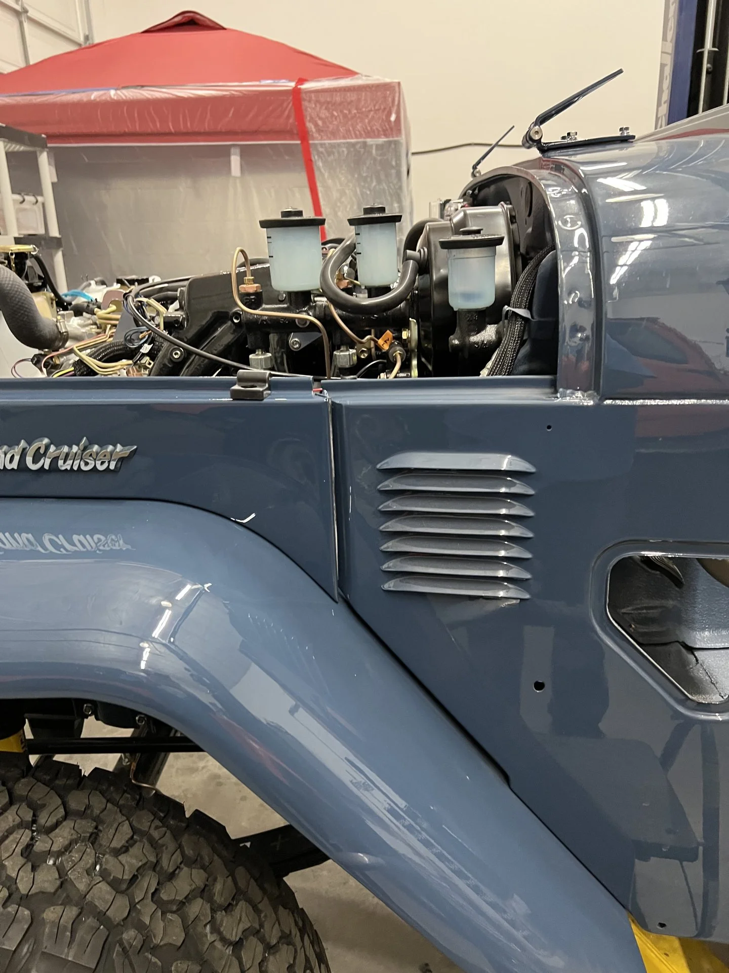

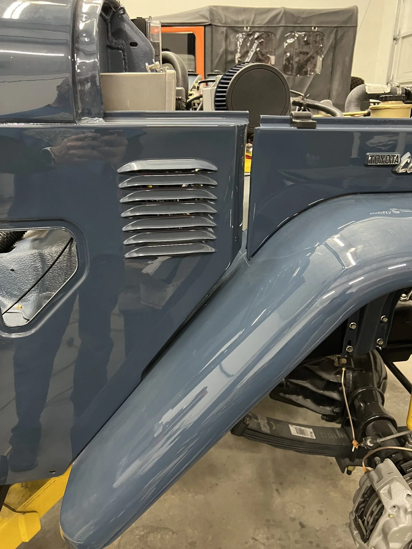

Fitment issues with the aftermarket tub were just brutal. Months of finagling and it’s not great. Case in point, I have a gap on one side between the cowl and apron. I’ve spent days trying to readjust and realign to panels, but it is just a bit messed up. I think it’s domino effect from adjustments I made when fitting the tub to the cowl.
Here you can see the driver gap vs the passenger (too big) gap.
Maybe a 3/4 tub wouldn’t have these issues.
View attachment 2882062View attachment 2882063

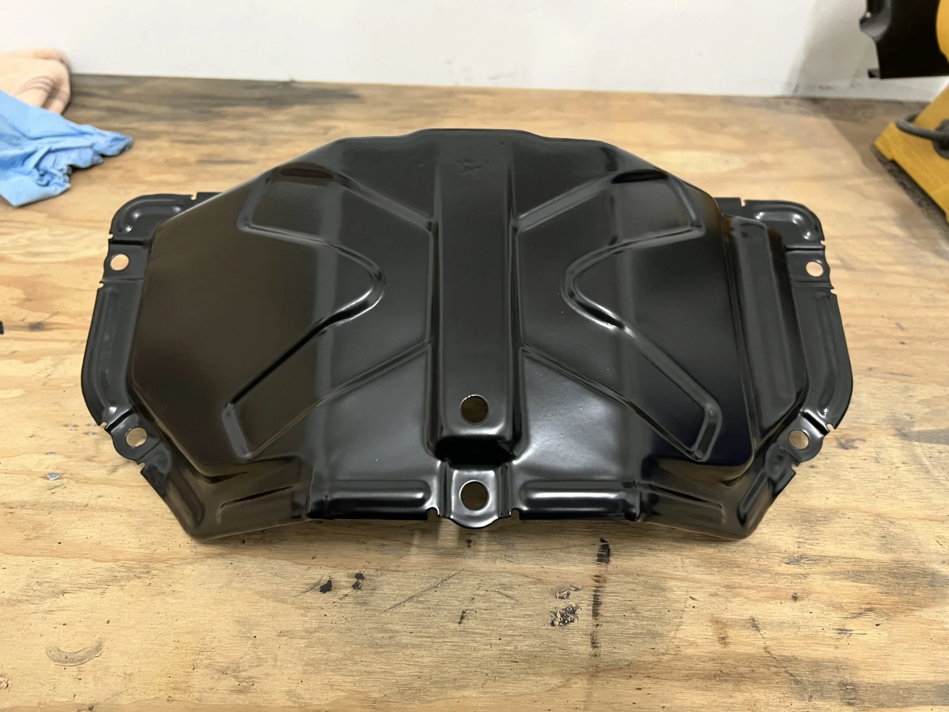

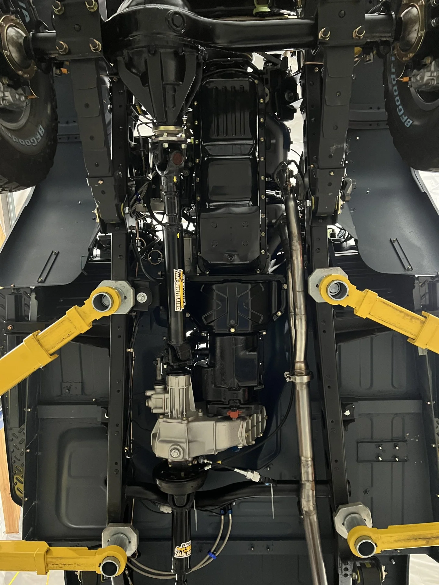

PC’d the flywheel and clutch cover.
And got it installed. Picture from underneath:

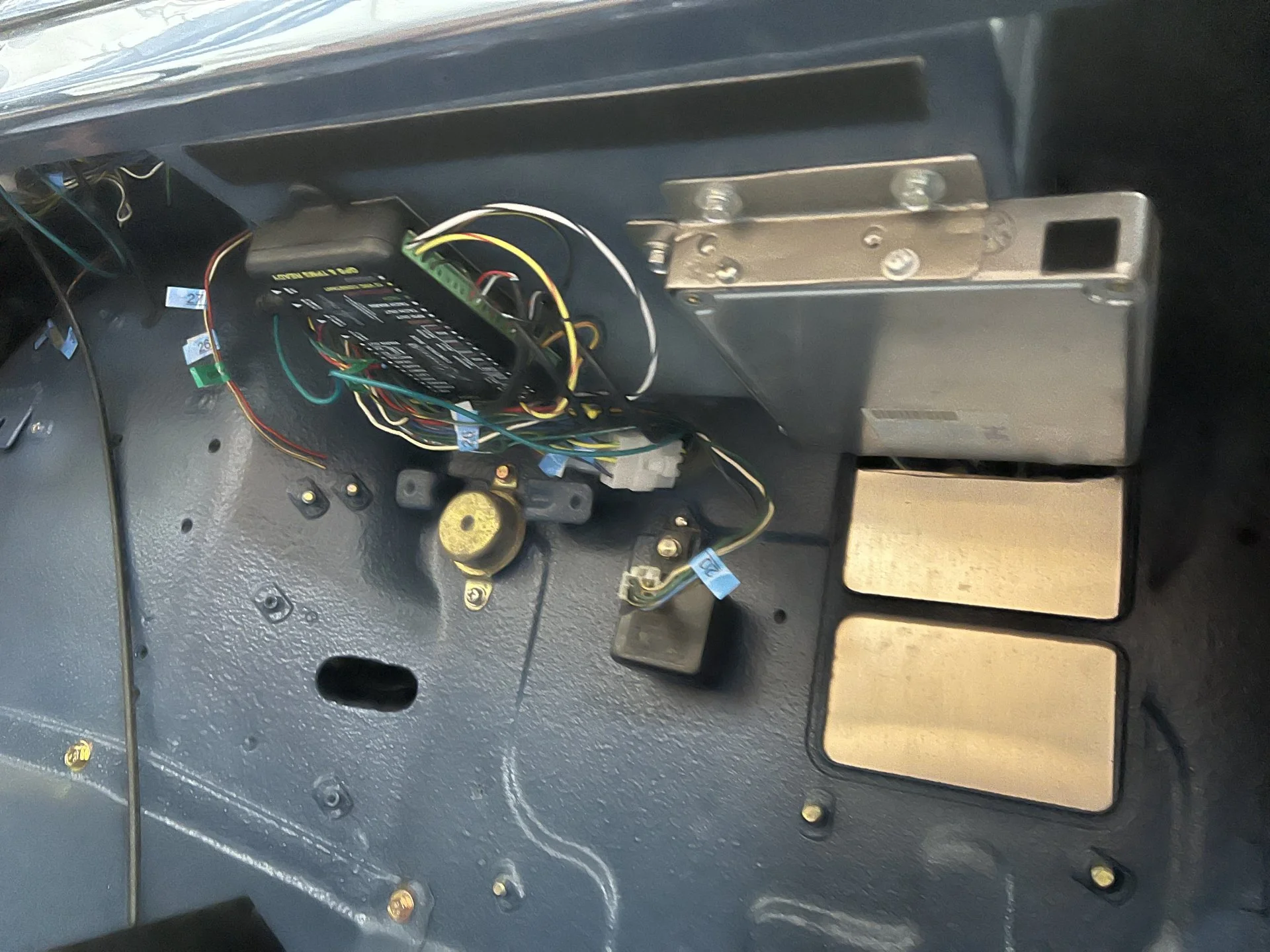

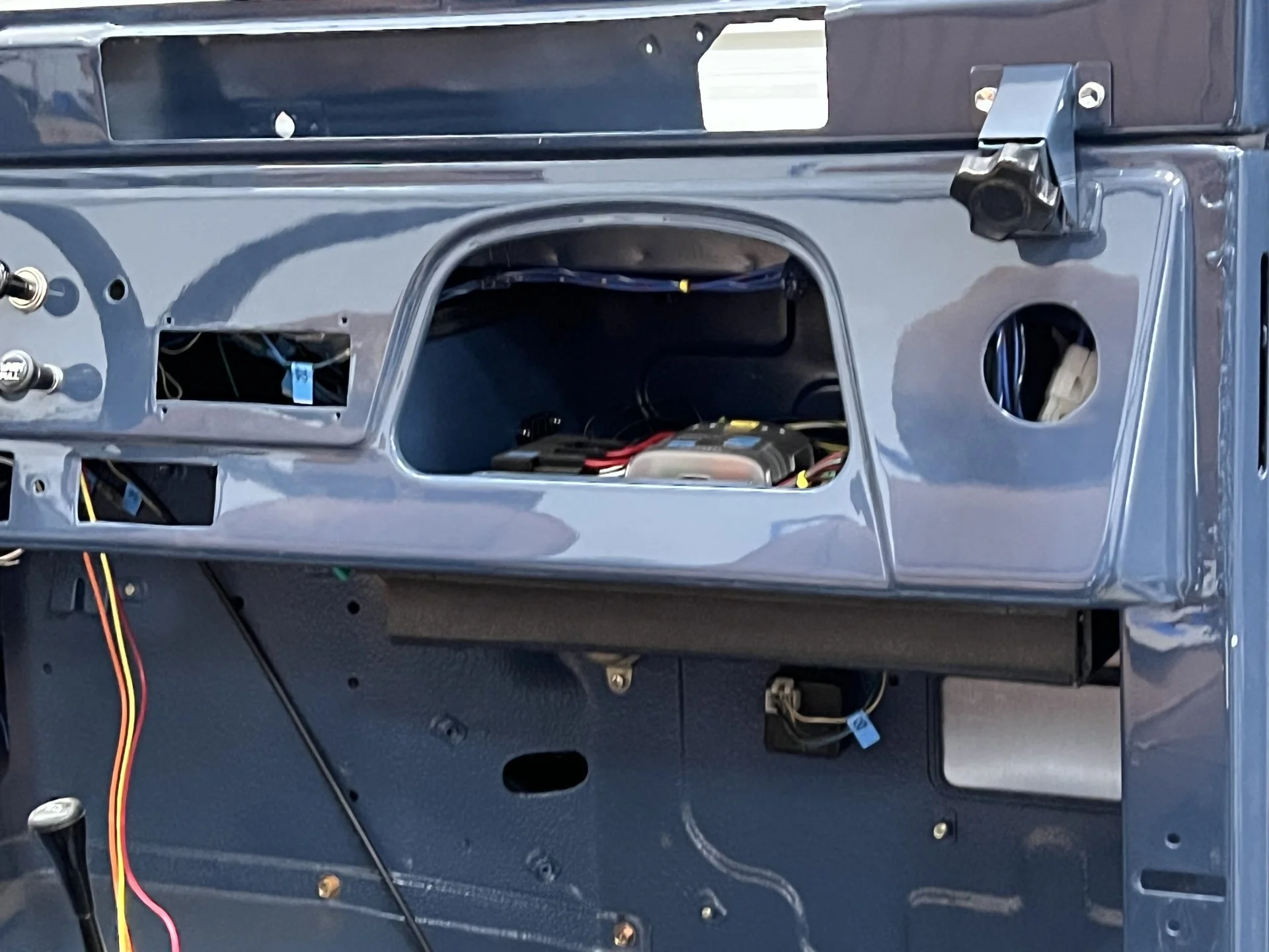

Then, I decided to mount the Dakota digital control box underneath the glove box, next to the 3FE ECU. While it worked out well, it’s kind of an ugly mess and I worry about someone kicking things or whatever. I do need to clean it up at some point, but for now, decided ti just cover it. This is what it looks like:
So I had my son make a box of sorts out of some spare ABS plastic I had. Looks OK and will do for now, until I get around to doing something better at some point. For now, keeps things cleaner as hidden.

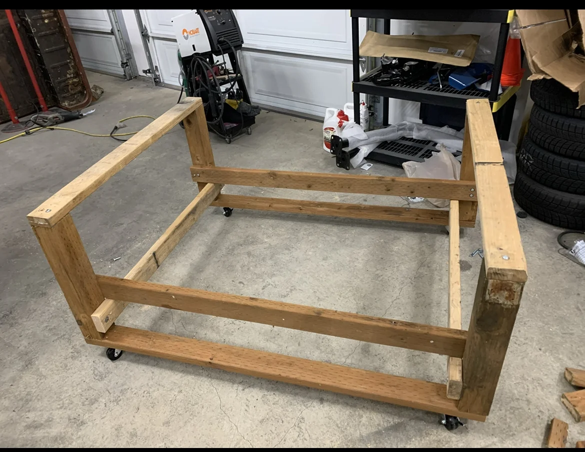

Beautiful build here Curtice. I was wondering if you might happen to have some more pics of your cart you built for your tub to sit on. Measurements to, if you would have them as well. I’m going to have to build one here shortly and I really like the one I’ve seen in your posts. Thanks
@jjcruiser77 Sorry I don’t have any measurements and I’ve since tore it down (taking up too much space in the shop). But I just measured the underside of the tub to get the measurements where I wanted to tub to rest, if that makes sense. But here is a pic

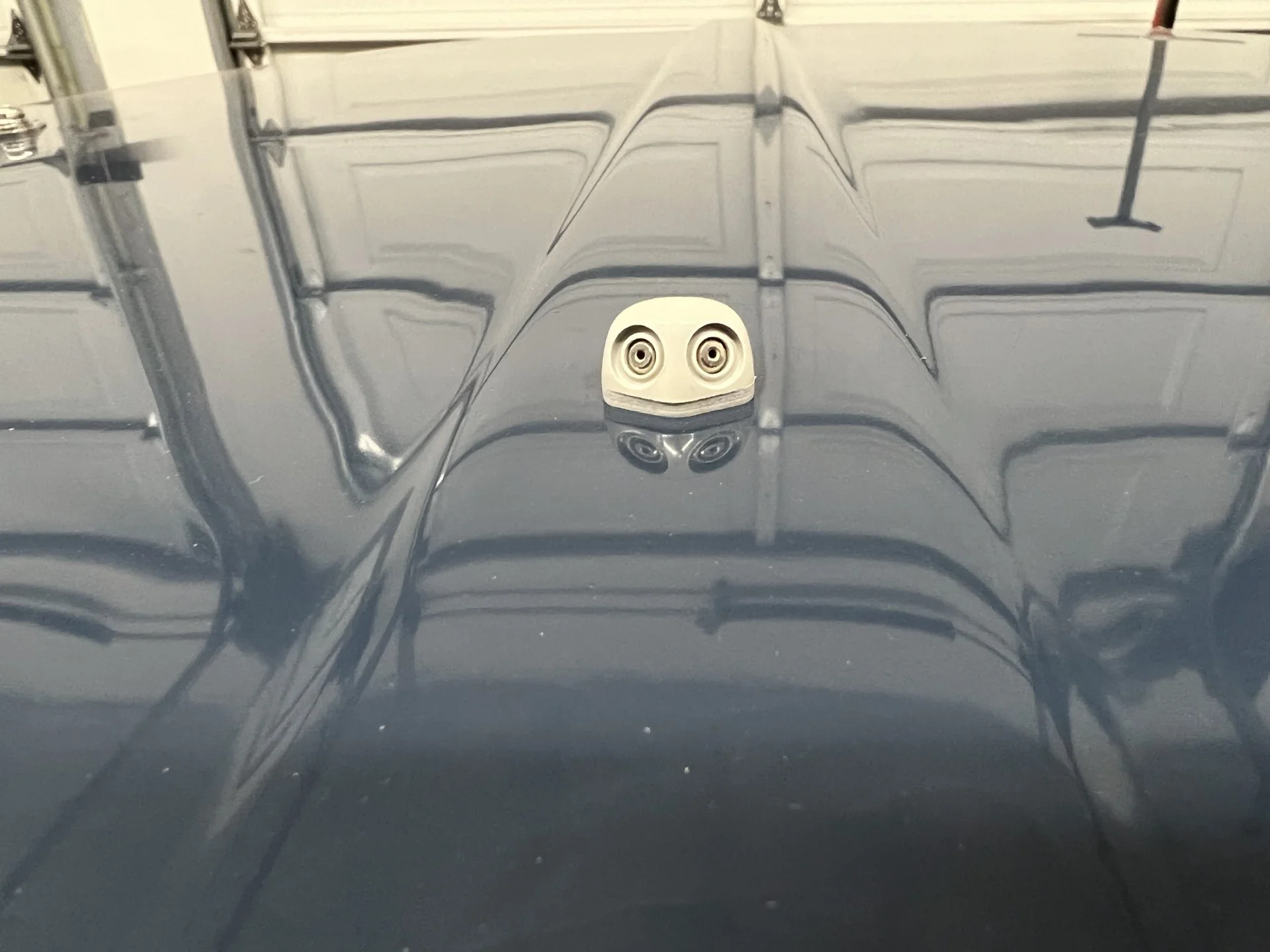

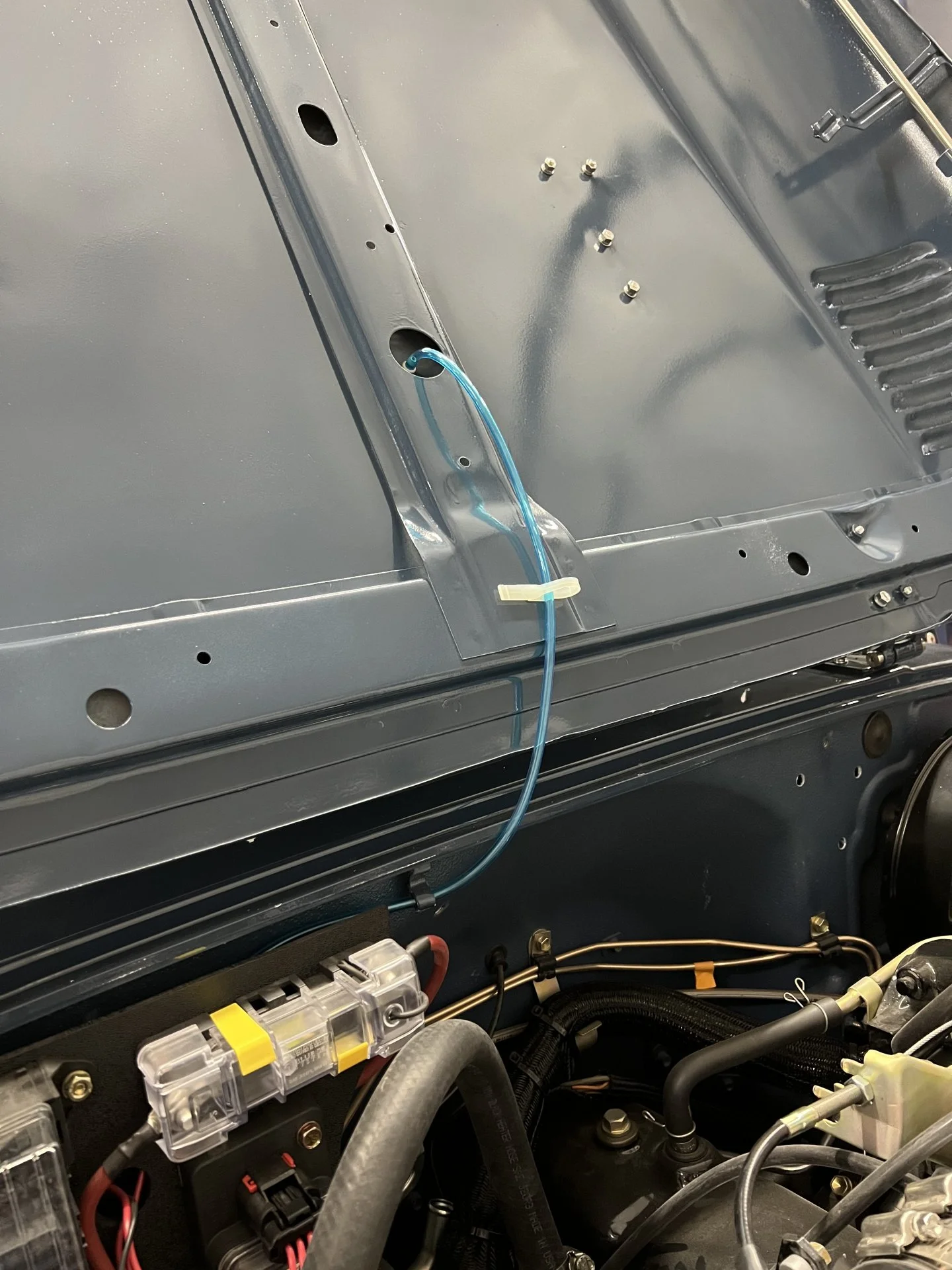

Windshield glass installed, as well as washer tubing routed to the squirter nozzle. I elected to use the hood nozzle rather than the above windshield one.

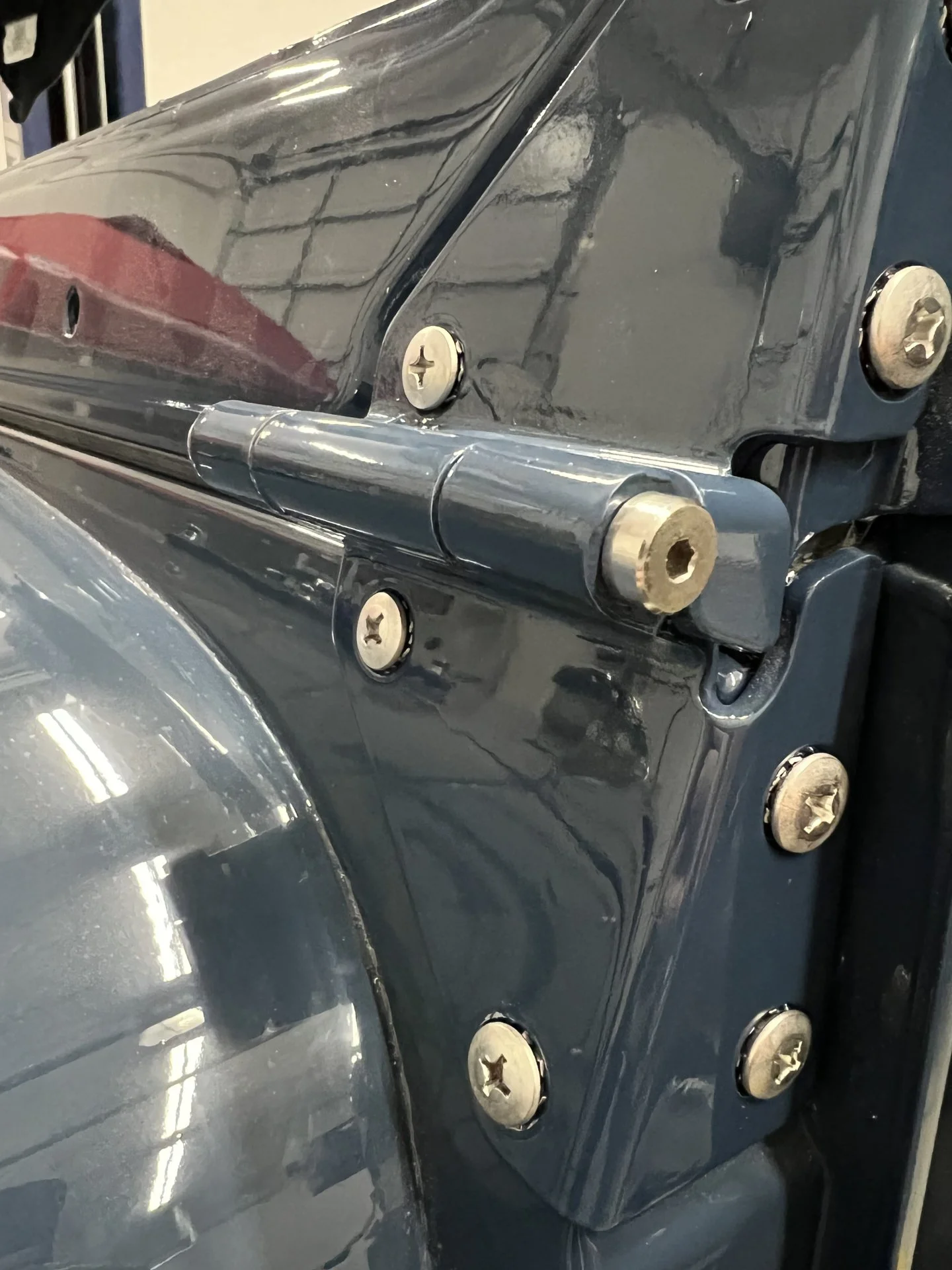

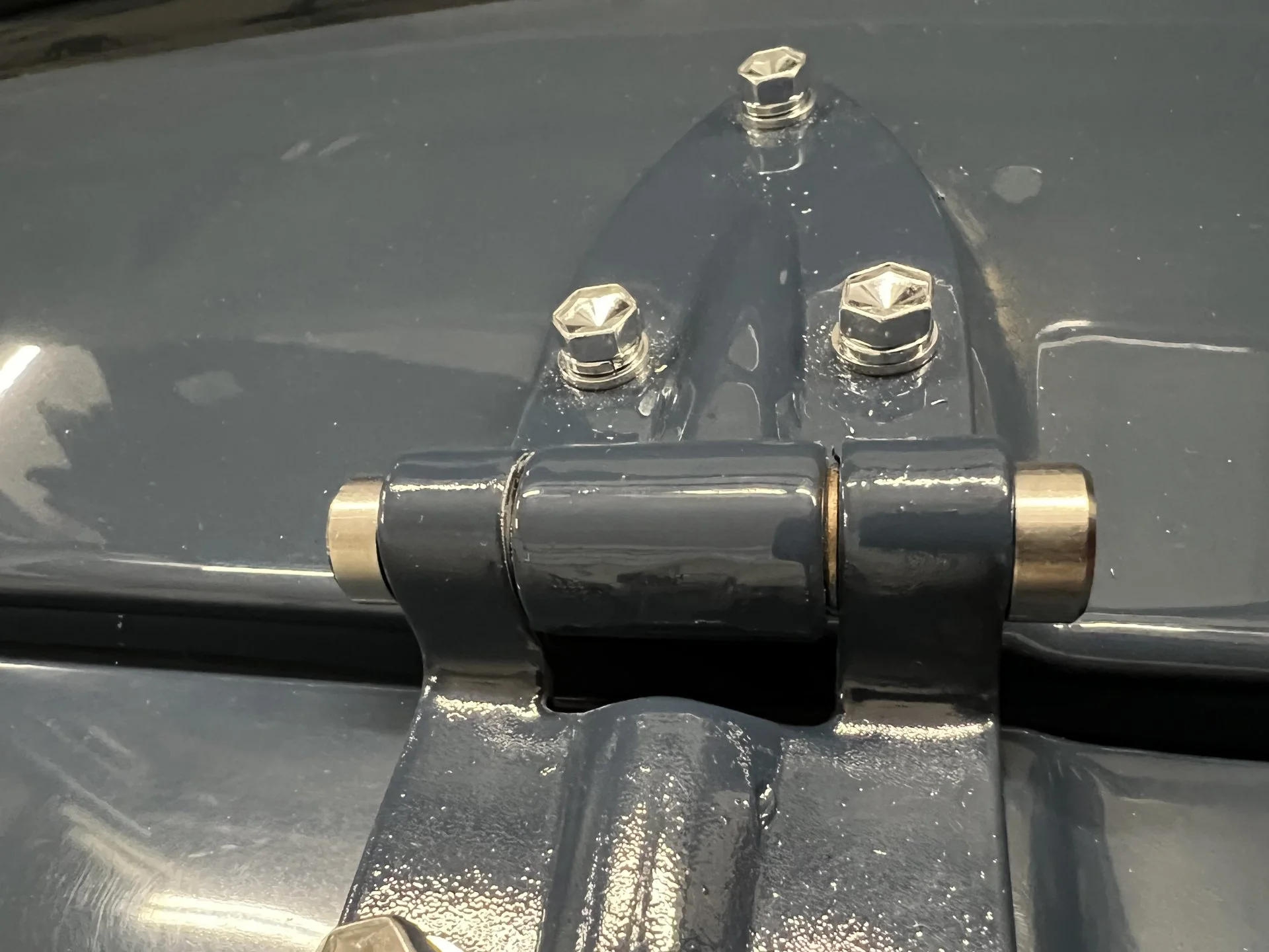

Couple pics of the new hinge pins I picked up from @SMG
