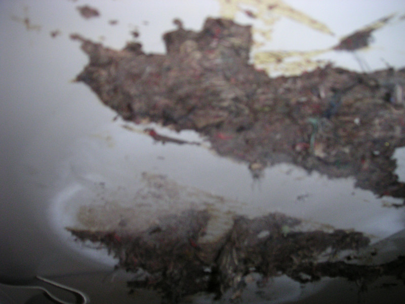

WD-40 dissolves the small bits of floor insulation left after the dry ice treatment, but its a slow process.

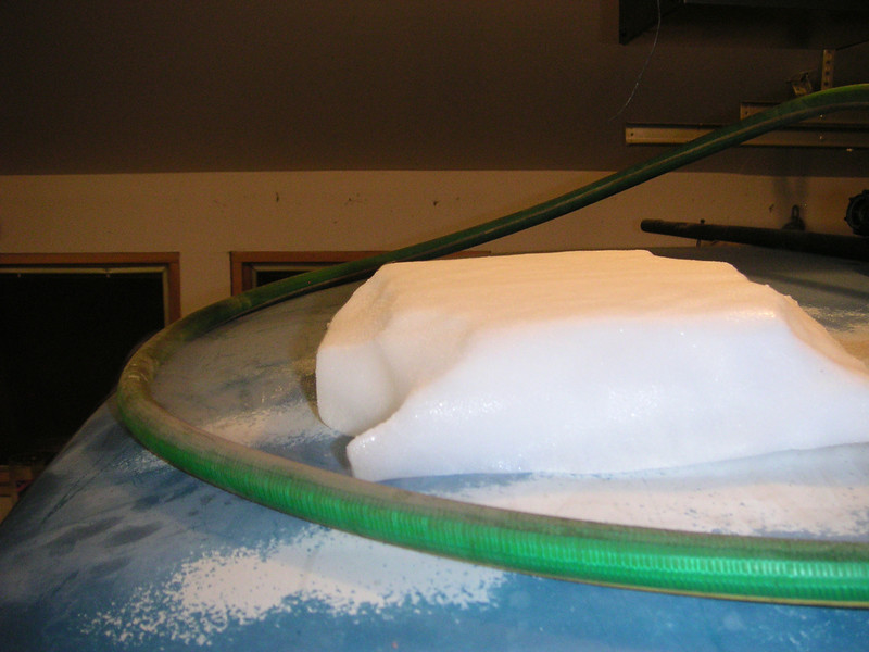

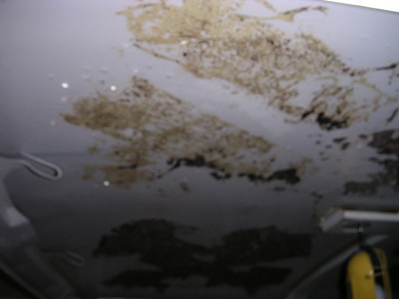

Tried dry ice on the roof tonight to remove the roof insulation glue with the plastic chisel, it seemed to help a little but I'm not sure it's worth it.
Sorry 'bout the focus.
At least youre FINALLY doing SOMETHING to that rat trap!
Glad to see some progress happeneing.
That is a GREAT idea with the dry ice BTW!

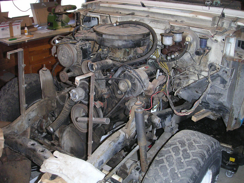

Yep, taking them apart is the easy bit. What I should be doing is planning out and acquiring the drive train, etc...but I'm broke so might as well inspect and cut out rust. I also can't stand scraping, sanding, any of that repetitive boring sh-tuff, so procrastination and general laziness have slowed me down a bit.
As for the doors, I think I've figured out how I want to weld the patches where the hinges mount, but my welding skills have only just graduated from ignorant and flat out dangerous to just plain incompetent. In other words, just enough to do floor patches.

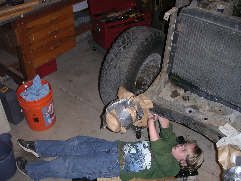

:princess: and I removed the inner fenders a few weeks ago.
This weekend I cut off the custom radiator mounts.
:princess: was working with her lathe off to the right, I failed to notice the shower of sparks my grinder was making landing on her. :doh:
