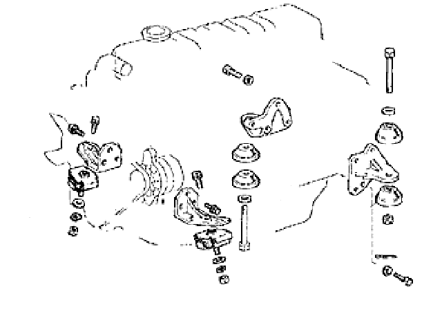

Howdy. Got my new motor today and a year ago when I tore this thing down, I did not remember, (and did not write down) how the domed "hockey puck" rubber insulators stack up.
Tech manual picture is hard to interpret, and actually shows a different arrangment on the passenger side than driver's.
If someone could take a peek under their stock original FJ, and give me the order of the "sandwich" (including where the engine bracket flange goes in there), I'd appreciate it.
Example: tech manual shows driver side:
frame, hockey puck (dome side up), engine flange, hockey puck (dome side up).
Passenger side:
frame, hockey puck (dome side up), hockey puck (dome side up), engine flange.
This doesn't seem right.
Thanks!

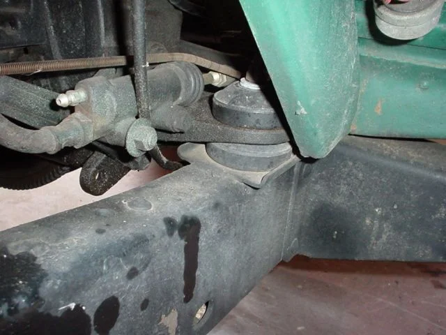

Pass side pic I used to mount mine..
From SOR
What I did..............First pic is passenger side, second is driver's side:beer:
Man. that's just filthy, Ed!
