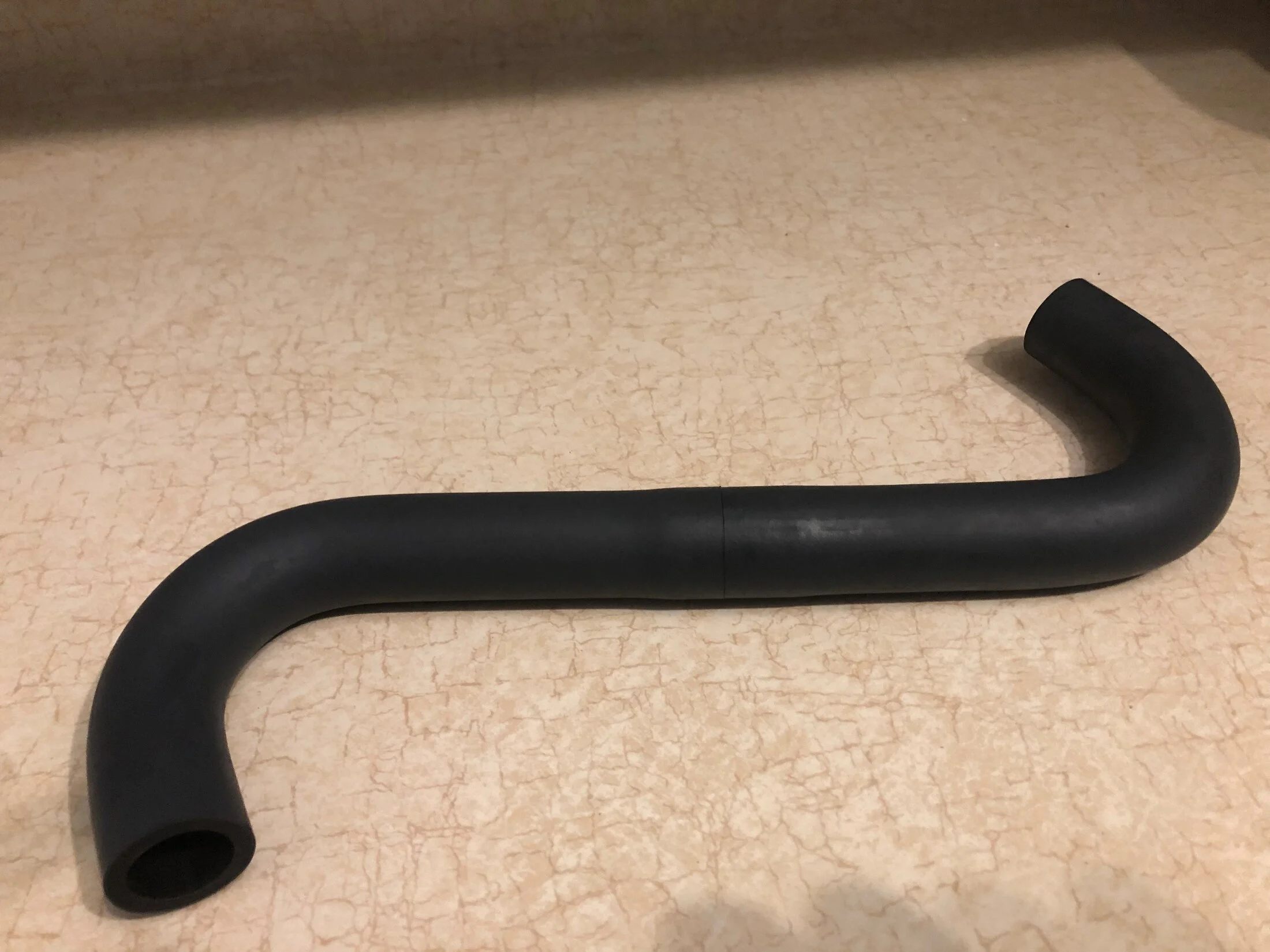

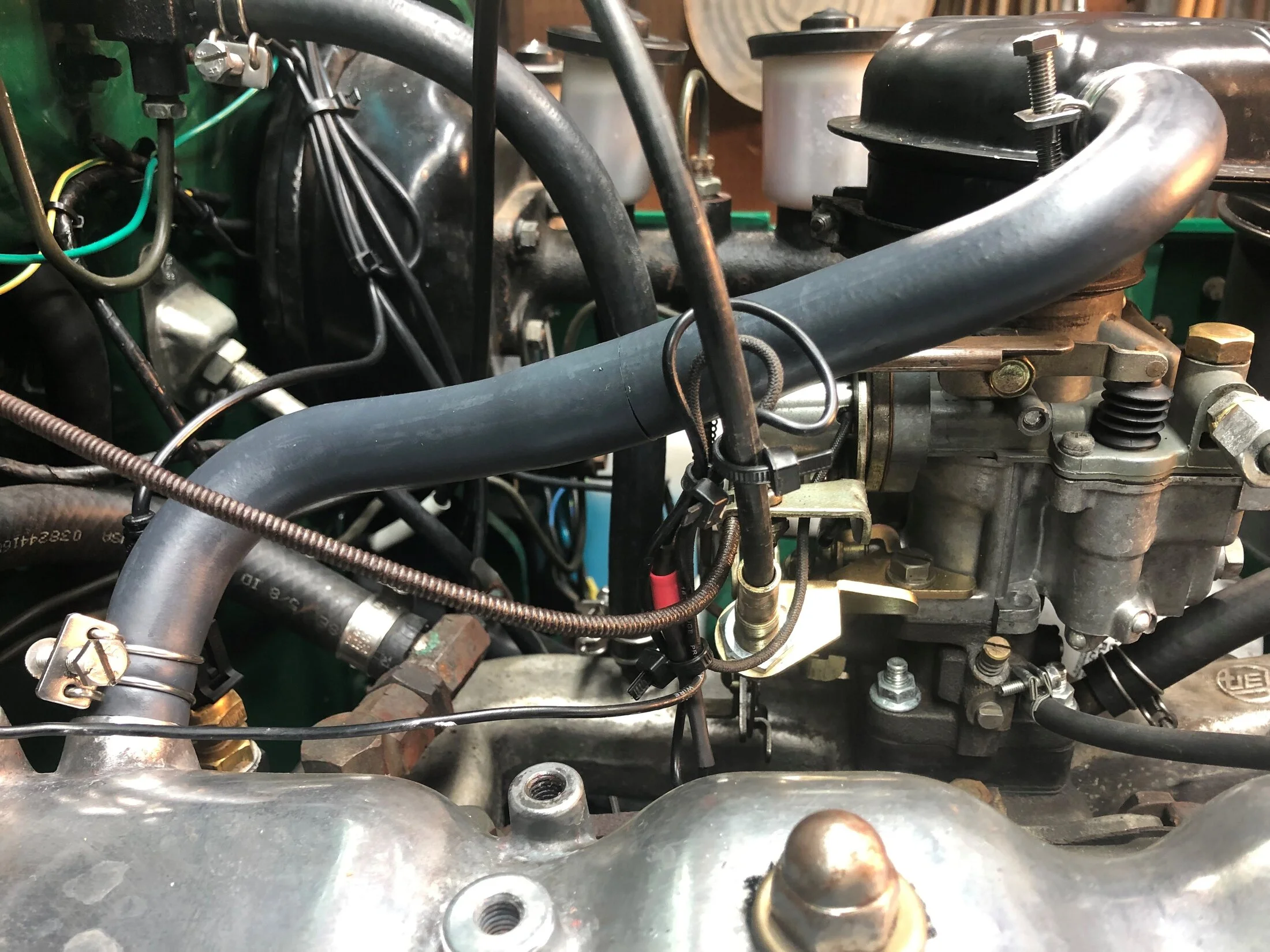

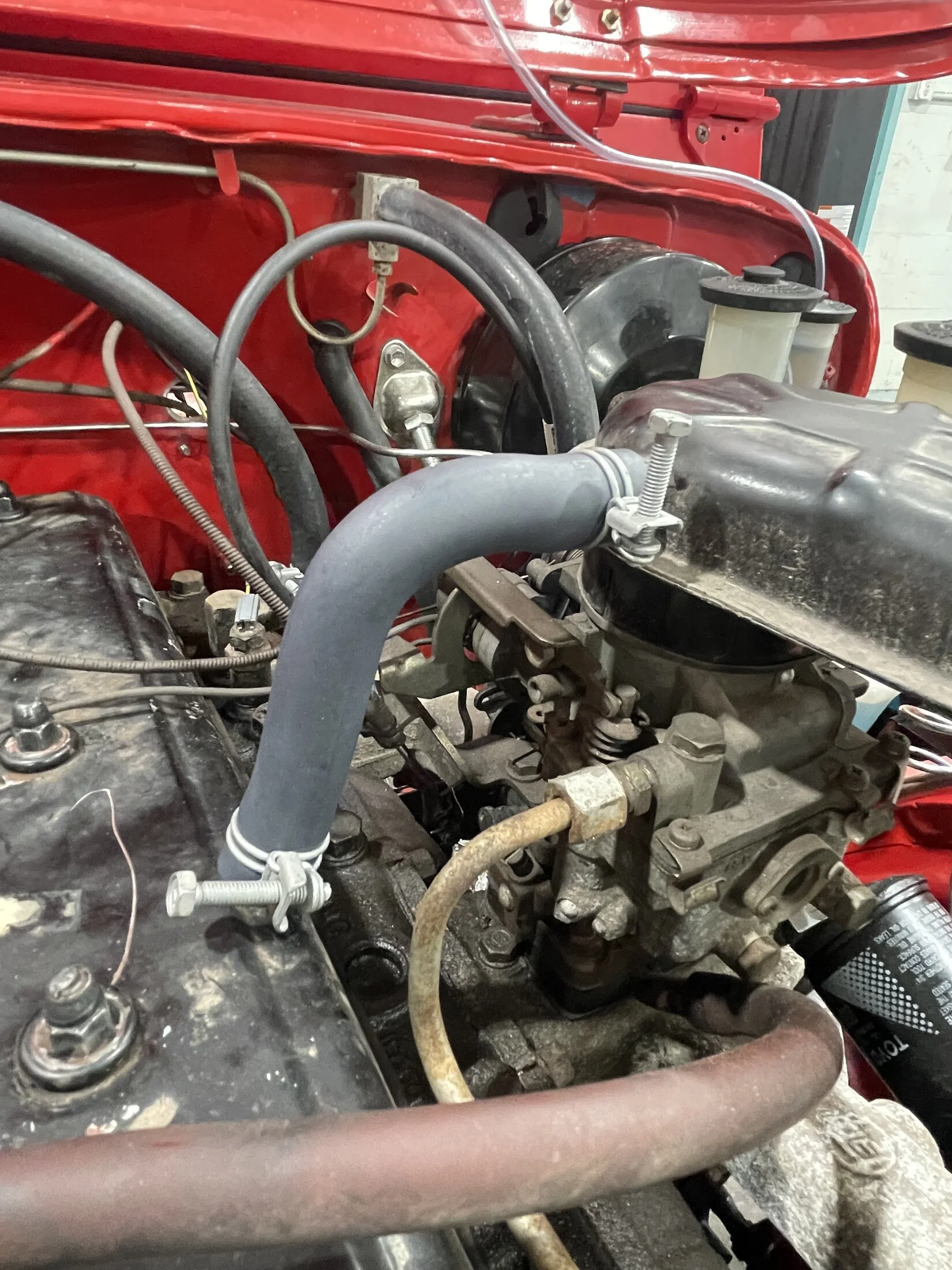

For those with 70-74 1F engines and original air cleaner, I found 90910-05101 (from a 2F) fits perfectly as a substitution for NLA 90910-05036.
I also have plenty of them on the shelf if you would like to freshen up that engine bay a bit!
And... if you glue two of them together they make a dandy solution for a 2F valve cover mated with a 1F air filter housing. ;)

Go all the way and use OEM clips for this hose; easy to remove by hand.
Note that the original hose is 25mm in O.D.
