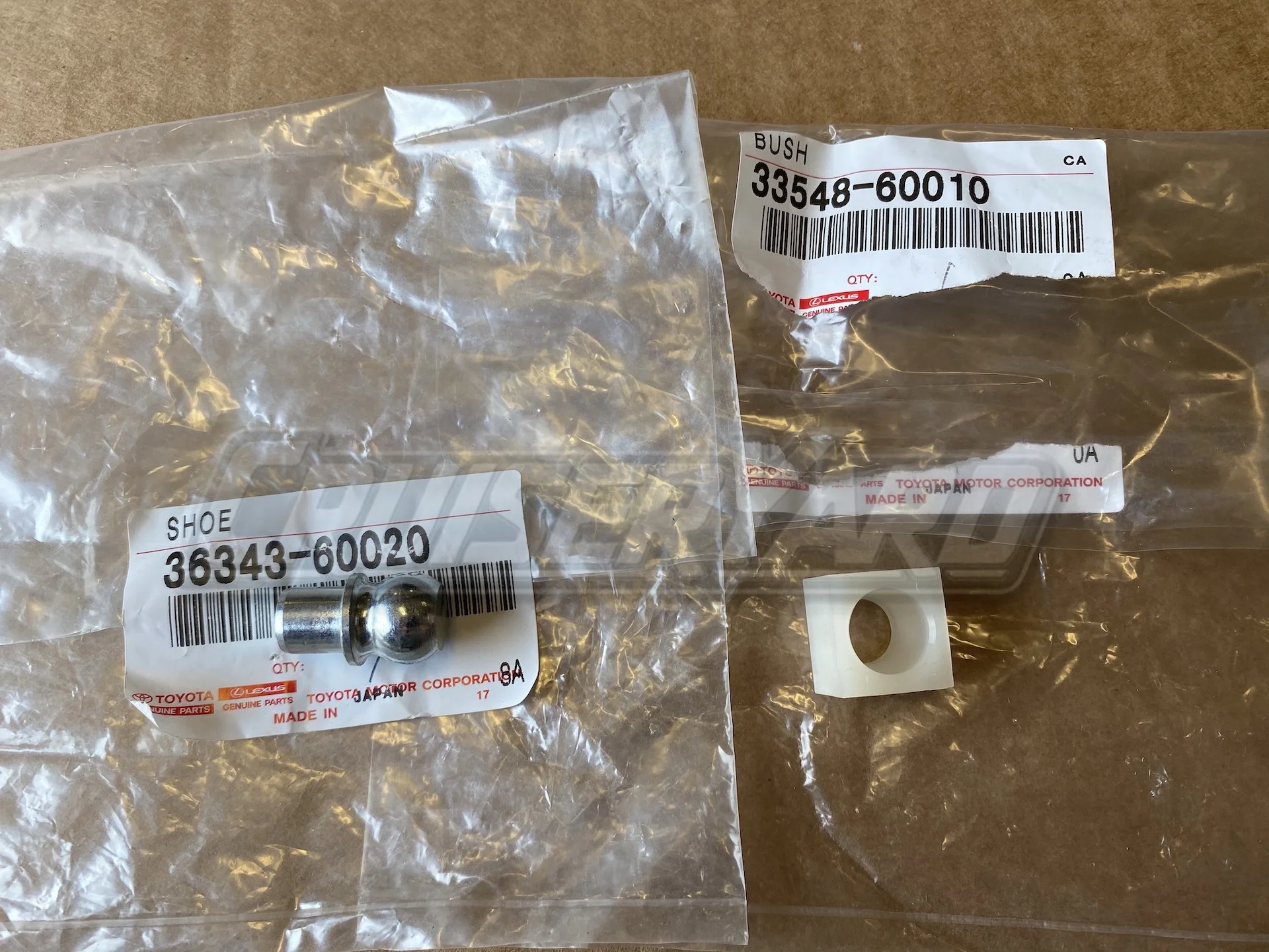

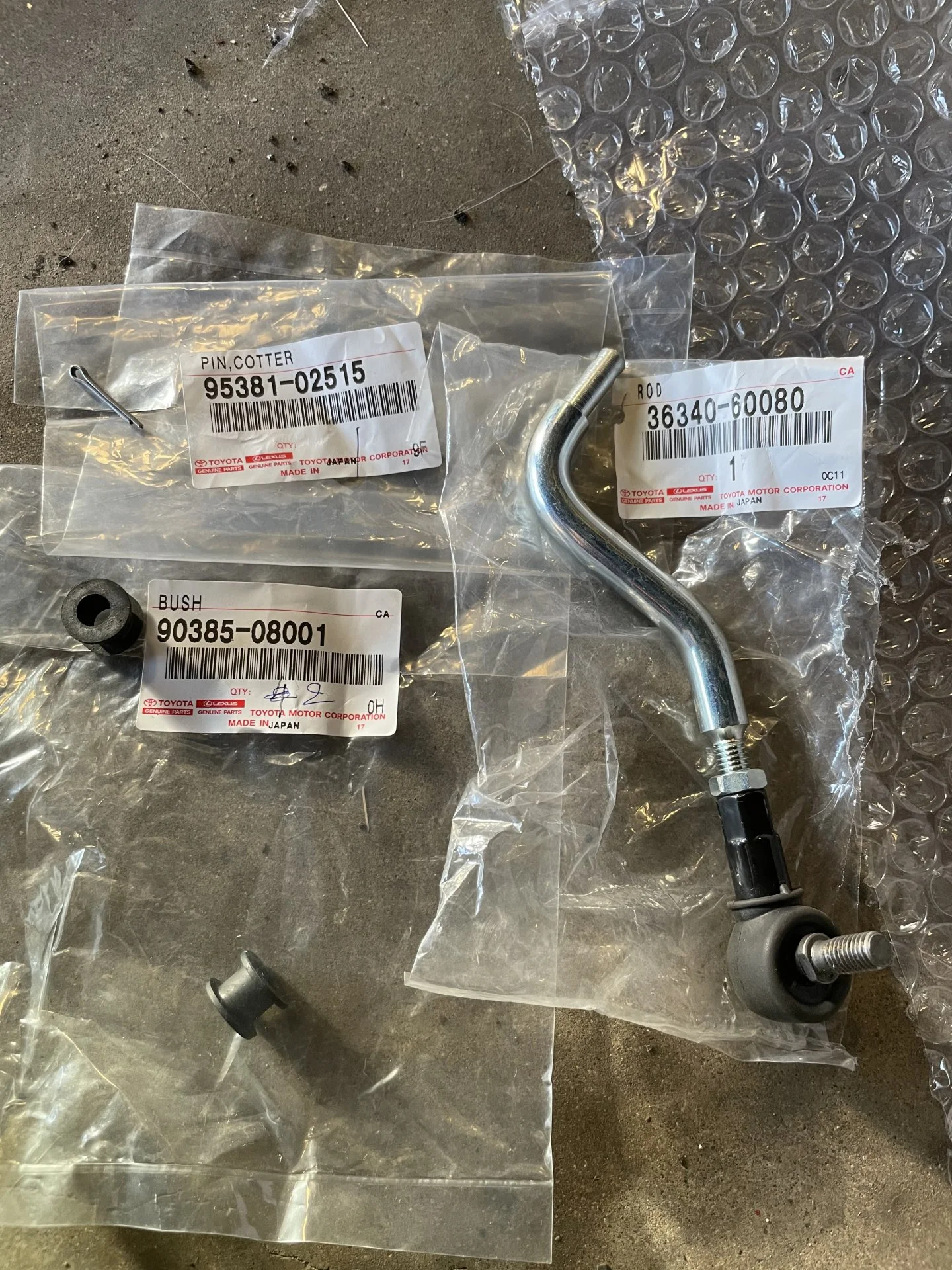

Toyota sells them. I just ordered them for a project.
Local dealer?

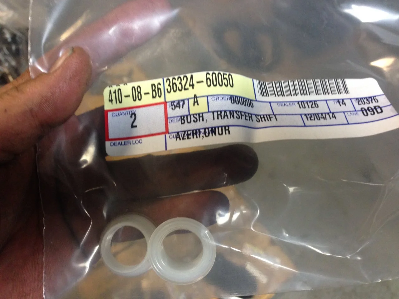

Yep, pay a visit to the parts counter folks at any dealership, have them pull up the specific parts diagram for the linkages. There are four bushings, if my memory serves me:
1x small round rubber
2x flanged plastic round
1x square hard plastic

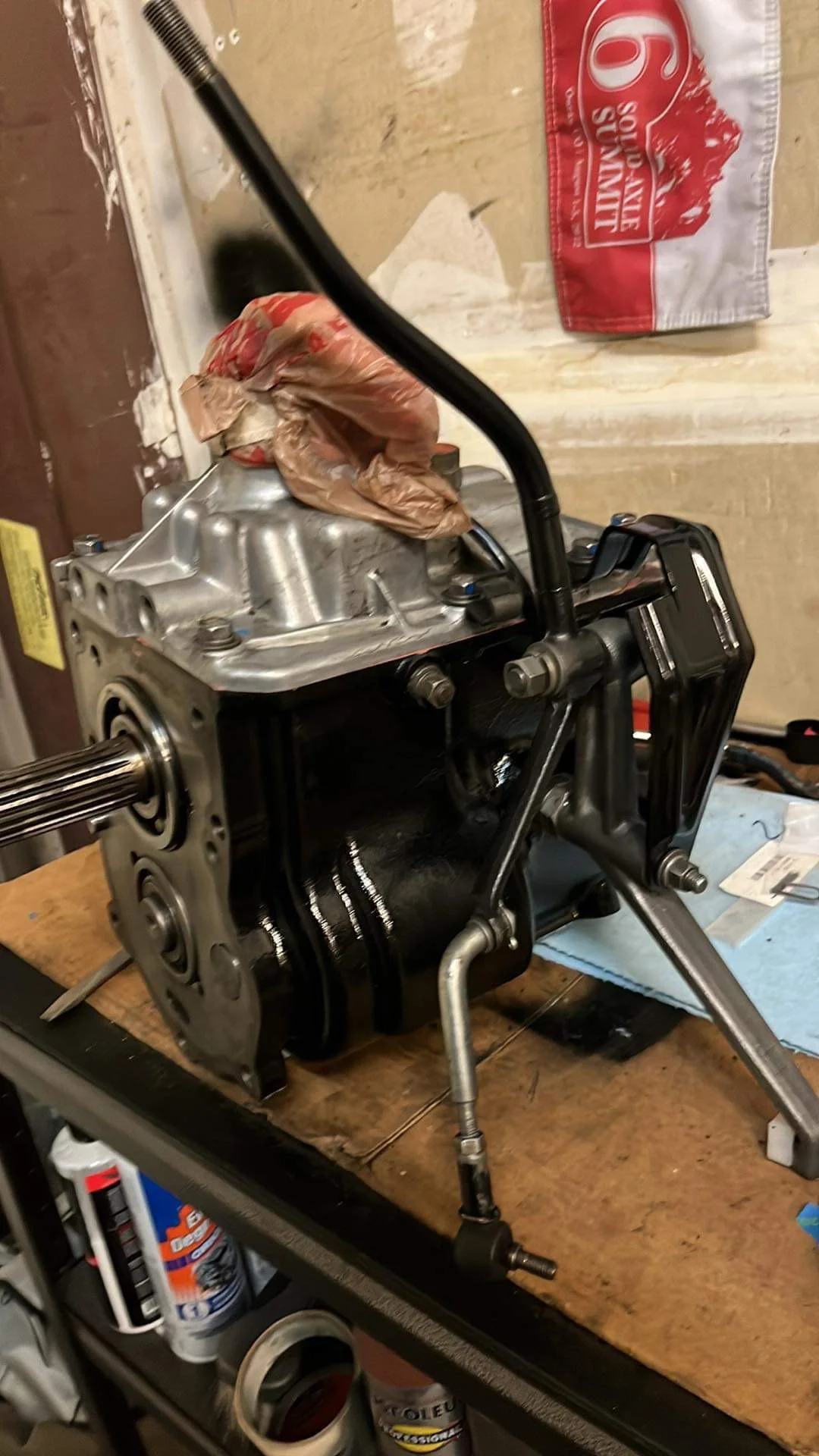

Maybe somebody will come along and mention a bushing I’ve forgotten. Here’s a photo of the linkages after I cleaned them up and put them all back together.

Haha, nah, just sent it as is.
I keep all of them in stock for 60 and 62 shifters
