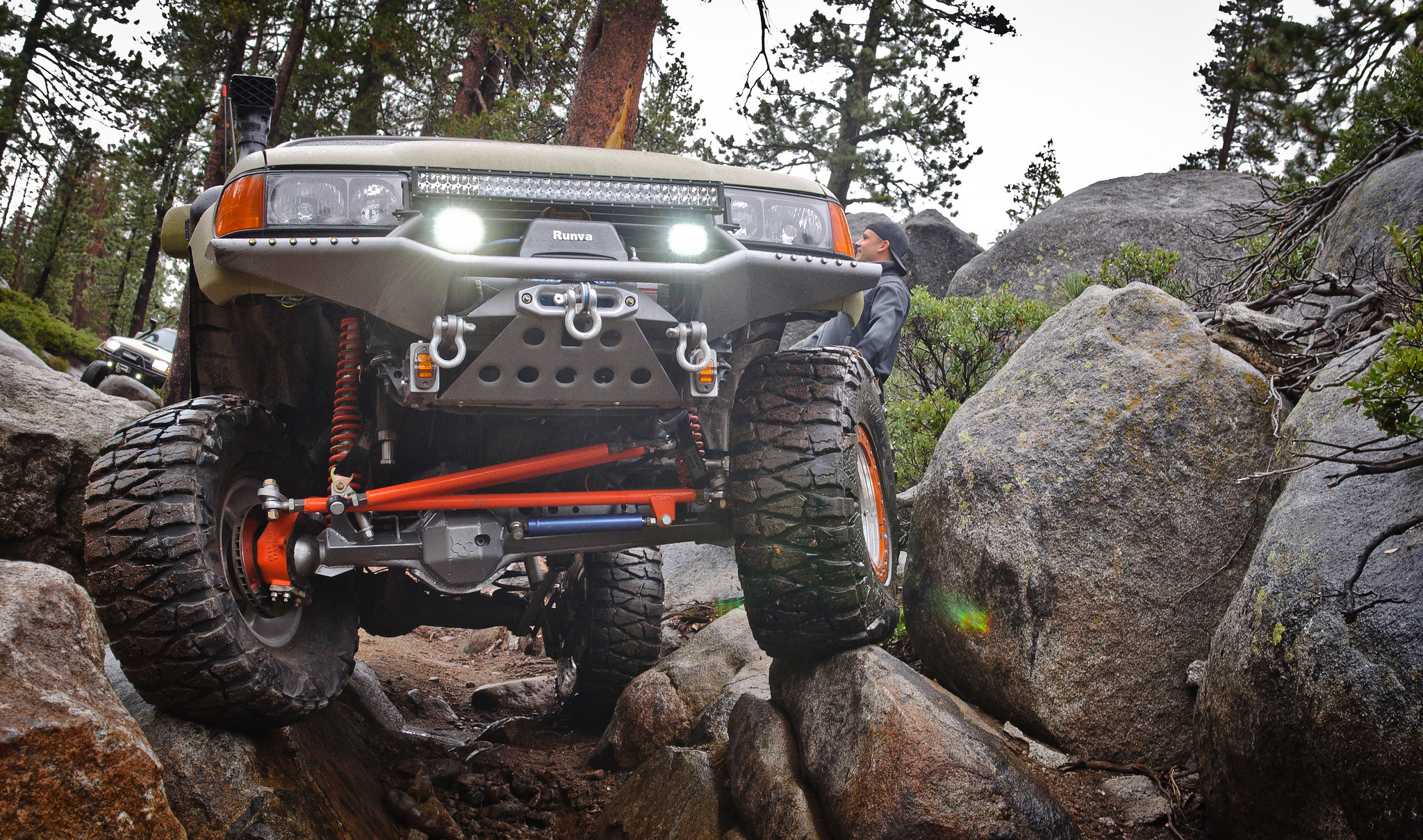

For 99% of people that TRE is going to be overkill as well as being a horrible DD interaction with an overall stock or even slightly modified suspension set-up.
That set up is for folks like you.... And you are few.
